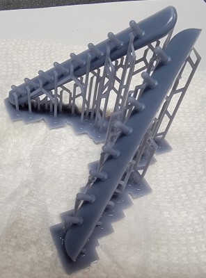

I altered the oar model a little and took a shot at printing 45 at once. I didn't leave enough space between them and the supports got fused to the oars in a few places. It's been difficult to dig them out, but I'm managed 27 usable ones so far.
File comment: The Borg Cube of oars

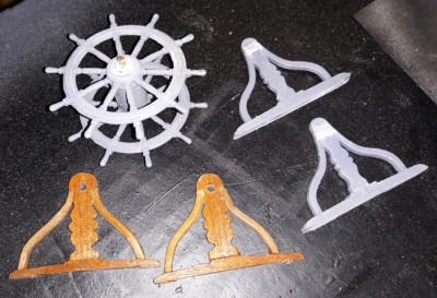

I printed a new wheel to replace the too-fragile one I bought, but I liked the wooded pedestal I made for the old one better. So I sawed off the resin pedestals. Now the wheel will spin again, so I'm reverting back to plan A and connecting the ropes to the rudder servo so the wheel will spin when the rudder moves.
File comment: Reverting back to the wheel's wooden pedestal

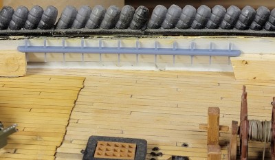

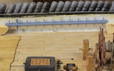

File comment: Top rails made up, not permanently installed yet

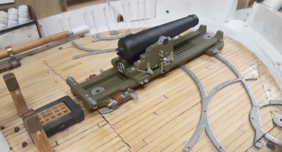

The parts of the model that make it a warship - the pivot guns all painted.
File comment: Bow pivot gun
File comment: Stern pivot gun

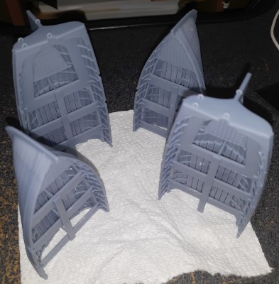

It was made in two parts so it would fit in the printer, and the parts had to be arranged and written to the STL file, for slicing.
The slicing software said it would weight 29.9 grams (1.6 ounces), use $1.05 worth of resin, and take 4h 50m 57s to print.
File comment: In two parts to fit in the printer
To the printer it went...
File comment: Almost half printed
File comment: Printing complete

Once the 2nd cutter was printed, I focused more on the quarter boats. It's one 3D model, but two of them get printed to eventually hang on davits on the aft quarters of the ship.
File comment: x-ray view of quarter-boat in progress
File comment: 3D model of quarter-boat
These boats look very much like the cutters, but are a little longer, not as tall, with narrower sterns. At 1:36 scale, they're about 8-7/8th inches long (22.5cm). All the boats will be too long to print in one piece, and are made in halves, but both quarter-boats can be printed at once with room to spare.
File comment: In the slicer; done in halves to fit in the printer's available volume.
Printing took about 5-1/2 hours.
File comment: Printed and washed
File comment: Two quarter-boats and the 2nd cutter
Here's the boats sitting about where they'll live on the main model
File comment: Where the boats go on the main model

John Dahlgren submitted a drawing, dated July 31 1850, proposing his idea of the ideal armament for "First-Class Frigates" suggesting they be armed with six 10 inch pivot guns on the spar deck, and 26 9 inch guns on the gun deck. The Navy rejected the proposal, mostly; they opted for two 10 inch pivots and the gun deck armed with 8 inch shell-guns and 32# shot guns, and the big frigates, razees (cut down frigates) were armed in this manner, including Constellation, the newest, and largest sloop-of-war that wasn't a razeed frigate.
File comment: 10 Shell Gun ~ Pivot Carriage
from Dahlgren's 1850 proposal
On a visit to the ship, years ago, they showed the Mississippi Pivot Gun plans, saying that was what Constellation was originally armed with; which were eventually replaced with Parrott rifle pivots, a plan they also showed me. I took some pictures of the Parrott plans, but went to the National Archives in College Park Maryland, to get a proper copy of the Mississippi plan.
On August 26 1854, the sloop-of-war Constellation would be launched. Almost a year later, June 1855, the plan for the 10 inch pivot guns for the side-wheel frigate Mississippi was drawn. Another year on, Constellation was commissioned on July 28 1855.
File comment: Plan for Mississippi's 10 inch pivot guns of 86cwt
It seemed to me to be unlikely the ship would be armed with a gun from a plan drawn a year after her launch, while her razeed contemporaries were armed with the Dahlgren around the same time, 1853~1856. So far, I haven't been able to track down any sort of documentation that can nail down precisely which 10 inch shell gun Constellation got. The Mississippi gun is, so far as I've seen, always referred to as a "10 inch shell-gun of 86cwt" while the Dahlgren simply referred to as a "10 shell-gun" or a "X inch shell-gun." I haven't yet found a references to Constellation's guns as "86cwt." The 10 inch Dahlgren is 120cwt, and I've never seen anything referring to it in that way.
Since it's really isn't that big a job, being able to 3D print now; I decided to switch the model's pivot guns to Dahlgrens. Since I was already making the 3D model for my Naval Gun project, it didn't really add to the work-load.
File comment: 3D model of X inch Dahlgren pivot
The slide for this gun, while very like the Mississippi gun's slide, was wider and shorter. I used the slide from the 3D model of the previous pivot gun, shortened and widened, which saved some time and effort.
I printed the gun in three parts; slide, carriage, and tube; to facilitate painting, and reducing what I'd need to reprint if one of the parts failed. The first gun lost one of it's rollers, but I could fix that without reprinting. The second gun printed perfectly.
File comment: Second gun, fresh off the printer
File comment: New Dahlgrens next to the gun they're replacing
A shorter slide meant I needed to make new deck tracks, which I 3D modeled like last time, but I made them short/thinner to be more in scale.
The guns are mounted on access hatches, fore and aft. I removed the old tracks, sanded the scars best I could, and re-coated the hatch decking with polyurethane. The newly printed tracks were primed, painted, glued onto the hatches, painted again, and the whole thing was clear-coated. The guns too were primed, and the tubes painted and detailed, but the carriages and slides are waiting to be painted the same olive color as the old set.
File comment: Deck hatches cleared of old tracks and refinished.
File comment: Aft pivot
File comment: Forward pivot

Besides working on other model besides Constellation, like my Pride of Baltimore, I went and had a stroke back near the end of June. Basically the summer was shot, as far as getting any work done. I am getting detailed things back, like handwriting, but it's gotten cold, and there's no heat in my shop/garage, so getting physical work done is still stalled. My goals for the spring are getting Pride sailing, if not finished; and beginning proper rigging of Constellation.
To that end, an item Constellation needs before rigging can begin are her pin-rails. It'll be near impossible to install them once the rigging's going up, and many rigging items attach to the pin-rails.
I opted to 3D print the pin-rails that attach to the bulwarks as I did the ones at the base of the masts.
File comment: 3D printed Pin-rail at base of the fore-mast
There are basically four pairs of pin-rails: Port and starboard at the mizzen, main, fore, and a pair at the bow on either side of the bowsprit.
Building from the 3D models of the mast rails, mostly belaying pins and the shape of the rail, and getting size and shape from an 1888 spar-deck plan, and the few photos that show enough of anything to work with; I started with the aft rails. The printed with a little deformity at one end that was repairable, but I also had forgotten to account for the fact that the bulwark they attach to leaned inboard and I had not modeled in that angle. I fixed the 3D model and it printed perfectly.
File comment: Aft pin-rails just printed
File comment: Aft pin-rail sitting where they'll be installed after primer, paint, and UV protective measures
