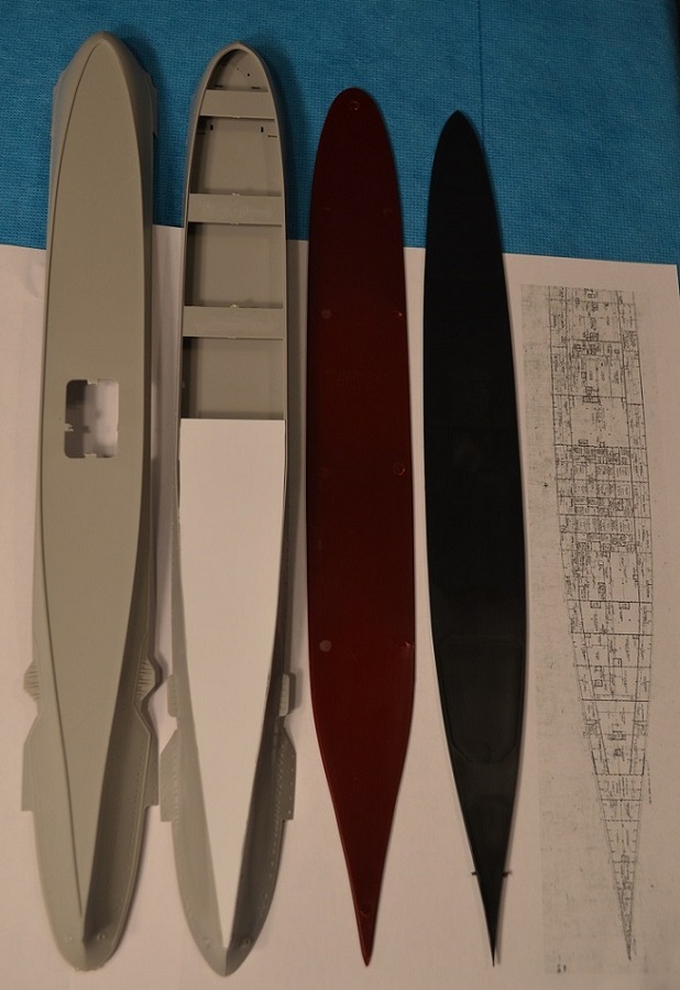

The CV-5 plans from HNSA were downloaded and the 4th deck (closest to the waterline) was scaled to 1/700 and printed. Following is a shot of the waterlines of (L to R): Trumpeter's CV-5/6, Trumpeter's CV-8 (corrected), the Trumpy CV-8 waterline plate, Tamiya's CV-5 waterline plate, and scaled CV-5 plans:

The new hulls compare very favorably with the scaled plans. The older CV-8 hull is about 2.5 mm wider, and has less undercut at the stern, not just due to the slight change in sectioned level, but due to the curvature of the hull. My Hornet copy was boxed in 2010; the waterline plate has a date of 2005 molded in.
The Hornet hull has a sharper prow than the recent CV-5/6mold, similar to Tamiya's offering for the class (Tamiya is to the left, dark grey):
