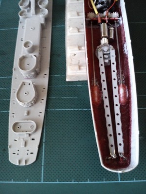

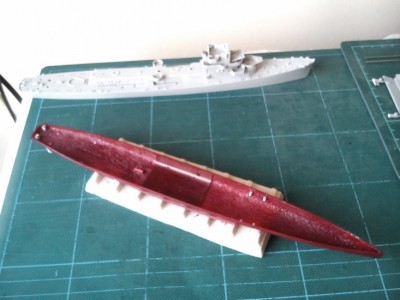

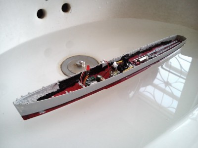

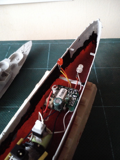

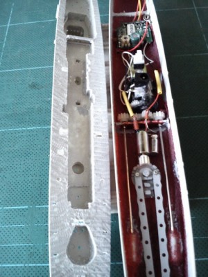

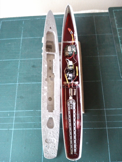

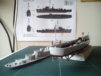

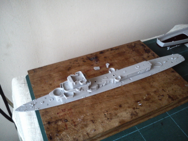

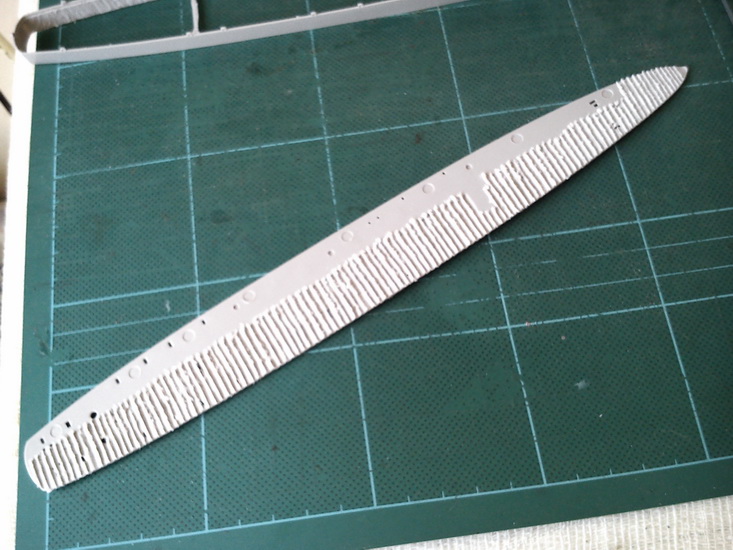

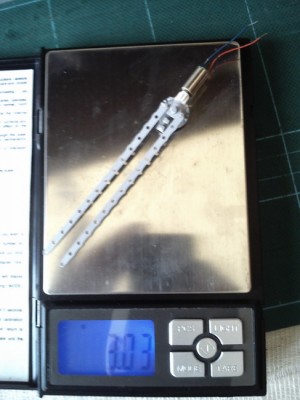

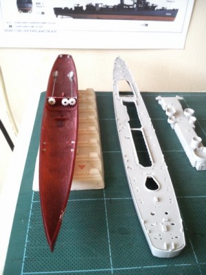

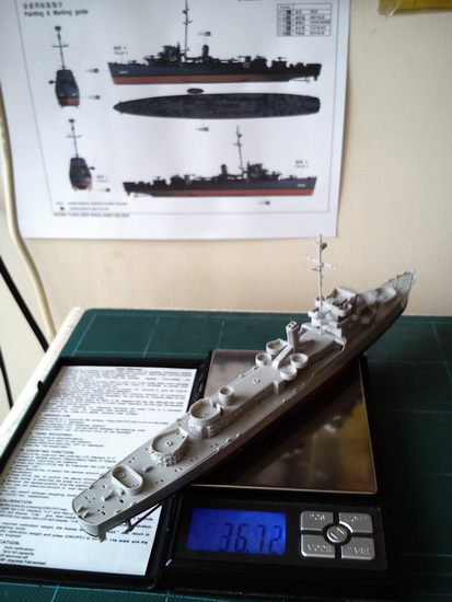

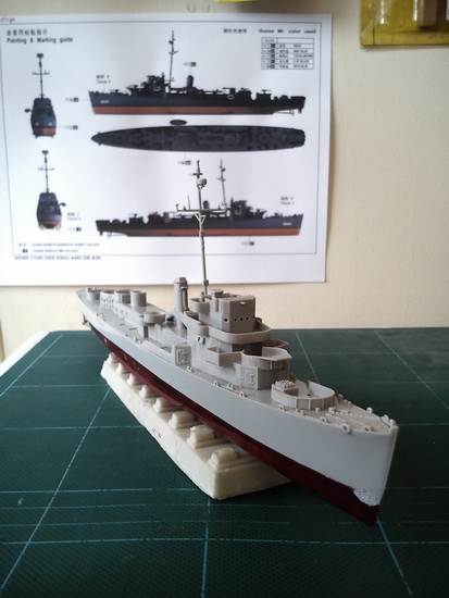

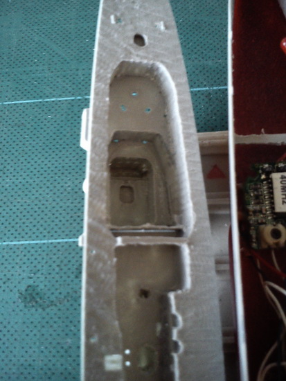

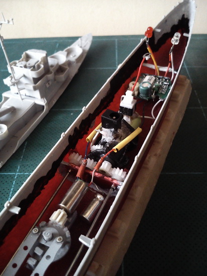

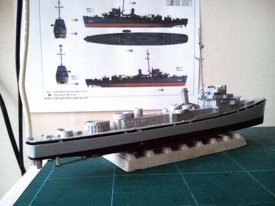

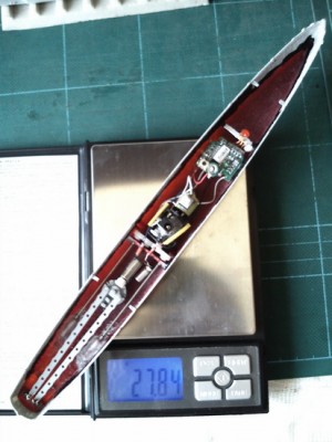

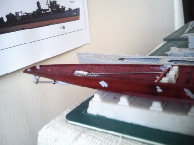

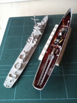

Hello all,
This's part 1 of 2, I've built it in part 1 assembly until this ship model can be buoyancy test in water & stable.
In part 2 about install all small parts & PE, painting my friend mr. Pek from modelivery.com (Thailand) he'll be do it later.
And last step we'll be fix the propellers & trial in water that'll be post pics again, hope you like it, enjoy. :big_grin:
Thanks
mws (modifyworkshop)
Part 1
A Diet hull
B Diet deck&superstructure
C Accessories
D Rudders
E Propellers
F Hull assembly

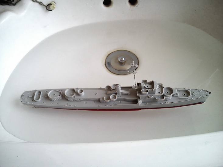

G Buoyancy test
H Ship in the toolbox
I Acc testing in mp4

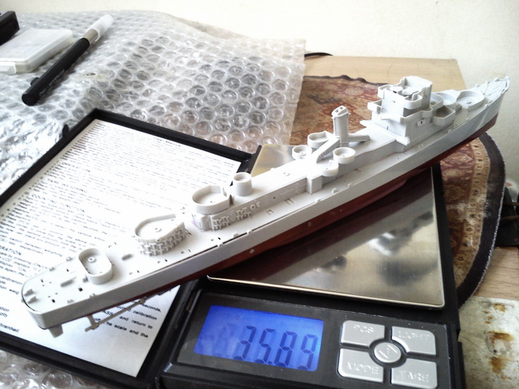

File comment: Part 1

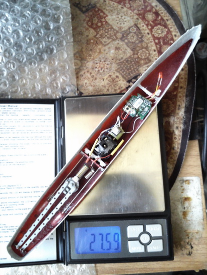

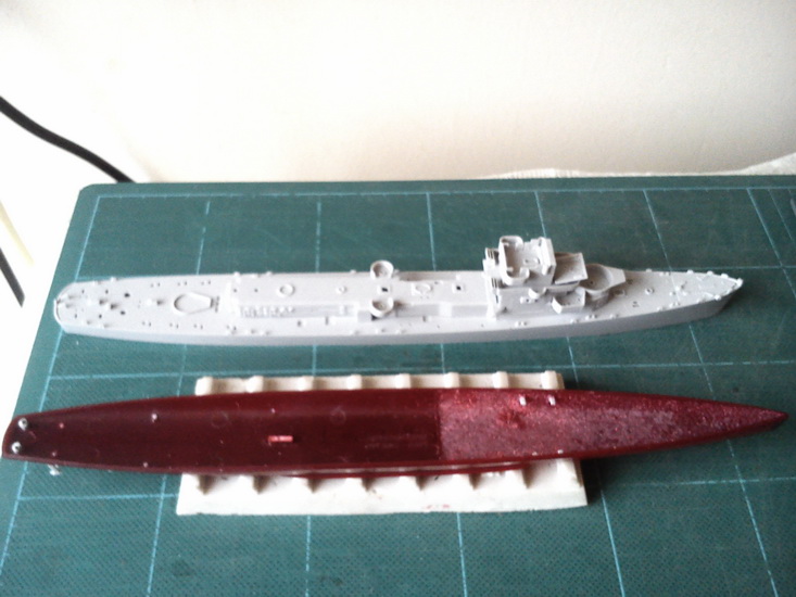

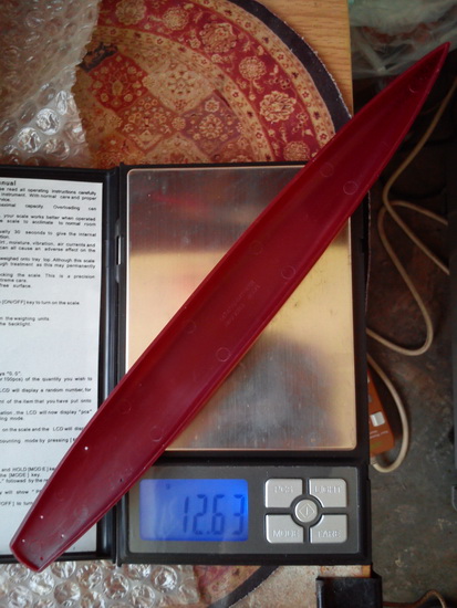

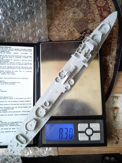

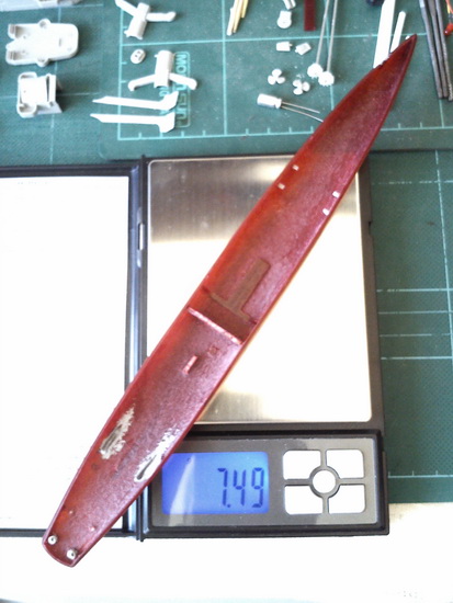

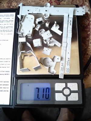

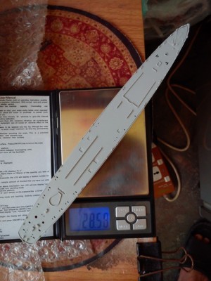

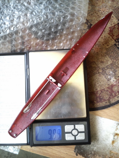

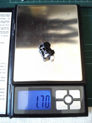

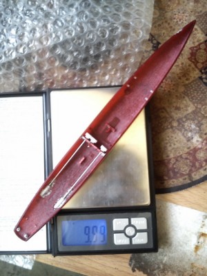

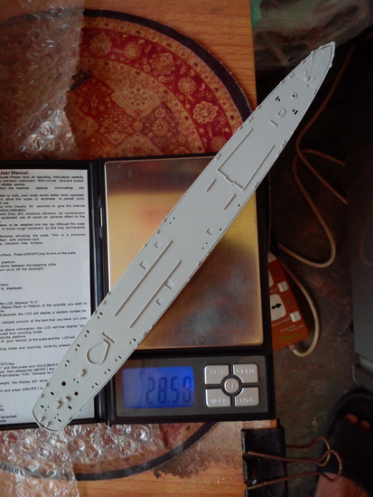

A Diet hull

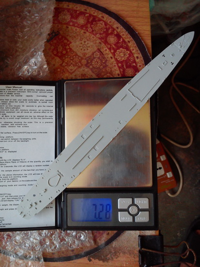

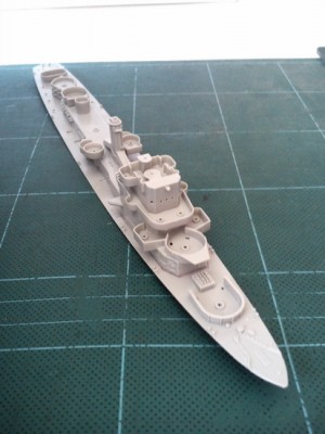

A1 Check raw weight (6 pics)

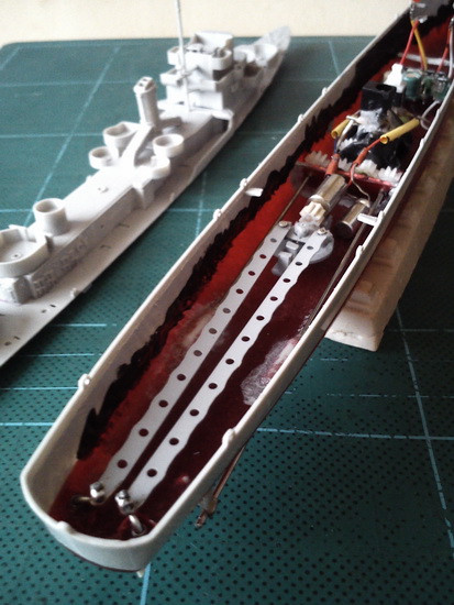

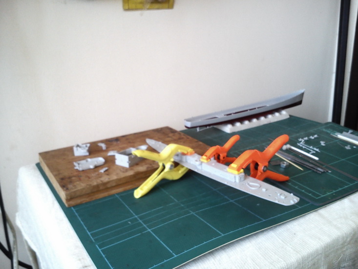

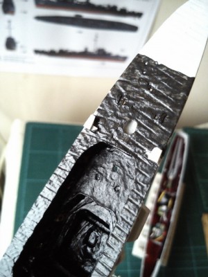

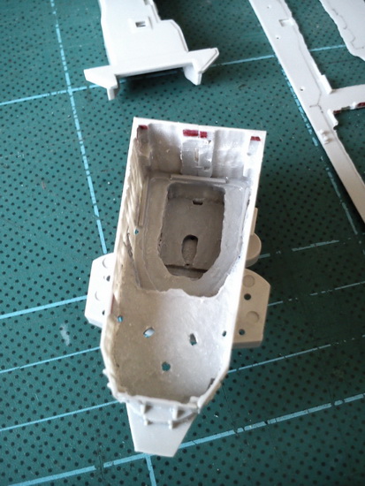

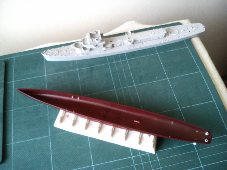

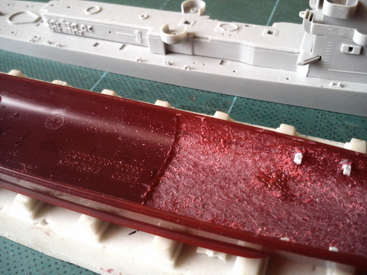

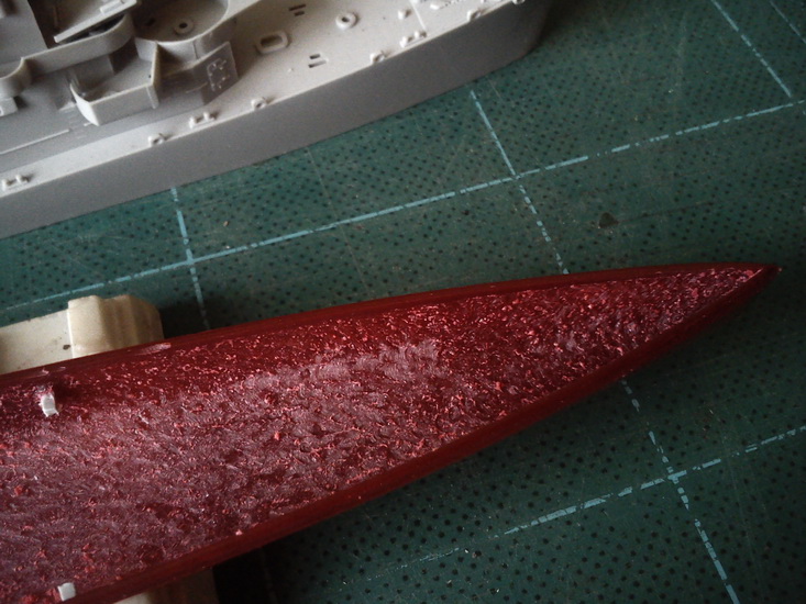

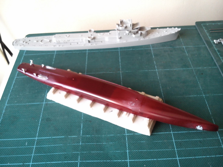

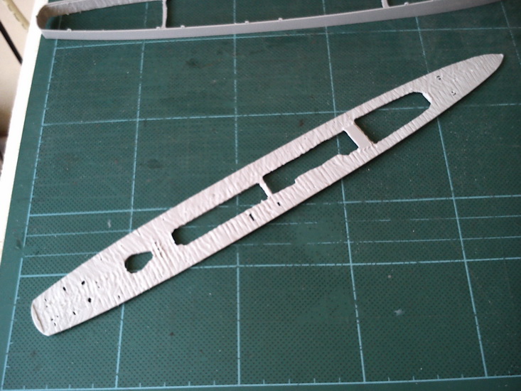

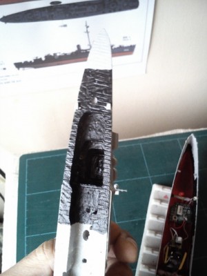

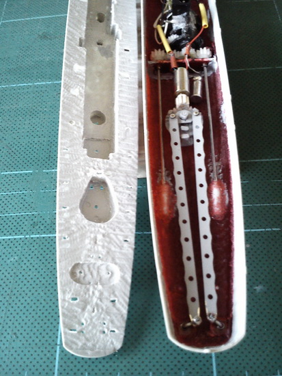

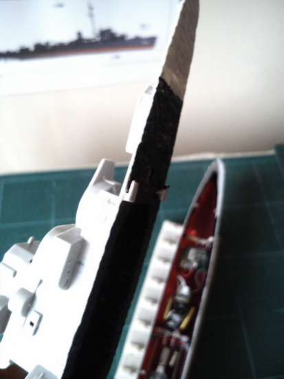

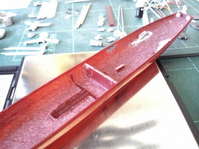

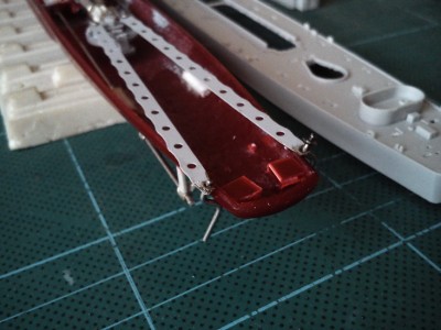

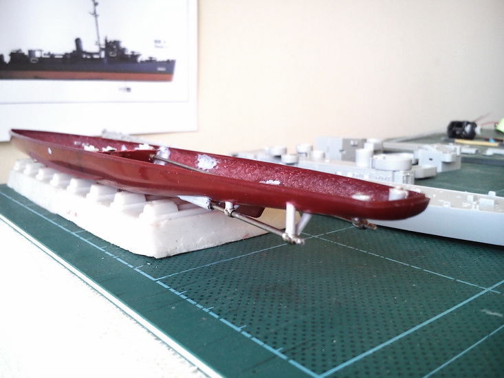

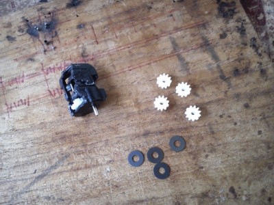

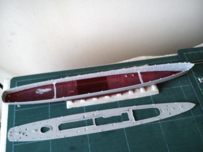

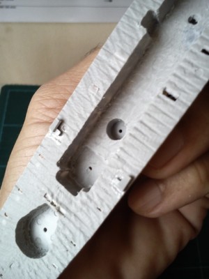

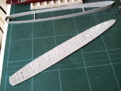

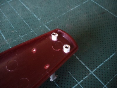

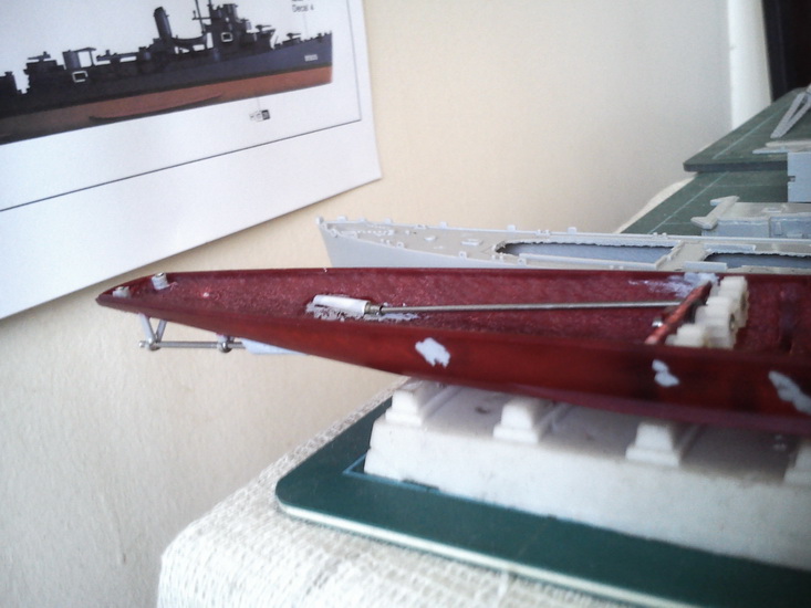

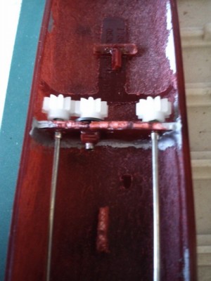

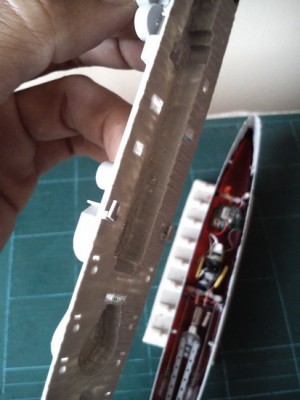

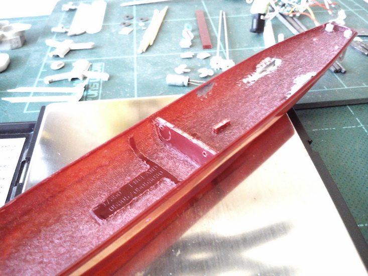

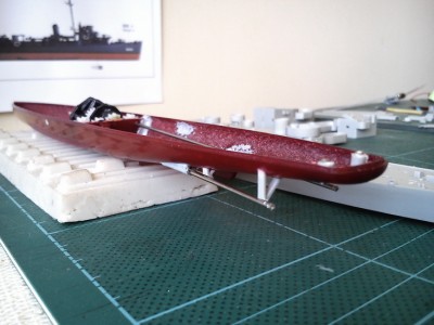

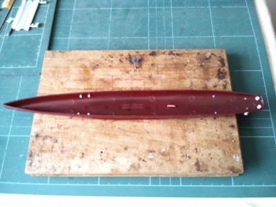

A Diet hull

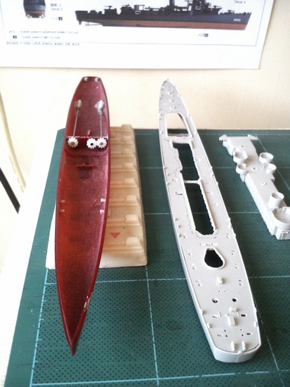

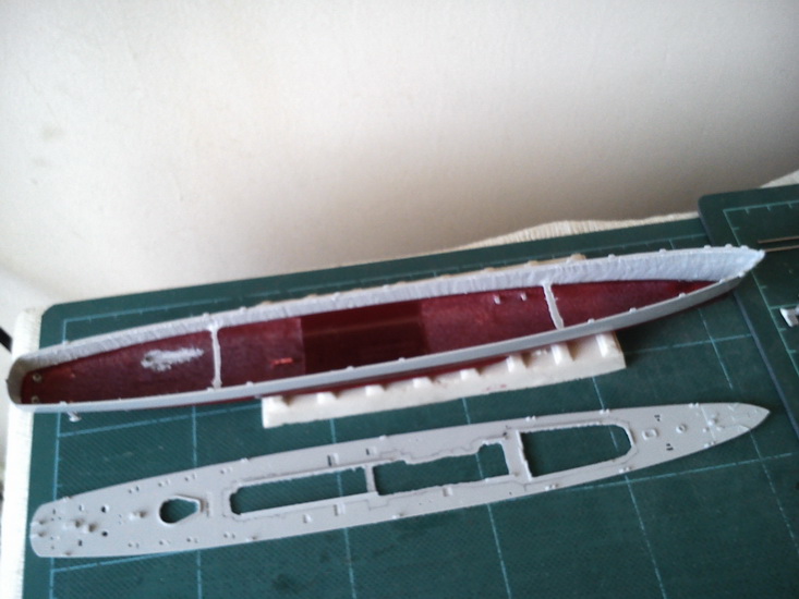

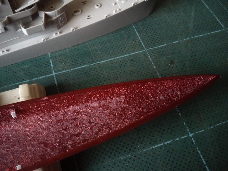

A2 Diet process (10 pics)
PostPosted: Sat Jan 09, 2016 4:03 am
Joined: Sat Dec 05, 2015 12:47 am
Posts: 33

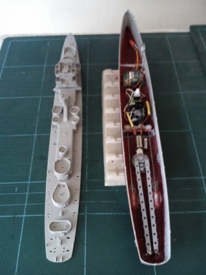

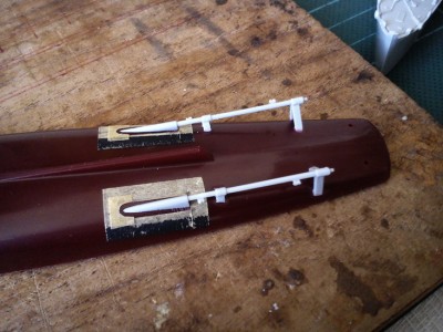

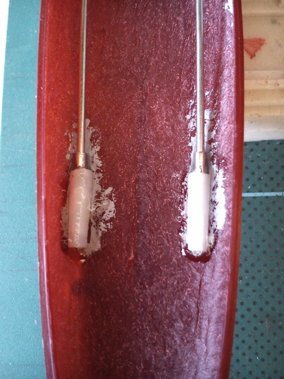

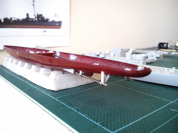

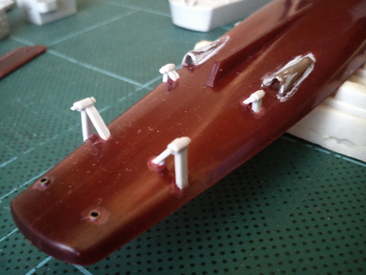

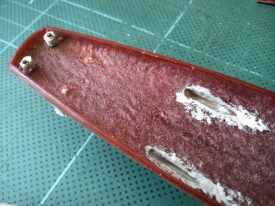

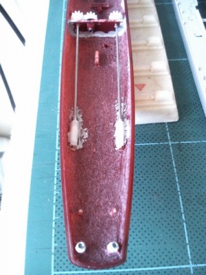

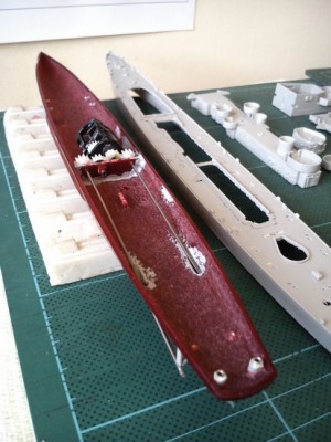

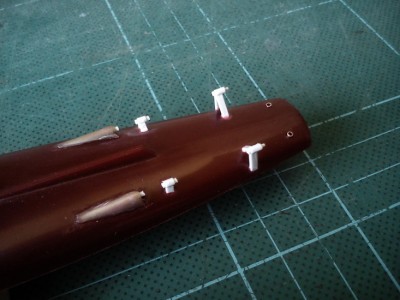

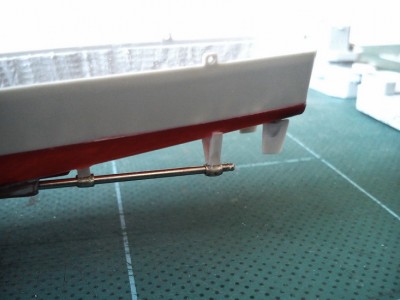

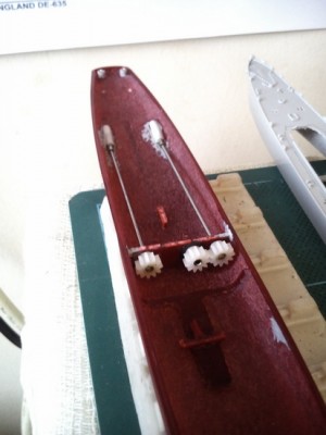

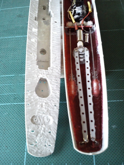

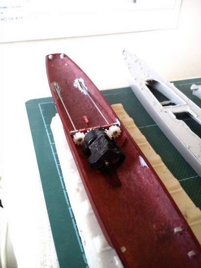

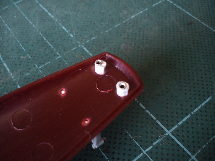

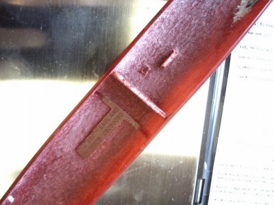

A Diet hull

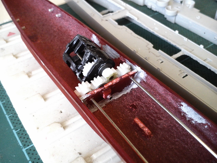

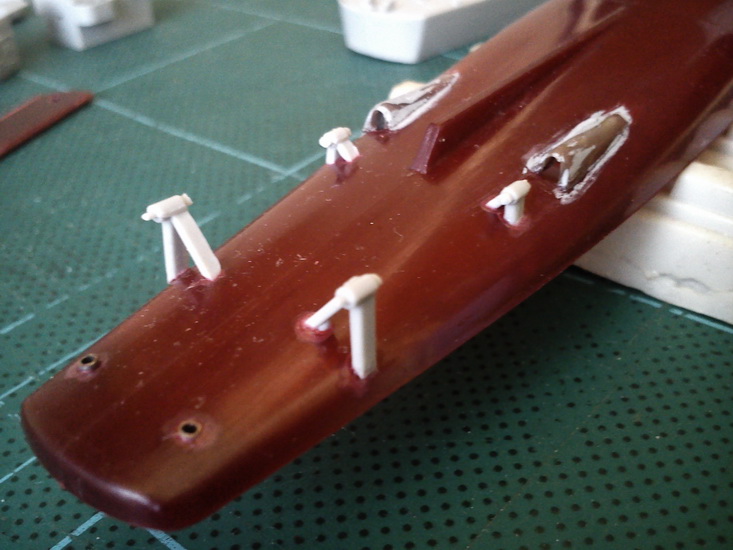

A3 Shafts install (20 pics.)
PostPosted: Sat Jan 09, 2016 4:08 am
Posts: 33

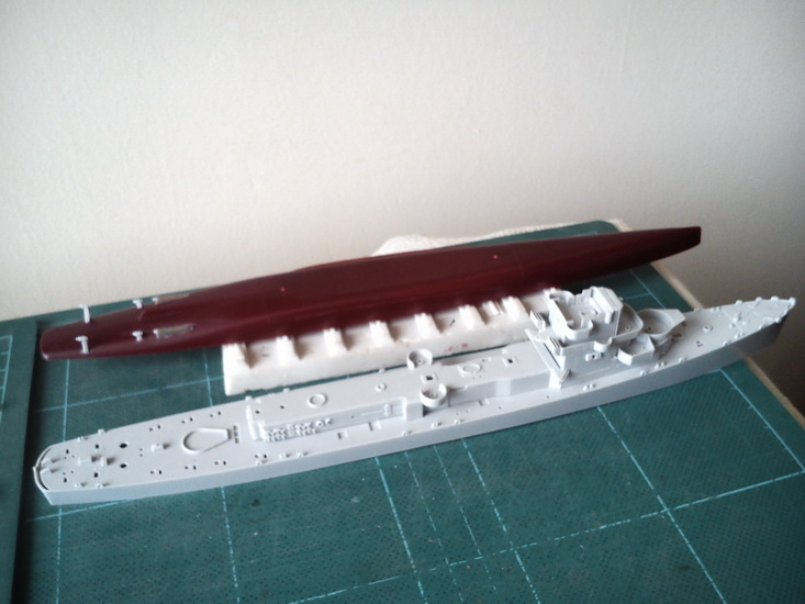

A3 Shafts install (cont.)
PostPosted: Sat Jan 09, 2016 4:11 am
Posts: 33

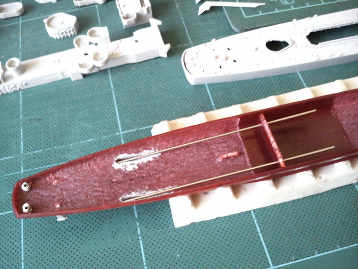

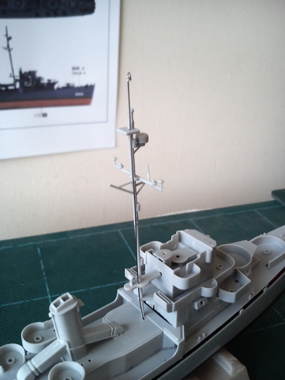

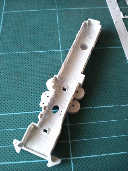

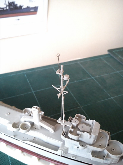

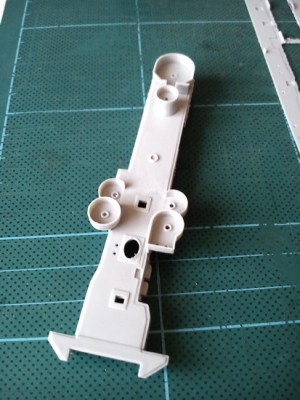

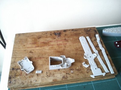

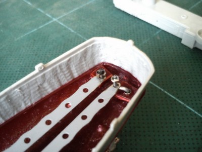

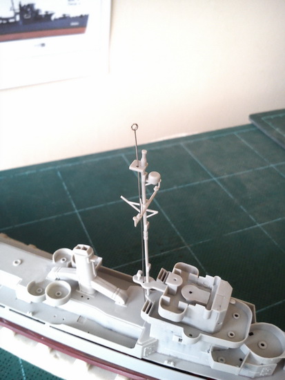

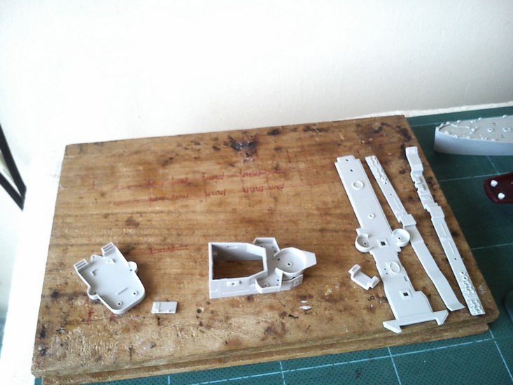

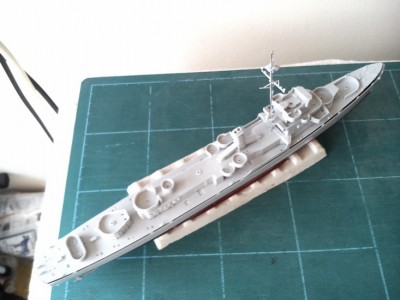

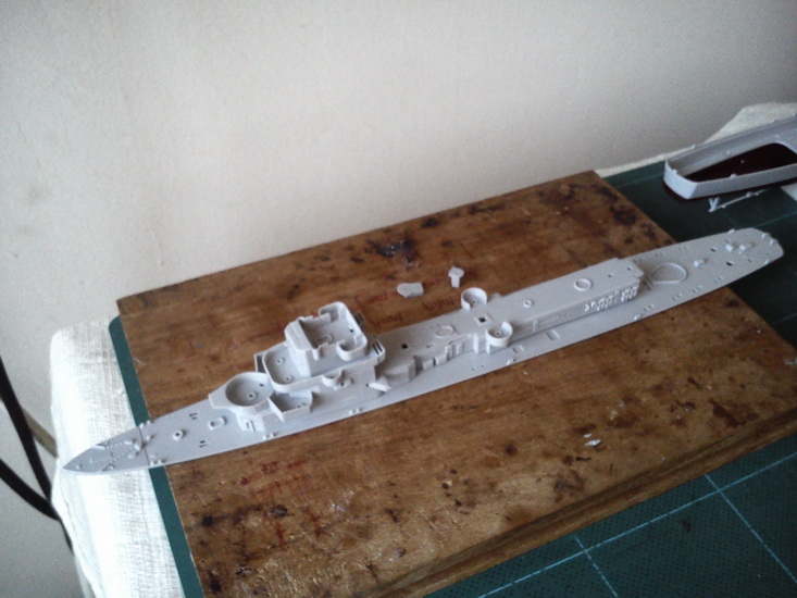

B Diet deck&superstructure (19 pics)
PostPosted: Sat Jan 09, 2016 4:19 am
Posts: 33
B Diet deck&superstructure (cont.)

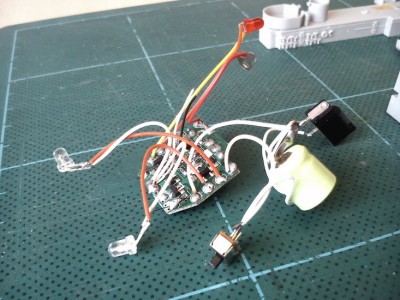

C Accessories (10 pics.)

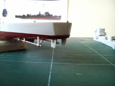

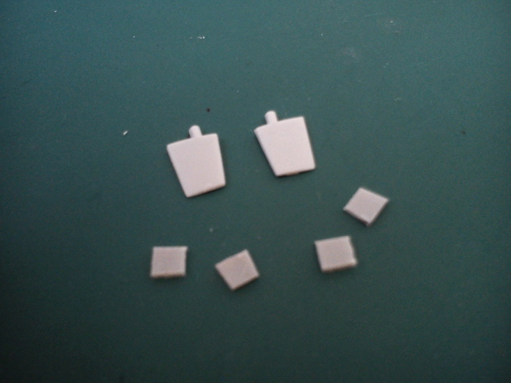

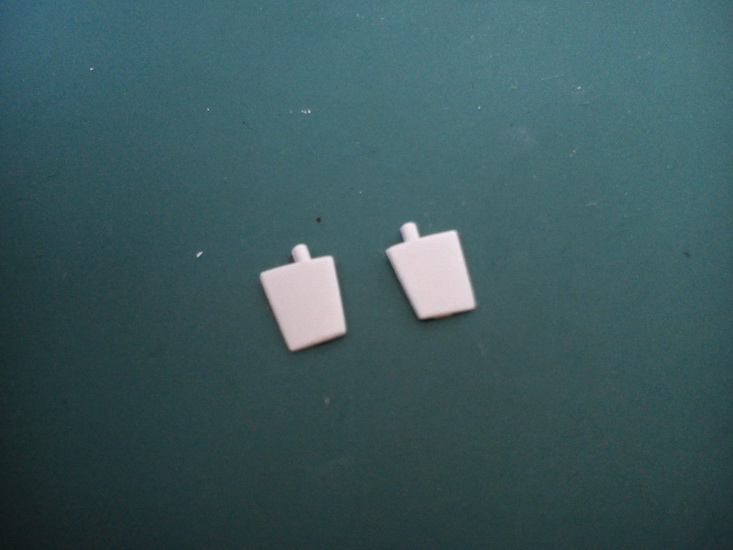

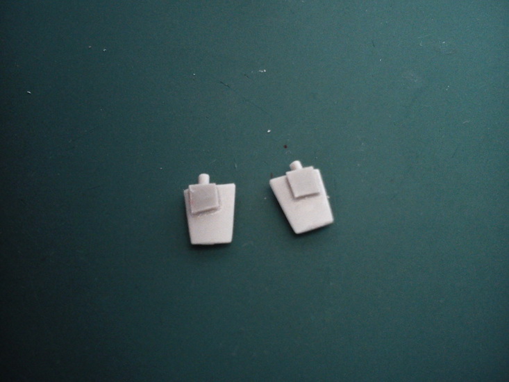

D Rudders (10 pics.)

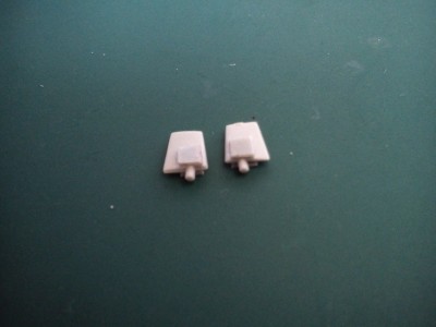

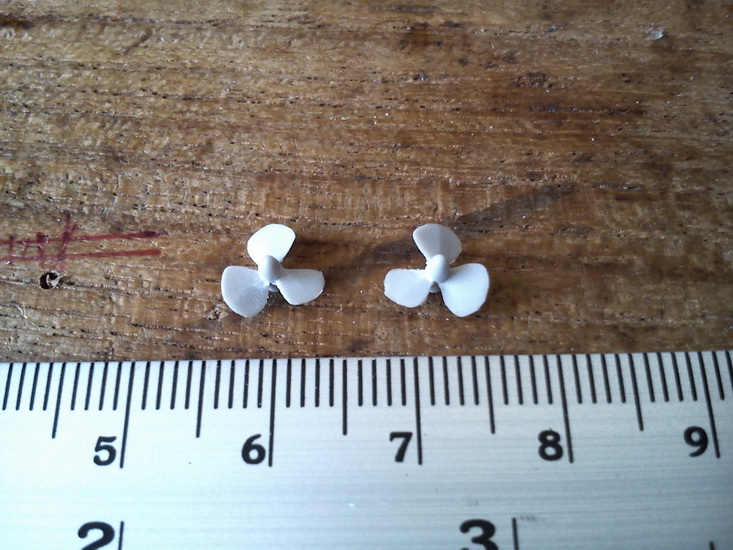

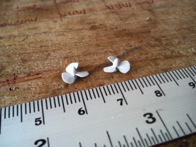

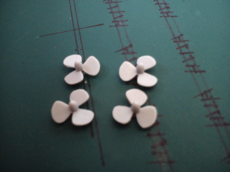

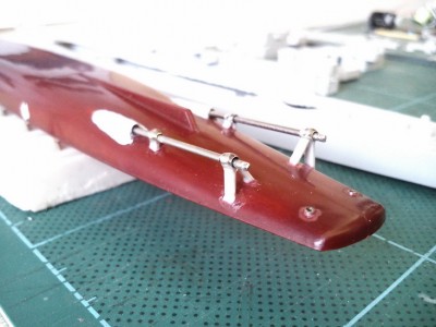

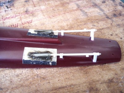

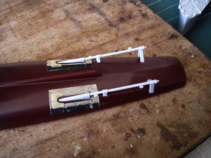

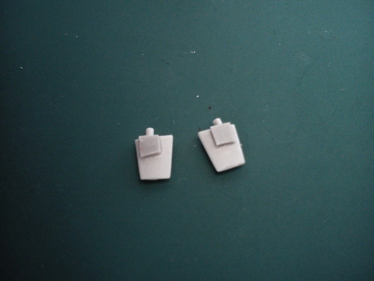

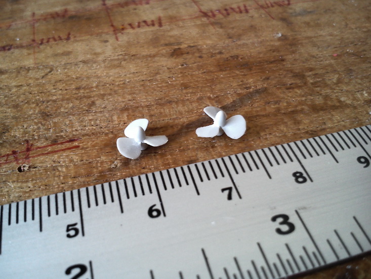

E Propellers (3 pics.) sanded for thin shape.

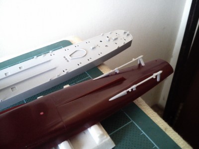

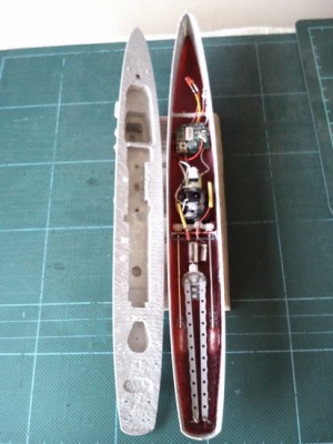

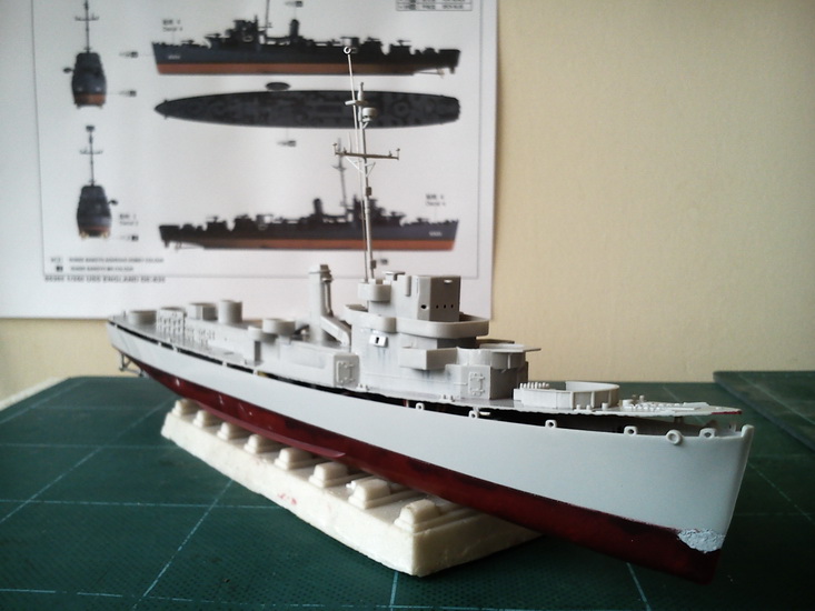

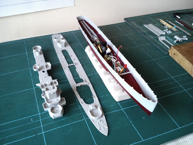

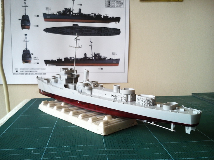

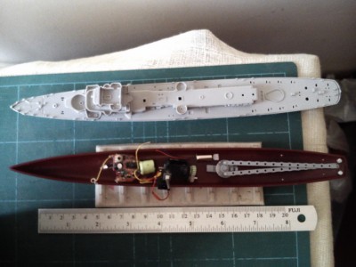

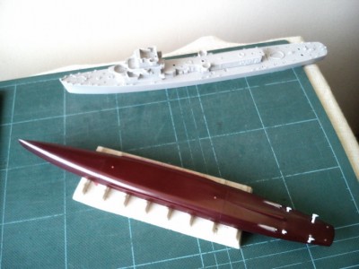

F Hull assembly (20 pics.)
PostPosted: Sat Jan 09, 2016 4:41 am
Posts: 33
F Hull assembly (cont.)

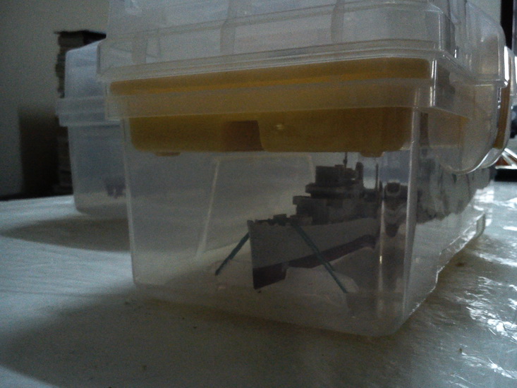

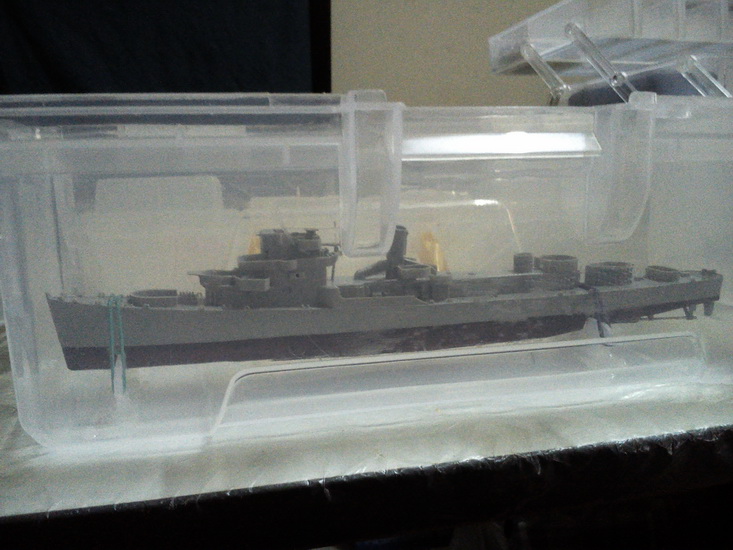

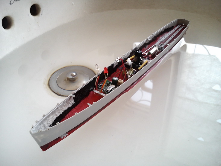

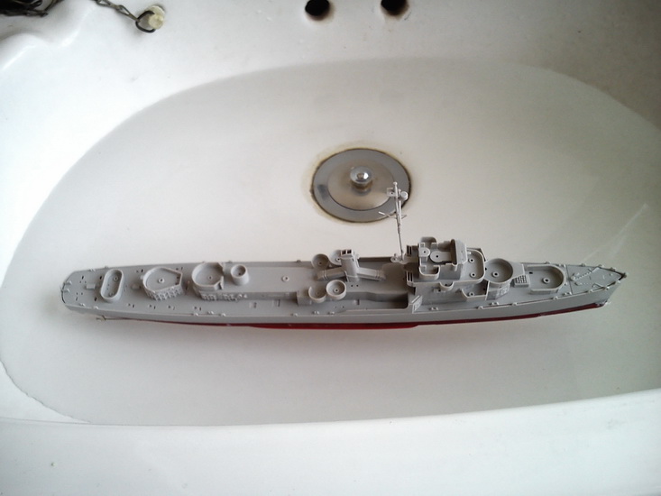

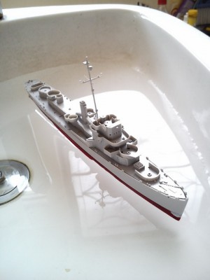

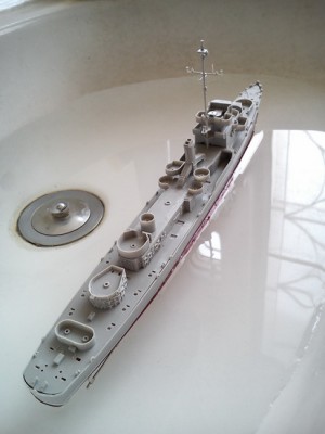

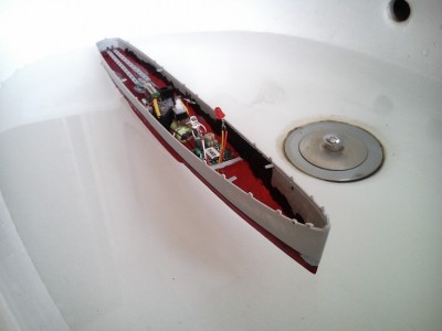

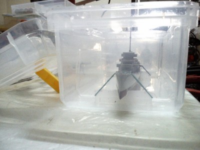

G Buoyancy test (8 pics.)

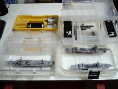

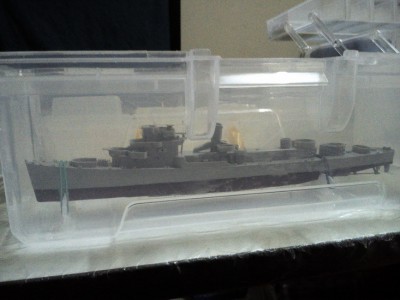

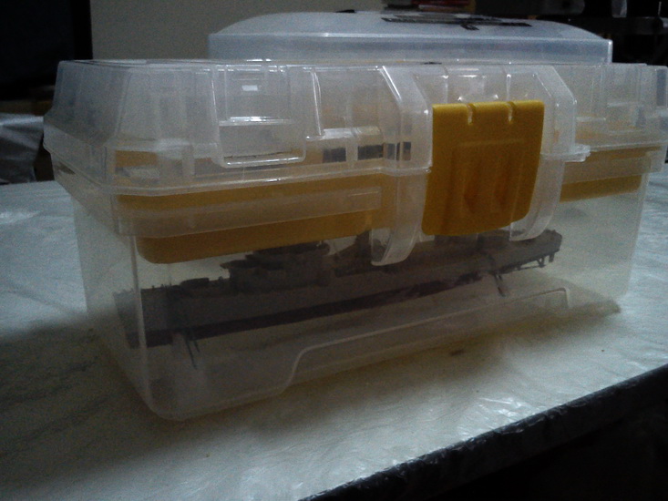

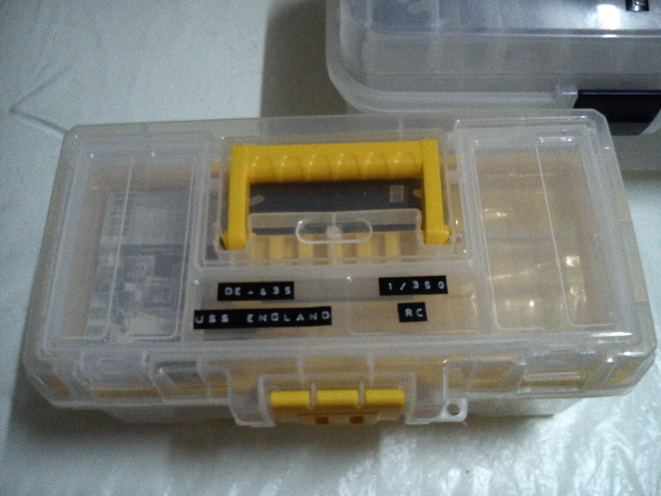

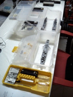

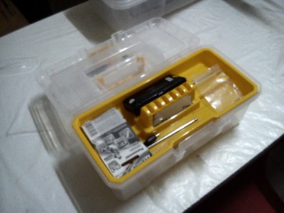

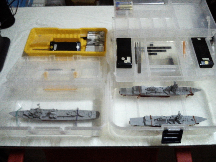

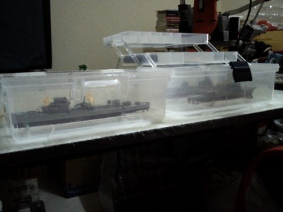

H Ship in the toolbox (9 pics.)

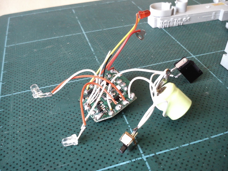

I Acc. testing
Please link to Youtube in below.

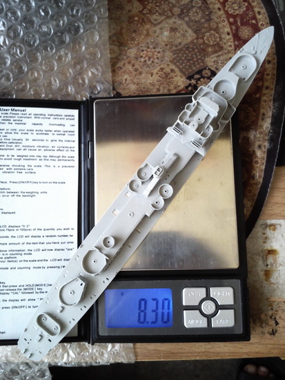

PostPosted: Wed Jun 02, 2021 11:24 am
Posts: 5062
I see that you have carefully weighed all the parts. For such small models the top weight of the thicker plastic components tends to give a lot of top weight and have poor stability in the water. Have you had any trouble with this?
Cheers! Tom
