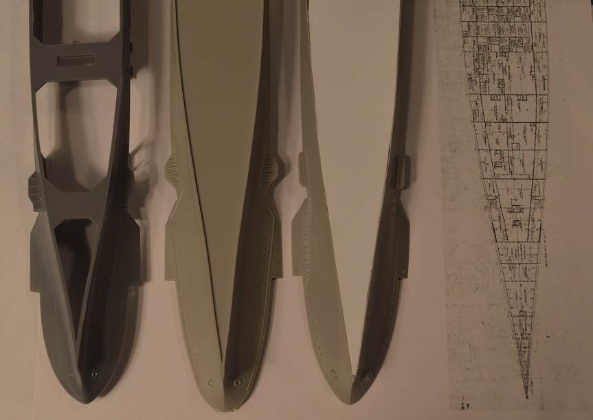

The CV-5 plans from HNSA were downloaded and the 4th deck (closest to the waterline) was scaled to 1/700 and printed. Following is a shot of the waterlines of (L to R): Trumpeter's CV-5/6, Trumpeter's CV-8 (corrected), the Trumpy CV-8 waterline plate, Tamiya's CV-5 waterline plate, and scaled CV-5 plans:

The new hulls compare very favorably with the scaled plans. The older CV-8 hull is about 2.5 mm wider, and has less undercut at the stern, not just due to the slight change in sectioned level, but due to the curvature of the hull. My Hornet copy was boxed in 2010; the waterline plate has a date of 2005 molded in.
The Hornet hull has a sharper prow than the recent CV-5/6mold, similar to Tamiya's offering for the class (Tamiya is to the left, dark grey):

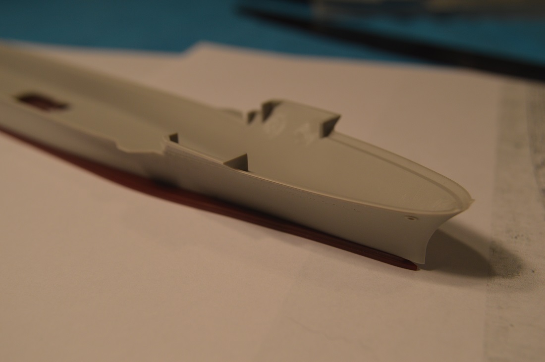

After a couple of hours of fiddling, using 0.030" styrene sheet and the scale plans, and cutting the first 3 cross braces out of the CV-8 hull, it was possible to draw in the hull sides. Working from the bow, the "waterline insert" was clamped and secured about 1-2 inches at a time with thin cement. The cross-braces were re-installed at slightly adjusted locations to add rigidity. The hull sides are thin enough, and Trumpeter's plastic is soft enough to then correct for the warping or twisting outward of the upper hull edges which resulted. While significant, this too was largely corrected so that there are no apparent major issues with fitment of the hull sides and flight deck. The hull remained flat at the waterline. All told, I think now the Hornet will build into a very nice model, without the distraction of the "tanker" hull form. An in-progress shot follows:
The correction pulled the hull sides at the waterline in by about 6 mm (1/4") the hull is sitting on the unaltered waterline plate. Although there are some strain marks where the hull was flexed back, under the 5" gun tubs, a touch with a file and a little bit of dull-coated 5-O will hide the surgical scars well enough. It does not look to be possible to use a CV-5/6 hull and CV-8 upperworks; the construction and dimensions of the decks and bulkheads differ. But, I'm pretty pleased with the fix so far.
