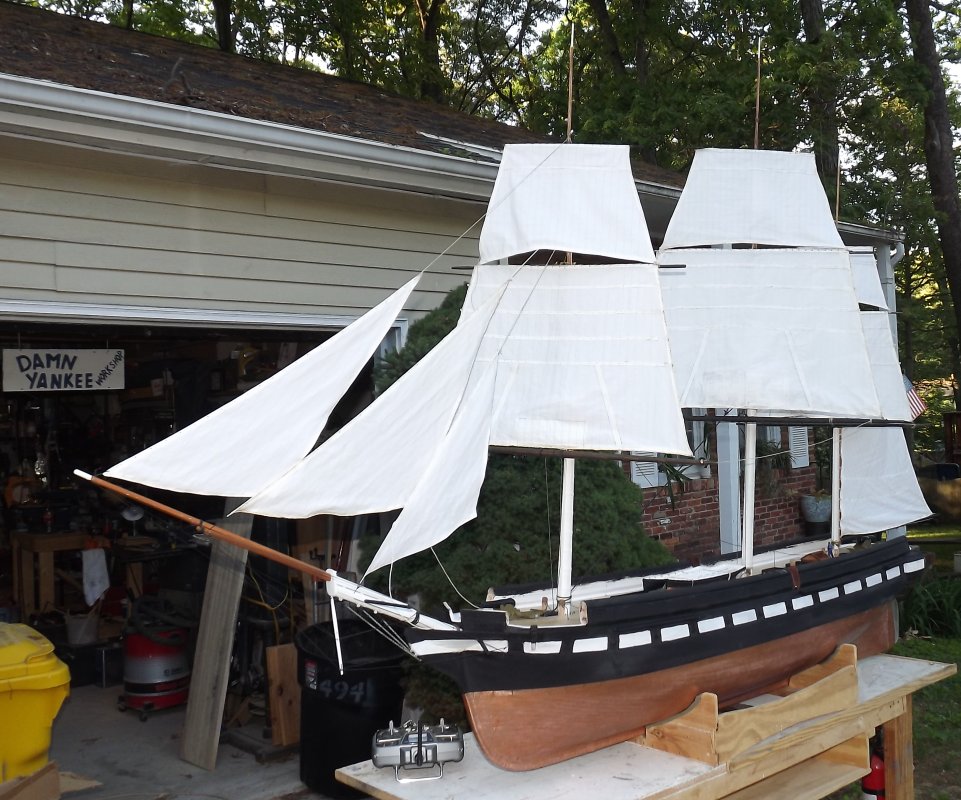

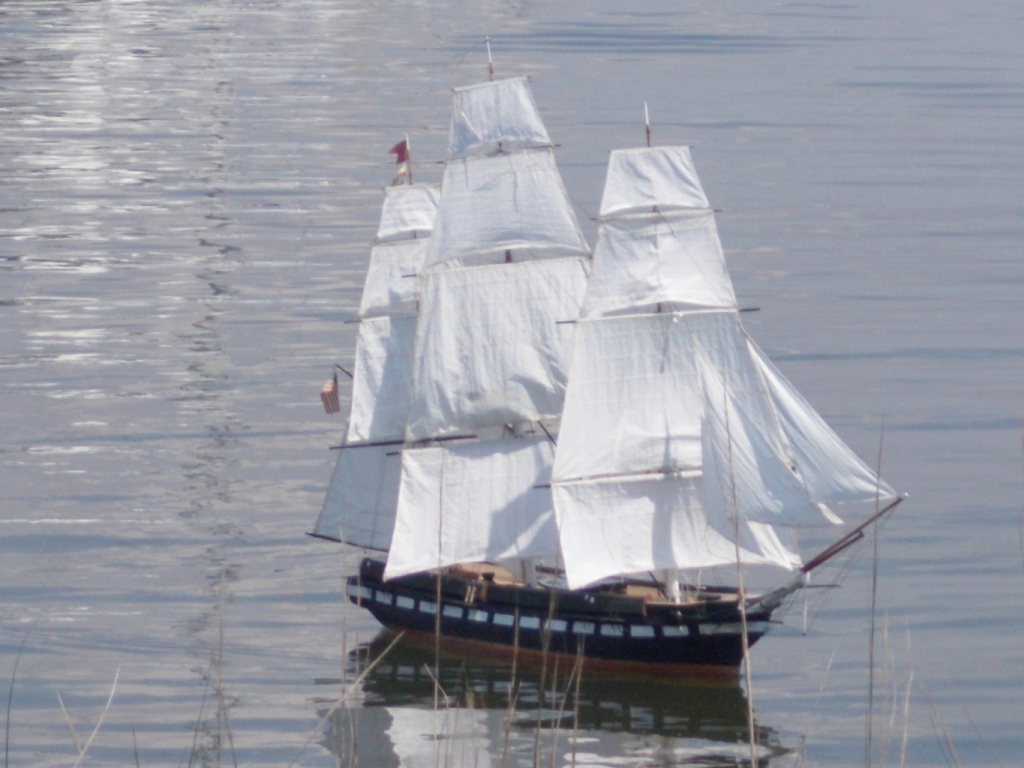

I started this model in 1999. It sat for something like 8 years before I got back to it. I've been working on it regularly, if not steadily since 2008.
On July 10th, 2011 it sailed on it's own for the first time.
File comment: First Sail

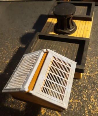

Constellation's been a little neglected as I built two other hulls; the 1:36 scale British frigate Macedonian of 1812 and the 1:20 scale Baltimore Clipper schooner Pride of Baltimore of 1981.
But recently the ship's launch was built and more work done on her 1st cutter, and the stern was given windows and decorations and really look much more "finished" now.

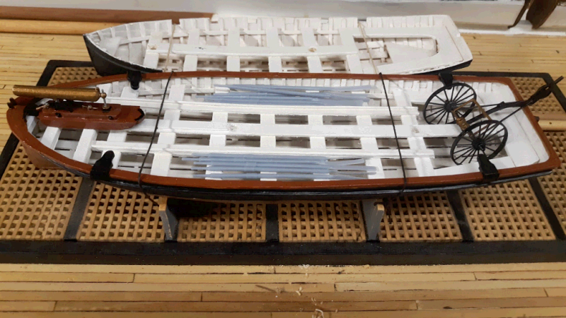

File comment: 1st Cutter and Launch worked on

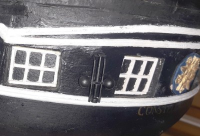

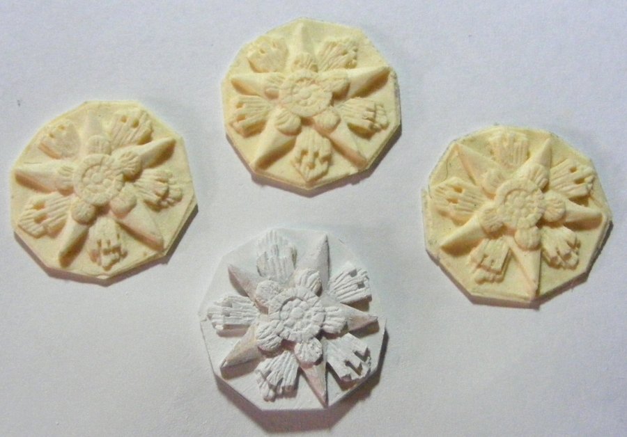

File comment: Stern decorations made and cast in resin. Each is slightly over 1 inch in diameter.
File comment: Stern windows and decorations installed.
The girl has a nice rear-end now. :)

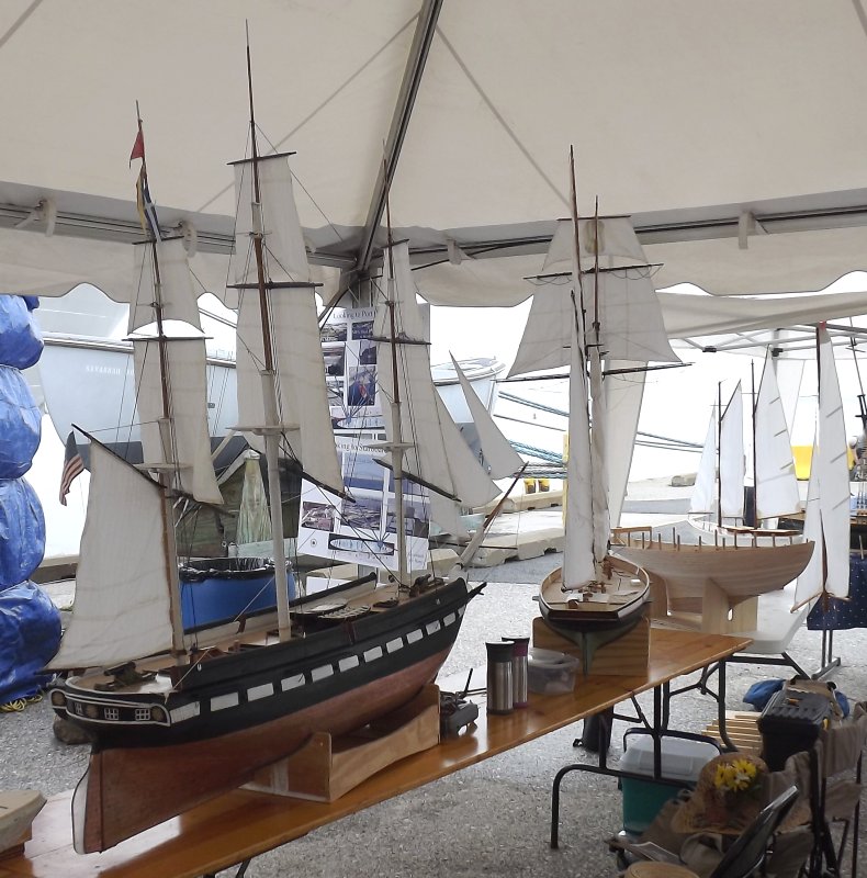

After 18 years my job decided they didn't want me anymore, so they cut me loose. I knew finding a new job in this economy, in my 50's, and without a degree wouldn't be easy, but I never expected impossible. Over 200 resumes, applications, and just going in and asking over two years, and not so much as an interview. Anyway, the mortgage people like getting paid, and when they weren't they took back their house. Needless to say, the models haven't had priority for a while.
Then I was asked by the director of the real ship if I would display Constellation at the Baltimore Port Expo back in mid-May (2014). I've never done a model show or public display of my models, but I wasn't busy, so I did it. They had a pool of sorts set up, and four or five modeler's showed up and sailed around in it. It was generally too shallow for Constellation and in her unfinished and jury-rigged state, I wasn't going to sail her in the open waters of Baltimore harbor with the breeze blowing around 15+, so the model stayed "anchored in the pool and I talked to folks that asked about her. One such person invited me to take her to the Chesapeake Bay Maritime Museum's Model Boat Expo two weeks later.
These folks hold this event every year and have a model sailing club on site - so it's run a bit more smoothly and their "pool" is deeper. There were also a lot more visitors to this established museum, then there were to a beat-up old dock out in Baltimore's dying industrial sections.
I took all three models; Constellation, Pride of Baltimore, and Macedonian, though only Constellation was capable of sailing. A lot of people were very interested and asked a lot of questions, mostly about my construction methods - since Macedonian's bare hull was there to show it off. It was quite enjoyable, a very nice museum that I hadn't been to since 1979, and only an hour down the road.

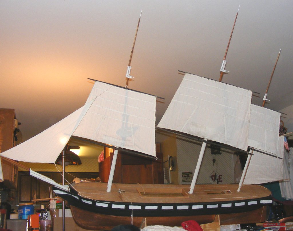

Inspired a bit, I went to work on an improved control system for the model's sails. The square sails winch servos would be mounted on slides that would allow springs to move the entire servo to take up the slack in the braces as the yards were adjusted. The arm-type servo got semaphore arms to control the jibs up on the bow, while the arm itself controlled the driver sail back aft. The whole operation was mounted on a single tray that fit better through the model's main hatch and is more easily accessible. Two such trays were built, one for Constellation, and one for Macedonian. Pride will get a different arrangement. The only problem is the new winch drums I made for Constellation were packed away, and I haven't been able to find them yet, meaning I may have to make new ones.
Looking at the pictures of Constellation sailing at St Michaels, I got the notion to make the last portion of her masts. With a lot of my tools still packed away it was a challenge to turn some square sticks into tapered, round spars, but I managed to rig her with her t'gallant poles.
My 12 x 30 shop is history now, but I'm moving into a 14 x 20 garage. That's 80 square feet less space, but stuffing 20 pounds into a 10 pound bag is what my life is about now. Everything is in, but almost nothing is set-up to use, though I just rearranged the place and made room to put Constellation on her bench where I can work on her. This was prompted by a friend that just built a 14 foot skiff and gave me his left over epoxy which I'm going to use to seal and glue the sub-deck on Constellation. This is a major milestone in completing the model, as a lot that needs to be done is waiting for the deck to be installed in order to happen.
As always, more pictures and details can be found at the model's Web Site
File comment: Constellation sailing with a Chesapeake Bay Ram schooner and other models at the Chesapeake Bay Maritime Museum in St Michaels Maryland
File comment: New servo tray with sliding winch servos for brace control (winch drums not shown) Semaphore arms control for-and-aft sails.
File comment: Constellation get's her t'gallant masts. She's leaning because she can't fit under the ceiling upright.

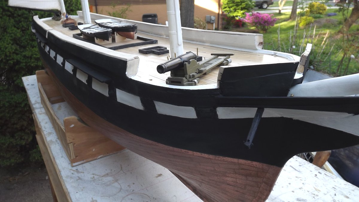

File comment: Target the slaver off the starboard bow!
File comment: Deck layout and hammock rails installed
File comment: Catheads installed

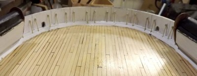

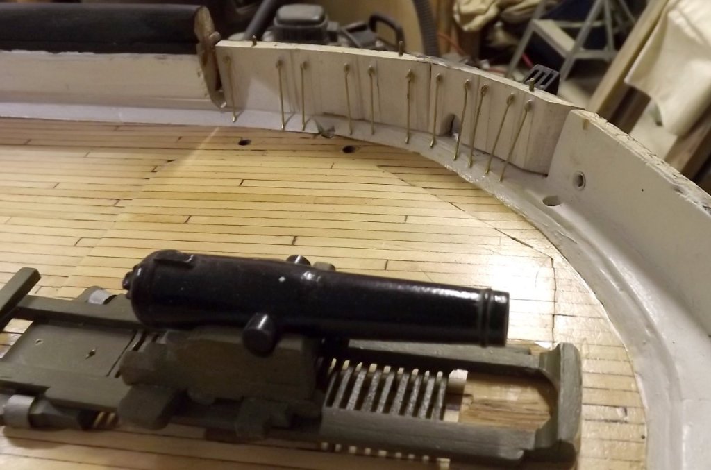

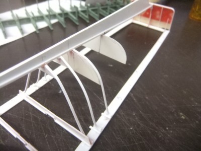

The aft "folding bulwarks" were built, the forward ones fixed to the hull, and the support rods made and glued in place. This should keep the fellas from falling off the deck. ;)
File comment: Inner framing clamped on
File comment: Outer sheathing applied
File comment: A coat of paint
File comment: Gluing on the forward bulwarks
File comment: Support rods on the forward bulwarks
File comment: Support rods on the aft bulwarks

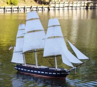

Under-weigh on the Miles River Maryland, May 2019
File comment: Under-weigh on the Miles River Maryland, May 2019

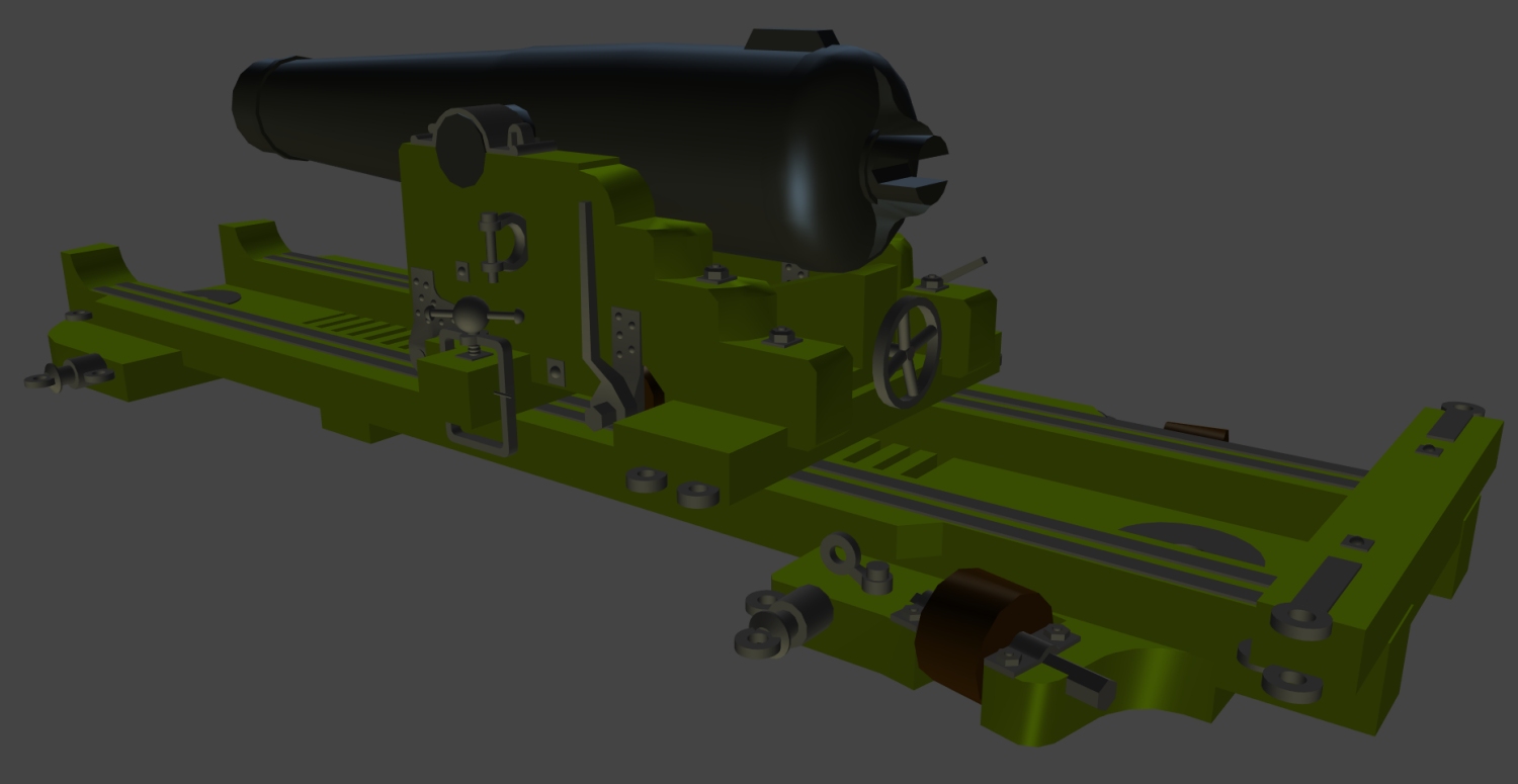

Got a 3D printer at last and I've been working on models for Constellation;
A boat howitzer for the launch, and new pivot guns with all their details modeled in
A few other items will get printed, such as boarding steps, blocks, carved entry port boards, binnacles, head carvings, pin rail balusters, crew figures, and whatever I can think of. All of this has to be modeled in 3D from scratch as there's little to nothing out there in 1:36 scale for this period of ship.
File comment: Dahlgren 12 pdr boat Howitzer on boat sled and iron field carriage
File comment: 10" shell gun on pivot slide

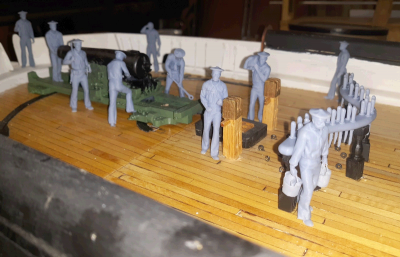

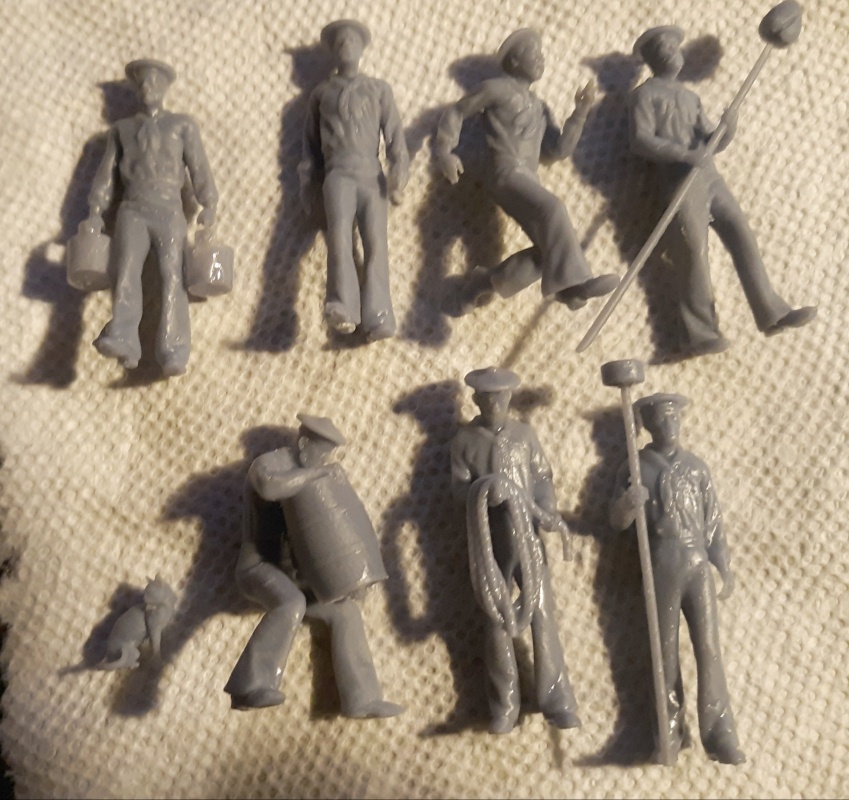

Printed, and printing some stuff for Constellation:

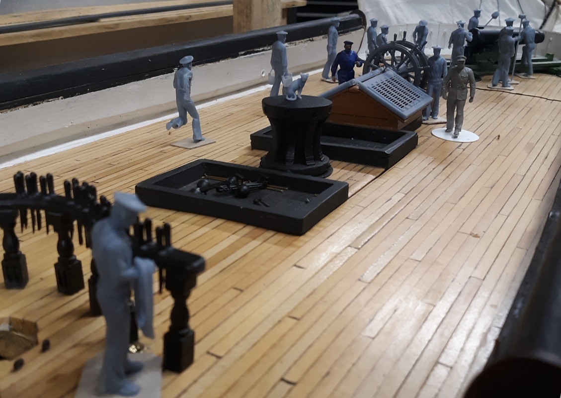

File comment: Two anchors and boat howitzer all in 1:36 scale

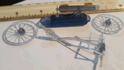

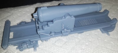

File comment: 1:36 scale Boat howitzer printed
File comment: Pivot gun getting zapped with UV to cure the resin

The first try was with the gray stuff that came with the printer. The supports separated almost at the start causing the flukes to deform.
The gray stuff was also heavier than this translucent resin by maybe a third, and the translucent resin is noticeably stronger.
File comment: Deformed first attempt
The wheels are for a friend's model schooner that's 1:24 scale-ish, with Constellation's boat howitzer, and all four anchors.

I started painting the guns by brush, but I think I need to find my airbrush.
File comment: A smattering of paint
Made a rail with pivot mounting points for the boat-howitzer in 3D.
Here's the launch and it's gun all painted up and the gun glued in place. The carriage will get tied in.
The gray sticks are oars, and there's some spars, sails, and rudders to put in both boats yet.
File comment: Launch and cutter approaching completion
I modeled the pin rail stanchions, or pilasters, a while back, but printed new ones in the strong resin. Then I modeled the rail with the belaying pins in one piece.
File comment: Ivan models the foremast pin rail with 3D printed rail and pins, and stanchions, or pilasters.
File comment: The mainmast pin rail with 3D printed rail and pins, and stanchions, or pilasters.

Printed more crew figures, basically the ones that didn't get printed, or didn't print correctly with the first batch. With Ivan and his comrade from the Soviet Naval Troops kit, this makes 19 and a cat, out of the 40ish I intend to have.
The skylight got new panels with more detail and better sized.
I modeled and printed the Night Lifebuoys to hang on the stern. I got drawing of the ship back in 1999, showing the ship in dry dock in 1859 that showed these things, but I had no idea what the drawing was intending to show (I doubt the artist knew what they were either). I finally figured out what they were and made the best models I could with the details I had.
I modeled some studded chain for the anchors and got them to print without bonding the links together. All four chains, and a shackle to attach them to their anchors are printed and painted.
File comment: More crew printed, some are reprints of one that didn't turn out right the first time
File comment: One of a pair of Night Lifebuoys that will be mounted on the stern
File comment: New printed skylight panels
File comment: Some of the new crew drilling on the aft pivot gun with Stella the ship's cat on the catstand, I mean capstan
File comment: The model's becoming quite lively even with half the figures I intend to put aboard.
