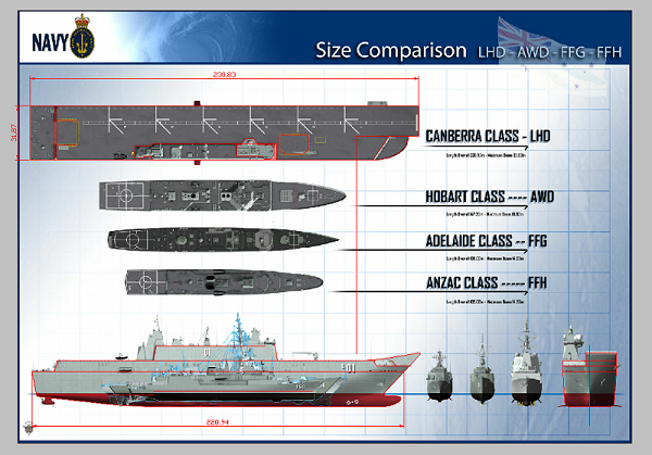

Source information.
File comment: Source plan, elevation and cross-section.
File comment: Source long-section.
File comment: Source deck plans.

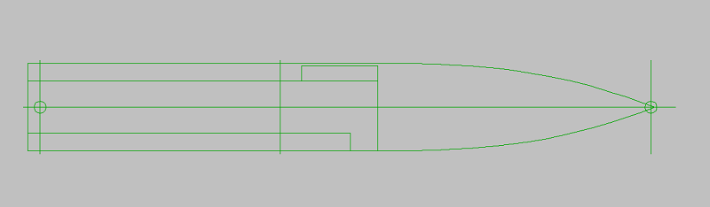

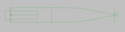

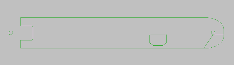

CAD model.

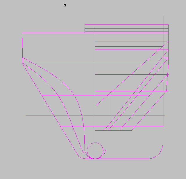

Progress so far on the frame profiles. Still some work to do getting the bow end shaped properly. Much of this is going to be guess work.
PostPosted: Fri Jan 03, 2020 9:27 am
Joined: Sat Dec 21, 2019 7:54 am
Posts: 100
I hate the bow of this ship :mad_1:.
The previous image looked so much better but unfortunately the actual LHD bow doesn't have those nice curves. It's pretty much slab sided everywhere above the waterline. The images I used to get the generate the deck plan profiles from don't match the hull profile at the deck elevation that the plans represent. For example the plan which appears to represent the floor of the well deck (just below waterline), a level at which when a line is extended to the bow should end in a nice vee, actually ends with a profile of the bow bulb which is much further below the waterline.
I suppose the upside is that the rest of the hull in cross-section is very simple :cool_2:.

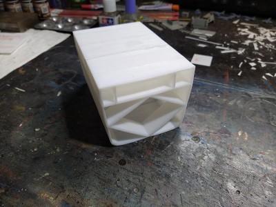

PostPosted: Sat Aug 20, 2022 6:41 am
Posts: 100

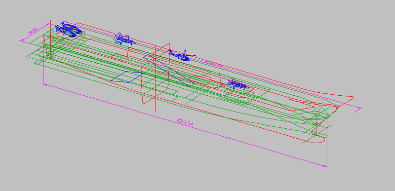

So I have been experimenting with 3D printing. I created solid images in CAD, exported to 3D slicing software, and then printing using HIPS filament. Dimensional accuracy is not the best but could be suitable as a base but lost of filling and sanding will be needed. The best part about using HIPS is that I can glue styrene sheet to it using the usual modelling glue. I may continue to try and build the rest of the ship using the same method or maybe 3D print frames only and then skin the ship in styrene sheet. Though I am leaning towards a full 3D print build just for the hell of it.
