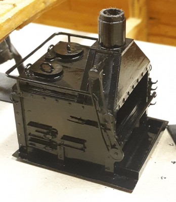

A stove for Macedonian
File comment: 1:36 scale Brodie stove for a 38 gun ship
File comment: Stove with a coat of paint

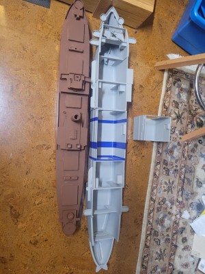

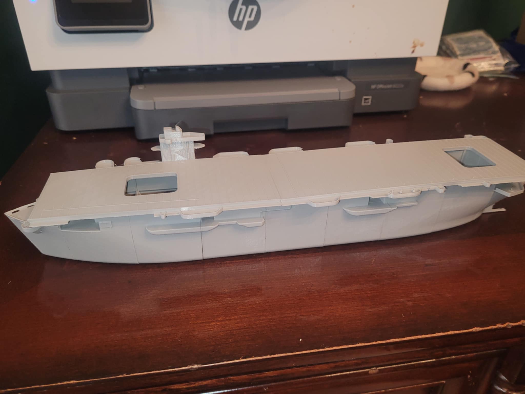

I've taken up the job of getting some cargo ship work done for a buddy - he wants a conversion of the Liberty Ship to a Park ship - so...here's what we ended up with:
https://www.thingiverse.com/thing:6873845
Not perfect, but close enough for his model railroad setup. It's a modification (with permission) of the Johnbuttery Liberty Ship model.

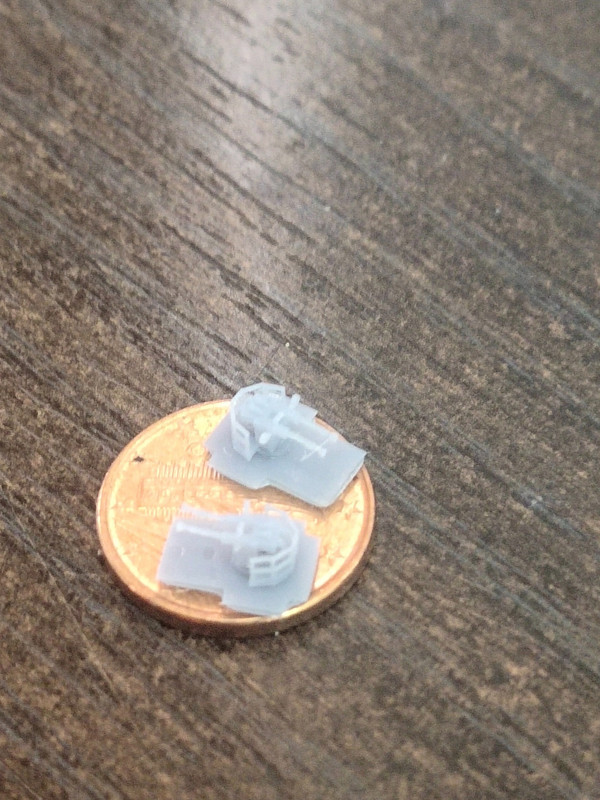

Next up is the 20mm Oerlikon twin mount that I put together. Looks pretty much the part - I'm pleased.
https://www.thingiverse.com/thing:6869601
Then - I took the other Liberty ship file that's on Thingiverse from Jaberwok and modified that into a pretty close match of HMS Puncher:
https://www.thingiverse.com/thing:6869595
Currently printing the Puncher.
Note - in the picture below, the Park is printed at N Scale - 1/160, and the Puncher is printed at 1/144.
File comment: Draft print in 1/350 scale
File comment: Puncher and Park side by each.

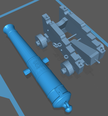

Most recent parts for a rag-boat ;) A 1:36 scale RC model of HMS Macedonian c.1812
File comment: 32 pounder Carronade
File comment: Model in the slicer
File comment: Blomefield in the slicer

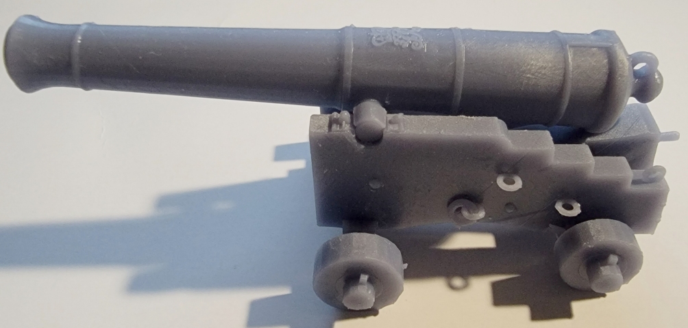

File comment: test-print of the carronade
File comment: test-print of the Blomefield

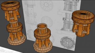

Iceman 29 wrote:
A lot of facets on the barrel, which is a shame. Setting up the 3D drawing programme? :cool_2:
That barrel was done by someone else, and the cartouche was lifted on the surface, draginf some of the geometry along. I made a fresh barrel and laid the cartouche into it separately. It's still relatively "low-poly" but it's better. I changed out the model on Thingiverse too
File comment: 18 pounder
