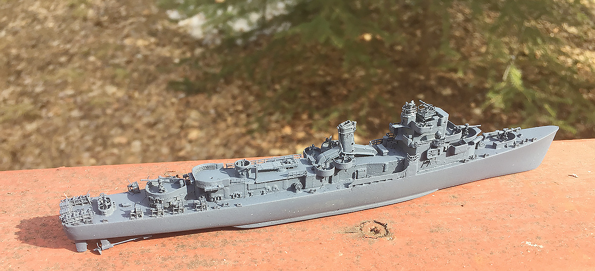

1:500 DE England:
Basic hull with two superstructure and three tubs added.

Added numerous small bits and pieces: Depth cargoes and K guns, sky Lookouts, director, tubes, small hatches etc. Time to start base color coats soon.
Current progress. With a model this small many pieces are very delicate and have had to be replaced. The latest was the props which extend below the bottom of the hull and I mistakenly set it down and squished the bottom blades! Still working on the aft 01 level 1,1 quad. I was able to modify Hank's larger scale barrel assembly but still working on the carriage.

Last night added a probably temporary stand to the hull. Using my heavy armed scriber on a glass plate,I marked the waterline, masked and painted the hull bottom. The boot top remains to be added. I used my Circuit style machine (Cameo) to cut black pin striping, which produces something much like Tamiya tape. I have used this before on HO locomotives for pin striping and it might work well for the boot top rather than paint. remains to be seen. Only the part wrapping around the stern where there is some angle would need a different treatment, Once the hull is painted some of the details such as anchors can be added. As an example I popped a depth charge rack off of the stern while masking. Fortunately it survived and I found it undamaged.
I have printed a mast, but these are too flexible to withstand rigging. in the past, with larger models one can print them hollow and reinforce with piano wire. Too small in this case so I'll make the mast bones from brass wire and add printed details. Main deck life lines, dunno yet. I did make a DE at this scale once upon a time with steel wire stanchions and an old girlfriend's hair but that one was a styrene card hull which drilled easily, the printed hulls do not.

Painted the deck, added cable reels, chocks and bitts, inclined ladders, anchors new props and working on the mast. The mast is mostly printed with a piano wire yard arm and a piano wire lower extension which penetrates the 02-03 levels.
