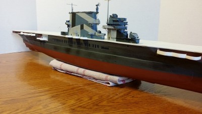

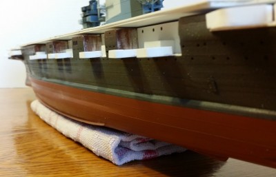

The hull has been primed and is nearly ready for paint and further detailing. The red has been smoothed and the black will be shortly. As stated earlier, the red is rattle-can Krylon brand "Red Oxide", a dead ringer for US Navy 121 red oxide, and will not be painted further, just mildly weathered. The portholes on the hull will be re-drilled using a pin vise since the primer has partially filled them.
Straking detail is visible in the photos.

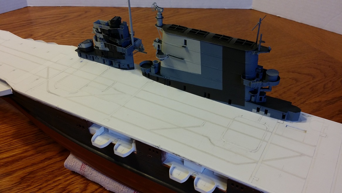

The flight deck (and funnel and conning tower) has merely been placed onto the hull for photo purposes. When the boat bays and AA sponsons are complete, the flight deck will be cemented to the hull. To ensure that the surface of the flight deck is perfectly flat, it will be fixed inverted to a flat surface then the inverted hull will be placed down onto it and shimmed where necessary. Perhaps it is more accurate to say that the hull will be fixed to the flight deck.

File comment: Starboard side. The bottom edge of the black primer will form the boot topping. Photos of the ship indicate that the plating of the starboard stability blister was all butt-welded, unlike the rest of the ship, which was riveted. Therefore, the blister is very smooth compared with the rest of the hull, which is straked.
File comment: Port side. Bilge keel is visible. Plating pattern around the bilge keel is consistent with photos as is the slight variation in porthole height just aft of the nearest boat bay. The watertight hatch visible in the side of the hull was common to both Saratoga and Lexington. Through this hatch on Lexington, electrical cabling was passed supplying electricity to the city of Tacoma, WA for a month beginning in December, 1929. Notice also that the portholes inside the boat bay are much larger than those on the hull's shell plating. This is consistent with plans and photos.

File comment: The floatplane tracks are visible. Photos of the ship in 1944 indicate that the original slot in the center of the floatplane tracks was eliminated, thus the model's tracks are solid.
