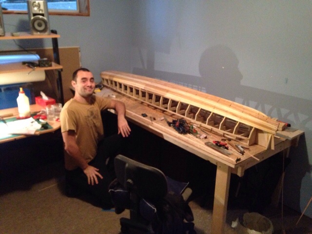

Hi there everyone!
I am new to this forum however I have been building Shipmodels on and off for a good portion of my life. My father is the main model maker for The Vancouver Maritime Museum, and so I have had models in my life ever since I was a small child, and have been lucky enough to have my dads wealth of knowledge to draw upon. Last summer my father and I were spending some quality time up the coast of British Columbia on his boat, when we came up with the idea of making a large scale RC model that we could take with us on our annual boating trips. So after a bit of thought I took it upon myself to build this model in the free time I would have over the next year. The ship I decided on is a World War 2 German S38 type Schnellboot- the S62, built plank on frame in 1/15 scale as she looked in 1942. The original S62 was 34.94 meters long making my model a little bit shy of 8 feet in length. She also had three 2000hp Mercedes Benz MB 501 engines that propelled her at 40 knots, making my scale speed somewhere around 8 knots. For power I have not yet decided what I will be putting inside her, but I have made room for at least six 12v 7.2 aH batteries. If anyone has any ideas on some good remote systems out there I would be most grateful as I am having trouble finding what I need (separate throttle control on all three motors individually, plus the usual stuff).
As of right now I have been working on the model since September ( mostly on weekends and when I had free time ) and I am hoping to finish her sometime in the summer. I will continue to update you guys with this build, and am very interested in any feedback/suggestions you may have!
Happy modeling!
Theo P.
File comment: Initial stringers
File comment: Starting the planking
File comment: Rough sand
File comment: Good scale view with meter stick
File comment: How it looks right now after epoxy fiberglassing. Lots and lots of sanding, rudders with servos, keel, and prop shafts and then painting time!!

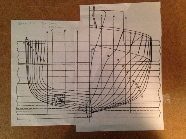

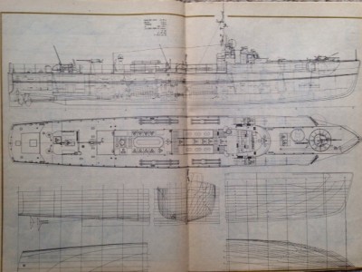

File comment: Drawings
File comment: Form plan
File comment: Room left for launch mechanism
