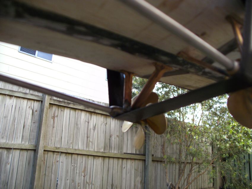

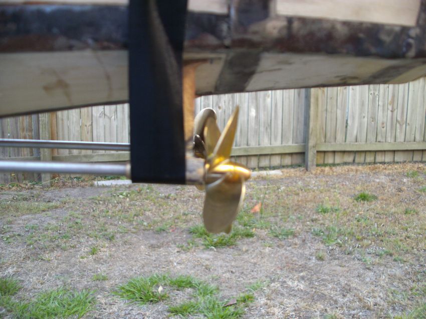

Hey all,
Had the opportunity to use a mates lathe yesterday and made up the prop shafts and the bearings, then made up the supports and soldered them together today. I have taken some pics and in the pics you will see the black tape holding it in position. :smallsmile: It will be removed.
There is more work to do on the supports as these are just filed, not sanded.
File comment: View from inside, the shafts will eventually go into a gearbox and be driven by 1 motor.
The props were purchased from Raboesch via a local supplier.
Will be making the rudders soon too.
I will be plating the hull with aluminium before this lot gets attached permanently.

I would add support bearings about halfway down the exposed shafts, right about where they pass through a frame. Good work on the strut bearings!

I am in two minds about that.... I was looking to mount a bush on each side on that frame where you see the shafts protruding through and about the middle between the frames where the shafts end then they run into the "gearbox", or, just run directly into the gearbox and have it closer to the bush running through the hull (this is space dependant). Of course, will have to look at the motor situation and may eventually go with 2 motors instead of just the one, just smaller ones and get them nice and close to the bush and run a couple of universals so I can level the motors a bit. Weight is my enemy and I just have to look at every gram I build into her.
Any thoughts?

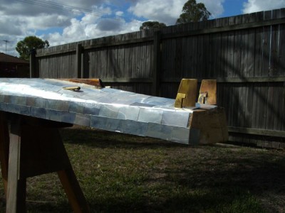

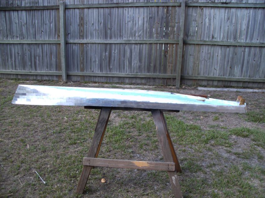

Been busy since I last posted, have made the rudders and set them in and plated half the ship with aluminium plates. I utilised the process as described by ARH for the USS Moffett DD362 viewtopic.php?f=75&t=8912 . Very informative build.
Anyway, back to the Mitscher, here are the pics.
File comment: The rudders attached and a little plating done.
Not an overly great pic of the rudders, if anyone wants a closer shot, let me know... anyway, rudders were made from 3mm brass plate and the post made from 6mm plate, all filed down to aerofoil shapes and pinned through to enable them to be turned. :thumbs_up_1: At least they will work.
File comment: Lot more plating and the rudders again.
Better view of the rudders here... my soldering, well, yeah, need more practice.
File comment: Full length shot
Here she is, one side done, ( except for the keel), all the plates measure 26mm x 52mm, going by pictures and a guesstimation of men versus plates on real ships, I cut the plates to represent 6'x 12'. Hope that is close to the real thing.

hello,nice work on the rudders and plating,what type of glue did you attach them with,i used contact cement tricky because one could not move them once they were put on.it is a very time consuming job but the end results are worth the effort.

I used the Selleys Vertical Kwik Grip contact cement. It is a jelly like version of the normal contact, but I read on the tin at the bottom that you can wet stick things. This is good for small items, so I would apply the glue and immediately start putting the plates on and then use copious lengths of tape to hold the plates down. I could move the plates around for up to 10 minutes before it was permanent. I would leave the tape on overnight and then peel it off. So in 2 days I did one side in this manner. That 500 gram tin cost me about $15 at Bunnings and I have used about half a tin, so hope I will finish without having to buy more. :smallsmile:
If you desire, when I am doing the other side, I will take some pics of the process, just let me know.
