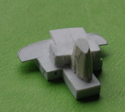

Meanwhile i started working on the superstructure by tacking the captain cabin and owners' cabin under the boat deck. I build my superstructures by building down from the deck above it using styrene strips and this one was an easy start.

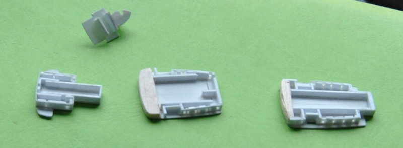

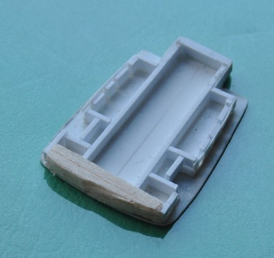

The other two levels have a curved front which leans back slightly. This is difficult to get right using styrene profiles so I have used two pieces of balsa in front which were roughly sanded in shape. I am now building and detailing the straight (back) parts and will return to the front of the superstructure levels when I have paintedn and glued the back parts together.
