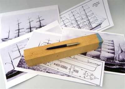

After 6 weeks rest (modeller's block - lack of interest), I have now picked up the modelling tools again commenced a miniature of the British four-masted barque Pass of Brander. This steel hulled sailing ship had a career of 26 years, initially as Pass of Brander and latterly as Bengain. She was sunk by enemy action in 1916.
The model is to be full hull with furled sails, mounted on brass pillars inside a homemade acrylic display case of my own design and construction. During my break from ship modelling, I drew up plans of several sailing vessels, the first being Pass of Brander! The hull is 8.70 inches long on the waterline.
Bob

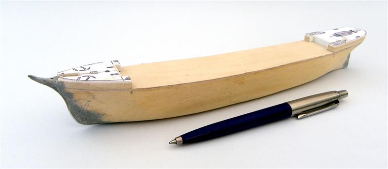

I am now just under five hours into the build and the hull shaping and smoothing is almost complete. I don't have the patience displayed by most model shipbuilders, and that is one of the reasons that I went into miniatures! Incessant pouring rain is at present preventing me from making a start on the display case, as I normally do that outside.
Bob

PostPosted: Mon Oct 01, 2012 2:00 pm
Posts: 437
Thank you very much to share your technique, all your models look very nice (subject chosen and modeling).
Which wood is this, do you have a machine to cut it?
You're sanding by hand or with a kind of dremmel or else?

Location: Lancashire, England
The wood is obeche. I cut the basic hull with a small hobby bandsaw. I smooth it down with files and wet & dry paper, all by hand. The filler at the ends is car filler paste that dries hard in two or three minutes.

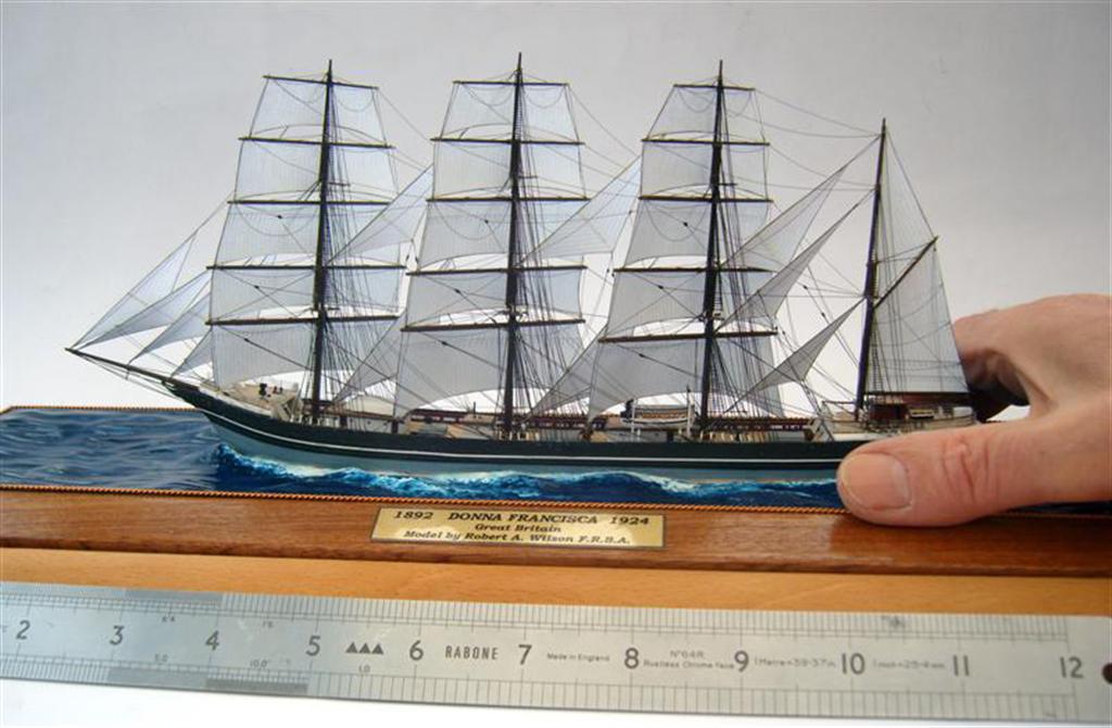

It is just the right size for me. The bigger they are, the more difficult I find it to build them. On this scale, there are no knots to fiddle with, and all the masts, spars and rigging will be metal. The rigging (including the ratlines) being fine copper wire that I find easier to deal with that thread.
Attached is Donna Francisca at the same scale.
Bob

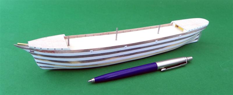

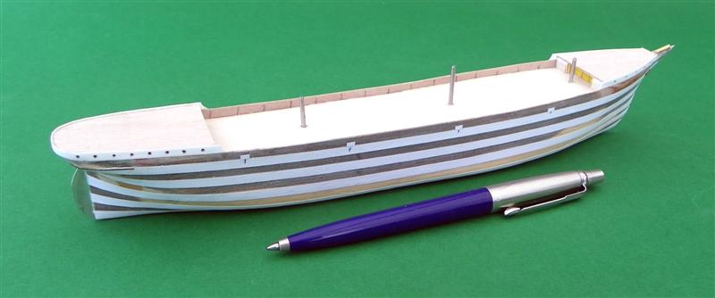

I have made some more progress and the hull is now plated with paper plates and ready for the paint, after which it will begin to look much better.
Bob

are the plating runs gummed paper?--self-adhesive..(!?)
oar they plain paper--if so what are you using glue them to the hull?
I guess it all gets sealed witha coat of varnish prior to paint?
or is the paper such a tight lay that paint will not lift fibres of the paper
Intrigued!

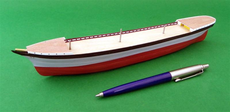

The plating is just 90gsm writing paper glued on with white wood glue. The red underwater colour was sprayed on using red oxide primer for Halfords car accessories. The grey and the black were hand painted using water-base acrylic paints (Chromacolour). The sharp paint lines were obtained by sticking very thin strips of painted paper masking tape over the junctions. The bulwark panels were made using the "box drawing" font of Microsoft Word. They were coloured in on the computer.

PostPosted: Fri Oct 12, 2012 3:08 am

Posts: 197
Yes, they are about 1mm wide. I stick a piece of paper masking tape on a scrap piece of acrylic that is longer than the hull and spray it the required colour and then cut off the 1mm strips as required.
