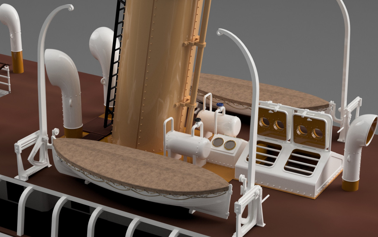

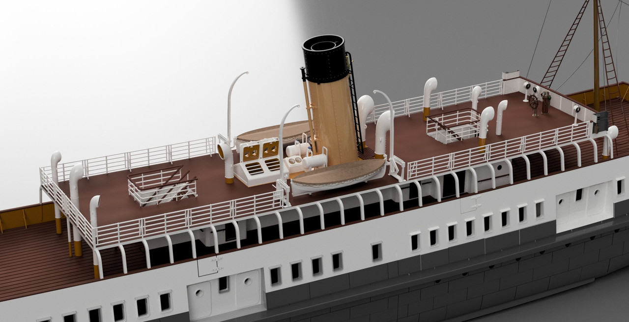

Not much today, I did a bit of scale 1 auto mechanics for a change.
Drawing of the gratings near the funnel and the engine room skylight which is not finished.
There are still two tanks to be made in that corner, one fresh water tank (kitchen taps, cabin) and one sea water tank (for flushing the toilets I suppose), then the galley skylight.

Any idea why there was a wooden grating at the base of the stack?
The stack and general marine architecture remind me a bit of the Hong Kong "Star Ferries", though they are open and optimized for a more tropical climate. Though diesel powered, not steam.

The engine room skylight.
Thanks to the photos I found recently I was able to reconstruct and modify it in its version that I think is close to the original.
I represent it open, because it must have been open when the boiler was under pressure to evacuate the heat from the engine room which was not well ventilated.

I am following this with really great interest--and your desire to get things as right as possible
is a strong drive.( and mine by proxy! )
ref the grating at funnel base ;
by being elevated and thereby allowing the deck to dry, could it be to prevent the build up of algae and slippery surface on the steel deck in that area
the ' shape and layout of that grating would lead me tho reckon it is so as to give secure footing for the guys coming down off the funnel ladder,
and give secure traction to feet when when trying to rotate the cowl vents...
...as you are still at the 3D stage with the open hatches,
That excellent photo of the man ( scale ) and the hatches is a really great find !
may I suggest first ( this might be rather more work--so maybe not worth it to tighten the radius of the hatch corners?
and ( hopefully easier ) to halve the thickness of the (safety cross-bars on the hatch ?
On your render--compared to the photo--they look too chunky to my eyes
Looking at the chap, the photo suggests these to 7/8" - 1" in real life approx ( 22-25 mm )
on a finished printed actual model--the cross bars on the engine room hatches will stand out against the
dark background of the ' hole' and white ( especially 2 layesr of paint! ) and that might make them too dominant
and look over-scale in my view

Indeed Jim, but the skylight is very small at 1/200, the cross bars are 0.25 mm in diameter, the extreme limit of resistance to tearing for the resin during printing, not for the printer.
The drawing of the 3D parts could be much finer, but I have to take into account the printing scale for each part and be very careful not to go below the tolerable printing limits. It's frustrating for the designer, but that's the way it is.
I'm certainly not teaching you anything Jim, it's also like that to inject it and even worse, the more you reduce the size of the vessel the more the parts are simplified, sometimes coarse. There's the simple example of ship railing that become huge on some models at very small scales, better not to put them sometimes, even in PE which has its limits too.
It's too late to change the radius of the panels, I found this picture late after I almost finished the drawing, difficult to go back sometimes with Fusion 360 without disrupting everything ...

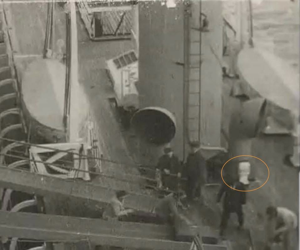

I had spotted this small ventilation duct on the first photo, the other photo pointed me to its shape, a shape resembling the Olympic class but much smaller.
You can also see that the air sleeves were not as high but with a larger diameter than when they were remanufactured during the restoration in Belfast.
On picture two, we see the new position of the mast which has been moved compared to 1912, we also see the covered walkway and probably a radio antenna.

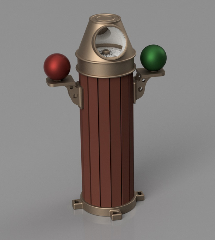

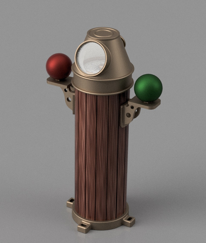

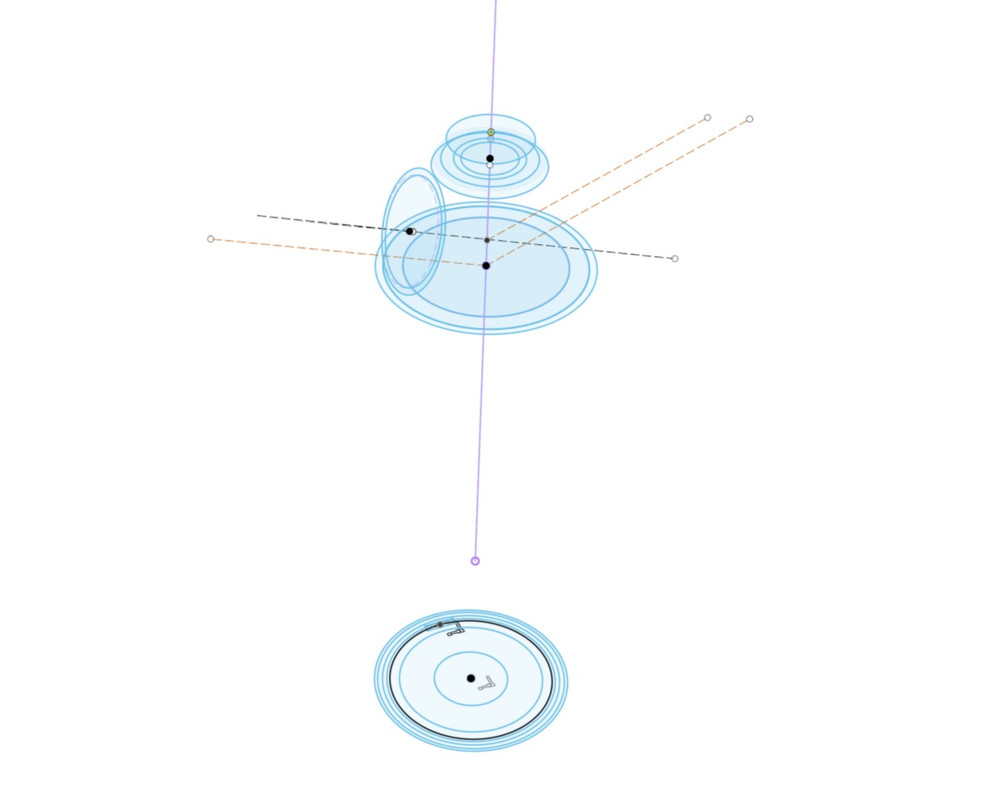

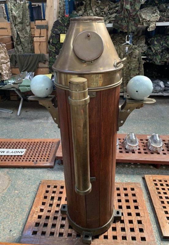

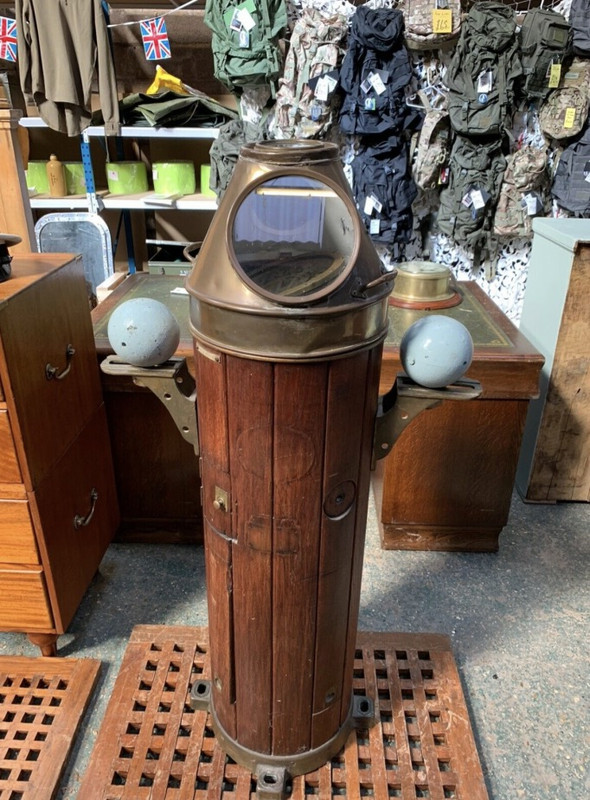

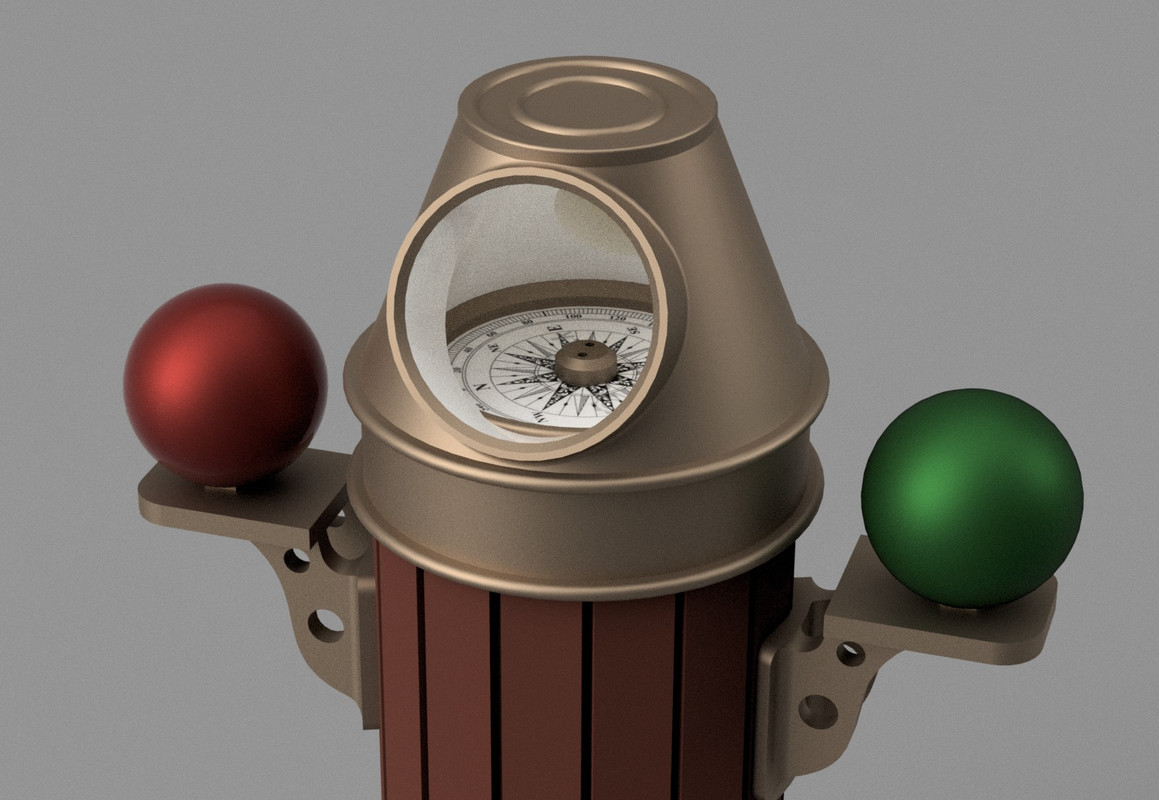

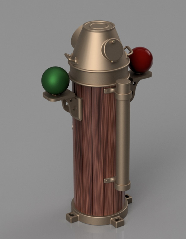

I started to draw the compass, there are still a lot of details to add.
Pascal
PostPosted: Tue Jan 12, 2021 12:25 pm
Posts: 1885
Location: Bretagne, France

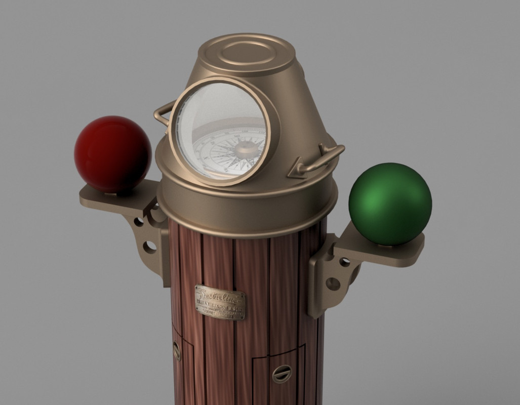

This drawing is coming to an end.
I used these two images as decals.
https://www.canstockphoto.fr/rose-vent- ... 19880.html

It was fun to draw this compass, I had a good and beautiful period model in pictures.
I'm going to tackle with pleasure the wheel steering, and the spare lanterns of the navigation lights these next two days.

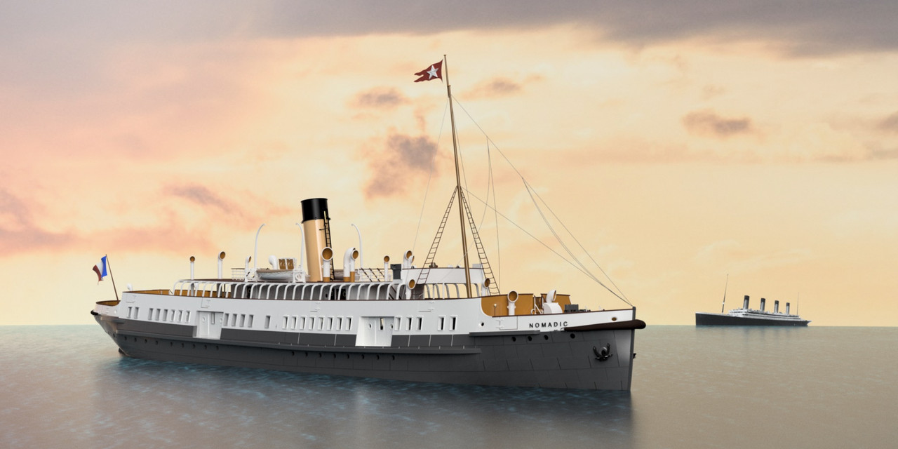

Tonight to motivate myself on this long and difficult double project, I made a little diorama of my own. We could call this painting:
"SS Nomadic waiting for the RMS Titanic, coming from Southampton, on Cherbourg roadstead on April 10, 1912 at sunset."

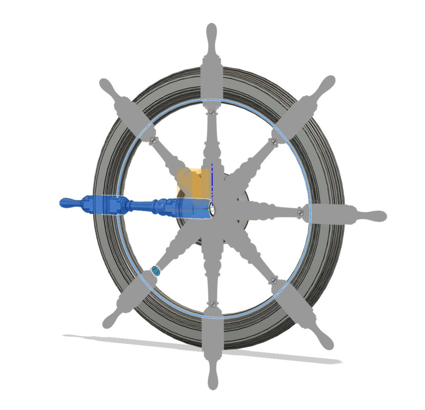

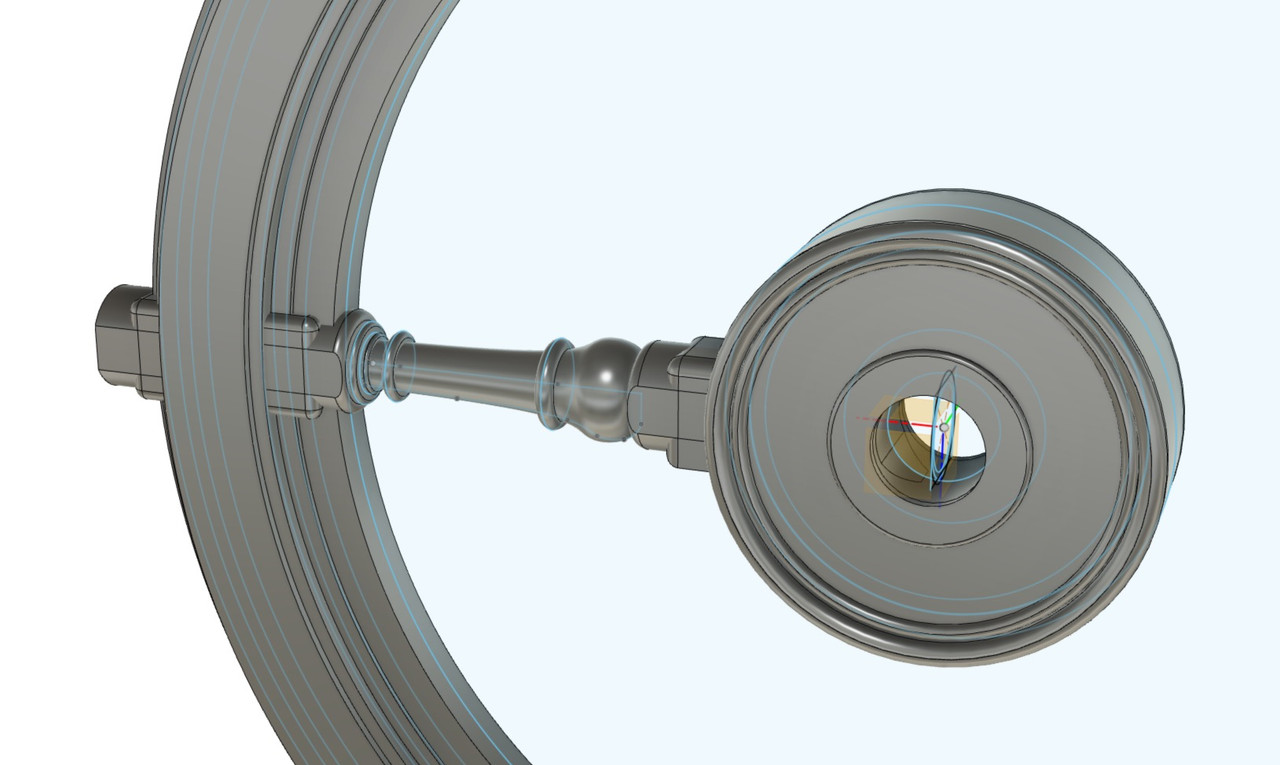

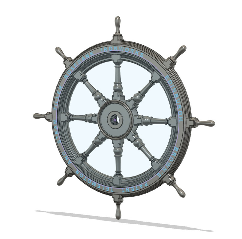

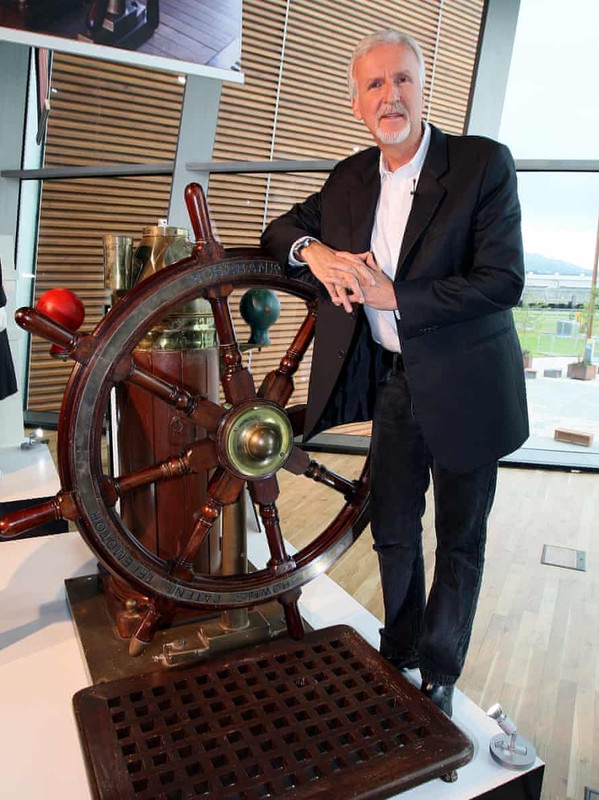

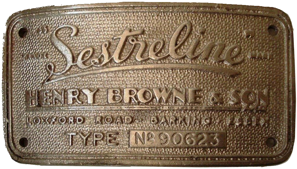

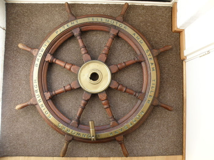

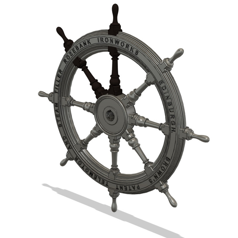

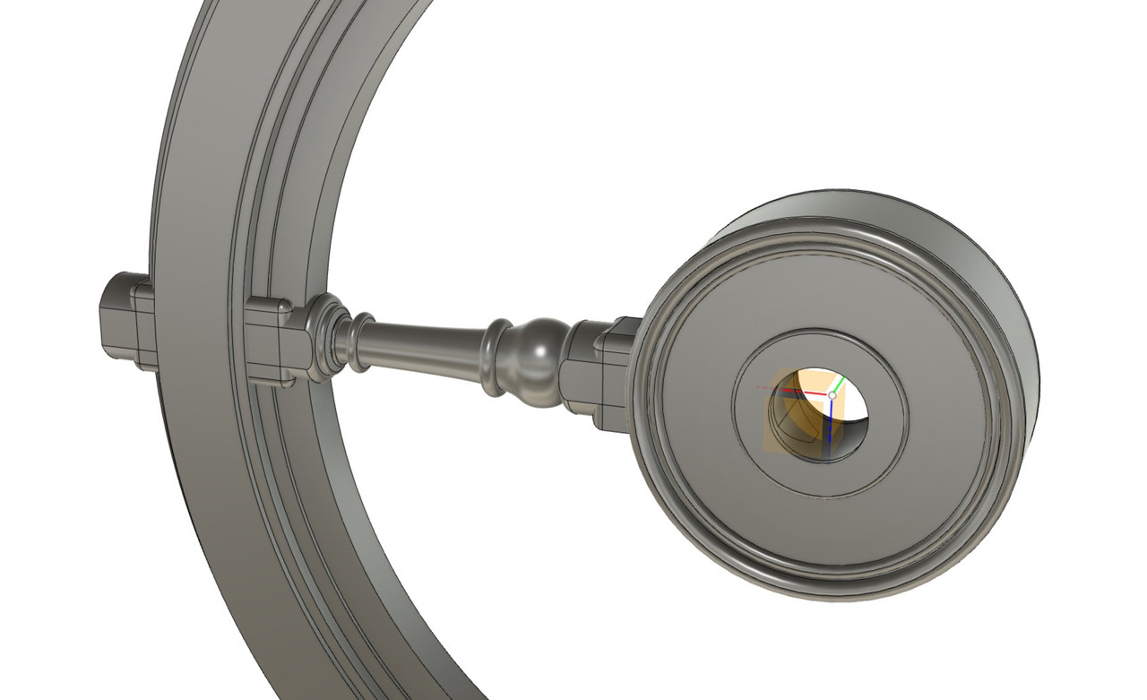

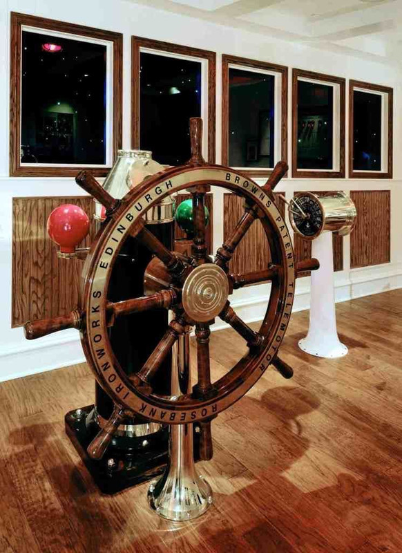

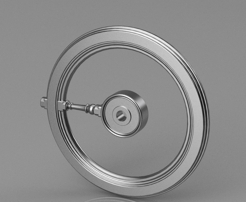

Drawing of the steering wheel:
I was inspired by this picture, the same maker as the Titanic probably:
The one in Belfast which is not the original;

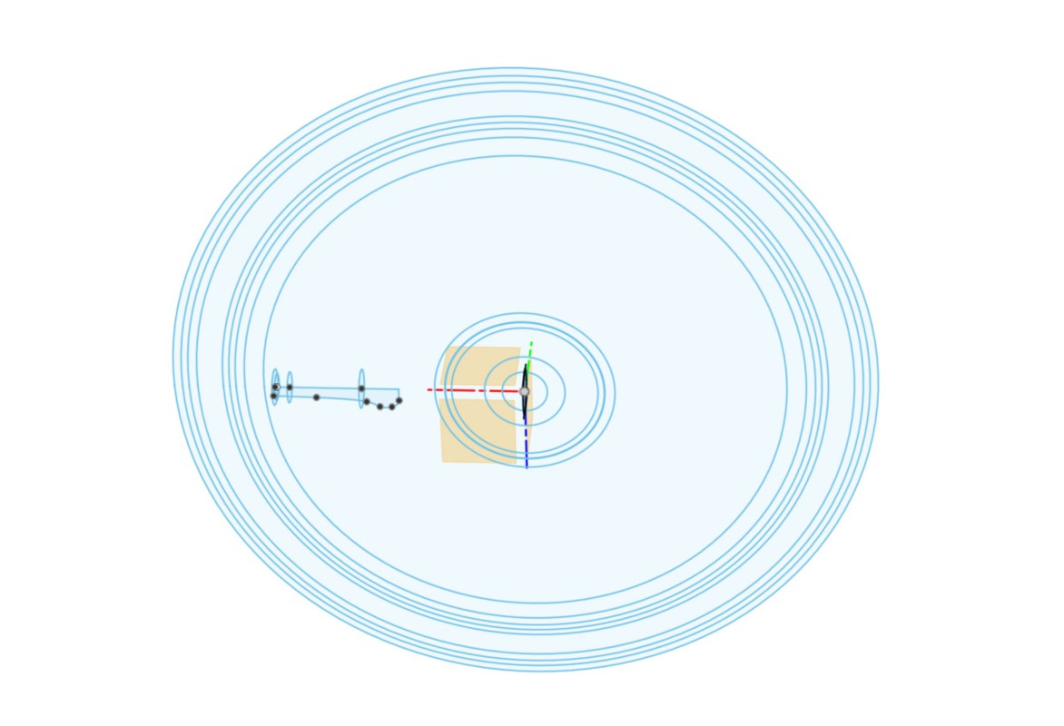

The unfolding of the drawing. It's quite simple to do, 3 hours and 30 minutes of work. The texture of the wood has to be adjusted.
It is better this way, to be refined with the compass.

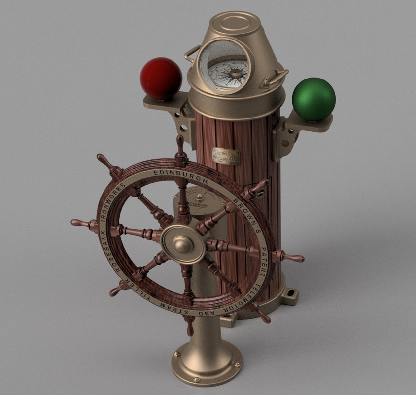

Finished steering wheel. Tomorrow it will be the turn of the navigation lights lanterns.

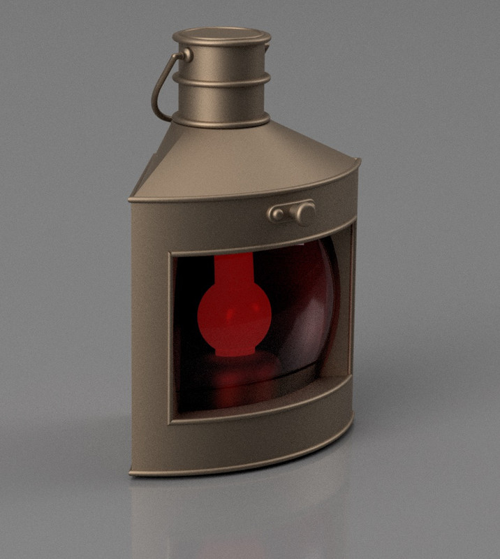

Port and starboard navigation lights are completed.

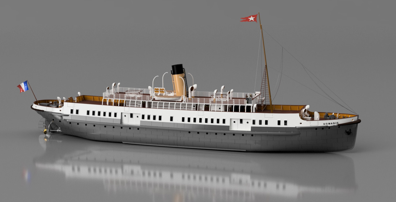

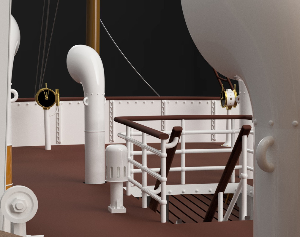

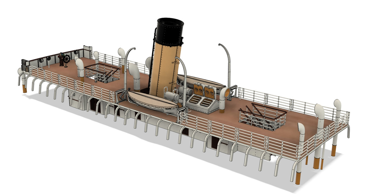

The drawing of this ship is almost finished, there are still some details to be created, navigation light of the foremast, small mast and aft navigation lights, some pulleys for the lifeboats, and the tracing of the upper deck planking, still a small day to complete these details after a few hundred hours of drawing since the beginning of November 2020, that is 2 months of design working on it every day.
There are a few flaws, but I'll deal with them. This is my second ship entirely designed in 3D and printed in resin. The next one will probably be much better, the experience gained will avoid me some mistakes.
Today I put the handrails, and the batayolles very particular to this ship with 5 bars, impossible to find in the trade. So I'm going to print them at the finest, 0.3 mm, it's going to be fragile but conform.
