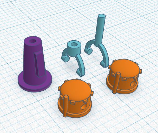

New skegs are off the printer - also designed some search lights.
ICBM Address: 44:78N 063:63W

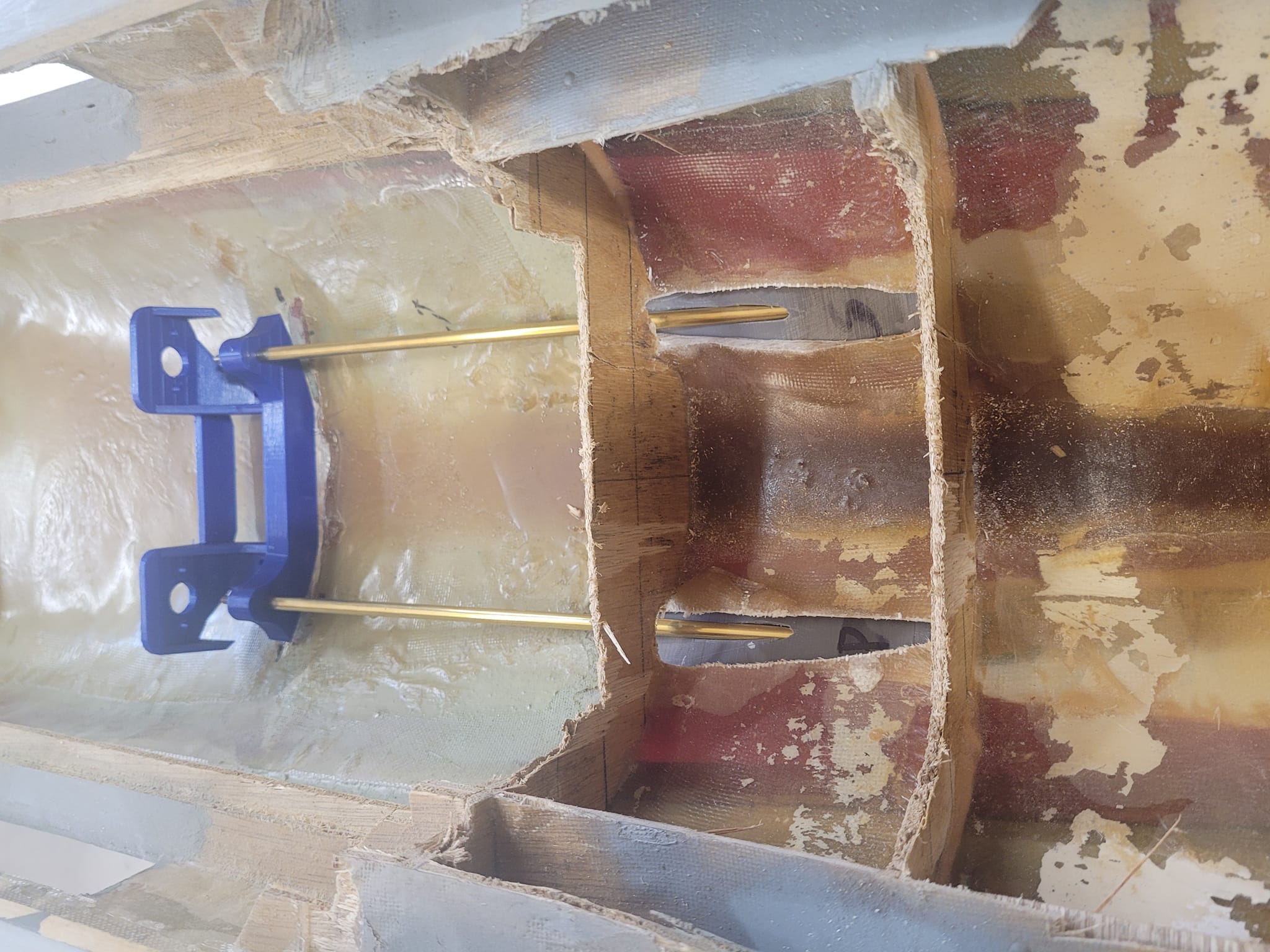

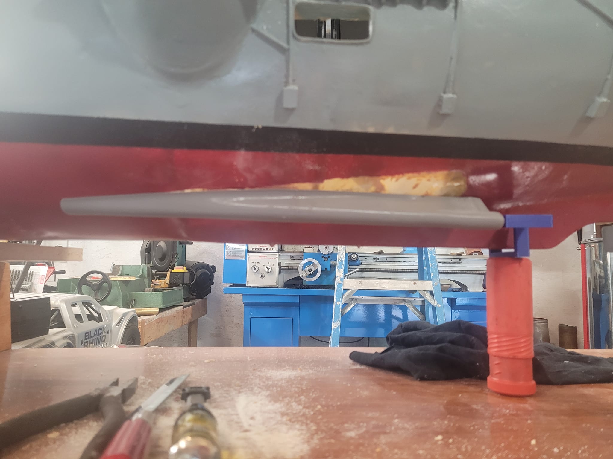

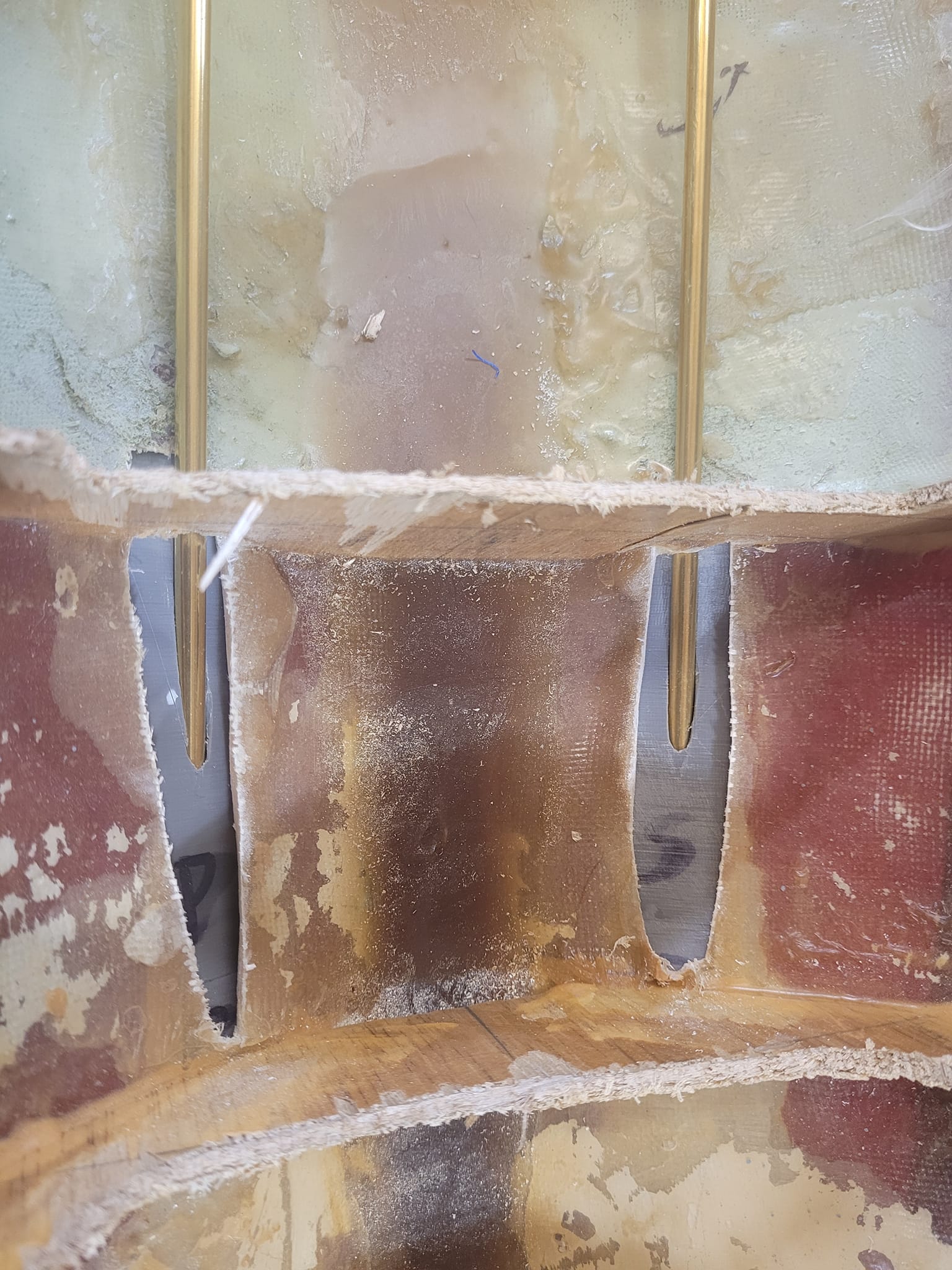

OK,
Having taken a bit of a pause on the Bonnie - I had a couple of other projects to get done - I'm now getting back on track with her.
New skegs printed, new motor mount printed, new alignment piece printed. MASSIVE holes cut in the bottom of the hull to allow things to be lined up properly...now it's time to start the rebuilding portion of this phase.
Here's some imagery....
Once the shafts are in, I'll re-do the sealing around the skegs. Putty and fairing compound.

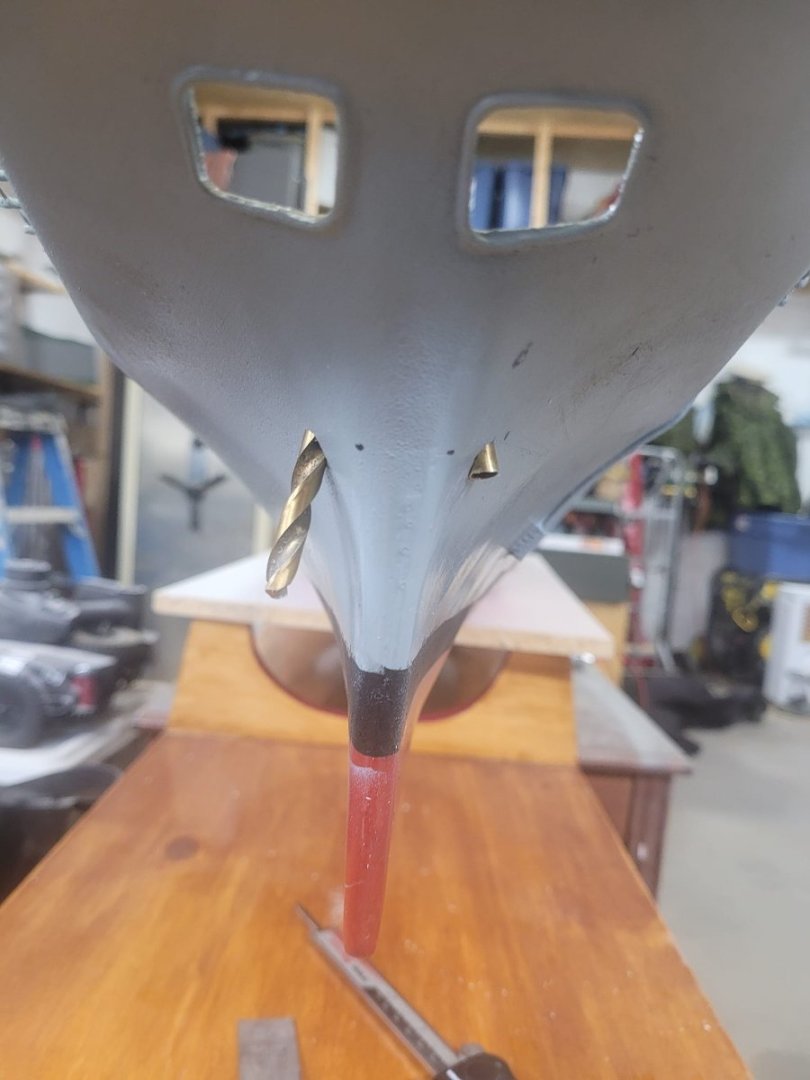

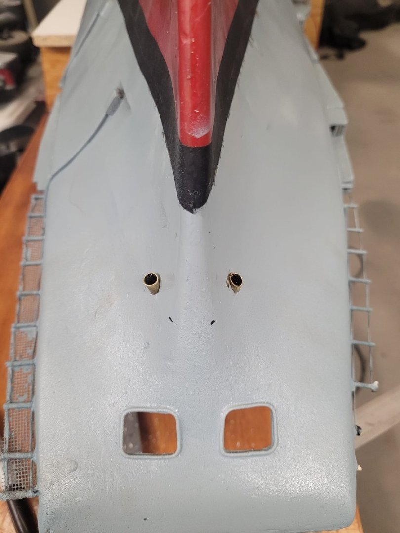

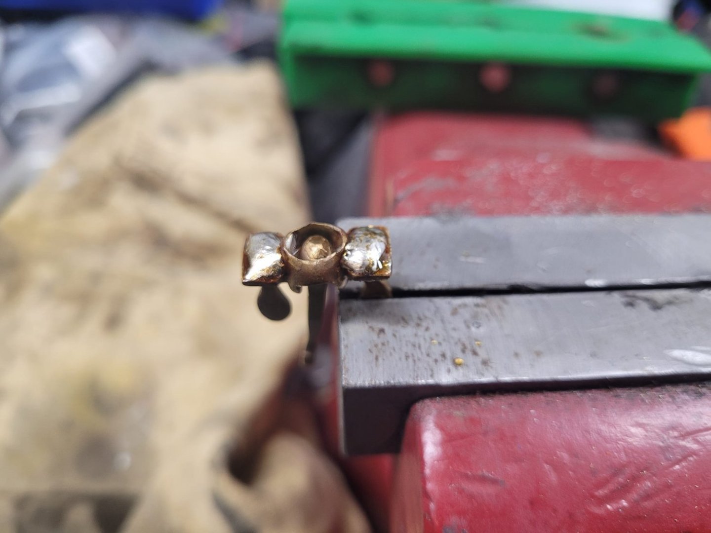

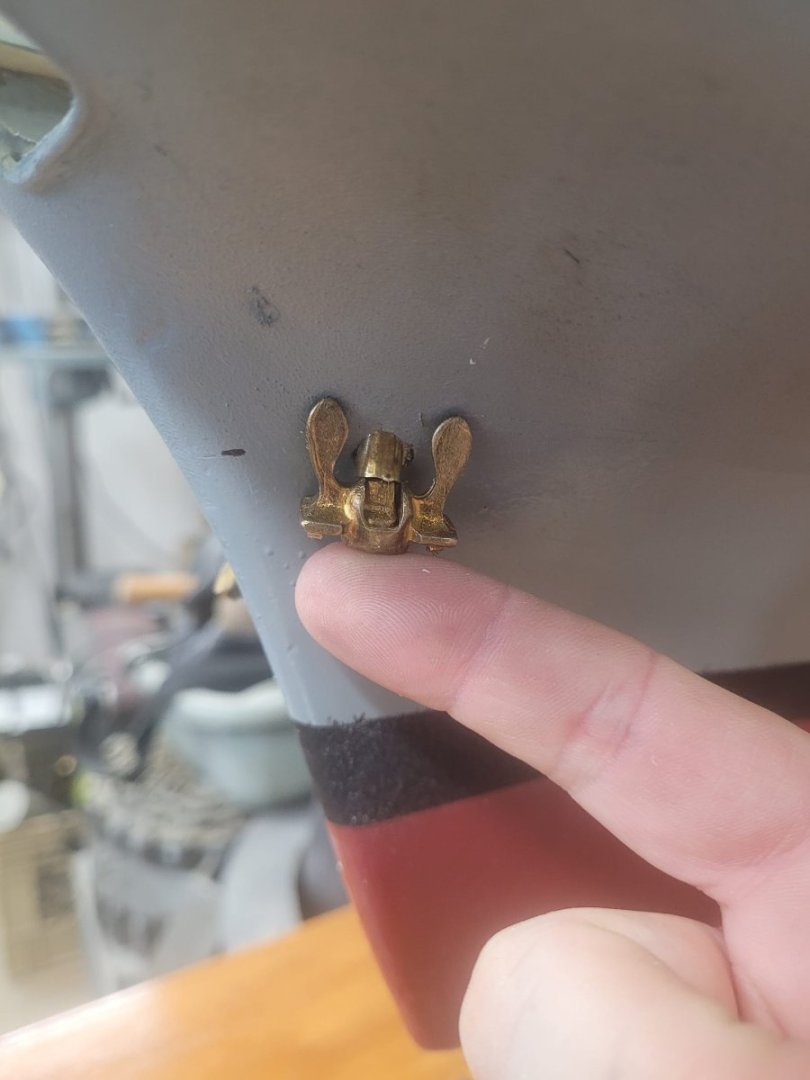

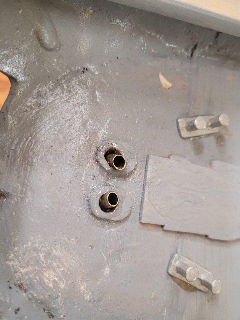

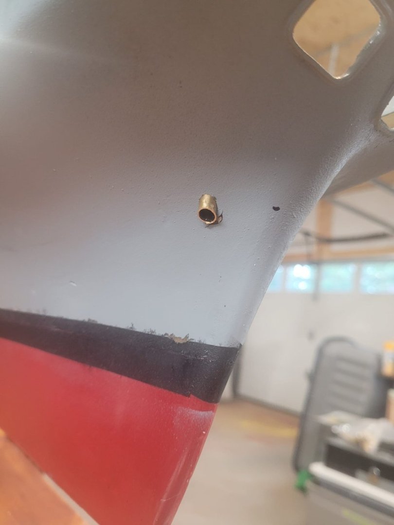

I finally got back to working on the Bonnie this week. After a bit of a pause to build the St Thomas, the bonnie is back on the bench and progressing.
I have the new skegs epoxied in place, and last night they got a layer of putty to start blending them in with the hull.
As I was waiting for the putty to dry, I did some work on the anchor, and drilled holes and installed the anchor chain hawse pipes. Then I looked at the anchor, added a bit of lead solder on the bottom of it to give it a bit more weight to help it drop free easily when released.
Then I did some inletting to get the hangar deck down to the right seating depth. It looks like things are going to actually fit together properly!

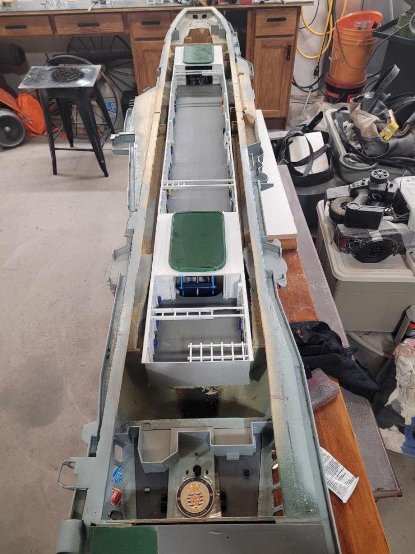

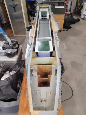

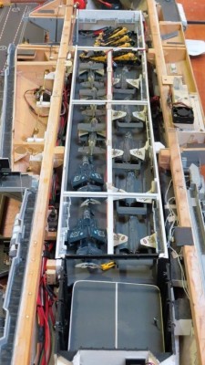

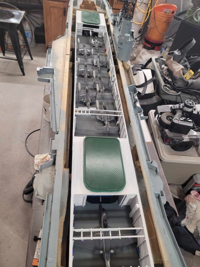

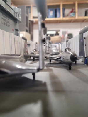

And here's the hangar deck inletted properly.
This fit was a key concern - all the motor mounts and electronics/batteries/etc will be going below this, and it needs to be able to lift out with the island in place, and it appears that it will do so.
Very pleased with how it looked, so I dropped in a few Banshees to see how that would look.

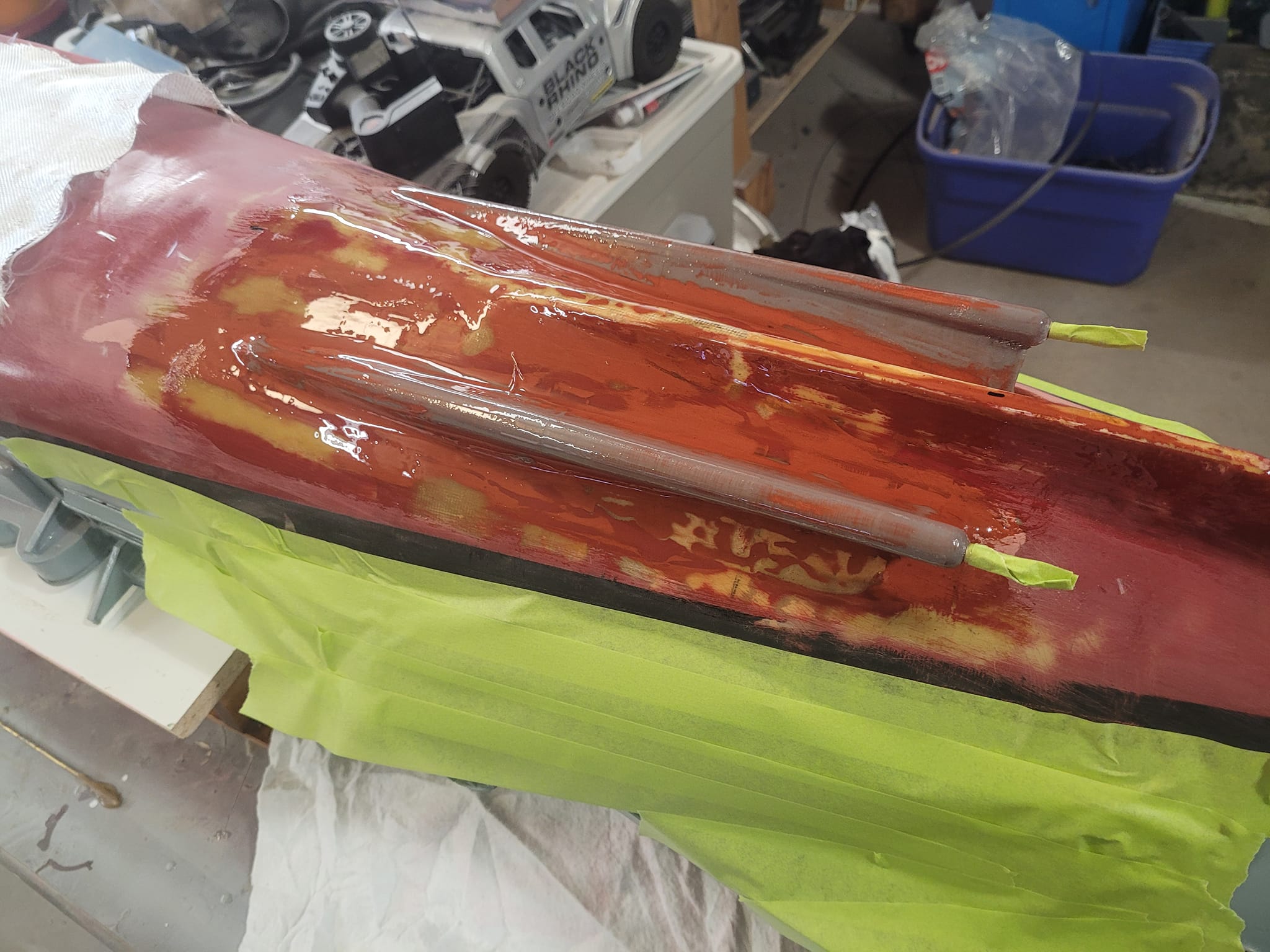

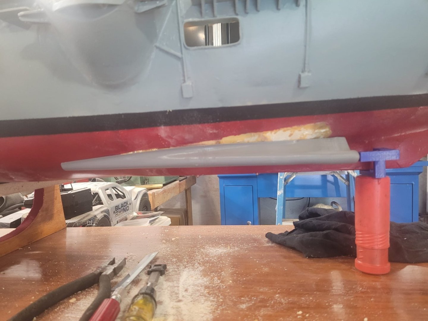

Oh, and here's the skegs for the prop shafts installed and starting to get faired into shape with some putty.

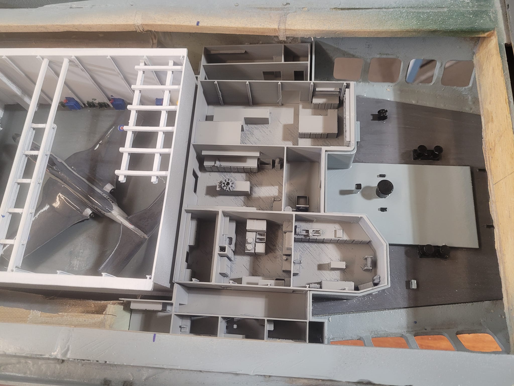

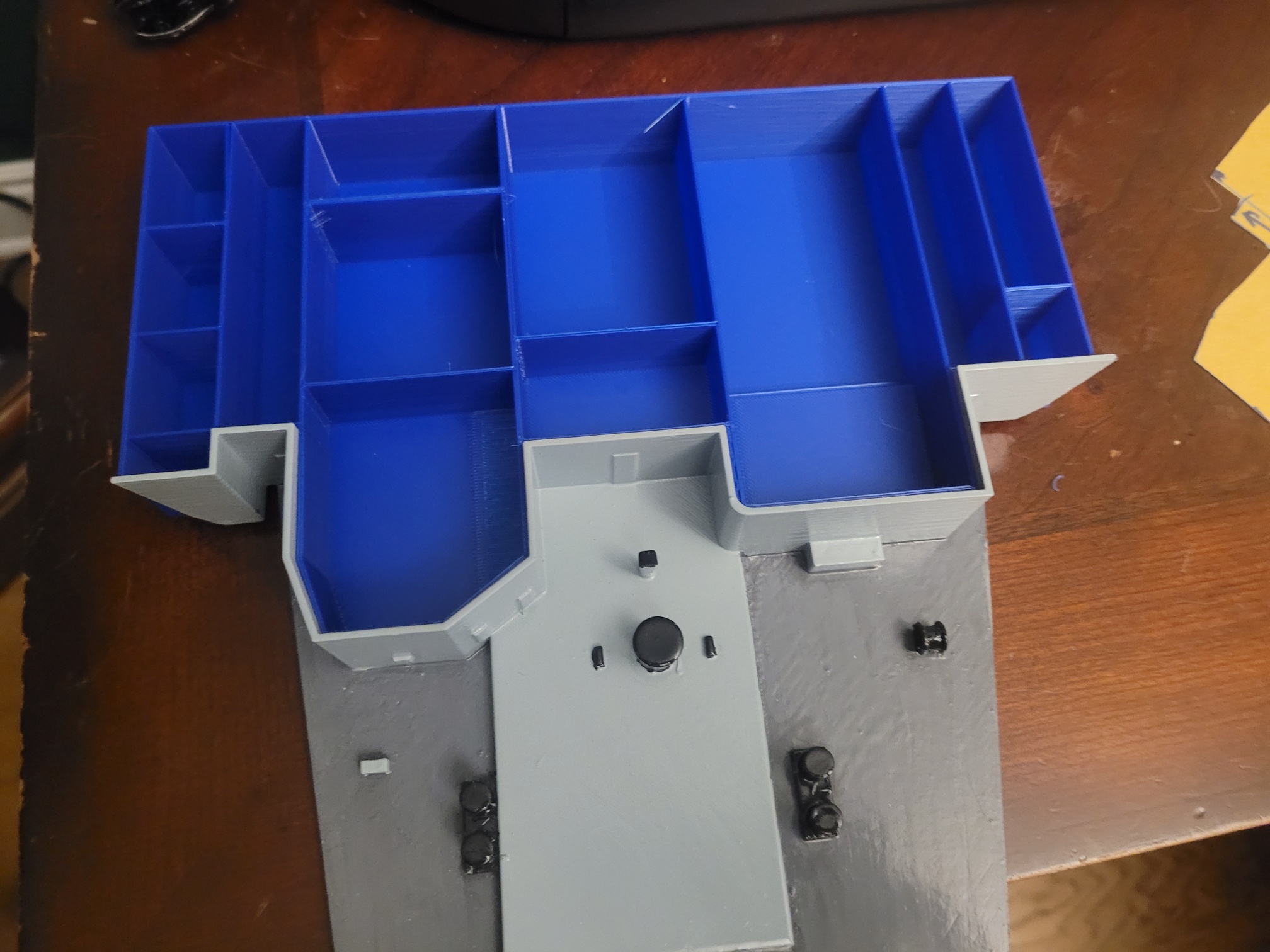

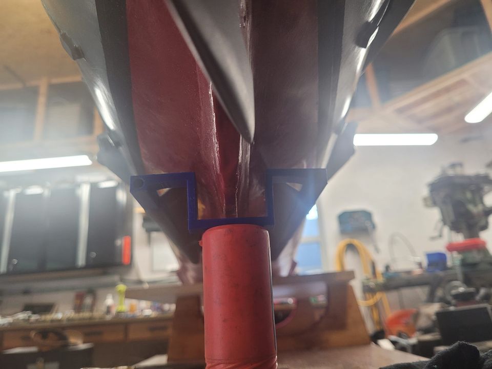

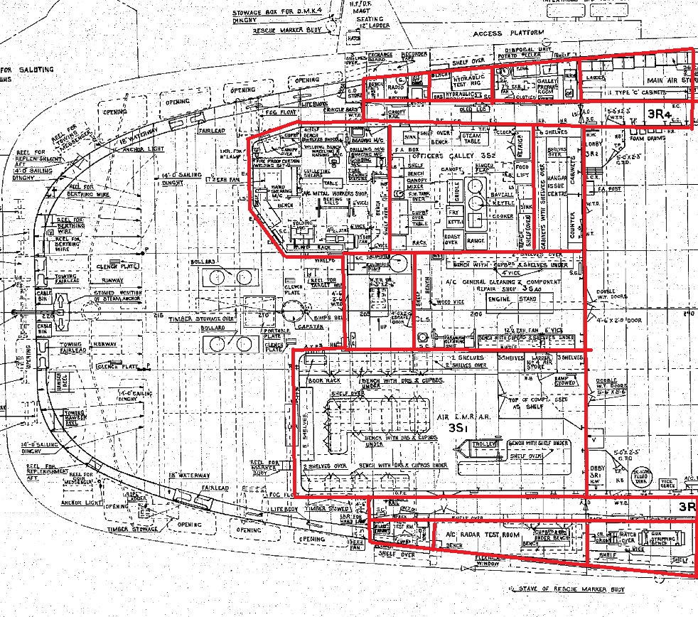

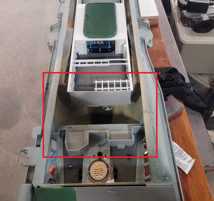

So....in looking at the photos above, I realized that there was a gap that bothered me. That being the gap astern of the aft hangar bay. When the flight deck panel for the aft hangar bay is open, it will let this space be seen, and I'm not a fan of this big ugly gap...so what to do about that?
I stepped back to the plans, and pondered things.
See the plan view with the red highlights....That's what I'm going to build to fill the gap.

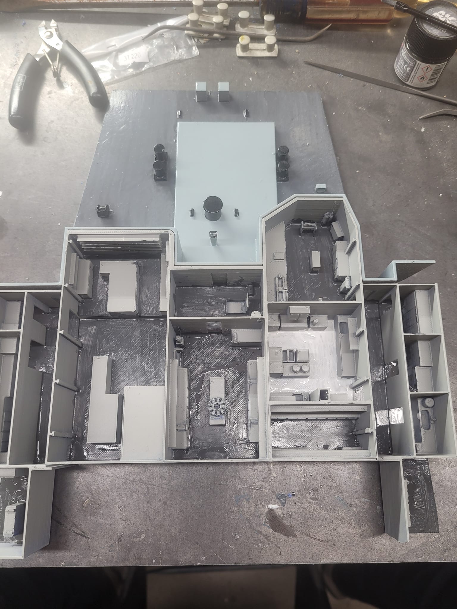

Some 3D design wizardry and 4 hours of printing, and presto...I have the 'sample' to test fit and adjust ready to pop into the hull tonight. There WILL be changes necessary to this, however, the most important part of fitting in with the already printed cable deck section was key.
It fits as can be seen in image 3. Which is a good thing.
I've already started doing some detail-work on the interior spaces - there is a selection of workshops and the wardroom galley space in here, so I'm going to have fun designing and printing some of these bits. We'll see how it all looks in the end!

OK,
Version 4 is pretty much there.
NS

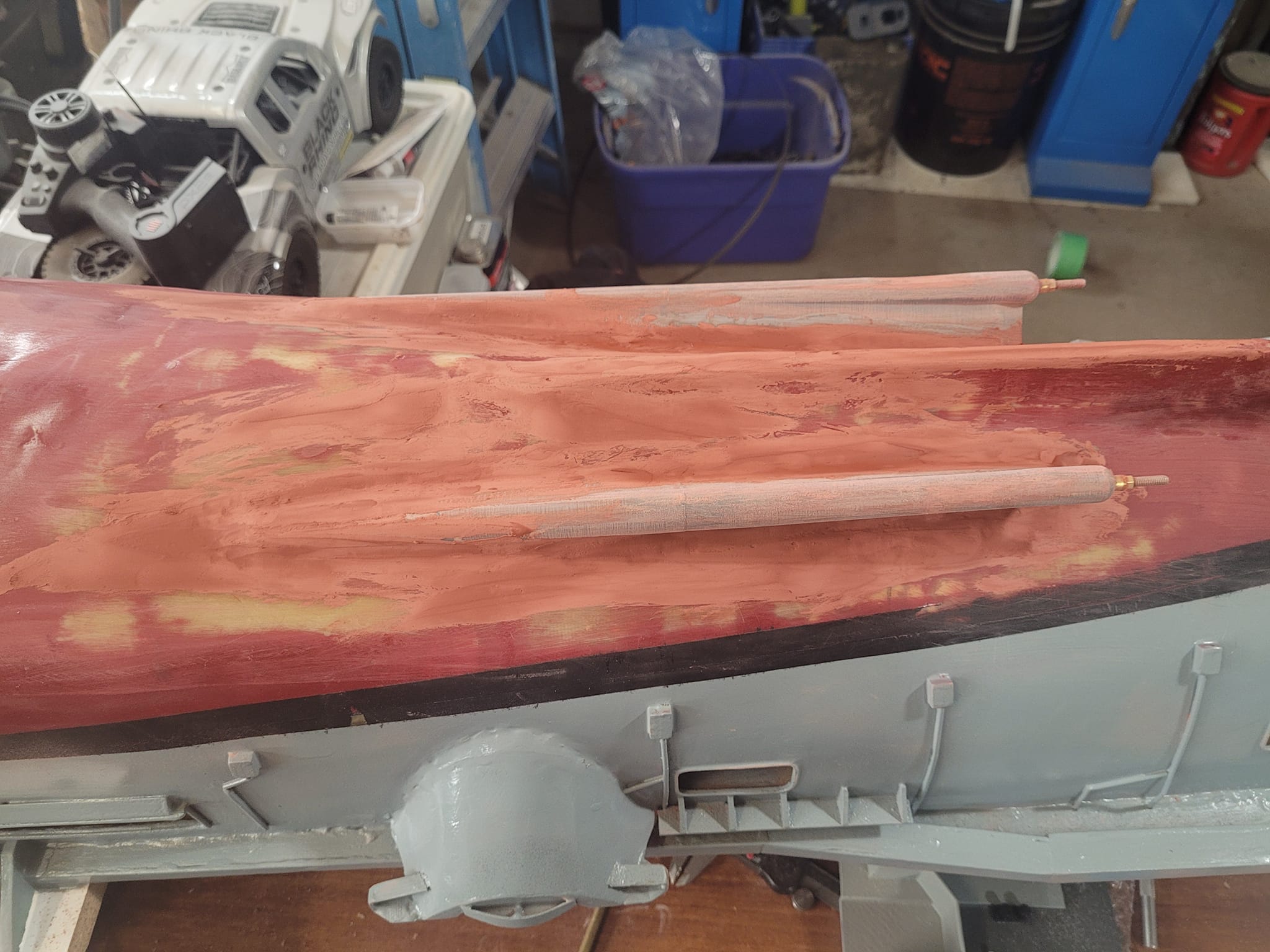

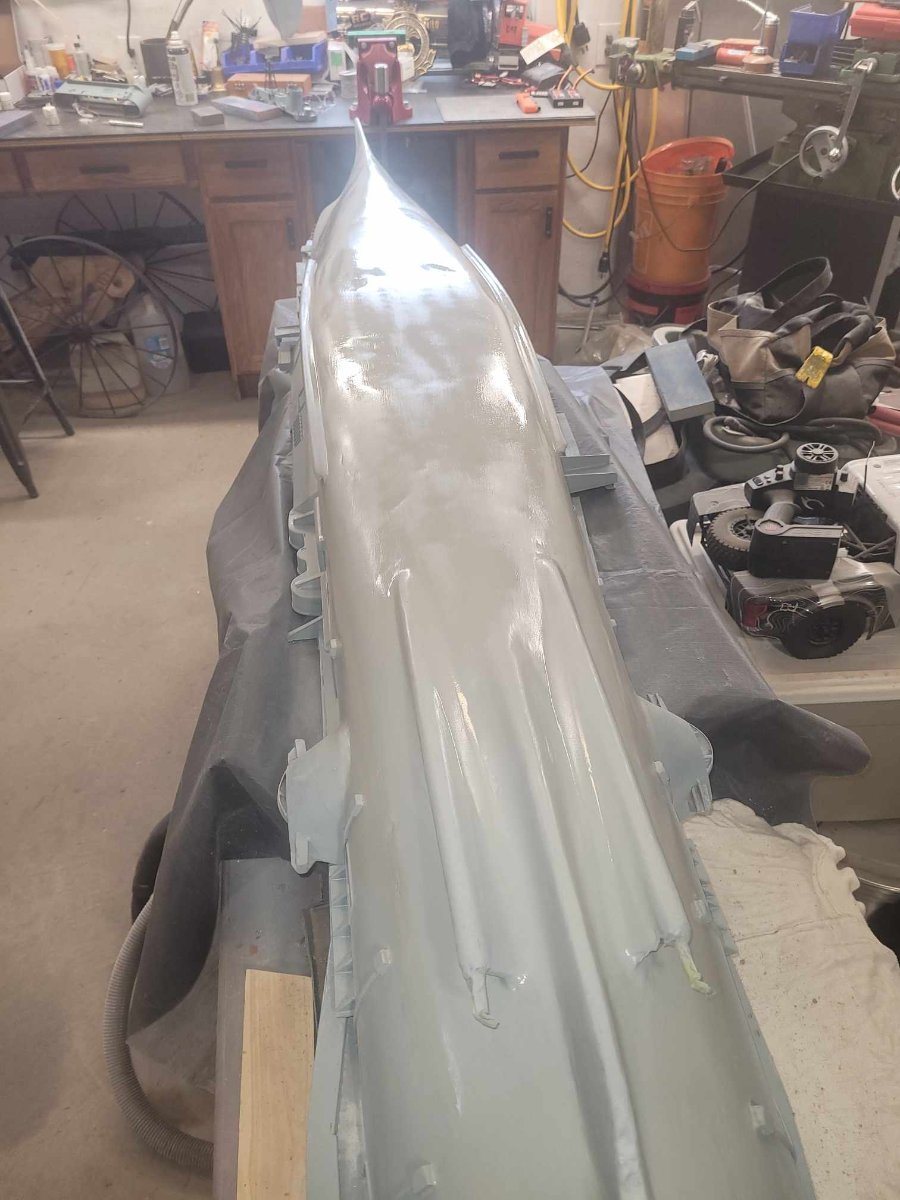

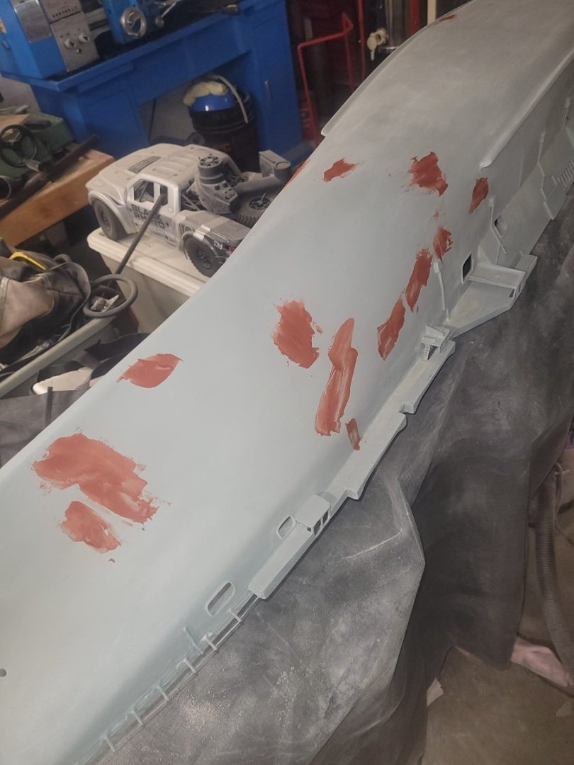

In the meantime, I've done a bit more sanding and filling on the shaft lines. One more bit of sanding, and I think I'll be able to slap on a layer of fiberglass and start sealing things up again.
NS

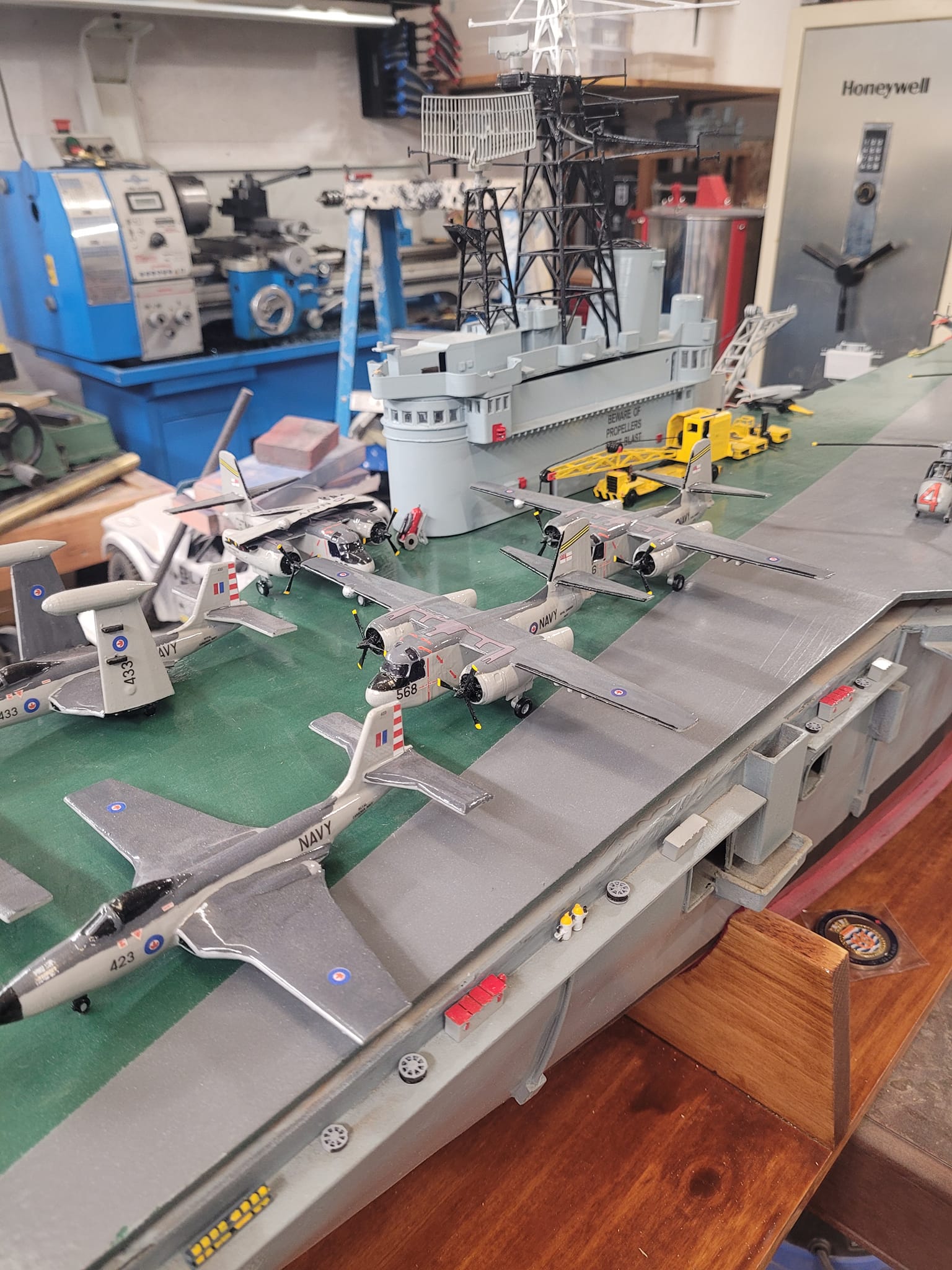

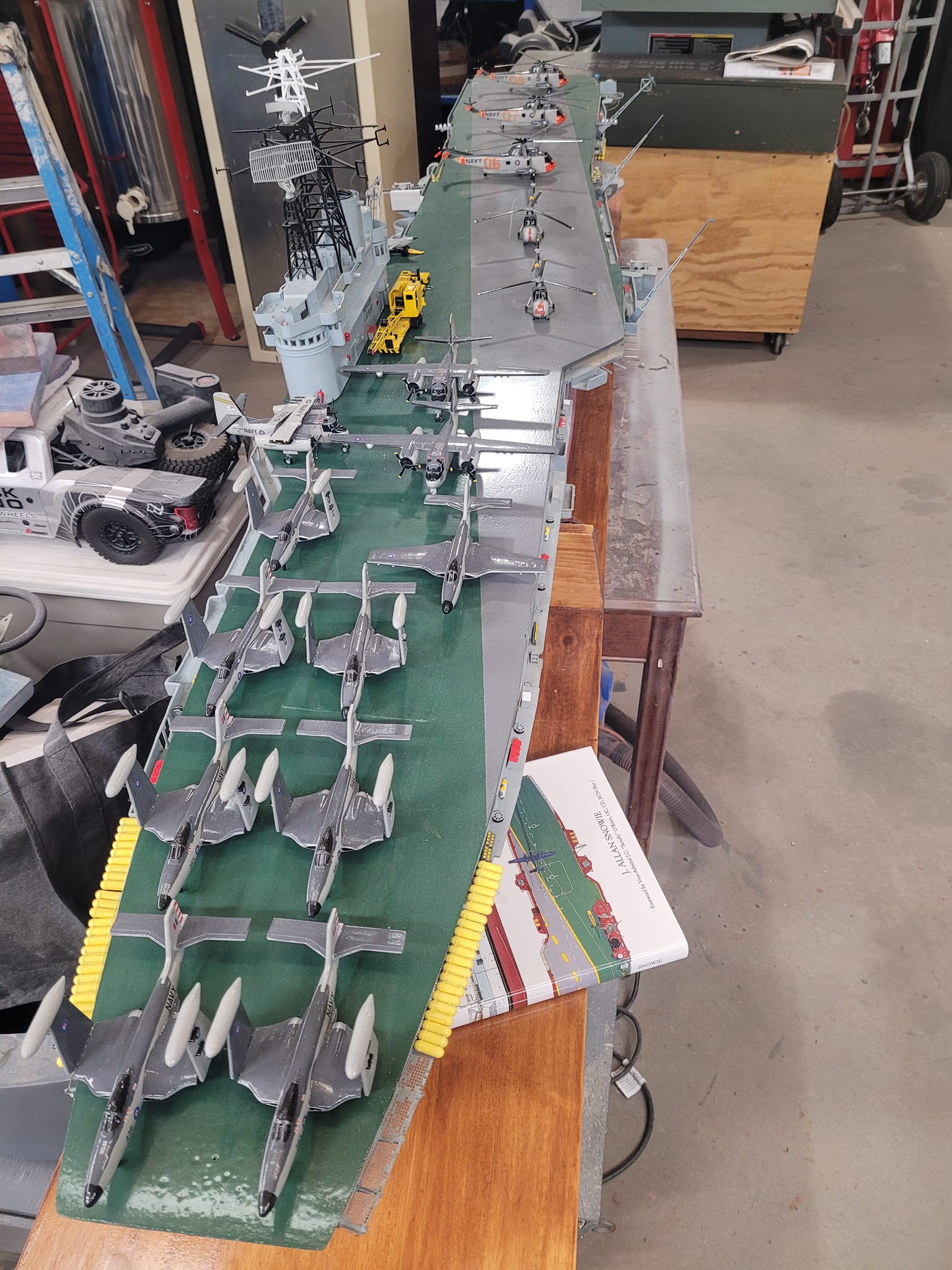

With a couple of other RCN vets coming out on Wednesday evening, I decided to tidy up the garage, put the shaft-line repairs on hold, and 'dress ship' to prep for my guests.
I'm generally pleased with how she looks!

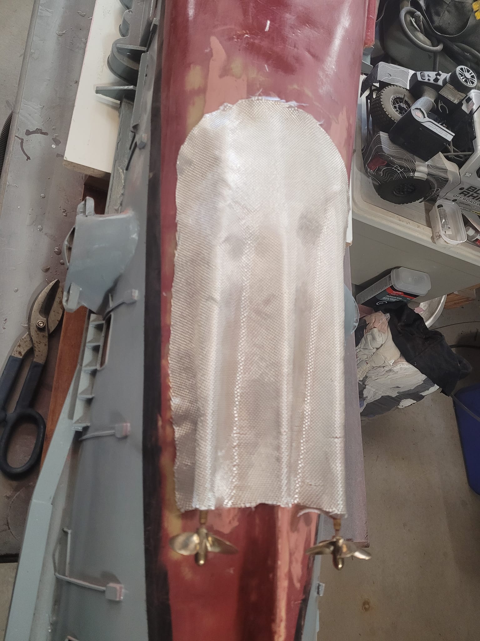

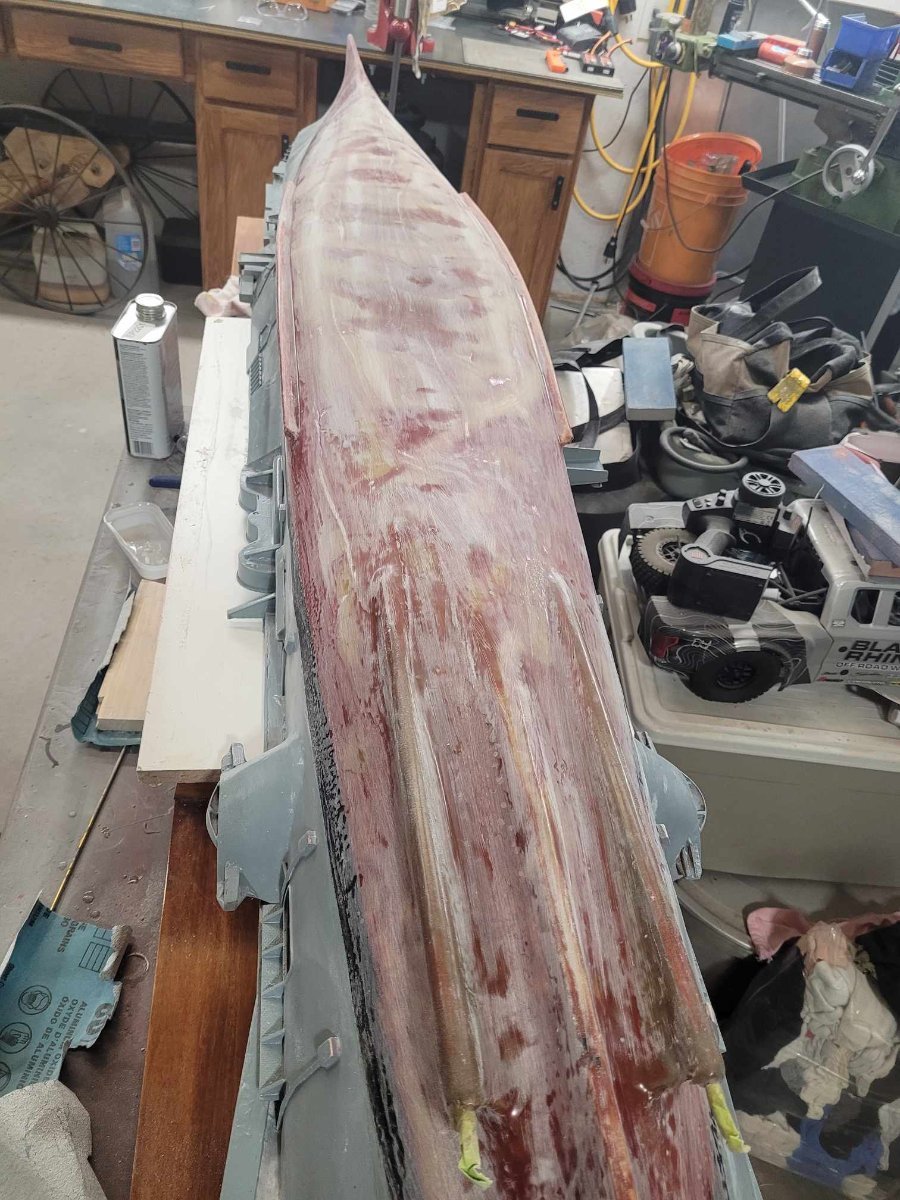

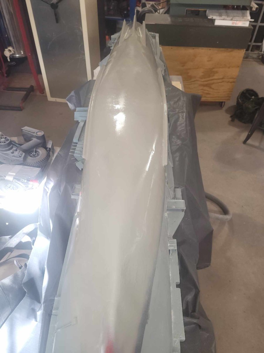

A great visit with some vets...and now back to work.
Here's how the fiberglass went on. Quite pleased with how it looks.
Some sanding required to tidy things up a bit more, but this is 1 layer of cloth and 4 layers of resin.

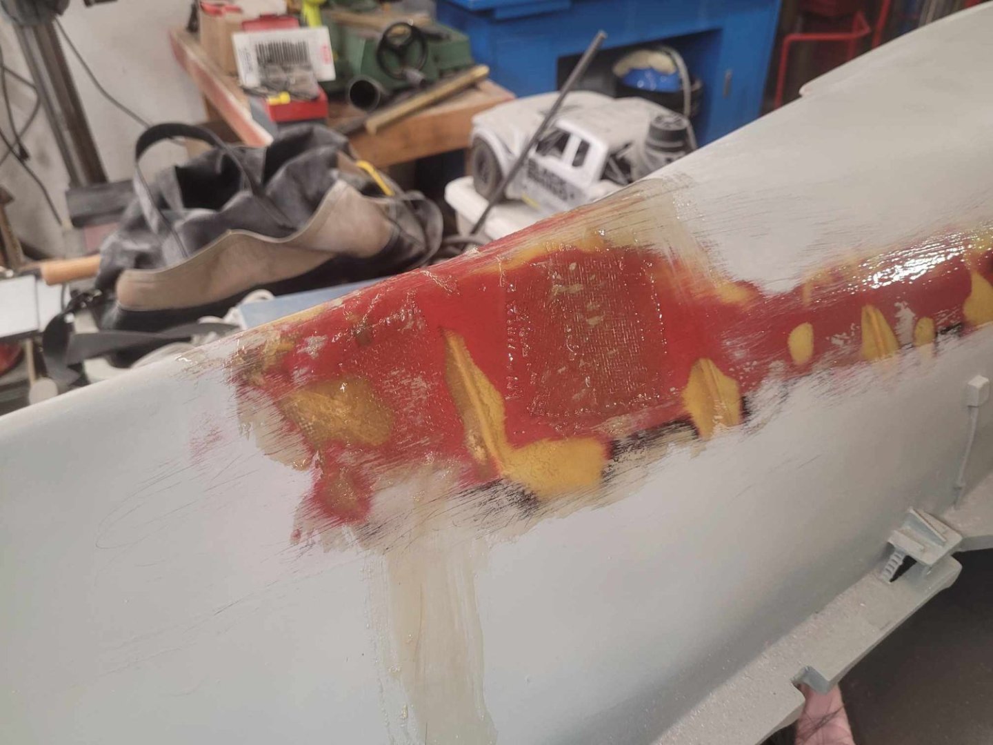

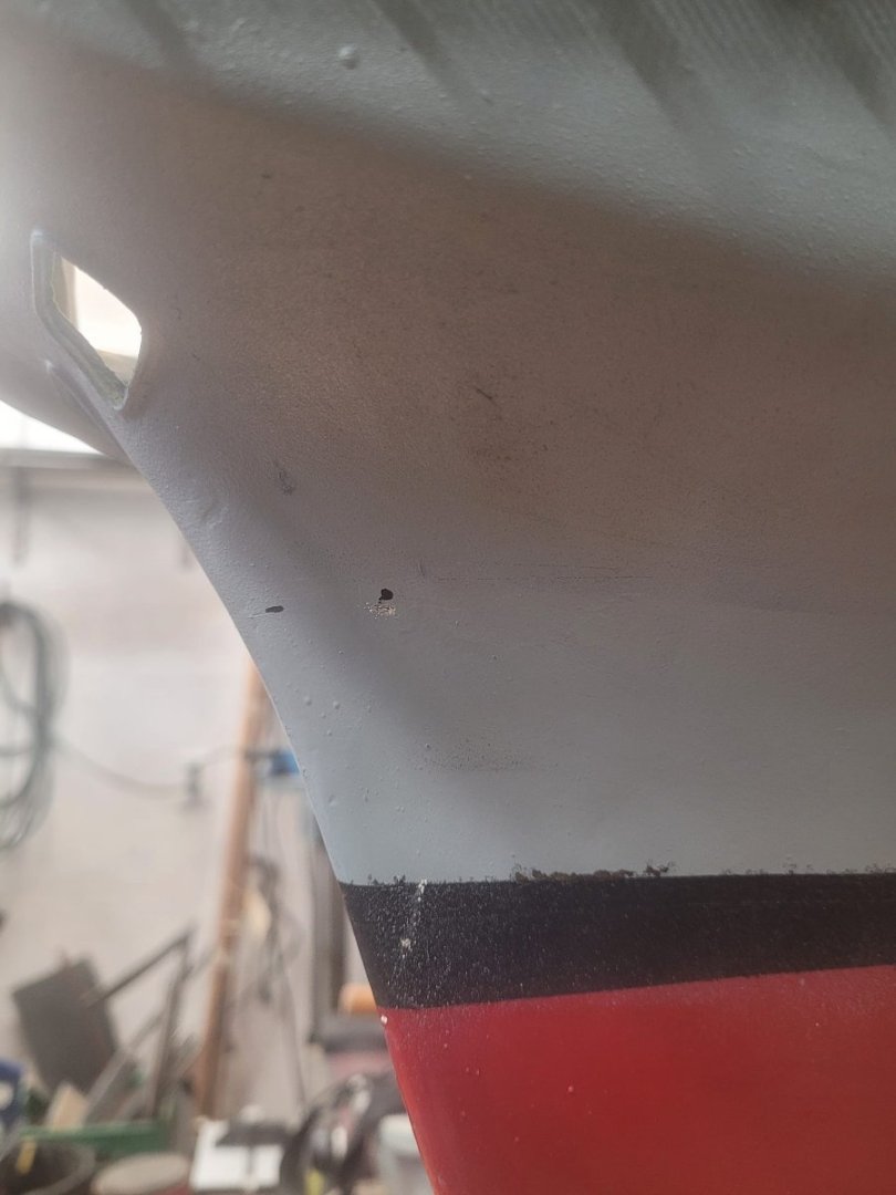

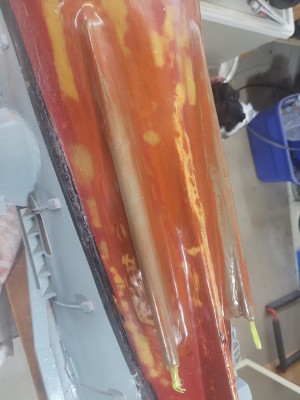

The bottom of the hull has been refinished - looks pretty good. I flipped the ship over once that was done and have been working on another project for a bit.
380886863_1040698377289716_7671078609708937263_n.jpg.5e15fb07c69345198ae92629b5a502ef.jpg
380886863_1040698377289716_7671078609708937263_n.jpg.5e15fb07c69345198ae92629b5a502ef.jpg [ 231.38 KiB | Viewed 502 times ]
383478344_708641407268028_9029653717435622239_n.thumb.jpg.ba5bf4b727ecbee837c8da401d3734fe.jpg
383478344_708641407268028_9029653717435622239_n.thumb.jpg.ba5bf4b727ecbee837c8da401d3734fe.jpg [ 173.9 KiB | Viewed 502 times ]
386619890_10159013402727242_5831133127870356536_n.thumb.jpg.24f317737f85fe849609efe636e46d4b.jpg
386619890_10159013402727242_5831133127870356536_n.thumb.jpg.24f317737f85fe849609efe636e46d4b.jpg [ 105.53 KiB | Viewed 502 times ]
381517705_1424873261404834_8304096821207248212_n.jpg.be7457e1ec99a9083f24e3b912e00f79.jpg
381517705_1424873261404834_8304096821207248212_n.jpg.be7457e1ec99a9083f24e3b912e00f79.jpg [ 147.77 KiB | Viewed 502 times ]
383699766_328800716279352_1447999553453266017_n.jpg.4f372979ef844ee41a85064a0ea323e6.jpg
383699766_328800716279352_1447999553453266017_n.jpg.4f372979ef844ee41a85064a0ea323e6.jpg [ 105.79 KiB | Viewed 502 times ]

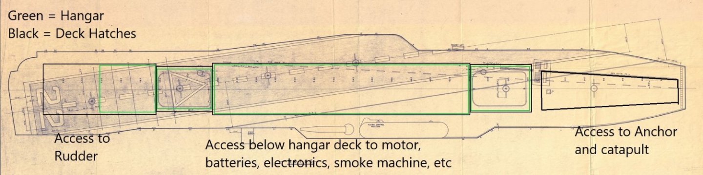

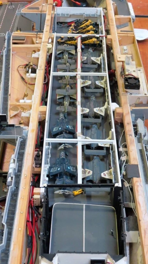

One of the things that inspired the Hangar deck work was this picture from another builder's HMS Hermes project:
HermeslHangarDeck.thumb.jpg.af453c2ec70bd3656425cbd74cba1d84.jpg [ 139.64 KiB | Viewed 503 times ]
You can see from this picture that I'm mostly there...ish....
That said, I had a plan to do interior access, which has the edges of the flight deck fixed in place with removable panels allowing access to the interior spaces using this plan:
DeckaccessPlan.thumb.jpg.ae9b0f7413e26b571f227008dd22959e.jpg [ 102.83 KiB | Viewed 503 times ]
So, I started hacking up the plywood flight deck that came with the hull and had a go at making it work.
