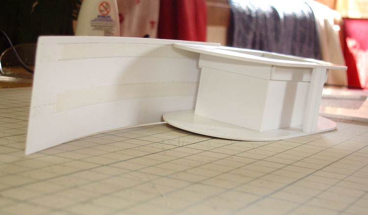

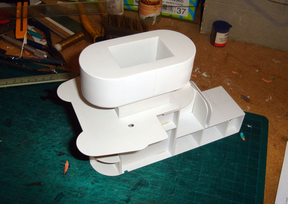

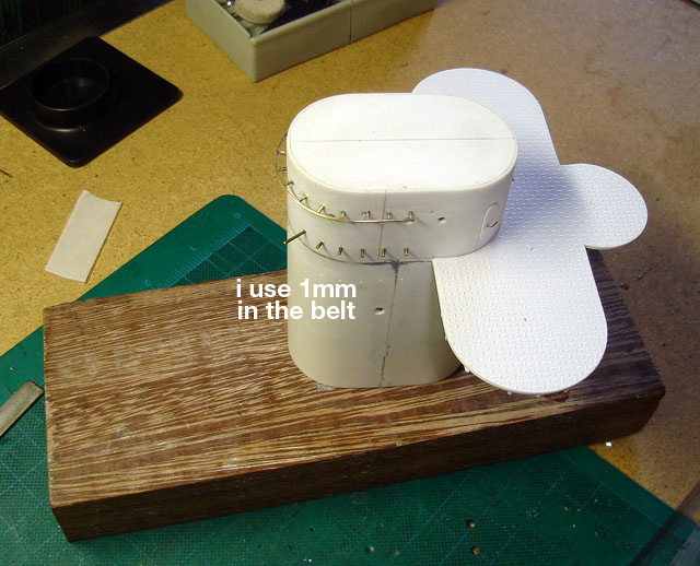

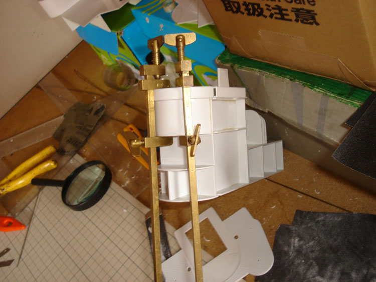

Hi ozpirate thank you by the kind words.
well i use the 0.5mm and the 0.8mm to circular walls. i using 1mm in the circular bridge of Bismarck with success.
but you have in mind he tickness of styrene i use is acording the platform or piece you are doing, example: in the searchlight platform of bridge i use 0.5mm. To revest the funnel( i still don't do) i am use 0.8mm i think.'as i said i use 1mm in the circular platform of the model.
no i don't use any hot font or hot water to bend. i bend in cold process. the hot water help certainly but it's not my process.
the secret is make a perfect soft curve, and correcting this curve don't be hard corner cause can danificate the styrene belt used to revest the piece. when you make a soft curve don't have any trouble.
but you have in mind when more tickness you use more complex is to do it.
i never use more than 1mm. Using 1mm it makes very strong a contrary force. you need glue first a part straight line using a good styrene glue. it leaves to dry a little after you can reinforce this part with a litlle bit of cianoacrylate. just use few ciano very feel. just prevent a strong gluig in the moment. after many hours what goes hold the part is the styrene glue you use before.
well after you can gluing the round part and holding with the hands or another tool you prefer, i prefer use the hands. after holding just minutes you can add again the cyano(very litte too) and continuing the process. Don't forget to measure the lenght of belt you use for a circular piece and leave a excess of each side to cut later. The excess is necessary. Too i make a pencil line and glue using this line to make a good gluing and aligned too.
you can use too bend(using a hot font of your preference) to broke (in part) a resistence of styrene in the round part. but you can use it when you are bending a large part of styrene and using too 0.8 or 1mm. i never need use 1.5 is very strong the contrary force.
i think this help you. any thing please ask me.
i am post some pictures to explain what tickness i use ok?
regards :wave_1:

OZ some pictures to ilustrate... :thumbs_up_1:
File comment: making perfect curves.
File comment: bridge revesting 1mm( is more difficult using 1mm but for this piece is a good thickness for me
File comment: bending using 0.8mm in this case

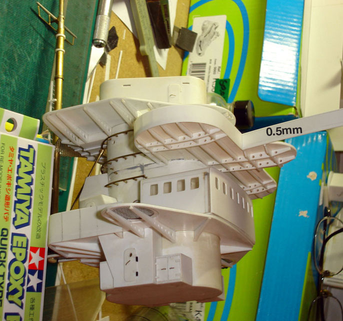

File comment: and finally i use 0.5mm in the searchlight platform.....
don't forget... a good curve help so much...
Bye

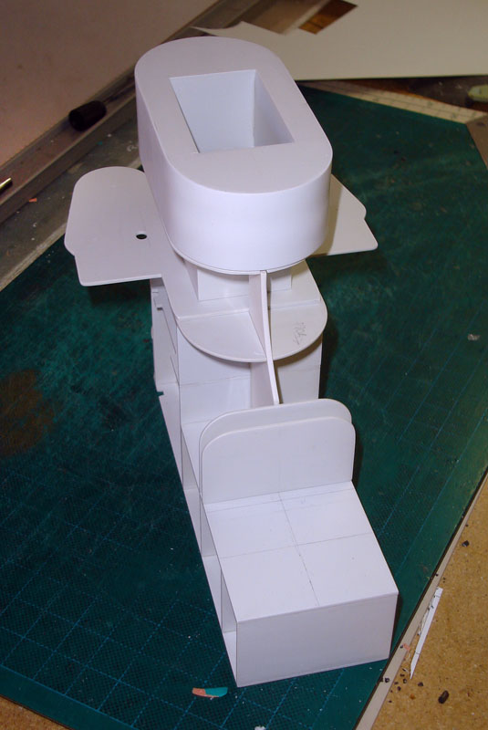

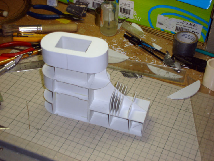

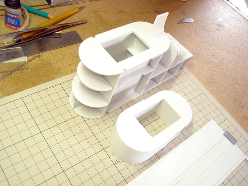

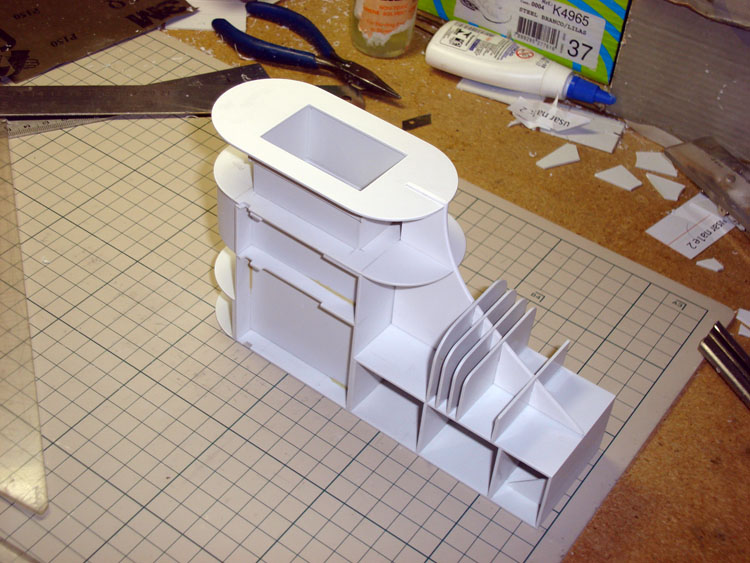

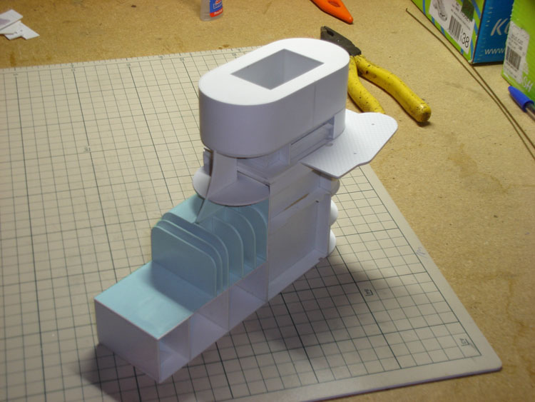

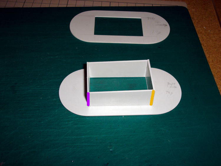

Hellow fellow modellers..
i am posting more pictures of the funnel buildings... :thumbs_up_1:

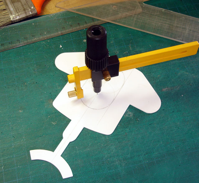

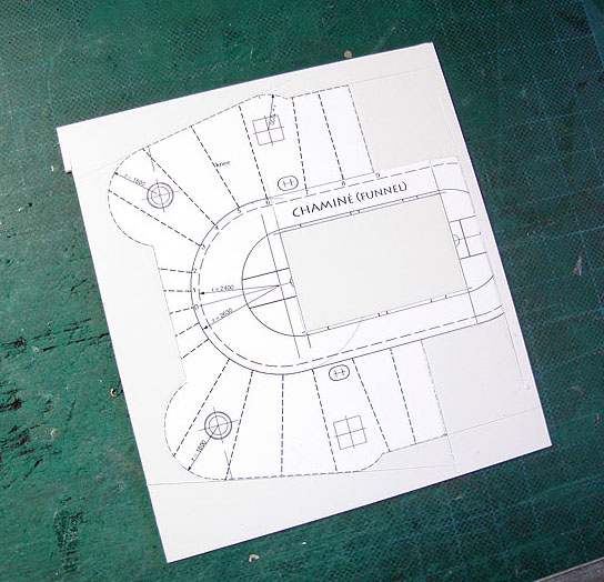

File comment: the purple line and yellow line is to show how this part have an elevation in the end of funnel near the hook

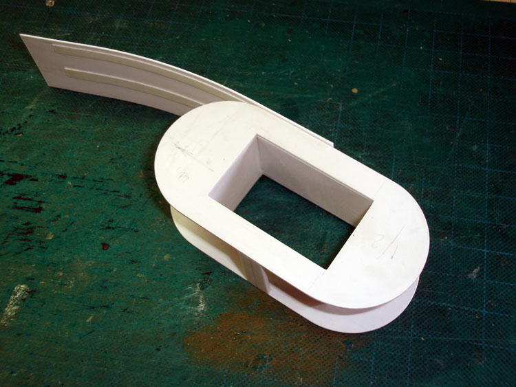

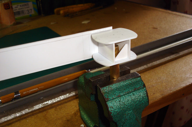

File comment: revesting the piece

I do like the idea of the extra stips on the inside of the funnel casing :thumbs_up_1: :thumbs_up_1: :thumbs_up_1:

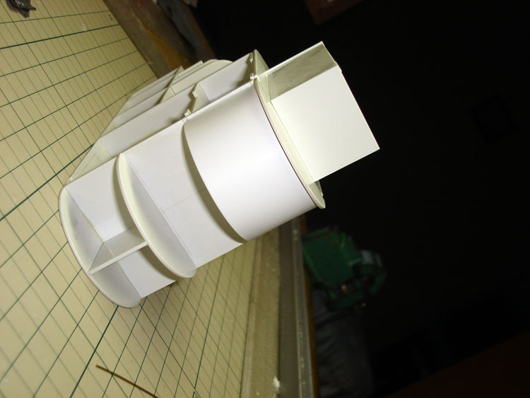

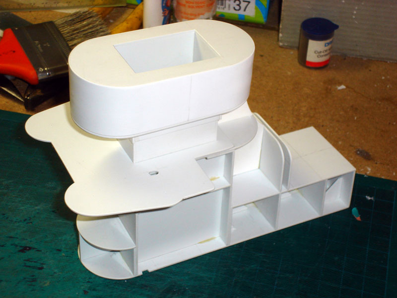

Posts: 1993
Location: Brasil
:thumbs_up_1:

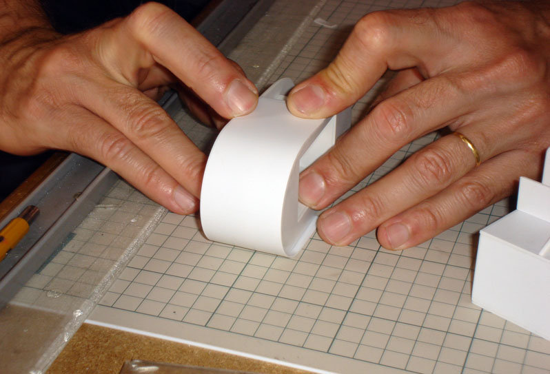

File comment: holding to glue

yes Dave, this is a reinforce too to hold some external parts... but is better do a not much large belt... :thumbs_up_1:

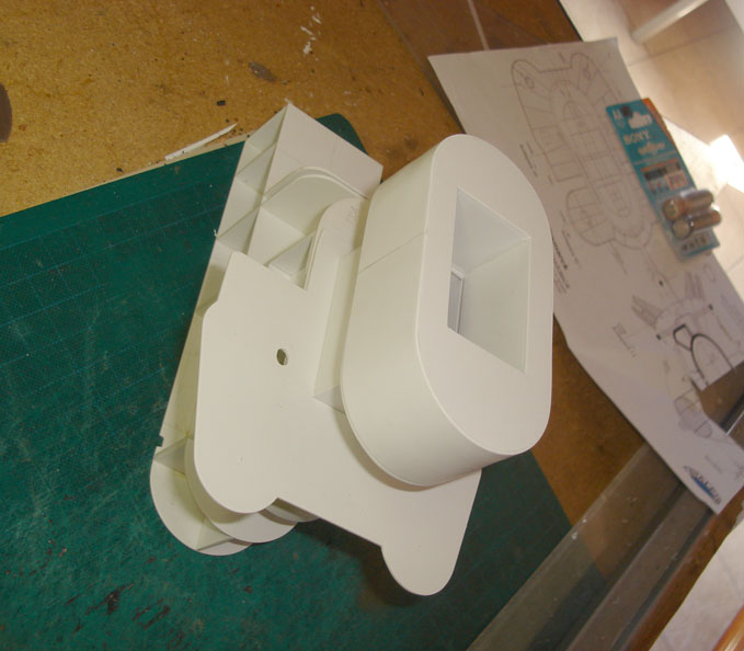

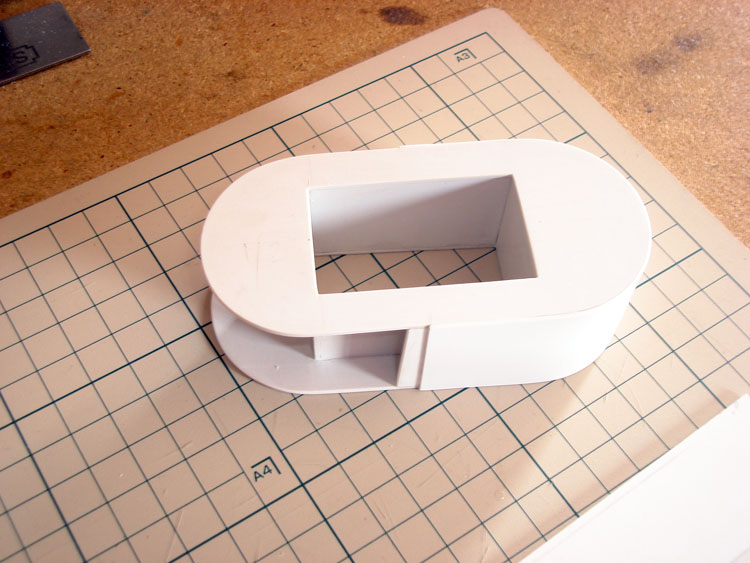

File comment: gluing in two parts

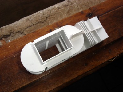

File comment: the ladder inside(really i dont know if this exact place, but i know have inspection ladders on funnel

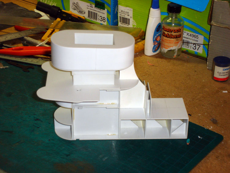

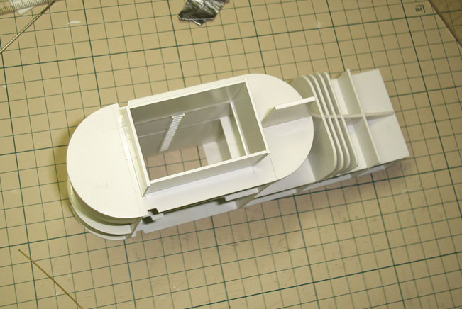

some elements still not glued

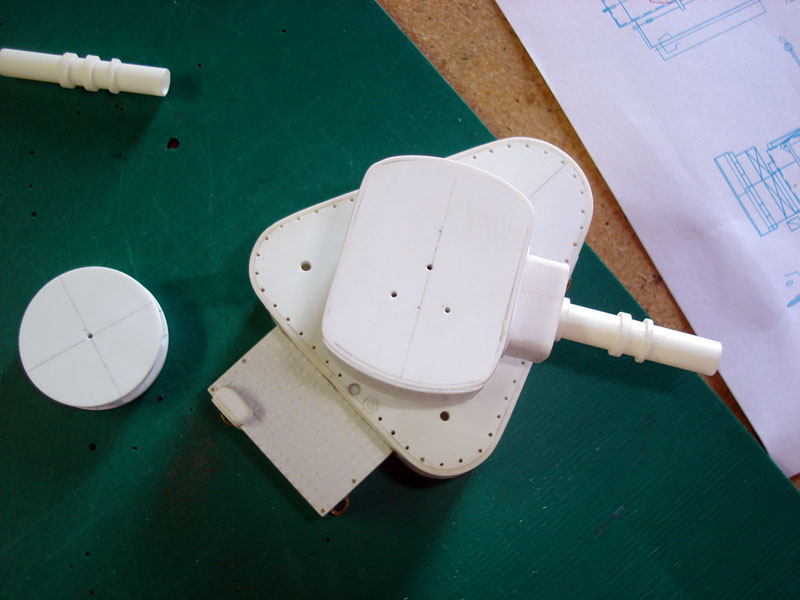

File comment: searchlight platform
File comment: preparing to cut
 Post subject: Re: Bismarck 1/100
PostPosted: Tue Sep 29, 2009 8:36 am
Posts: 1993
Location: Brasil
the searchlight platform make part of building leaves strong in the place :thumbs_up_1:

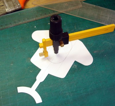

The level of detail and use of Styrene is simply Outstanding. I love the cutter, Will have to add that tool to the Box.
Awesome work. :thumbs_up_1: :thumbs_up_1:

hI SweeperSkipper thank you the nice words .
yes some tools are very usefull
recently i purchase a tool to make rivets(simulate) in the styrene. is from Hasegawa and a nice tool and is like a pen.
but i need invest more in specially tools
Regards :thumbs_up_1:

Hi SweeperSkipper
yes really the cutter is a good and very usefull tool.
i need invest in more specific tools too.
I have seen its work also. its. outstanding job.
soon i am post new pictures or the funnel's work

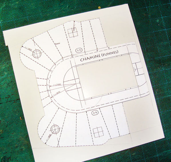

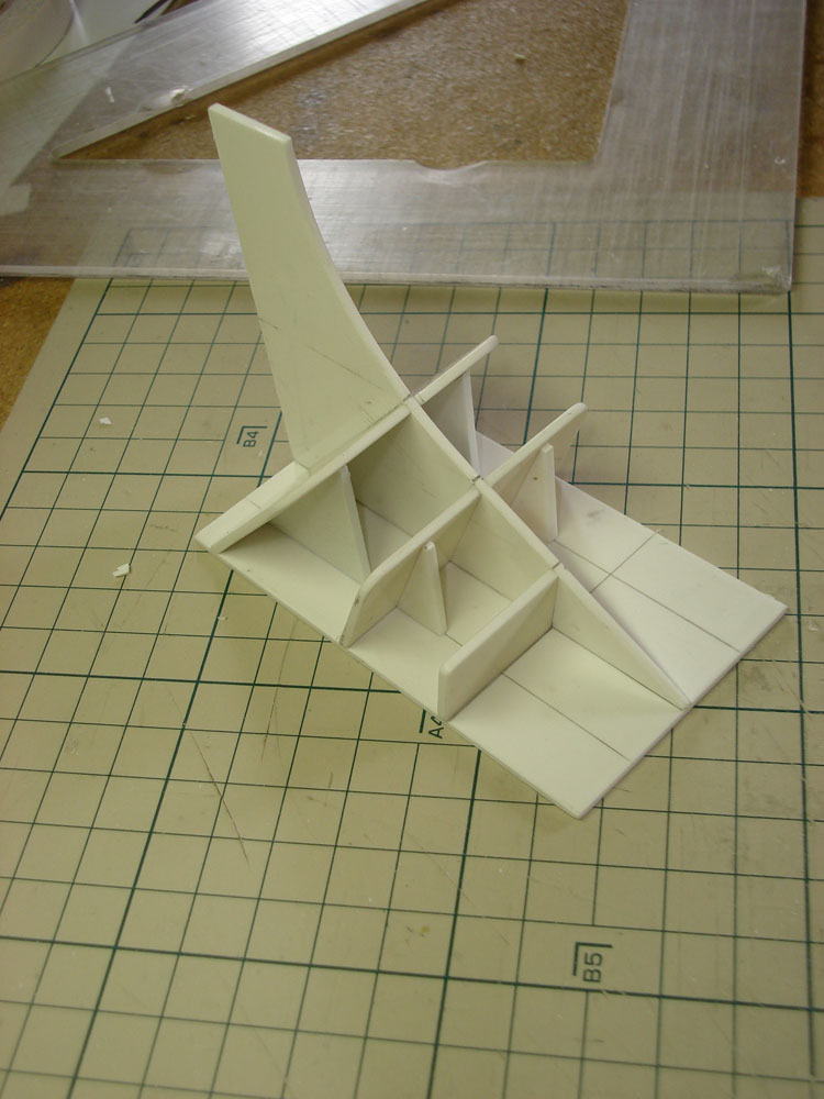

Rebuilding the rear part of funnel.....
Hi fellow modellers i am here again
and the pictures show the rebuild the rear part of funnel.
i ignorate one drawing i don't have in the main plan i have, so \to construct this part
i planed in my head how do it. ok this work but one part of the funnel(rear part) was so much difficult
to revest satisfactory. and i looking for more information i find in another plan i have an important drawing
just the rear part of this subject. now i cut out the part i am doing and with the new drawing i having in hands
now this work so well. but this consuming my few time too unfortunately.
i am revest this weekend. please show the pics and see the difference.
ship modelling as always a great challenge but i am happy to do it.
Regards all
:thumbs_up_1:
File comment: gluing the block......
File comment: part rebuilded
File comment: new structure to rear part..... yes the inclination of the bulkheads make the difference.
the piece revest perfect now.
