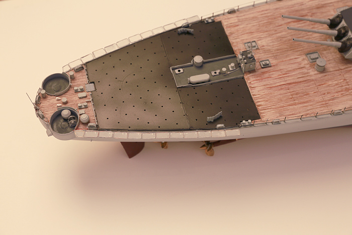

Back from a couple of months from helping my lady care for her newborn granddaughter. So ship progress this year has been very slow. Back to work on Mo, with "Mo work" to do. Finally tackling the helicopter deck netting, have the Port side done but now out of the Bronze wire used to form the nets. Bending the wire frame around a wooden form then joining the ends with CA. I then stretch a piece of open ribbon and glue the frames to the net ribbon , then trim after dry.
Nets added to fantail.

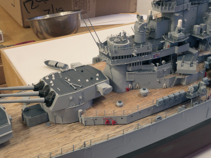

It seems as there is an infinite number of small items to add. I produced two Capt/OOD chairs for tech bridge wings, numerous small gee gaws for the yardarm and vicinity, small hand wheels (scratch) and a couple of ribbon boards for the bridge wings. I was fortunate to have a photo I could adjust and print to scale... Have a strong magnifier? I did find Dr Pr's great drawings of the SPS 10 to aid in constructing those. Added some more unrep gear to the top of turret three, on and on!
The current method is to post a photo on the 27" studio monitor and start cobbling and adding "stuff". A nearly 900' ship has a lot of "stuff".
Current progress fwd superstructure. Capt/OOD chairs added to bridge wings.
