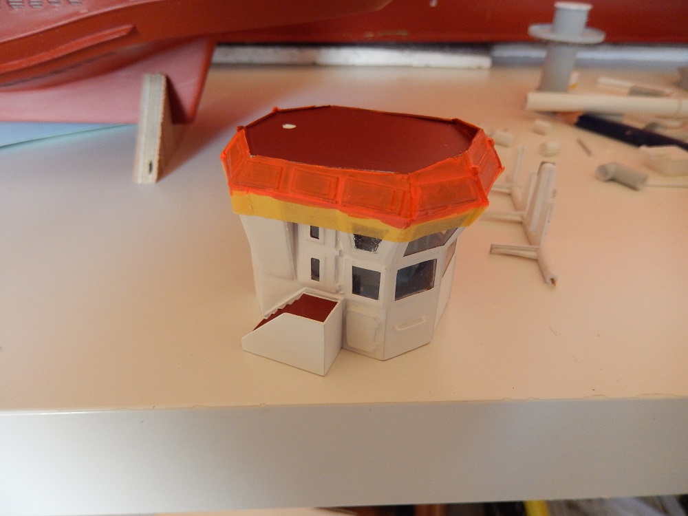

Hit a small snag recently. Found out the bright orange paint that I was going to use for the roof of the bridge doesn't cover very well. Combined with the dark primer below it, it didn't look very nice, partially because I tried to apply it by hand. Currently I've removed most of it and I'll be airbrushing it next time in a billion layers. Hope that'll fix it.

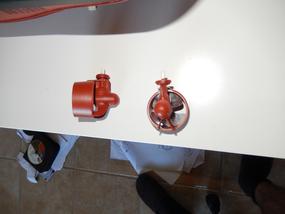

The propellors are now inserted into the pods. Looking at now, I guess it would have been better to make them seperately rather than turning the hub into the pod on the lathe like I did here.
Inserting the blades (litho) into the hubs wasn't really a problem, but to make them fit inside the tunnels, while keeping the same shape and size was a totally different story. Now they are covered in primer and ready for painting.

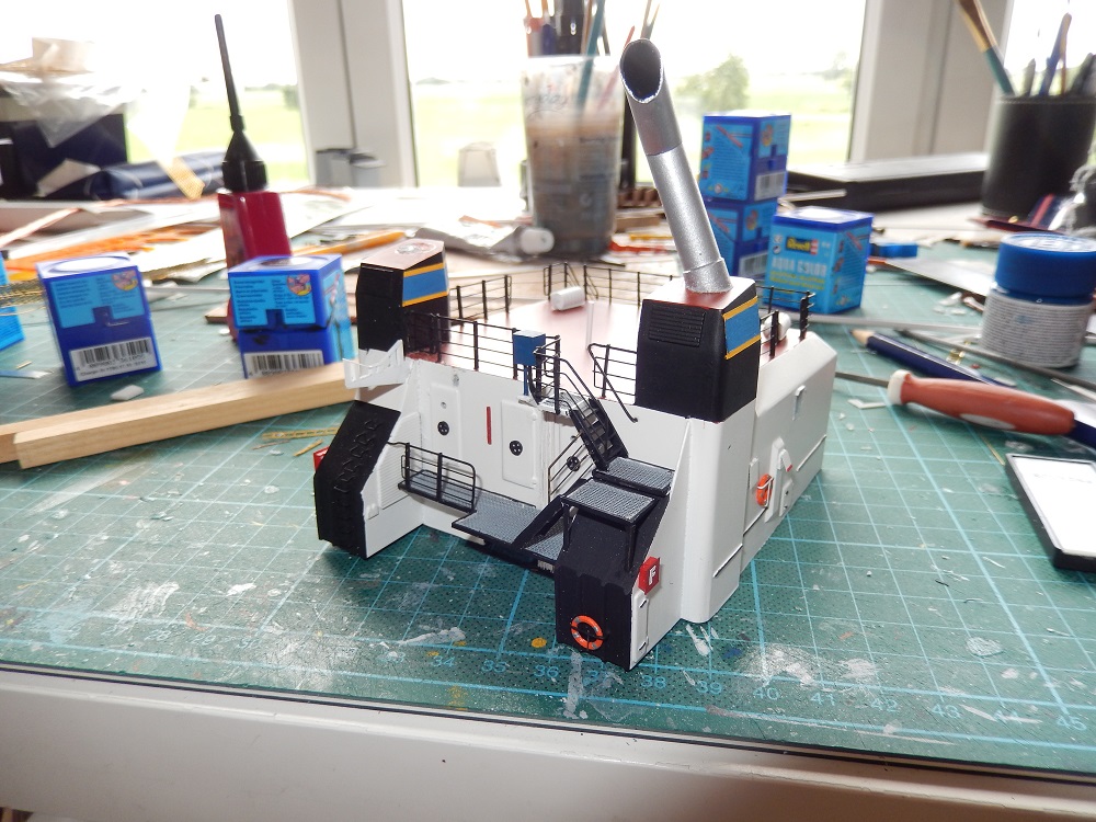

Furthermore I've been busy with a lot of details. The small foldable crane that sits on top of the aft towing fitting. The gratings on the aft of the superstructure (more to come there, they're connected by stairs.
And I've been turning the navigation lights from transparent sprue from kits. Used the sprue of the Tamiya Shimokita kit since it has a slightly larger diameter than Trumpeter's aircraft from Kuznetsov. They came out nice.
The top details of the bridge also received some coats, I'll add a drop or two more yellow for the final coat. Once installed I can add the lights.
Still a lot of stuff dry fitted in below pics, so don't worry if you see something in a strange position. The funnels aren't lined up yet, since I first need to finish the bridge.
Edit: as you can see, the liferafts are also finished, just need to make the cradles now.

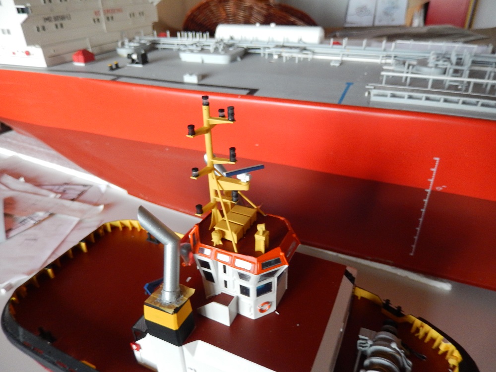

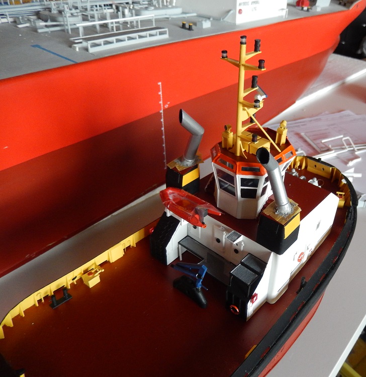

I had part of the blue on the funnels painted, but it was way too dark, so I softened it by now. Furthermore I've made the stairs for the aft part of the superstructure and started with the railing. I don't have any CA glue anymore, so that'll have to wait for later. Just preparing and bending the railing while I'm in the mood ;)
I had a problem at first, since it's 4 bar railing and that's not really available in this scale. At first I was planning to put 3 bar railing instead, probably nobody would notice. On the other hand I could have also drilled everything myself, but that would have taken a long time and probably I'd never get to finish it.
So I chose a path in between. I bought a lot of 3 bar railing from Dean's Marine for the Chaconia tanker, yet I knew there was some 2 bar stanchions in those sprues as well. So I came to a rather easy conclusion, I could just adapt the 2 bar stanchions. Drill some extra holes and straighten it out.
I also had to remake the zodiac supports since the boat was too close to the accomodation. Basically I remade the supports and made them slightly longer. These things do take some time, but in the end it's well worth it.

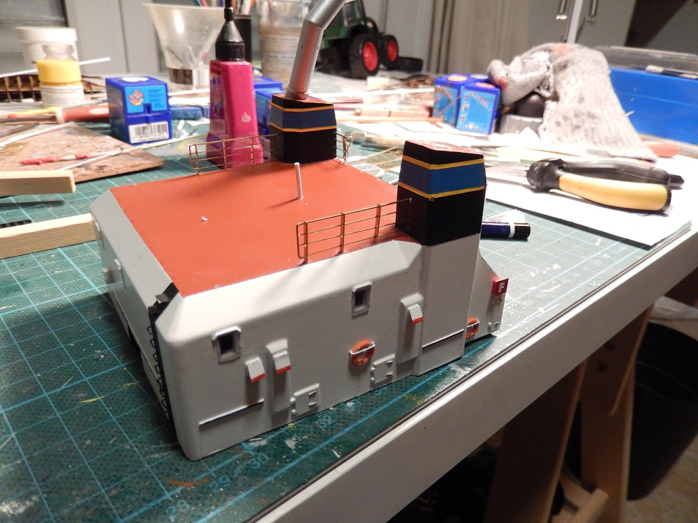

It's been an age and I haven't been home much, but finally an update. I now have a policy of 1 piece per day. So practically I'm putting one part of detailing each day on this tug and like this I do make some steady progress. Up till now my concentration has been on the railings on the superstructure and some small detailing on the aft bulkhead. Occasionally I can do more in 1 day. :heh:
I'm sort of hoping to be able to continue the Chaconia build much in the same way to at least get it finished some day.

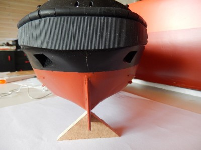

Unfortunately, due to the heat and probably direct sun on the starboard side of the hull, the hull has cracked due to the expansion coefficients between the styrene and the car body filler (that's at least my conclusion for now).
Not much I can do about that for now. I guess I'll just camo paint it and keep it out of the sun light.

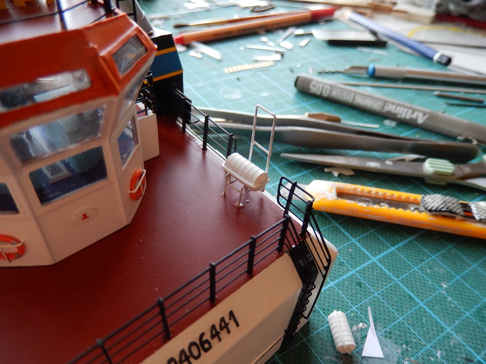

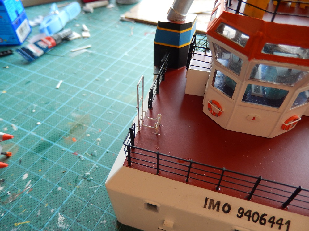

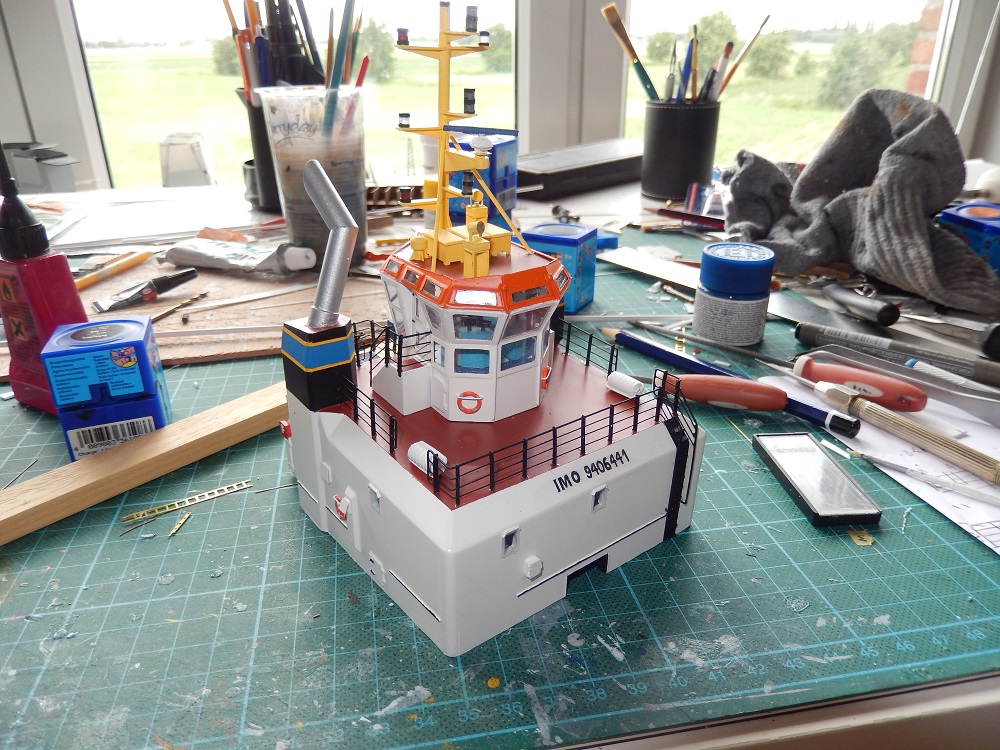

On the superstructure side however, I did a lot of small detailing. Finally finished the railing on the monkey bridge and added some small hatches and cleats to the bridge structure. It's also glued in place now, with the funnels and their supports in place as well. These connections do need some paint work of course.
I cannot make my own PE, so decided to bend the liferaft supports out of brass wire. Most if it is just one piece of wire and then the horizontal connections are seperate pieces of wire.

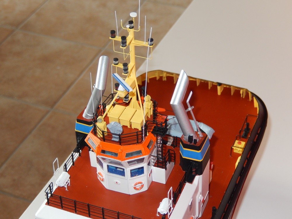

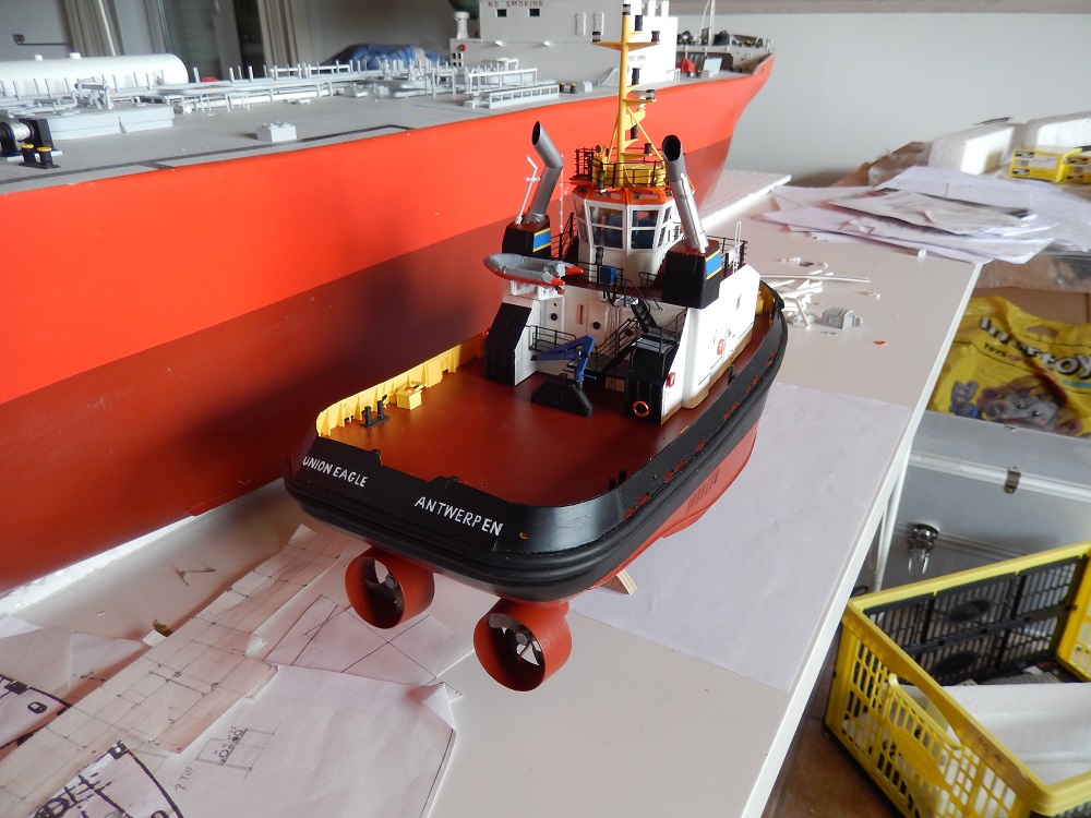

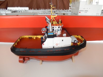

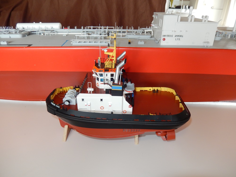

So here it is. Finally done.
The thread can be moved to completed models I guess. (that's a first for me in so many years :cool_2: :woo_hoo: :woo_hoo: :woo_hoo: )
