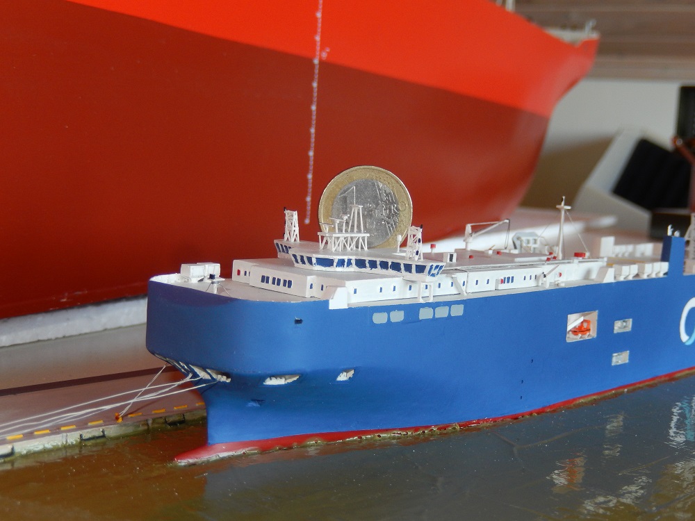

PostPosted: Tue Jun 05, 2018 2:59 pm
Posts: 2432

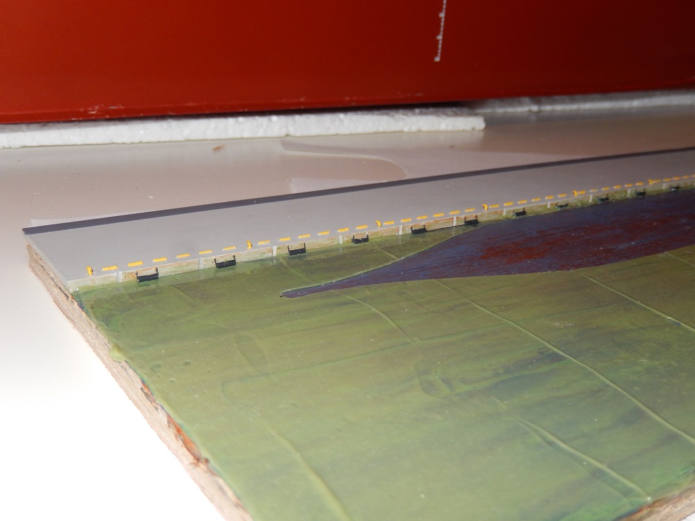

Currently I'm mostly working on the quay. Not exactly my strong point, but I'm exploring a few new things again. The side wall itself was given some washes of brown and green since in reality they look like that as well (not visible in the pics yet). The result looks ok so far.
For the water I'm exploring mixing acrylic paints with the acrylic gel and then I'll see if I have to apply it in several layers with different colors to get what I need. The water is very muddy in the inner port (as well as outside along the entire Belgian coast, due to strong currents).
For the quay, the dark edge is the start of the asphaltum, the lighter part is a stronger type of stones for heavy vehicles. They're always stored closest to the vessels.
The yellow pieces are stretched styrene, in reality of course they are a warning so that the cars don't end up in the water.
The bollards are made up of bent brass rod of 0.8mm dia. I then filed them straight at the end and flat at the top to resemble the real ones. I used a small jig again to make sure they'd have the same dimensions.
I drilled holes in the quay at the required interval and used a piece of 0.8mm rod underneath to make sure they'd all have the same height.

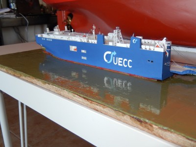

Ok, so I've proceeded with the remaining jobs.
First layers of acrylic after a couple of test runs. Eventually found out that mixing the acrylic paint with the gel before application actually gives better results than painting and then applying the gel. The pigment is more evenly spread compared to any wash and, depending on the amount of paint you mix in, the gel gives a transparency to the paint.

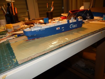

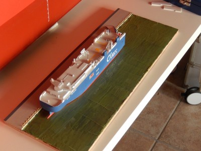

The ship is only placed for effect. I chose to completely "treat" the base with gel and later on cut out the hull outline to mount the ship.
In the meantime I have performed that cut and was surprised to find out how easy it was. Whatever I had cut out, came off pretty easy, much like a mask. I then applied a new coat of gel, with a little more brown mixed in, and then mounted ship (glued in place by the gel).
I needed to get the mirky brownish-green color of the Zeebrugge port (and North Sea as a whole).
The merchant shipyard

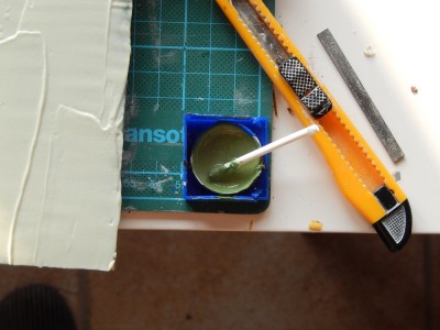

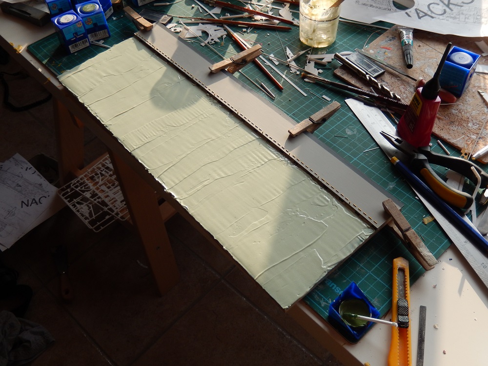

PostPosted: Thu Jun 14, 2018 4:08 am
Posts: 2432
Noticed I had some pics to show about the whole process. Didn't want to keep them from you.
The tricky part with mixing the acrylic paint with the gel before application is to estimate which level of transparency you will reach and which kind of colour.
Here you see some pics of the process. Unfortunately I had to use heavy gel since the shop didn't have medium available. So I had to mix it with water and paint, and due to this mixing I did get air bubbles coming out during drying.
Eventually the colour will be the colour as you mixed it in the jar. The difference in colour after mixing is basically the concentration of pigment = concentration of the final wash and transparency level. So the lighter your mixture, the more transparency your gel coat will have, but the colour will turn as dark as the original.
File comment: Here you see the mixed colour on the right and the final colour after mixing with the gel on the left.

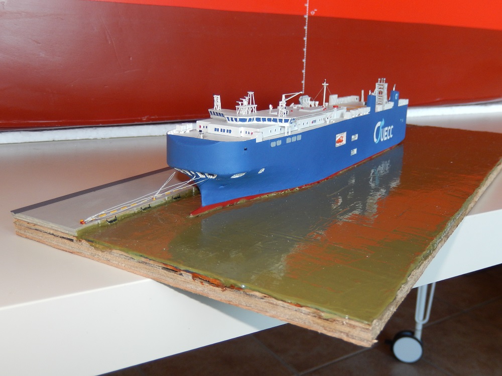

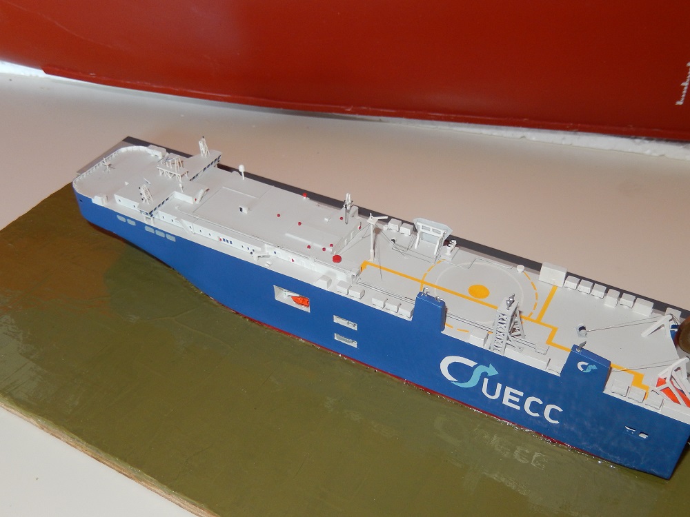

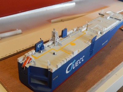

Finally finished this one. Not very happy with the mooring lines, but eventually learned how to work with it. They are small wires from a PC electrical fan, they're about the same thickness as a hair. I straightened them by rolling between my steel ruler and the table top. Unfortunately they are not stiff and therefore you have only one shot. If it fails, you have to roll it again to straighten it out again.
The mooring lines were troublesome, since Had to make the eyes first, then place them and try to tension them before gluing on the vessel. If the mooring area was open, this would have been easier. But with the closed mooring area, tensioning and gluing was difficult without bending them.
Eventually I decided to add more detail than I intended to in the beginning. It brings a bit more colour as well.
The stern gate wires are always kept slack in port, I suppose this is to avoid shock loads and lifting of the ramp if another vessel is passing close-by or if the vessel surges by the sea condition.
As for the green/brown water, this is normal North Sea water. Due to the strong current flowing through the shallow English channel back and forth (3-6kts) it brings with it a lot of sand and other particles, the water's very nutritious creating a mixture of algae and sand.
The inner port of Zeebrugge is connected to the North Sea by the locks, so this water also enters the inner port.
