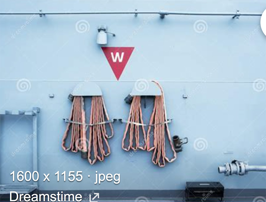

Coming along nicely! I think I figured out how to do the fire hoses. One comment, The usual method I saw for racking fire hose was to lay back and forth across the rack rather than circular coil. I certainly cannot vouch that this was the only method used. It did however avoid the twisting usually inherent in coiling. Unfortunately the bulwark hides many tantalizing details of the deckhouse.
These aren't a great example, probably a museum ship. Note that a strap is used rather than a bar. Bars might be more common (maybe). Modern ships have all sorts of clever reels and whatnot to spool hose off quickly. My photo of YT 138 at San Diego (1946) Is different in not having any hose racked on the stbd side so I couldn't tell anything useful from louping (Analogue pixel peeping). She looks a little stripped down, perhaps a post war economy.

Ok I see, tks Tom, I will modify.
It is not recommended to bend a fire hose so much, the rubber breaks under the fabric that surrounds it by force, and when you want to use it especially to put out a fire, it explodes at 8 bars of sea water pressure.
It is better to roll them up.
French ship regulations require the hose to be connected, as well as the lance. Ready to be used without loss of time. This is very useful, especially if the spanner to tighten the fittings has magically disappeared, which is often the case.
