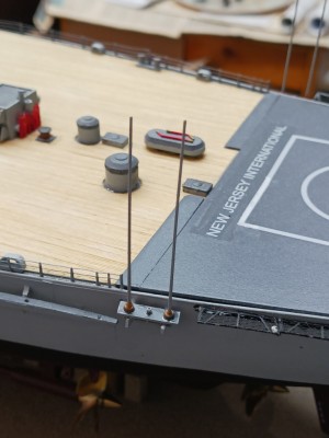

Currently, I'm getting close to wrapping up this Yard Period with the replacement of the stern UHF antenna platforms (P/S). And lastly, spot gluing the new 5" gun mounts in place will finish this very successful maintenance period. I should have some final photos to post after the work is complete.

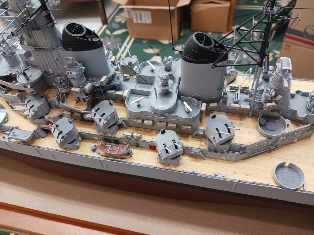

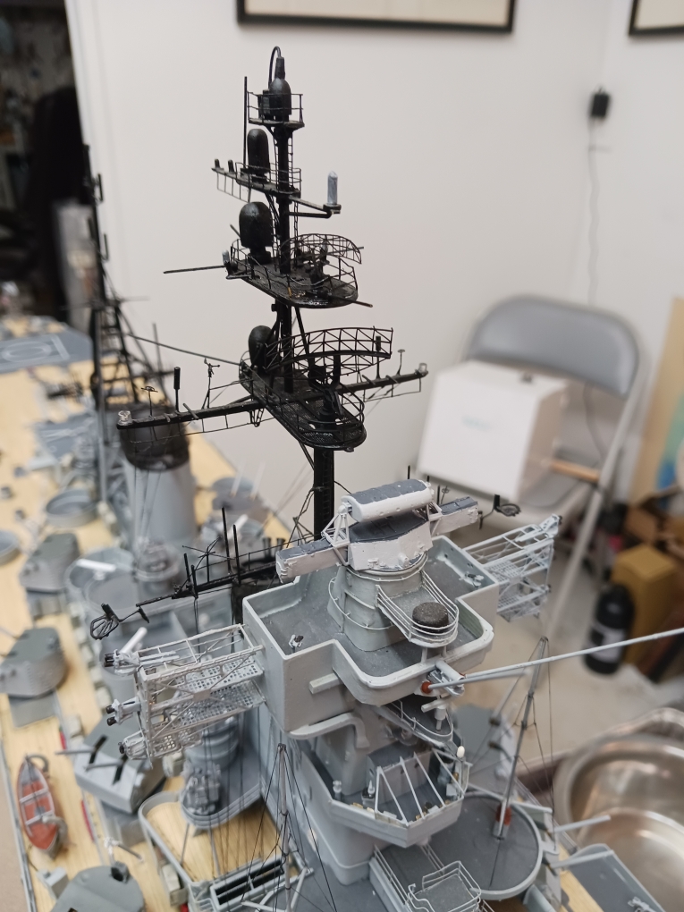

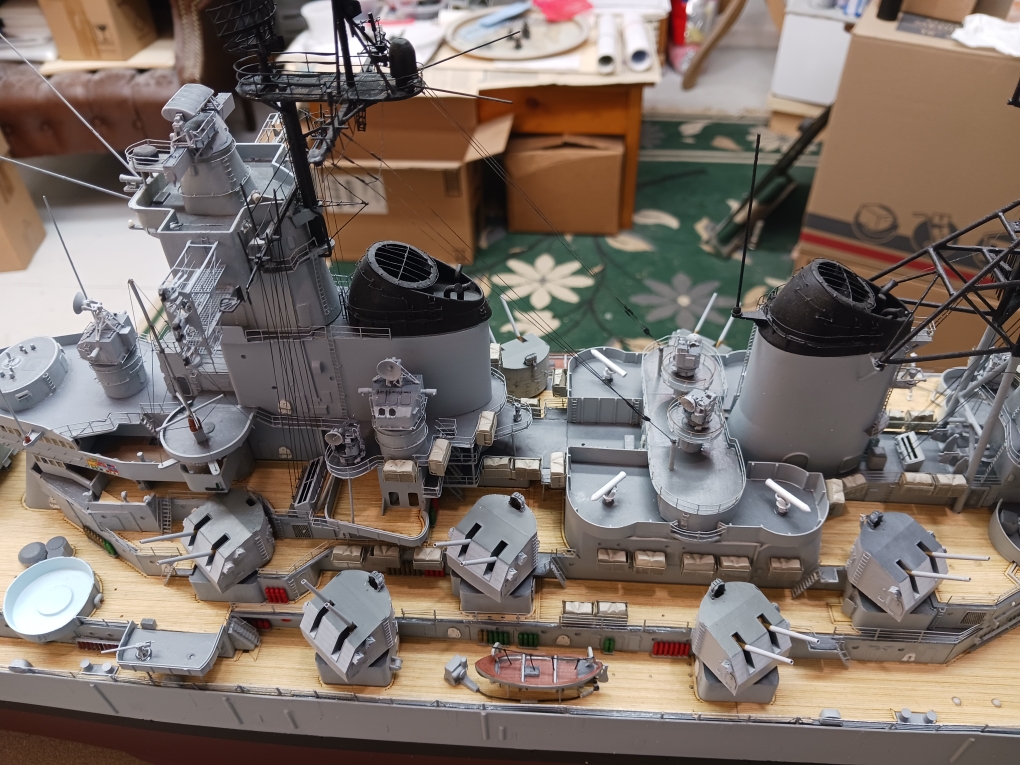

My Yard Availability period is now complete - a resounding success!! :thumbs_up_1: The following items were replaced during this short period:
(10) 5"/38 Dual Gun Mounts
(6) Mk. 56 Fire Control Directors
(4) 5" ZUNI CHAFF Rocket Launchers
(2) 6 pdr Saluting Cannon (added)
(2) UHF Antenna Platforms
All of these parts were 3D Design/Printed with a much higher level of detail than my own scratch built, original kit, or 3rd party purchased parts had which has given the model a much more detailed look. This was one of the main goals of this mini-project. Here are some photos of the completed overhaul -

Compare these photos with the earlier photos I posted prior to the replacement of these parts. Only thing left now is for requesting assistance from "The Admiral" for help in replacing the display case and then moving the model back to its proper location. I'm hoping that after self-DOGEing, the processing time for this request will be in days rather than weeks! :doh_1:

The re done 5" mounts came out quite well. Following your example I am yet (third version?) replacing my mounts on Missouri (1:192) as the very nice ones I have on there are the same as Alaska's and the wrong mod, having training buffers etc. They came out very nicely and the "hangup" is paint. For this ship I mixed my own colors and of course that paint batch is long deceased. Mixing paint runs in the PITA category of hobby experiences. I use a slightly different method of attaching them as there are magnets under the deck and I simply use a small recessed screw at the bottom. They seem to adhere strongly, are centered and rotate easily. When I do paint them I'll need to do the greased recoil sleeves!

Thanks for the nice comment! They ARE appreciated!! Isn't it great that when upgrades are needed, we can provide many of the (3D) parts ourselves?? As for painting, I agree - it's normally a PITA and one of the necessary "chores" in this hobby. As for the recoil sleeves, I was using two Testor spray colors, gold and gunmetal, sprayed one after the other while the first one was still wet; light coats, both. My gunmetal spray can is pretty much empty although I do still have one partial bottle of that color. The combination gave a somewhat "dirty" goldish result which was very close to the actual 5" gun barrel. These current barrels were done with the gold only but will have to suffice as is.
On this particular design of the mount, I used a 2mm dia. pin on the bottom and drilled out the according hole in the mount base on the model. I've spot glued each mount to keep it in place as once the display case is replaced, I don't want the mounts to fall off if something (such as a sneak Commie rocket attack) were to topple the model, etc. :doh_1:
