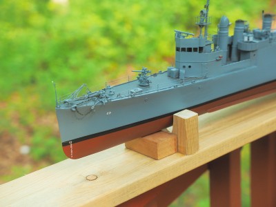

A little closer view of the Foredeck with the unusual stocked anchors and handling arrangements. However they did, as with later destroyers feature a single anchor windlass. The DMS's were mostly refitted with the light weigh 3"50's as also found on many DE's. Two objectives, reduce top weight and provide a degree of Light-Medium AA capability as Bofors were not able to be fitted due to weight. For close in capability 5 single 20 mm's were allowed. At some time the 3"50 was able to be fitted with the VT shells though I don't know the exact time. As the 40 mm Bofors was not able to be so equipped, this eventually led to the 3" weapon superseding the 40 mm to a great extent.
As newer DMS became available the four piper conversions were relegated to AG duties, towing targets, running the mail and other such general auxiliary duties. As the air threat increased near the Japan home islands they became increasingly vulnerable.

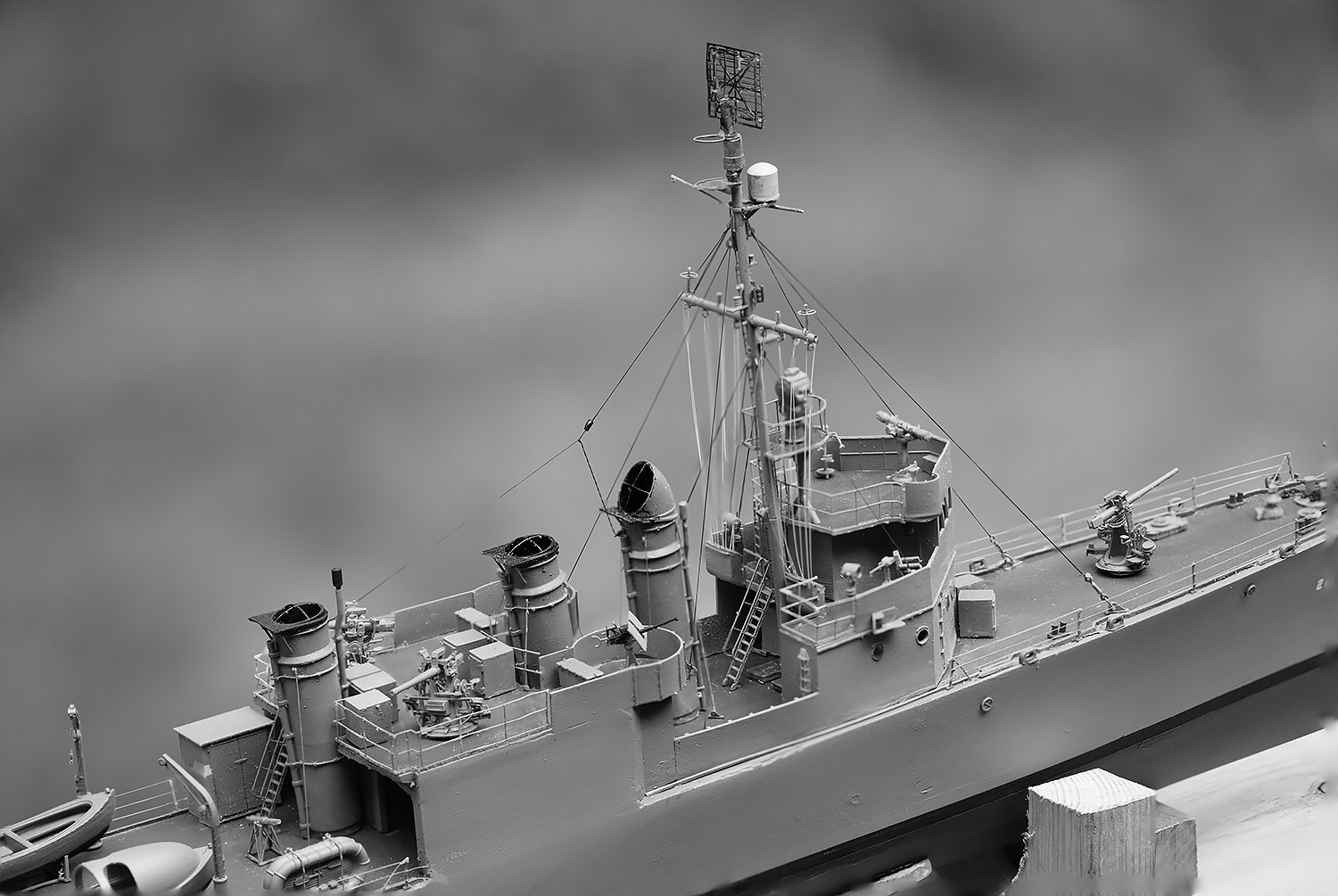

Some minor progress! Halyards and standing rigging added, Long wire HF antenna, new rangefinder, Handy Billy's painted red, new gaff and upper mast platform. Halyards are a bit tedious! Ah yes, 3" practice loader just aft of stock 3.
