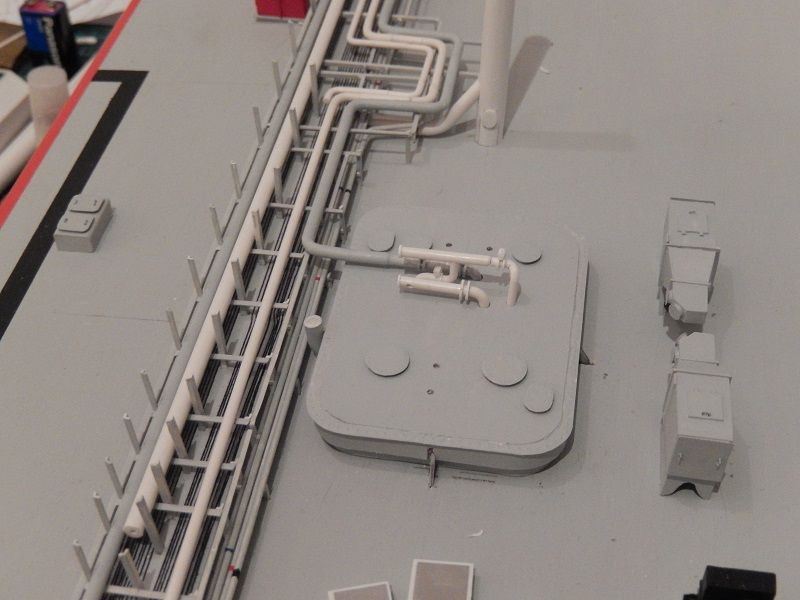

And I've continued a little on the aft piping again, "terminating" the liquid header to the pumps and back to the tank. I guess I'm nearly ready to start painting and glueing of some pipes. First have to put some additional detail and supports to line them up correctly.
The small pieces on the line are various flanges and valves. I still have to glue them and put some finishing touch.

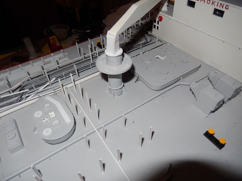

Continued a little bit. Done some final jobs and first layer of paint on several objects/sub-assemblies.
Here is the crane base, the upper part and jib I'll have to rebuild since they are of wrong dimensions.
Some deck view, I've built part of the condensate system for aft cargo tank, slowly the tank dome is getting crowded. I've also nearly finished the discharge valves of the pumps aft, just a stanchion (performing job of spindle) and a wheel. I saw some 5-spoke wheels at the scalelink site, but with shipping it'll cost a lot. I'll have a look around in some train supply stores etc.
Close-up of the valves on the condensate system. The change in diameter of the line is real. The thick part is just insulation, the wire near the valves is the actual pipe. Both pictures are of course very zoomed in. The actual diameter of the wire is 0.8mm, the part with "insulation" is 2mm styrene.
As you can see I've also made small supports with holes, those holes will receive a U-bolt to keep the pipe in place.
Up till now I've also glued the vapor line in place because I had the yellow for the color coding. I'm stuck there since I don't have any dark orange available for the liquid line and gradually I have to fix them to get the final lengths and lay-out of certain parts.
