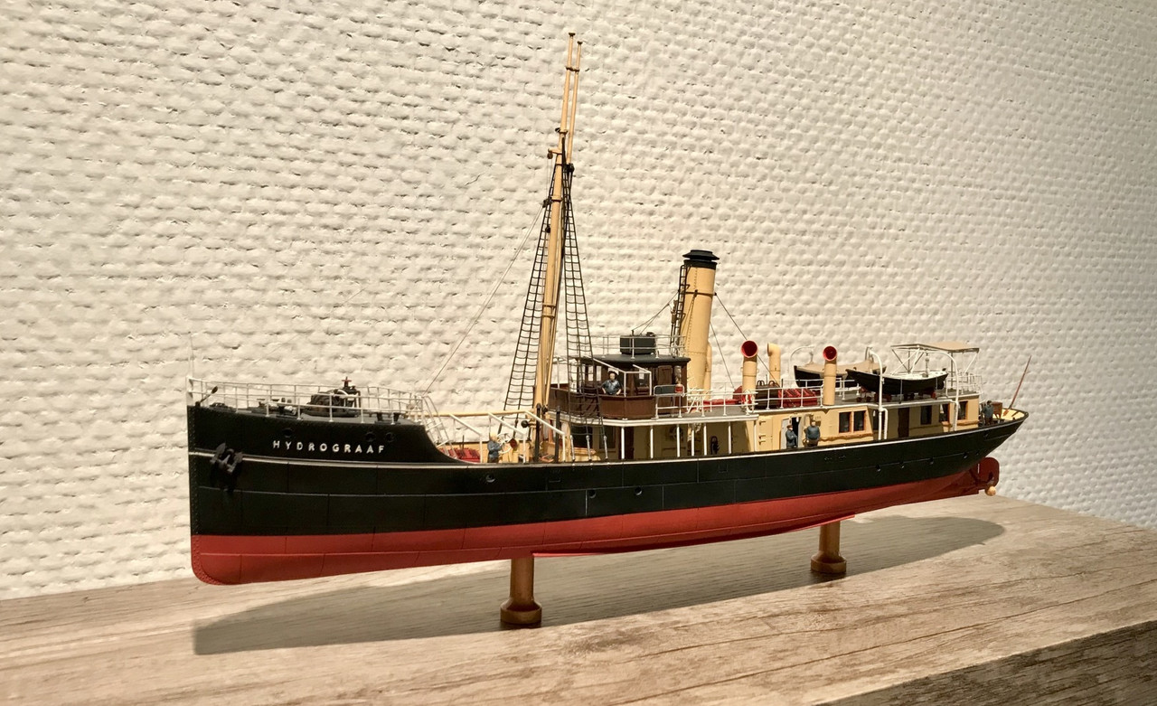

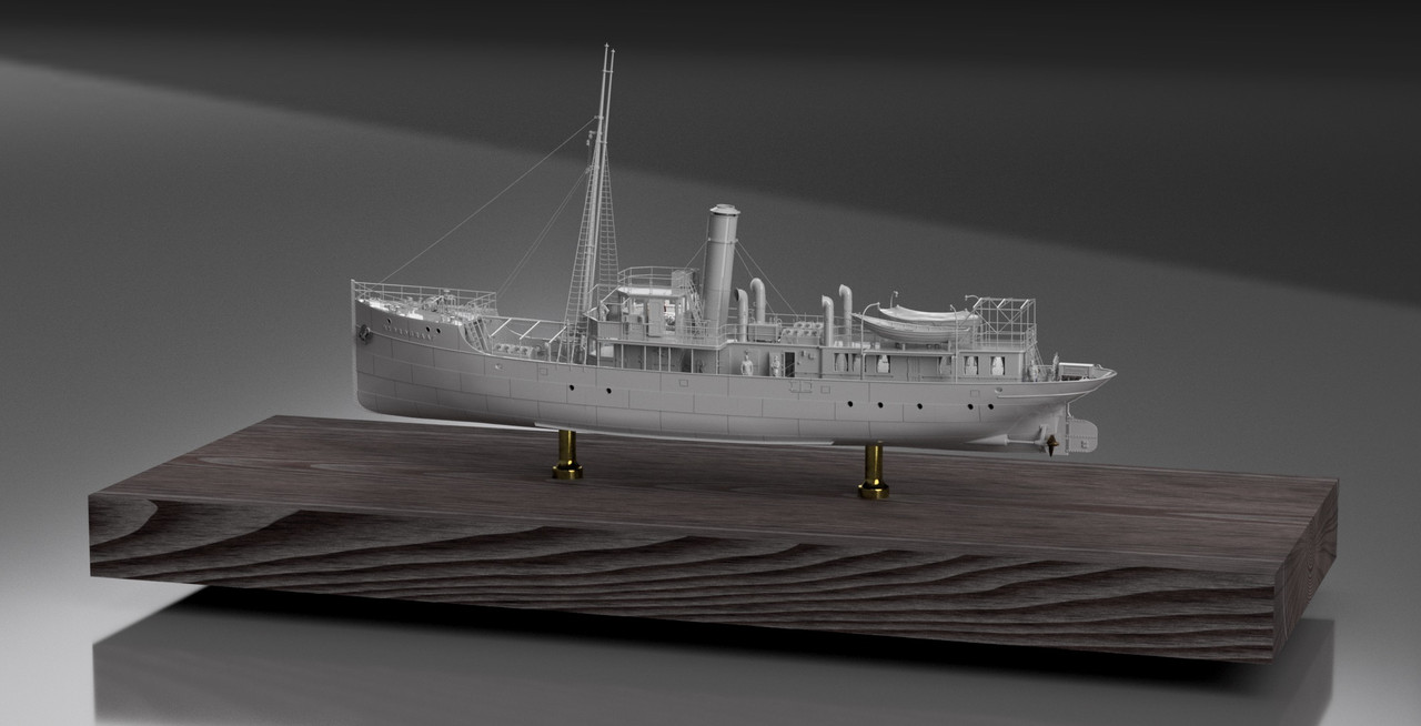

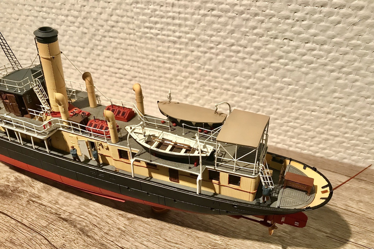

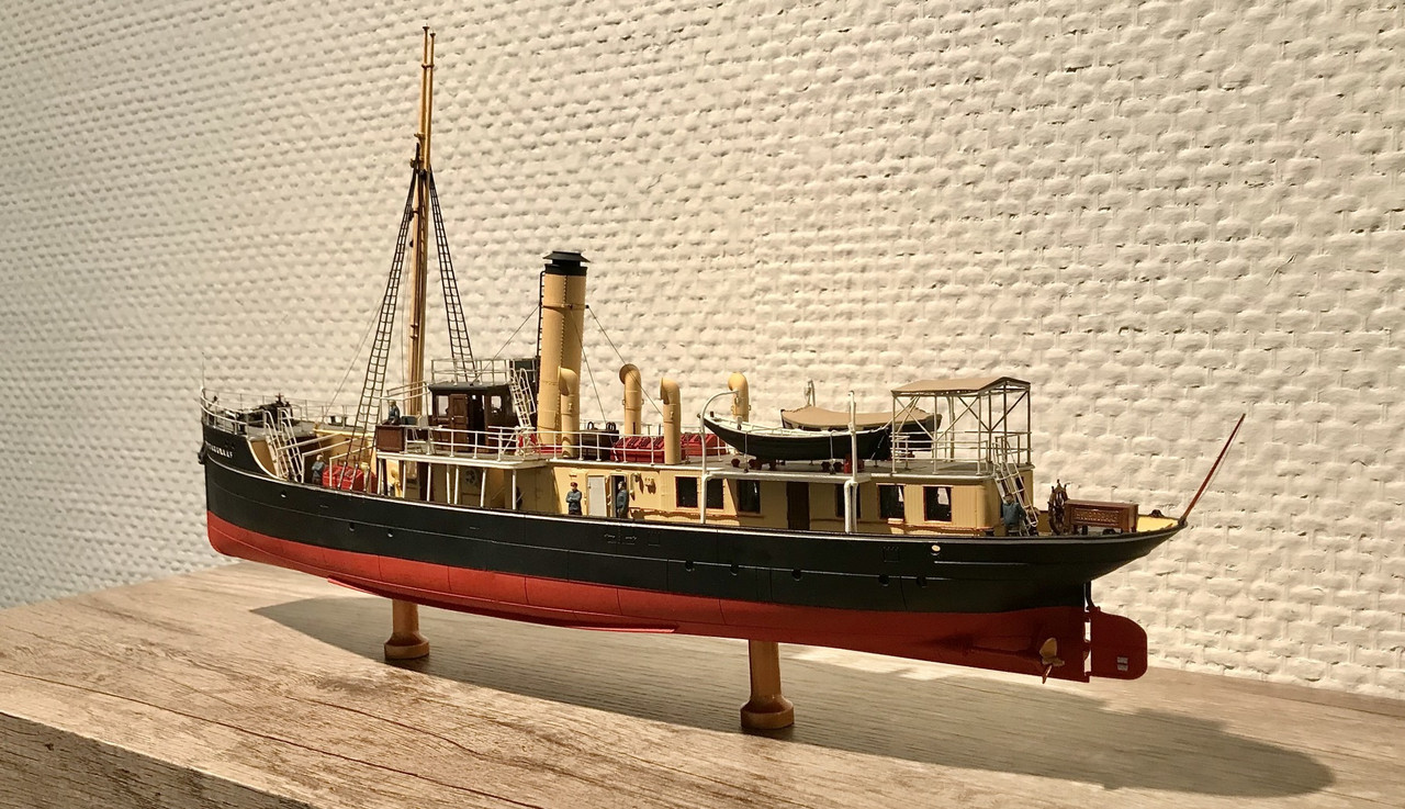

The second boat is finished, I redesigned it at 50% adding the clins this time. I modified the first front pair which seems to be badly drawn on the original plan.
I've been focusing on the final paint details and small repairs the last few days.

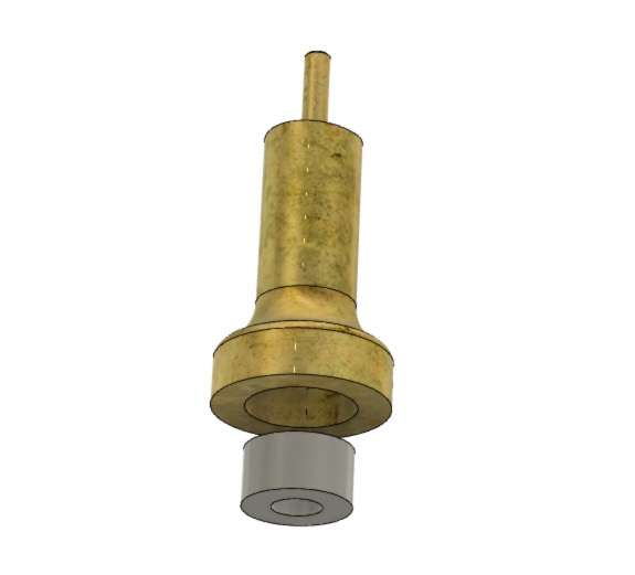

The support pillars of the ship have been printed, a 4 mm nut embedded in the support allows a good fixation to the support. A piano wire reinforces the whole in the upper part.
I still have to mount the navigation lights on the front mast and the one on the back mast, and the brass name plate to engrave.
Pascal

An advantage of a civilian model is the variety of colors which add interest! As to figures I have been looking for suitable USN figures. I did find out a PT Boat crew in a very large scale and somewhat expensive from a printable file. As a STL file I suppose they could be reduced to 1:120, they have helmets and life jackets so could man various position, though a little warlike for a repair ship. I remember you had various "swabbies" for your 1:200 tanker?
Hydrograaf is quite a stunning small model!

A wonderful and detailed little ship model - well done!!!!

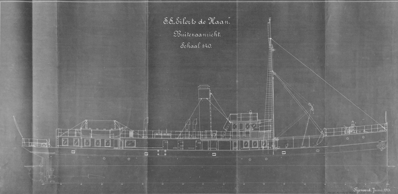

The Hydrograaf had a big brother, a little longer by 5 meters, but less lucky, the M/S Eilerts de Haan.
M/S Ellerts de Haan was a hydrographic ship of the Dutch Navy, built by the Rotterdam Fijenoord shipyard. (1921)
During the German attack on the Netherlands in 1940, the ship was in the port of Den Helder for conservation purposes, which meant that it fell into German hands.
The German armed forces converted the Ellerts de Haan into a school ship and renamed it Randzel. The ship was lost in service while being used by the Germans in the Baltic Sea in the spring of 1945, when it ran aground south of the German island of Fehmarn.
The ship was named after Johan Eilerts de Haan, a Dutch naval officer and explorer who died in 1910 during a voyage to Suriname.
Johannes Gijsbert Willem Jacobus (Johan) Eilerts de Haan (born in Noordwolde, October 3, 1865 - died in the interior of Suriname, August 29, 1910) was a Dutch explorer and soldier. The Eilerts de Haan Nature Park in Suriname is named after him.
Pascal

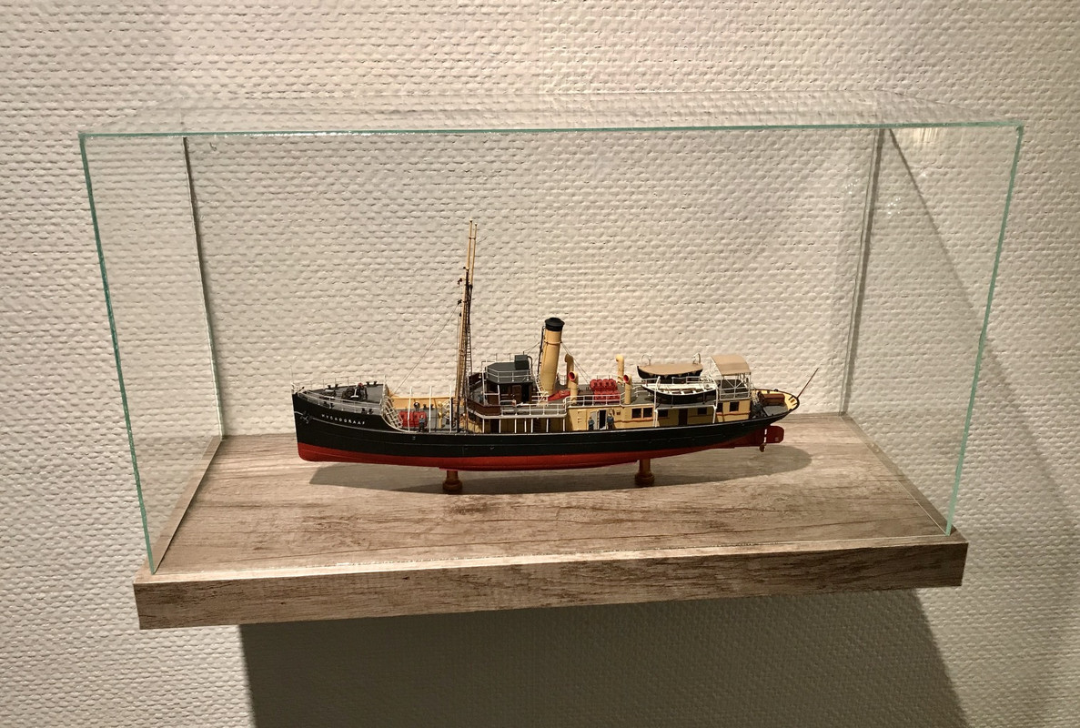

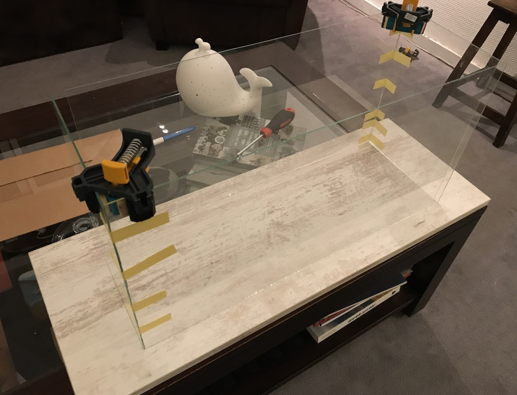

These brackets/shelves are interchangeable by removing two screws, so I can change models from time to time. Very practical.
Making the display case, thanks to Bruno ( Bgire) for his tutorial.
https://www-laroyale--modelisme-net.tra ... x_tr_hl=fr

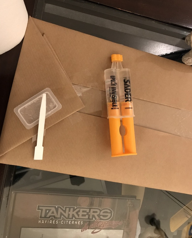

I still have the brass rods to cut and glue. I used Sader epoxy crystal, it works very well.
I also used Wolfcraft ES22 brackets that I modified by gluing balsa shims to make them accept 2mm. thick glass.
Pascal

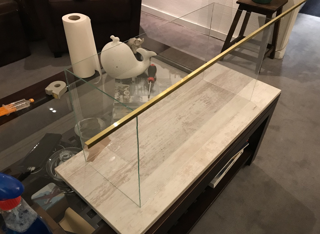

Some progress on the display case.
I cut and glued the 8mm brass angles, from the excellent Tartaix company, it is sold by weight.
Reference: L2CLE1/8
https://www.tartaix.com
I've already spent at least 3.50m of my 4m in stock, I should have enough to finish before Christmas as they are on holiday after that. It's glued with the same glue. If it goes over, a razor blade is enough to remove any excess glue.
Pascal
