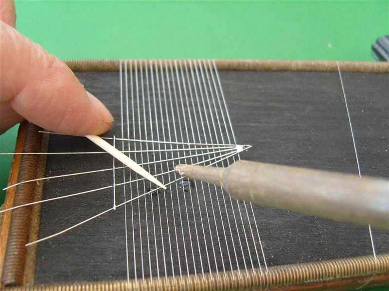

I'd like to see how you assemble your ratlines... You are using copper wire (from electric cable?), how and with what are you gluing it?
:thumbs_up_1:
PostPosted: Fri Nov 16, 2012 12:49 pm
Joined: Fri Aug 19, 2011 10:40 am
Posts: 197
Location: Lancashire, England
I use tinned copper wire 38 swg. It is not glued, but soldered. I wind the ratlines on a frame obtaining correct spacing via threaded rod glued along the sides. The shrouds are also tinned copper wire a bit thicker, soldered on. Really not all that difficult. If you have the patience to put ships in bottles, you should be able to build ones like mine. But most modellers set themselves at a disadvantage by stating "I could never do that!"

Hi Bob
are the shrouds flush with the base of the winding frame-- ie that when you apply the soldering iron the foot-ropes do not deflect the shrouds--or are the shrouds set up so taut that no deflection occurs?
I am thinking of a similar set up for making ratlines for an upcoming transitional sail/steam ship,
however it will be in half the scale at 1/700-- so the material thickness will be half or less-- will it still work in copper
or should I use stainless steel or tungsten wire and use glue?
thoughts and advice appreciated!
Jim Baumann
PostPosted: Mon Nov 19, 2012 4:17 am
Posts: 197
Jim,
The ratlines are above the base of the frame by the thickness of the threaded rod glued round the edges! When I run the iron along, it is only done lightly, certainly not enough to push the wire down as far as the base. The wire is tinned copper and you can get it much finer than I use and it can be soldered easily enoigh. The biggest problem with finer wire is that when it is cut from the frame, it is much more delicate and the biggest problem is fitting it to the model. But as you are used to very delicate work, you may not have much trouble with it. Also, do not rely on the solder already on the wire, put a bit on the iron as well. If it runs over and fills up a gap between ratlines, no problem - just heat it up with the iron and poke the point of a cocktail stick in to free it again! When soldering, it is important to use liquid flux. I use Baker's Soldering Fluid, that has the consistency of water. Plumbers use it and it is available on Ebay.

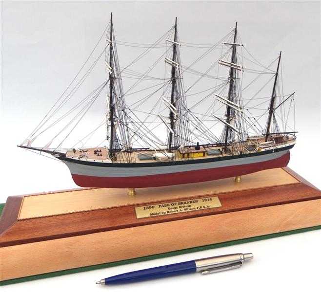

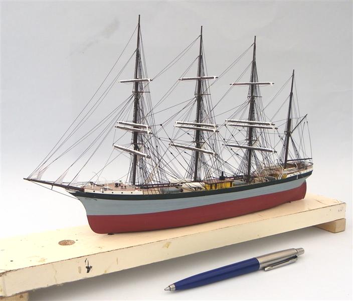

Completed Sunday, 25th November, 2012.
Bob
File comment: Pass of Brander
