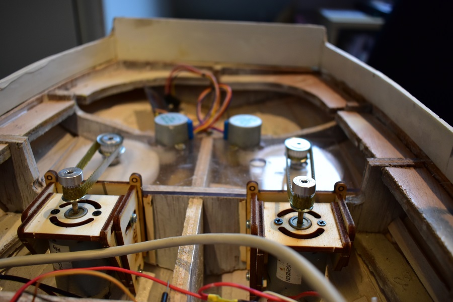

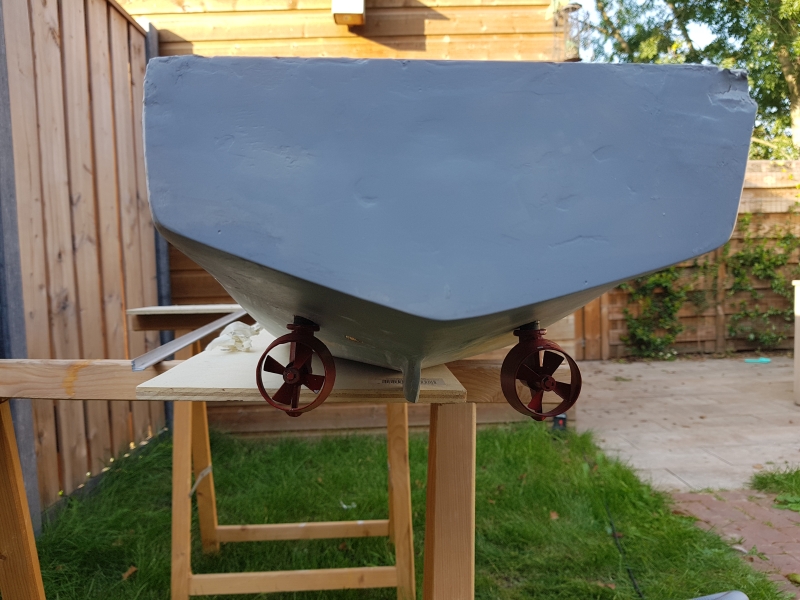

Hello guys,

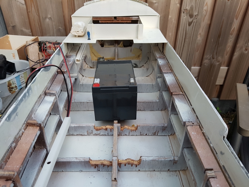

It's been a while, been mostly busy with the little one in past months. I have been filling and sanding every now and then though. But this week I felt it was time for something bigger, something with the propulsion. See the result below.
I've drilled the holes for the schottels after having decided to use the old schottels from the first attempt after all. I also modified the gearwheels to fit the schottels. The gearwheels and all components fit quite well though a few minor modifications will make things better still.
I also started adjusting the keel and frames so the battery will fit a bit lower in the hull. I will make a nice box to fit the battery so it can't move about and also to reinforce the hull since cutting in the keel and frames will somewhat weaken the hull.
I also received the new Raboesch Bowthrusters which I will fit inside the existing tubes in the near future, if weather permits it.
Greetings Josse

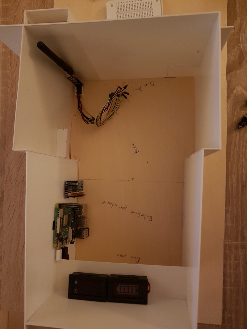

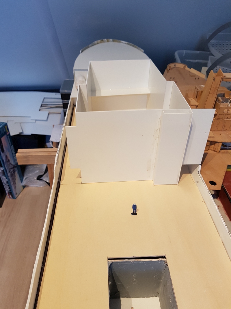

It's not much visible at the moment, apart from the walls of an entire superstructure. I've mostly been focussing on getting the programming to work with a major succes now! I finally got my PWM modules to work!!! That means a great step towards controlling the engines and bow thrusters and later on cranes, cooling water pumps (simulating only harbour generator running, 1 or 2 main generators running) fire pump (first one got in during the holidays) and the ROV.
I also made a document which shows all the functions listed in 2 categories (PWM and on/off) in which I also fixed the communication adresses for the device which will activate the function (I'll use both PWM modules and 16 channel port expanders) and dedicating a command for them. Furthermore I made a wiring diagram using Fritzing for the entire boat to give myself some idea as to what goes where. Add to the wiring a battery status indicator (which is quite bright for my purpose) and a volt/ amp meter (I'll use 2 since the amp meter can't handle more then 10A which is reasonable to to be exceeded under heavy working conditions. Therefore I will use 1 for measuring the power towards the propulsion systems (engines and stepper motors) and 1 for all other functions.
File comment: First my new hobby room is starting to get some shape

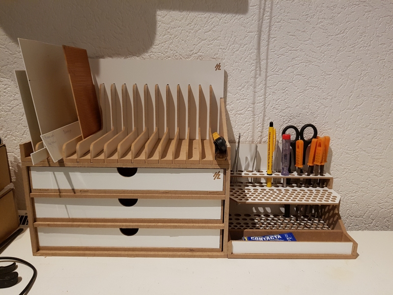

First I got myself some nice additions to my new hobby room.

This is the dive-area which will house the Raspberry Pi and the main fuses.
Dive-area with a test lay-out for the electronics.

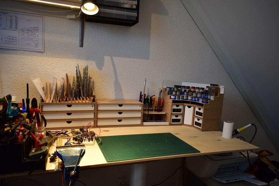

Hey guys,
I got some work done in the engine room now that my new hobbyroom is finished.
I put the engines in the right position to have the V-belts under proper tightness, I only need to properly attach the gearwheels on the engine shafts. I also attached the gearwheels to the stepper motors and placed the stepper motors. The holes for the gearwheels are large enough to fit the gearwheel through so I don't need to remove the entire plate. Fitting the gears proved a little difficult since the plastic gearwheel is too weak for M2 threading so I had to make a hole in the stepper motor shaft. I only need to make a proper place for the stepper motor controller.

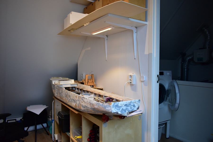

This is where the boat is placed now, a much better place then the shed where she was before.
This is the working room, though I will still be adding more Hobbyzone stuff for storage and for my tools.

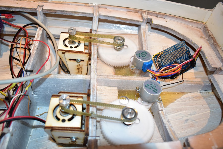

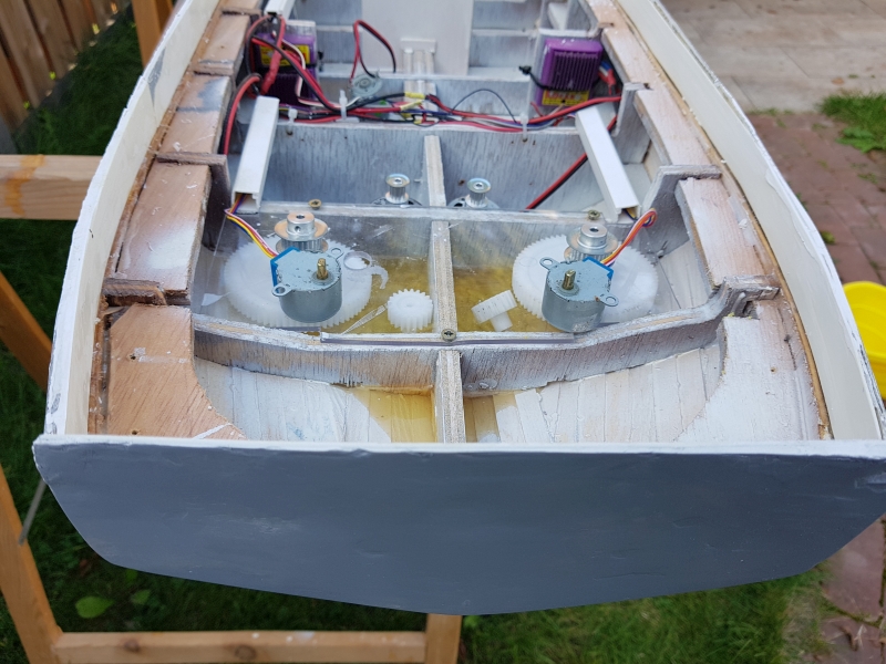

Hey guys,
It's been a while, been very busy, partly in and around the house. I've added a 3D printer to my list of tools now so I can make some more difficult shaped parts more accurately. It's been used quite a bit now and it works very nicely. It's a great addition to my toolbox!
First of all I continued to upgrade my hobby space, though there is more to come in the future.
I made the plates for the new transmitter, so it was time to see how the 12 joysticks will look, though 2 are missing here being used in a test set-up.
There will be at least 4 of these 3D printed sticks on the transmitter, 2 solely throttle sticks, the other 2 mounted atop the disks for combined throttle and steering control. I might add a 3rd of these for future projects. The transmitter will be dominated by the newly arrived 10,1" touchscreen for which the new transmitter had to be widened by 10cm so the wiring has the room it needs.

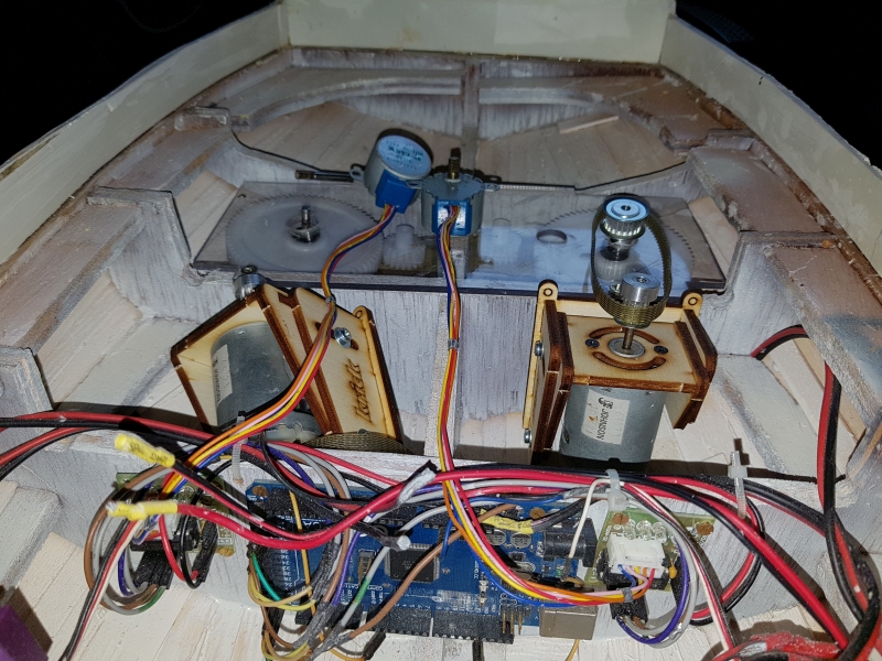

Electronics in the bow are starting to be arranged bit by bit. The small boards house 1 port expander (16 I/O functions) and the others a total of 5 relais needed for the somewhat (above say 10mA) more powerful functions here.
Quite chaotich wiring and hosing right now, once all the parts are in I will clean this mess up to make things reconicable.

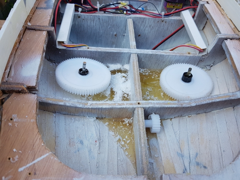

I've been modifying the gears for steerings the azimuths a lot due to my 3D printer printing a little bit smaller then the actual model is. This is somewhat frustrating when all the measurements where taken with a digital calliper.
Lot's of electronics, there's no other way to achieve my goal. The small blue PCB will control 16 servo's and motors, the larger 1 will control the rotation of the main crane and the small crane on the rear deck by means of stepper motor.

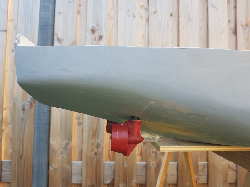

Since my last update I have been filling and sanding like it was going out of fashion. The result is there now!
This was after the 3rd time applying primer since the first 2 times only revealed yet more bumps and dents.
Now the first side of the hull has been fully painted, though I do need to straighten the waterline since some paint got under the tape.

The transmitter extension is now fully wired. This was not all to easy because I insist that the wiring and electronics inside the extension make sure things work as intended instead of controlling this using the Pi in the transmitter.
The last 2 types of PCB I designed arrived. I placed the stern PCB more forward then I originally intended due to the room in the stern needed for other components.
The stern will be quite cramped with the propulsion and crane components. Since especially the bowthruster engines give no room whatsoever to connect any means for registring the revs I decided to try Hall effect sensors to the side of the engine housing, hoping that will enable me to register the revs of the engine.
Because of the room needed for the pumps and interior in the bow I decided to place the bow electronics right next to the centre electronics.
This also fits a lot better.

Hey guys,
Recently I discovered that my newest PCB's have some design faults. First of all, both have the chip connected to the ground through 2 ways, one of those ways should have been connected to the + so now the chips wil not work. To make things work, I apparantly found the correct + on the chip when I worked on the superstructure PCB design and thus connected a 3,3V voltage regulator to the + of the chip and therefor also to the ground on the I2C. The result when powering up was some smoke and a tiny flame from the voltage regulator. The design has been modified to correct the mistake.
While connecting more and more I2C devices (everything is connected now) I found that the power this draws from the Pi makes the voltage drop too low so the Pi won't start. This still applies when powering the Pi from a USB power socket from the wall. This issue has now been resolved by using the 3,3V regulator on the hull PCB's.
Since the superstructure PCB's all have there own onboard 3,3V regulator I don't need a + cable attached for the I2C. However, the voltage must be within a range of 0,7V difference for this to work, so if the lowest voltage is 3V, the highest cannot exceed 3,7V.
Next wednesday I plan on testing the main engines controlled by an Adafruit motorhat. Is that test fails, I need 2 new ESC's. The first 9-DOF sensor has been placed all the way back, hoping to have as little interference as possible.
I might make a nicely 3D printed support here but this is way better already.
This PCB as intended to be placed further back, but there was no room there. This is the next best thing.
The final version of the transmitter is starting to take shape as well. Unfortunately I run out of black PLA filament, but since there were quite some bumps which need to be filled and sanded I also need to paint the entire transmitter anyways, so it doesn't matter anymore what colour PLA I use.
