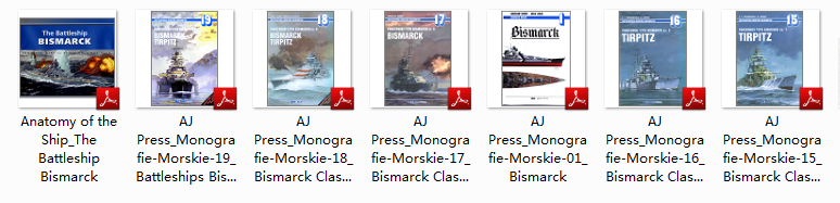

I have AJ's book,
[Halinsky] Battleship DKM Bismarck,HMV-2005-Bismarck Sixty million pixels,GPM_Battleship_DKM_Bismark,I have all these books. if you have the need, then I can send to you. Both are PDF.
File comment: AJ BOOKS

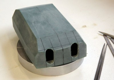

Hi,
finally some progress. A few months ag I started to research Bismarck´s main battery. I am using green Ureol which give you the chance to get sharp corners and edges! At least when you sand like hell!! :heh: :smallsmile:
File comment: Adding the embrasures.
File comment: Test fitting the barbette and guns.
File comment: Gun mantlet details.
