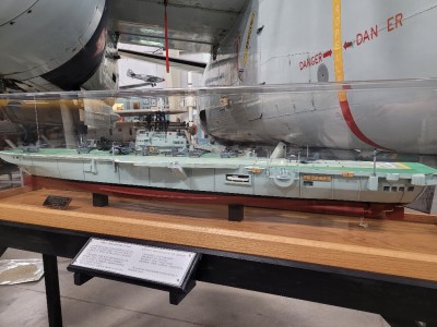

Some more progress pictures on the air det and other bits...lots of work to do.

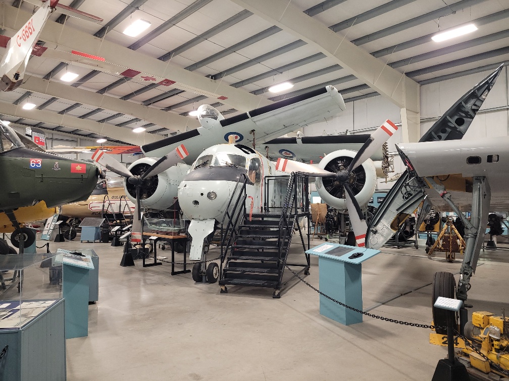

Visited one of the local aviation museums and had a peek at their 1/200 scale model of the Bonnie for some inspiration. Also got some detail pics of their Tracker. Alas, not in Bonnie-era markings.

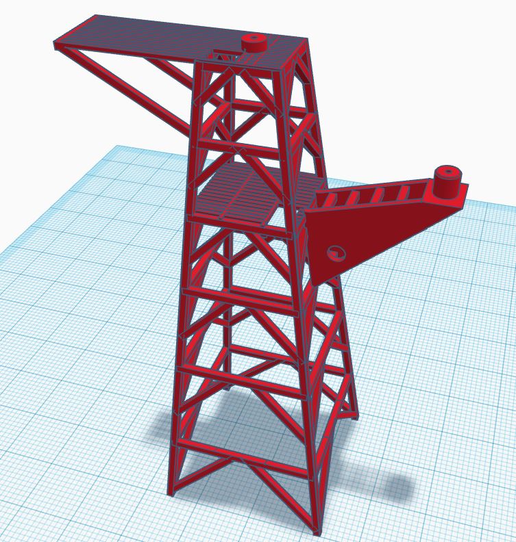

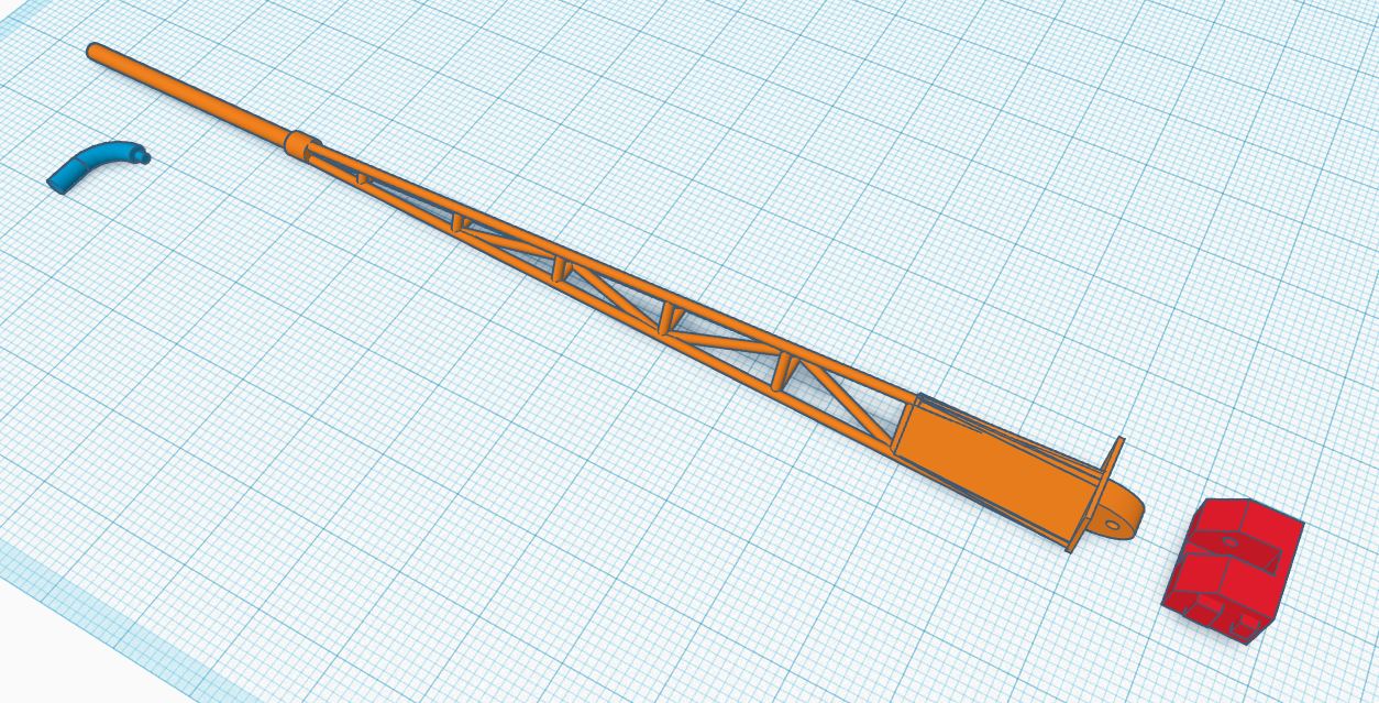

A bit more 3D design work today - here's version 1 of the "hockey stick" folding radio mast.

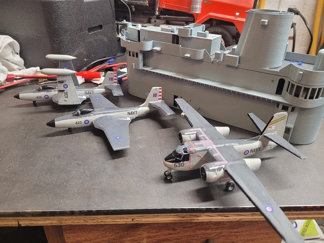

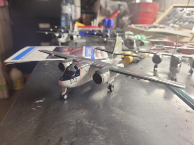

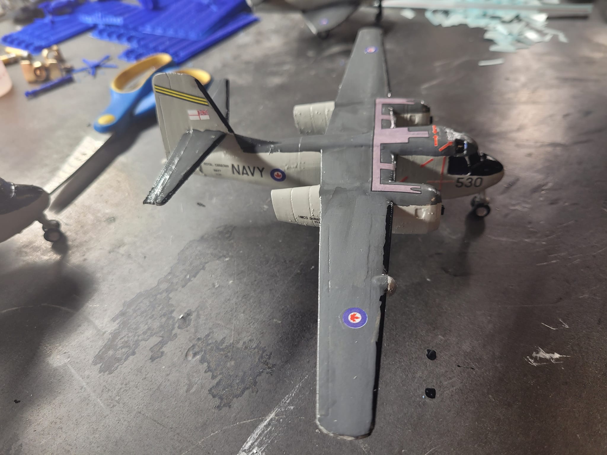

While I'm waiting for my 3D printer to be free (printing a test module for my anchor system!) I decided to hide in the garage and work on one of the Trackers. I was initially only going to do some of the decals...in the end, I put them all on.
Here's Tracker 530 in her full plumage!
There will be a couple of layers of clear-coat added to seal things up, but this is 1 of 8 Trackers complete...to go with the 8 completed Banshees in the background!

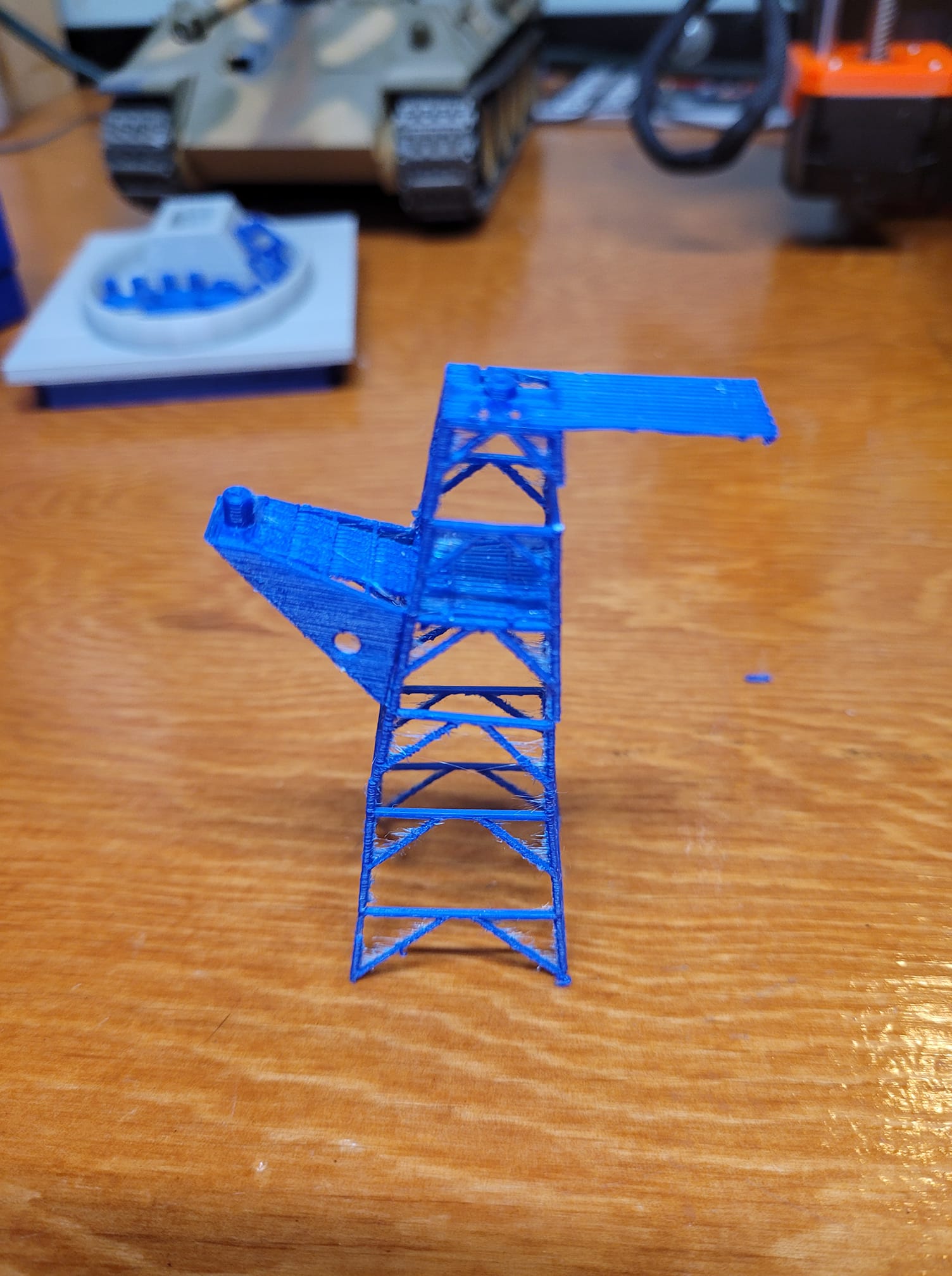

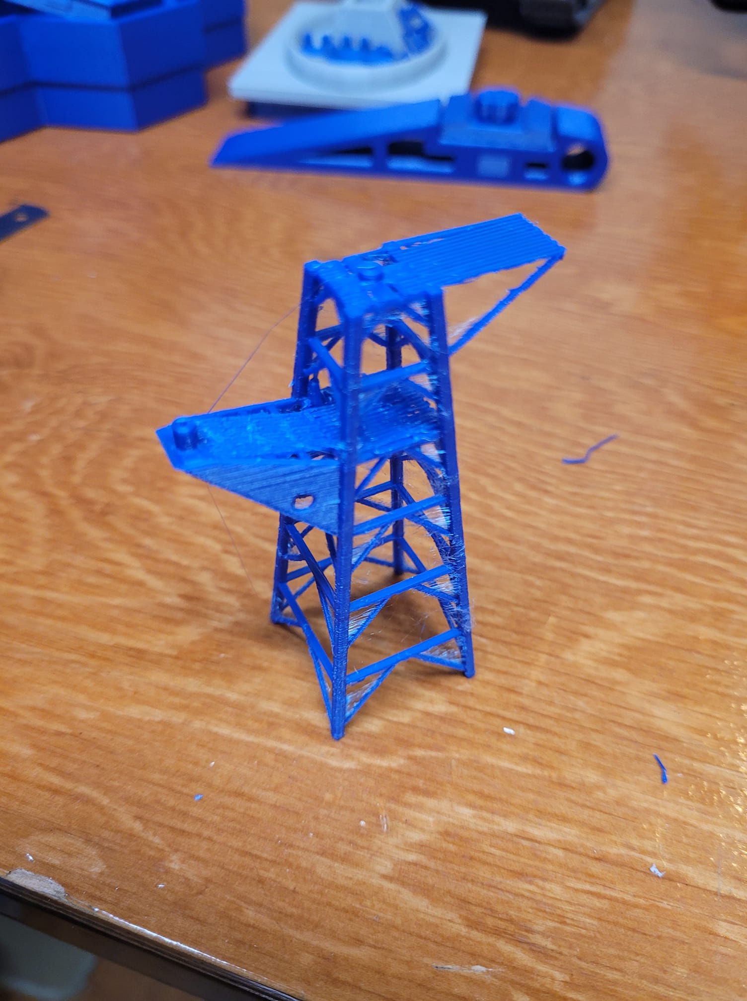

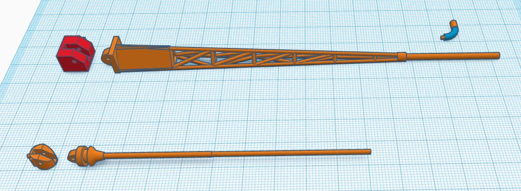

And here we have another Radio Mast with base added.
I'm tracking them as being 30 foot antennas, but in looking at some of the pictures, there are identical base units for some 20 foot antennas too...so I'll just print a bunch of them and snip the ends off to get the right size!
The draft version of the Hockey Stick mast is complete - I'm generally pleased, but have added some additional braces/stiffeners in the Version 2 model...I'll try printing one of each of these when I get home with reduced supports and we'll see how they look.
Other piece of good news is that my Anchor Test module finished printing last night, so that's going to keep me busy over the weekend.

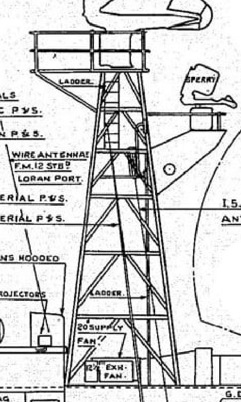

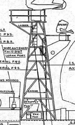

Had a bit of time today to plug away at some RADAR masts...
I had previously attempted to create the main mast and had some...issues...with my design in DSM, so I decided to go 'simple' and try Tinkercad for this one.
Here's the drawing I worked from...

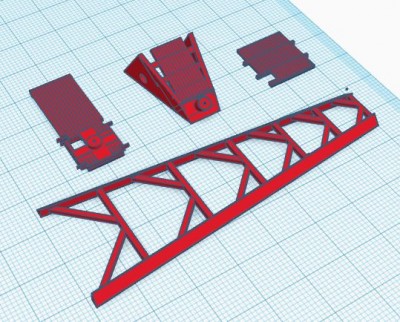

And here's the 3D version ready to download and print. I'm thinking I'll try this one with 'no supports' just for S&G to see what happens.
I suspect I'll need to do this with 'buildplate' support.
Bear in mind, I'm using an FDM printer, so things are a bit different for me compared to those using resin printers.

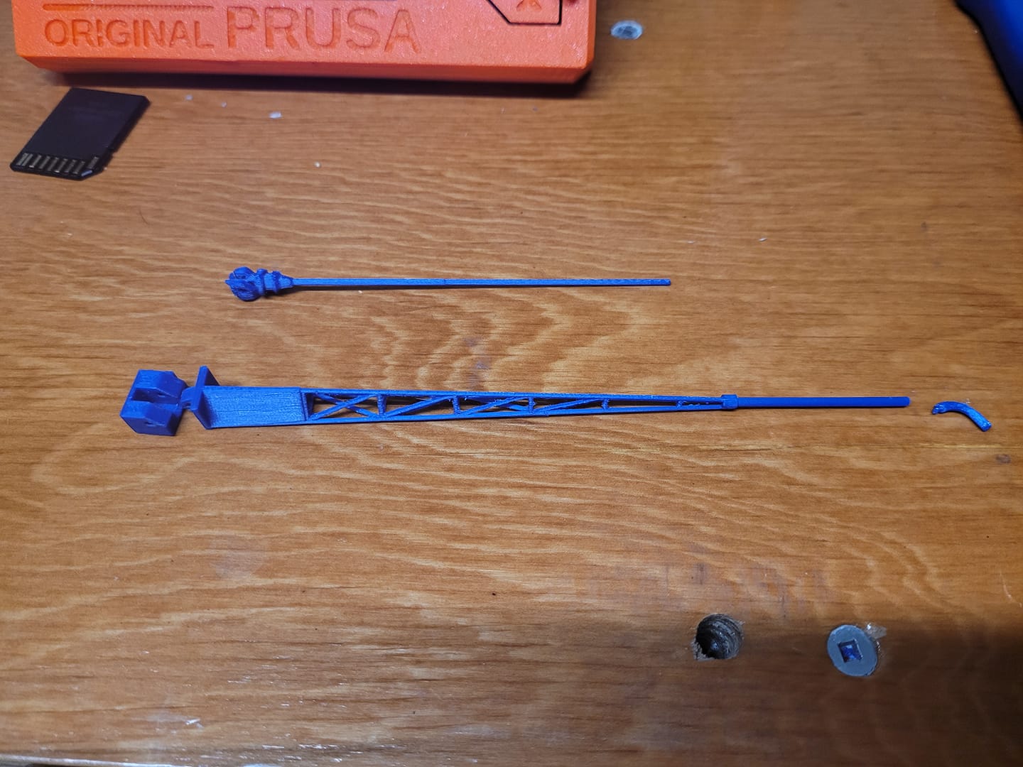

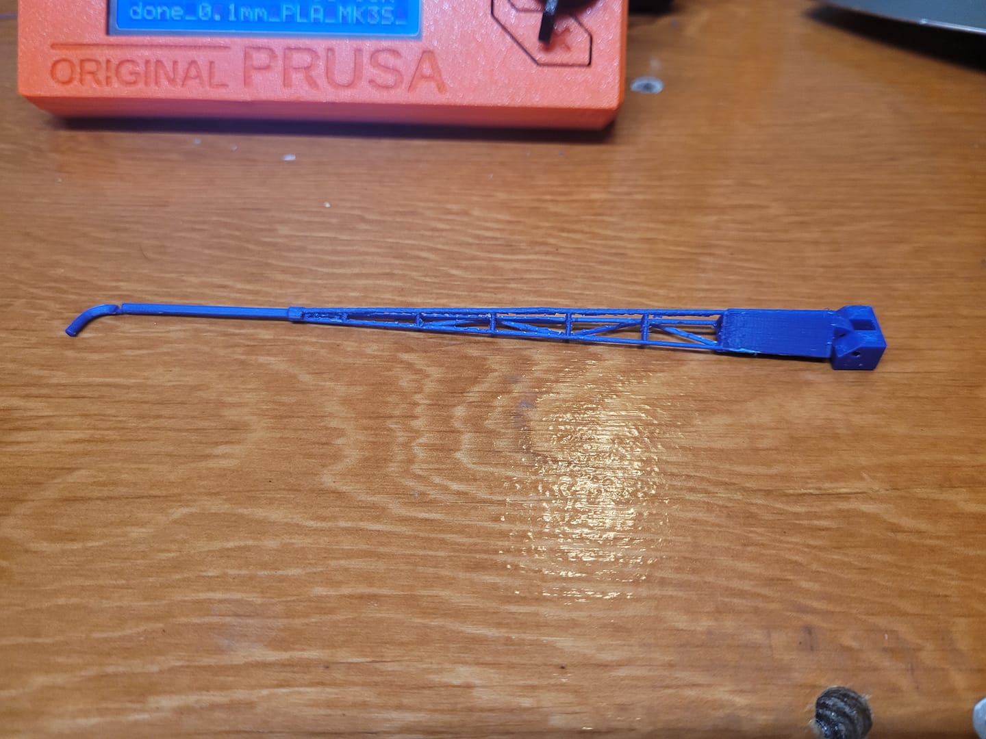

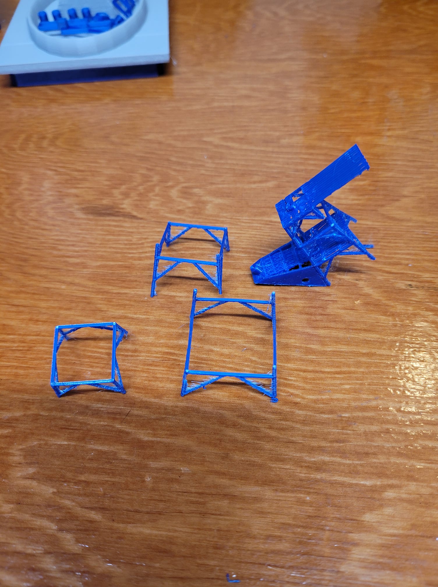

OK, so 2 prints tried, and now I've taken an idea from a buddy in another group and have split the mast into sections that I'll glue together.
The first print failed hard - it was, well, not good. Way too thin, so I had to increase thickness on some parts to make it workable.
The print that was waiting for me this morning worked better, but still not very nice looking. I can probably clean it up and make it work...but I figured I'd try chopping things up and see how it goes.
We'll see how this comes off the printer and go from there.

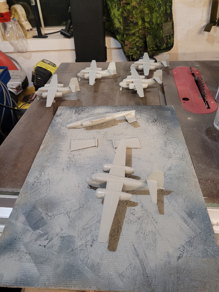

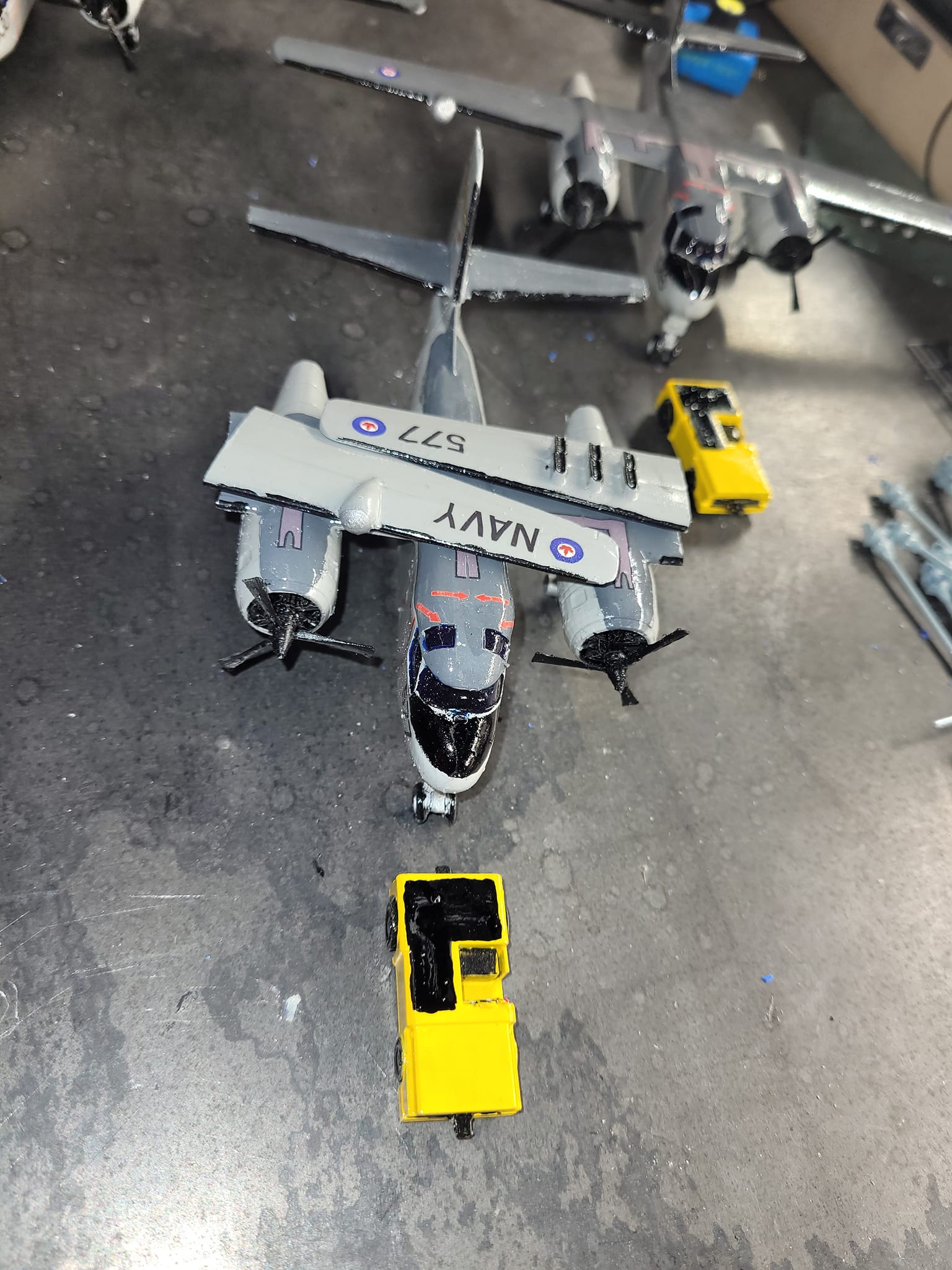

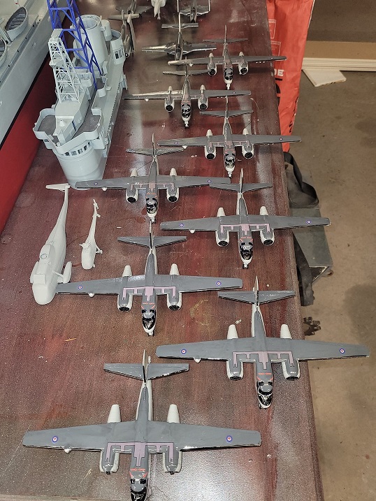

Alrighty....some progress!
The Trackers now have all of their decals applied, and are effectively complete....except for having to cut some wings off to position them as 'folded.'
I did one of them up like that last night - I am quite pleased with the result!
NS

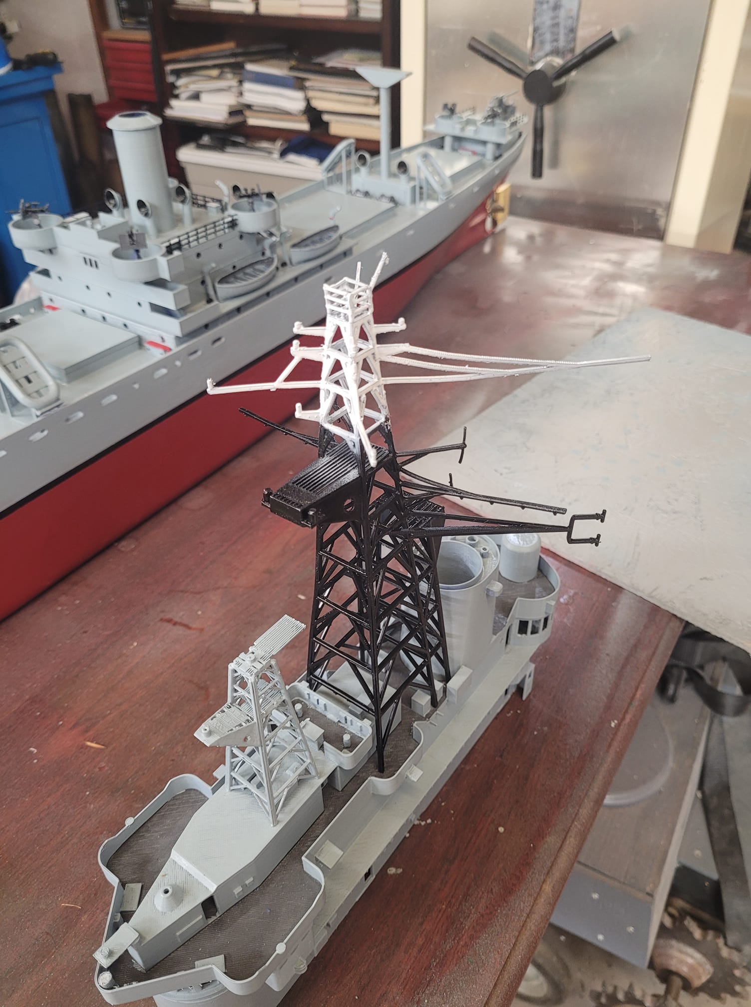

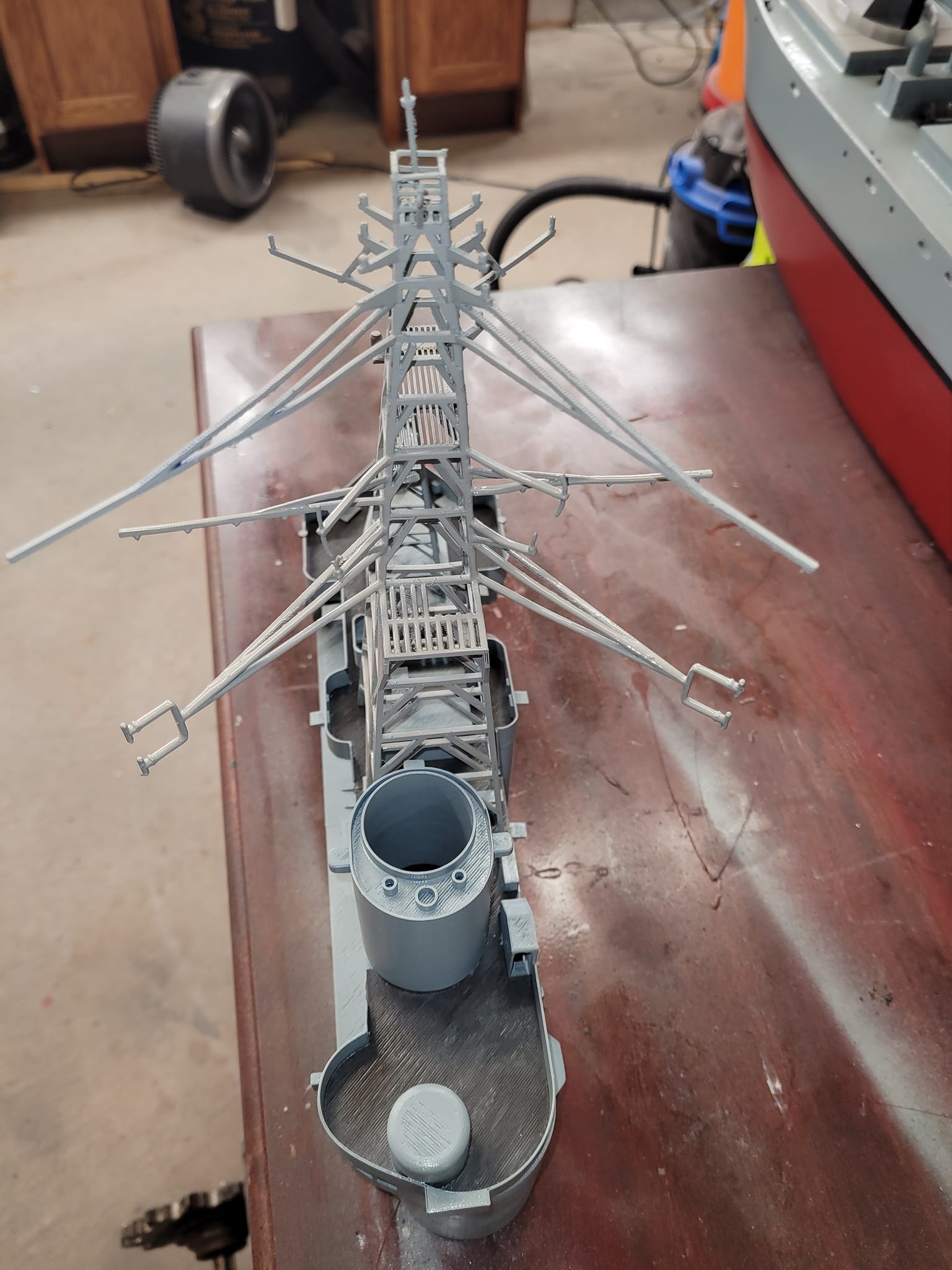

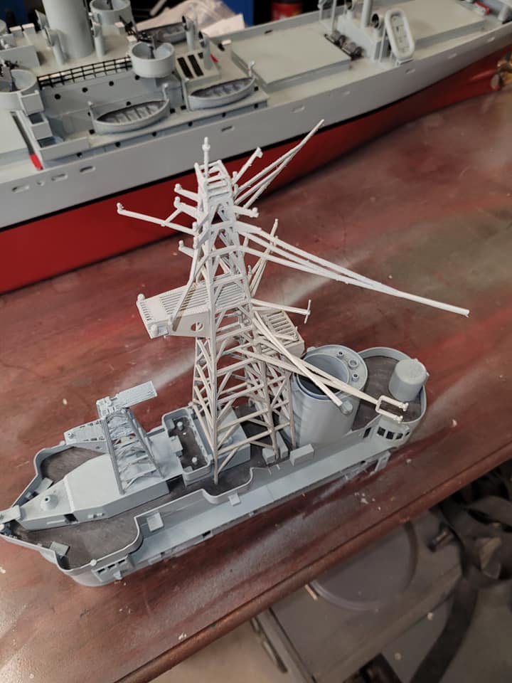

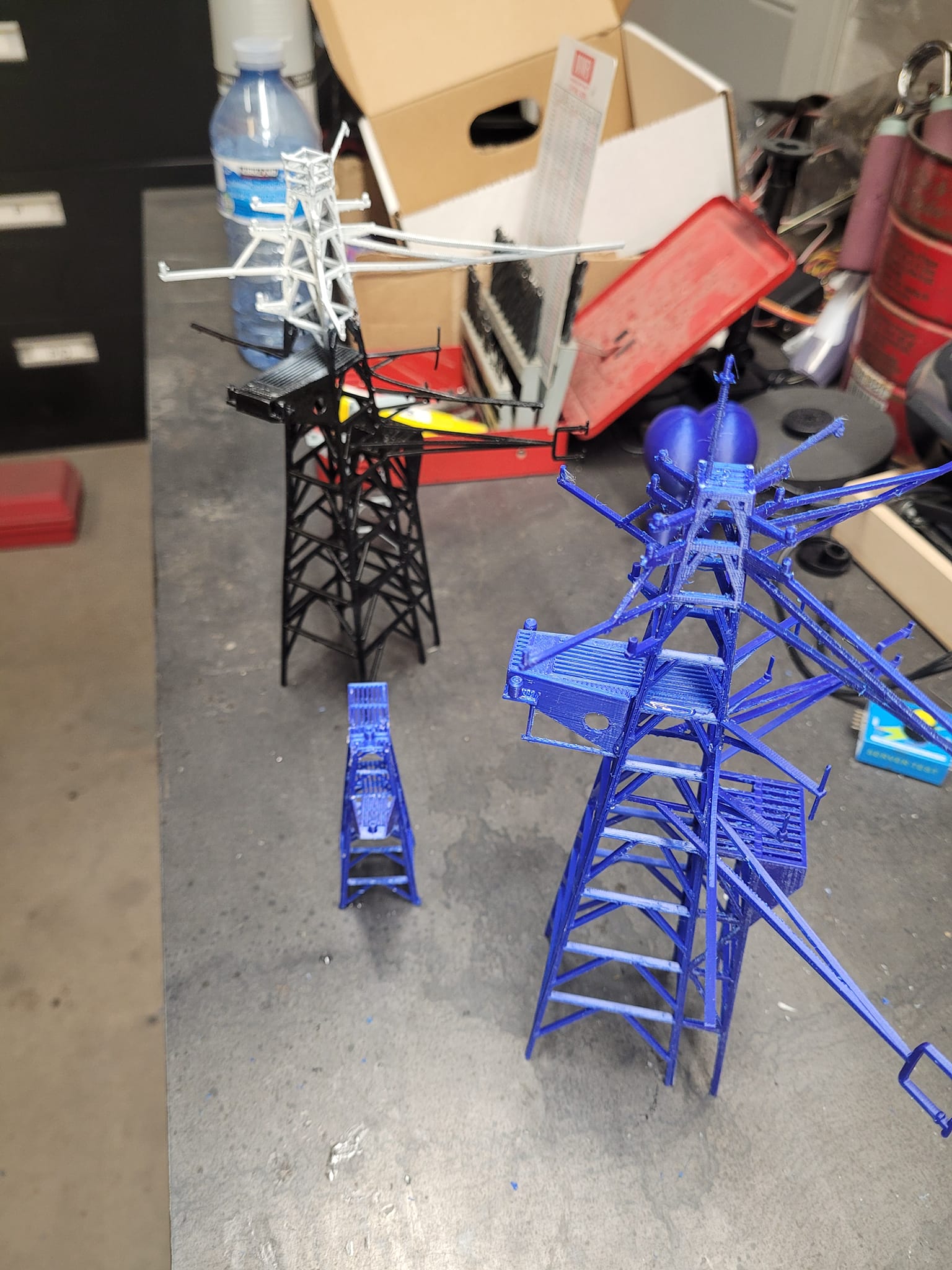

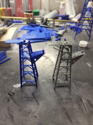

Some progress....the printer has been running steady- but printing stuff for a friend. I got his stuff shipped out on Thursday, so back to cycling my stuff!
Masts - printed, painted, and re-printed because I tried to clean off the 'hairs' of filament with a flame, and things got melty/bendy.

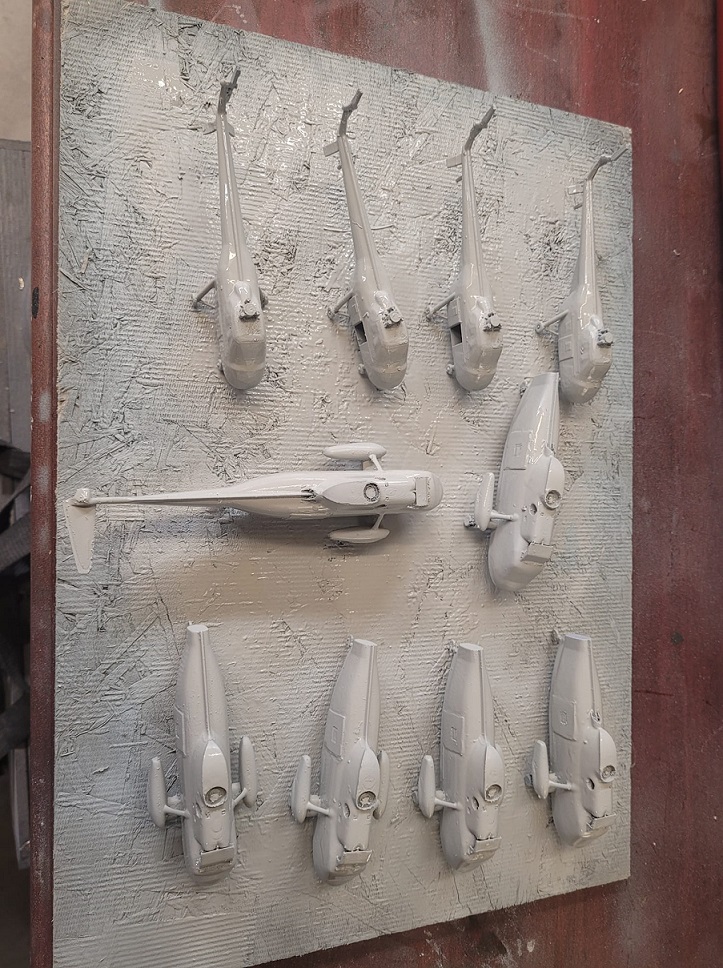

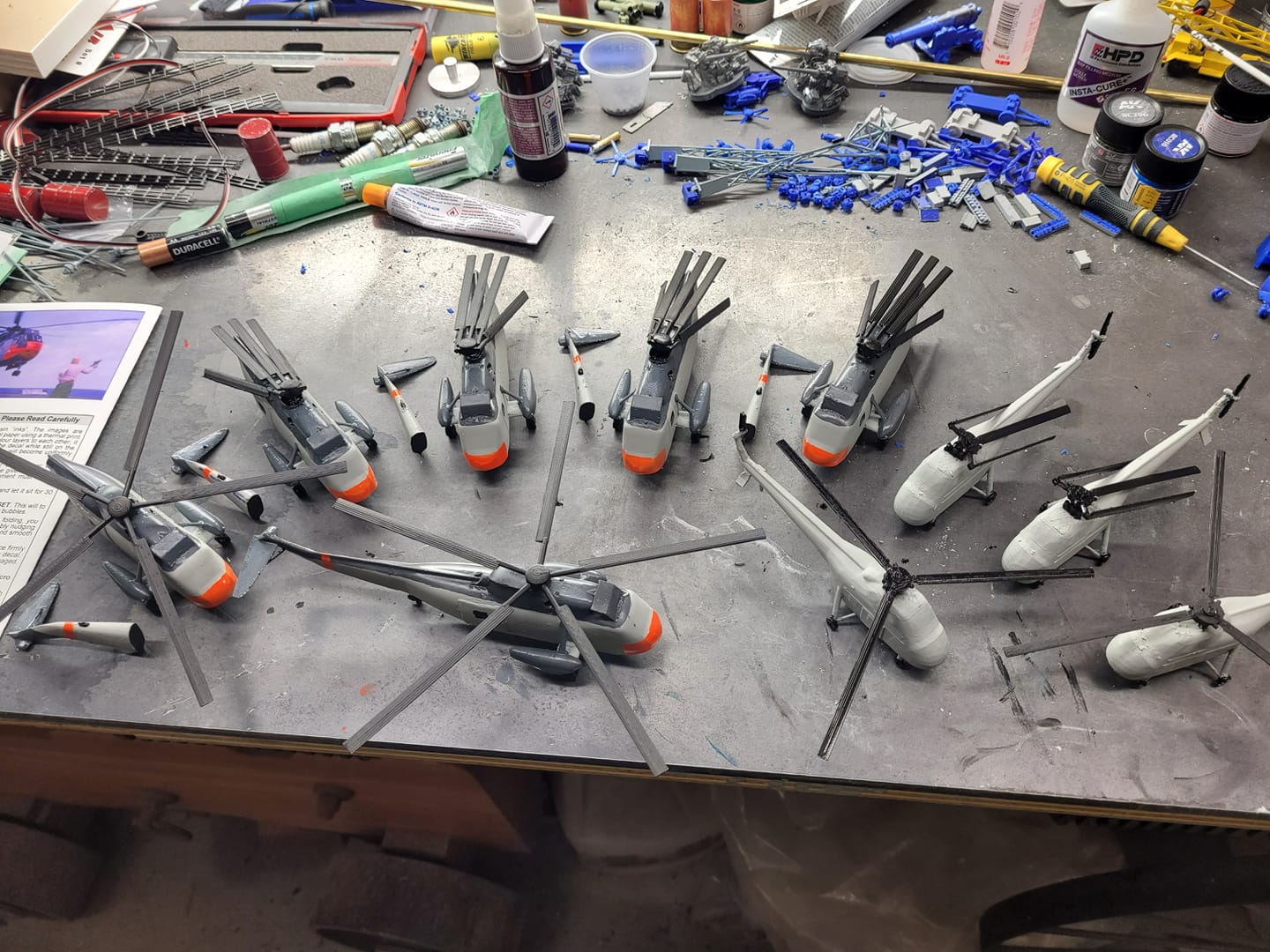

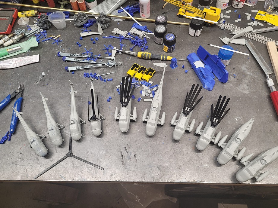

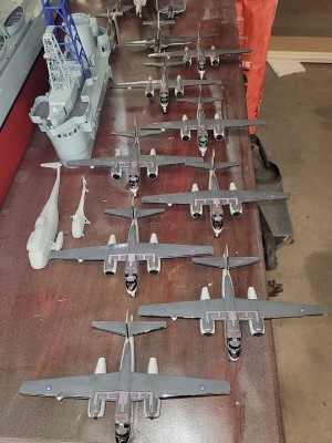

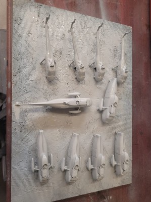

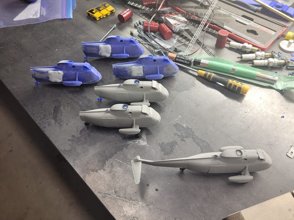

And, with the fixed wing portion of the Air Det complete, time to switch to Rotary...
Here's the 4 H0S4's, and 6 Sea Kings.
Of note - I am working on getting one of each motorized, and we'll see how that works out, these 10 will be painted/detailed properly. The motorized ones will be a work in progress.

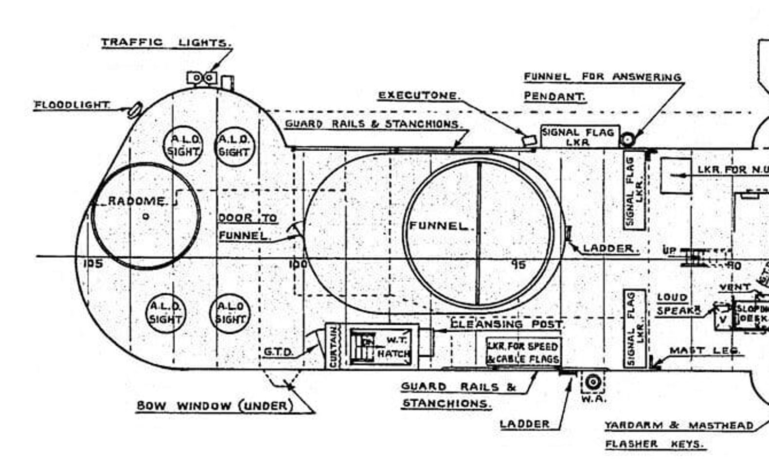

David, I think you're right - it seems offset about as far in as a set of guardrails. Maybe 6 inches?

Sadly, the 'easy' way to 'fix' the error was not to actually push back the edge of the funnel by a couple of mm...it was to pull the wall below out. (Compound curves in the funnel vs straight wall...) so I'm going to end up re-printing the whole shebang.
That said, I'm also adding more detail...I've pulled off the flag lockers and have done up a separate design for them and will glue them in place (I am hoping to find a good picture of the flag deck so I can see how the signal lines are rigged!) and there's a few more bits (phone boxes, director bases, etc) that I'm going to add.
Turns out Bridge V5 isn't the final product. LOL
I think I'll hold off on printing it to see how I can tie in RADAR dishes and motors as well this time.

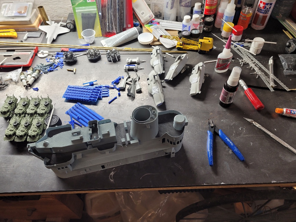

PostPosted: Sun Sep 04, 2022 7:07 am
Posts: 291
Location: Windsor Junction NS
The funnel wall is about 5mm.

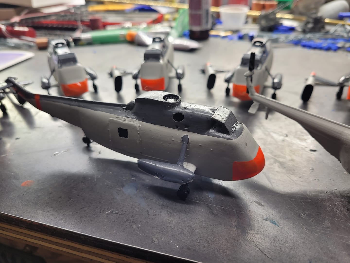

I've made some progress on the Sea Kings over the past bit - I'm pleased with how the helos are coming along.
301180296_10158265540227242_4348520724539674706_n.jpg [ 260.91 KiB | Viewed 637 times ]
301196245_10158265537352242_3126326426160724162_n.jpg [ 151.58 KiB | Viewed 637 times ]
