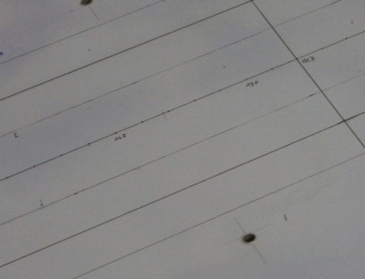

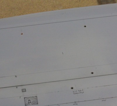

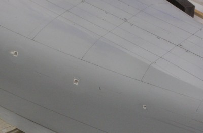

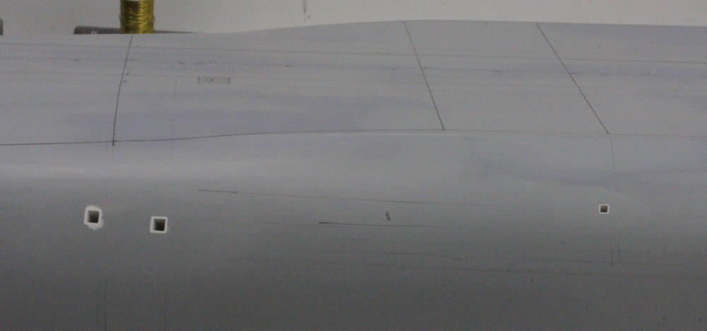

Hi,
an update of this weekend´s work... :wave_1:

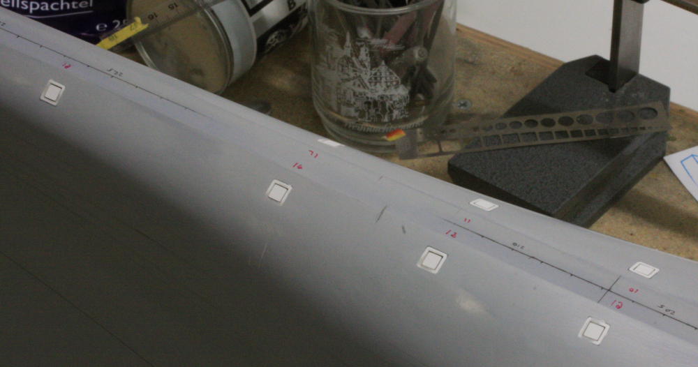

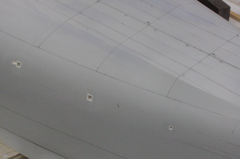

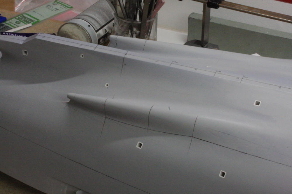

File comment: Hull openings for the sea valves in the aft hull.

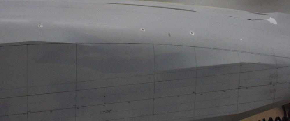

File comment: Ship builder at work: fine tuning with echappement files.

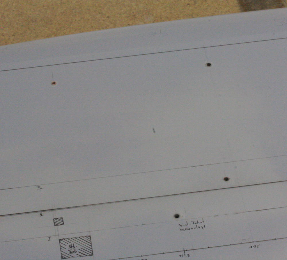

File comment: Sea valves in front of the bilge keel.

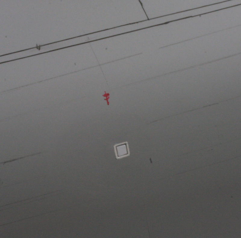

File comment: Sea valves behind the bilge keel.

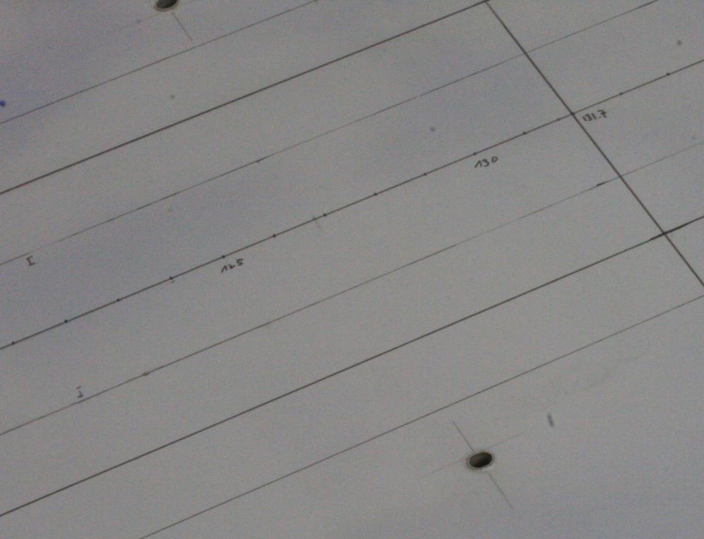

File comment: Hull bottom details
Thanks & Sources: Nilsson (research), M.Otten (modelling, research), J.Kaiser (research), B.Jenzsch (3D Services) and J.Arntz (research, drawings). HASSLER Profile, ZERO PAINTS, IWATA airbrush, EXCEL blades, Byrnes Model Machines and more

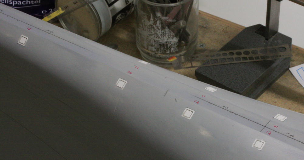

Hi,

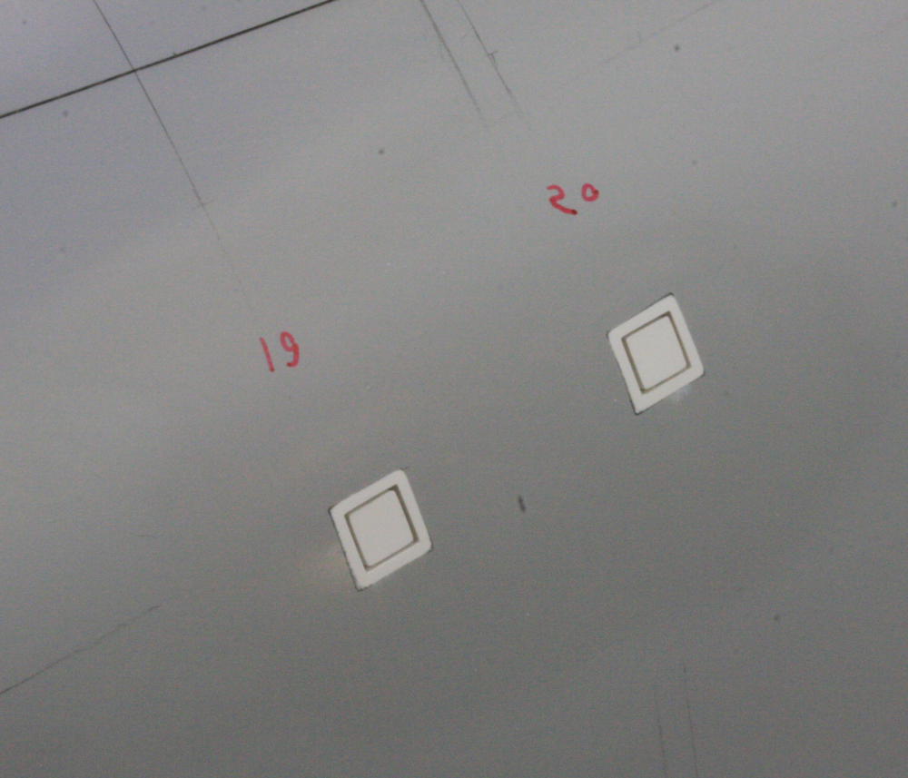

first dry fitting of the covers of the sea boxes for the sea valves (has anyone the correct english technical terms available, please?!) representing the closed setting. Both small and large ones.
Bye for now,
Bernd.

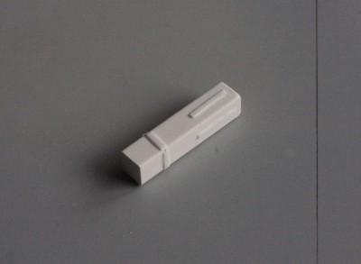

Posts: 611

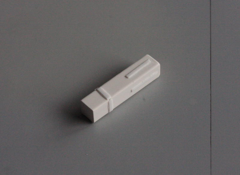

Added a picture of an insert for the sea valve chest.
Bye! :wave_1:
File comment: Insert for a large sea valve chest (4,5 x 4,5 mm)

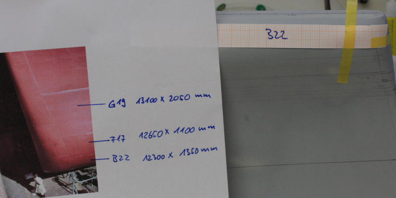

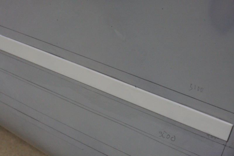

need to see something different from sea valves et al.

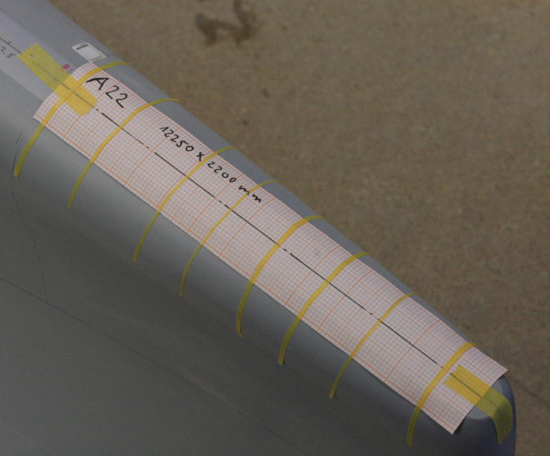

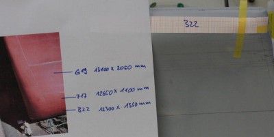

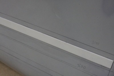

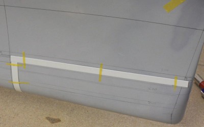

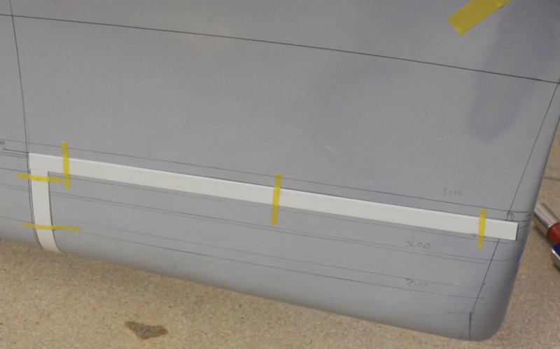

The Taylor bow needs some attention: to protect it from being hit by the falling anchor the shell plates B22, F17 and G19 were of a greater thickness (26 mm) than the surrounding "normal" plates. These 26mm-plates received a beveled edge against the thinner plating.
File comment: Using a template of plate A22 (flat keel) to mark the lower edge of B22.
File comment: Using a template of plate B22 to mark the leading edge of it. There are slight differences between Bismarck and Tirpitz (photo) at the front face of the Taylor bow in shell plating.

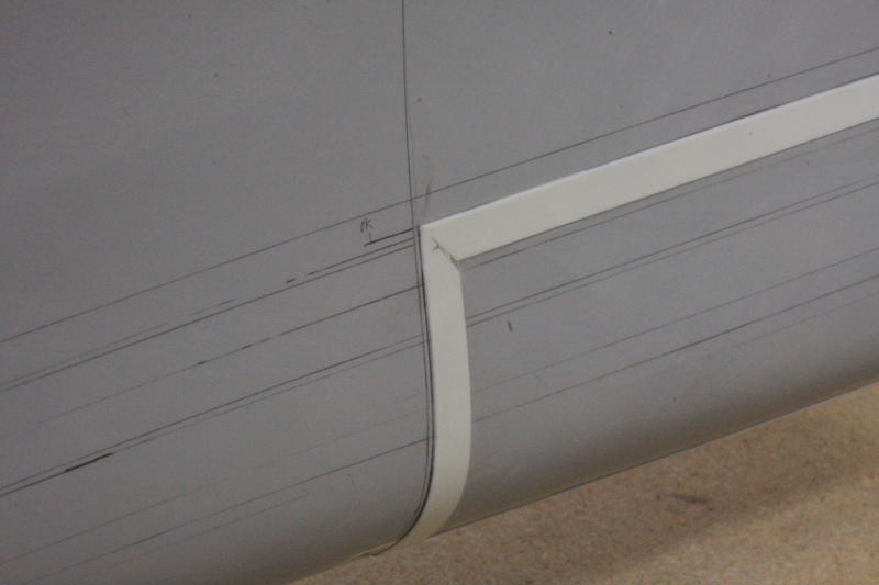

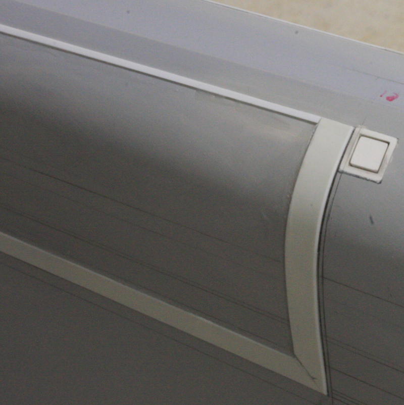

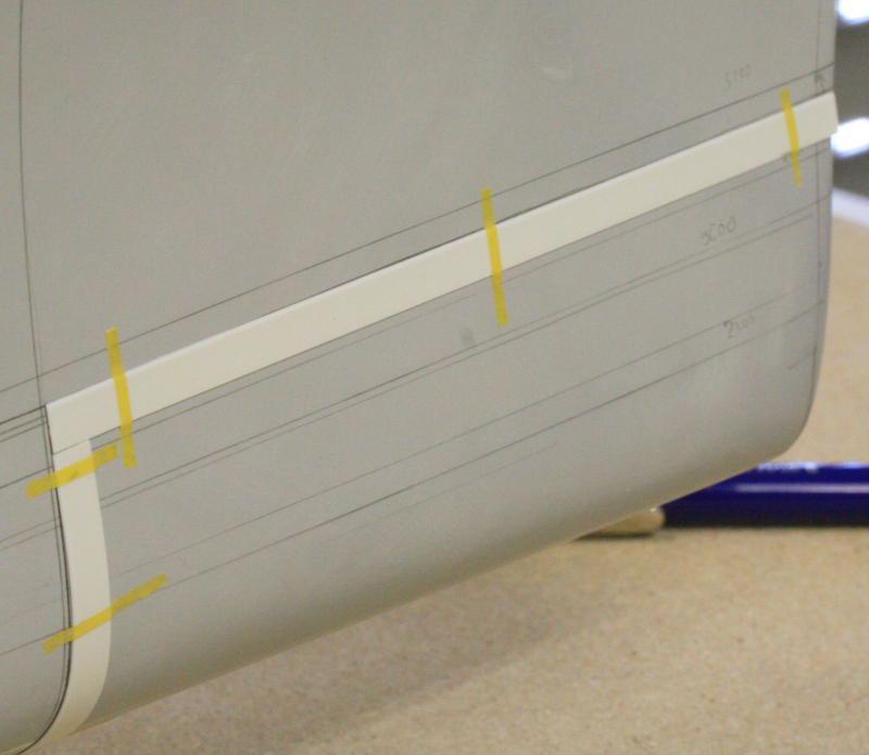

File comment: Dry fitting of the styrene stripes with a sanded bevel.

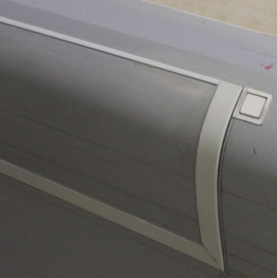

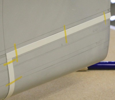

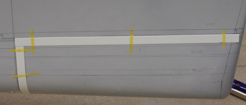

Final progress of today

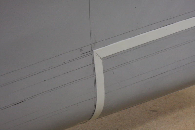

File comment: Glued upper and trailing stripe (0,15 mm styrene with bevel) onto the hull using CA.
File comment: Upper edge.
File comment: Fish perspective: it´s rewarding to work precisely - trailing edge at frame 226.8 lies next to the sea valve - just where it should be! :-)
