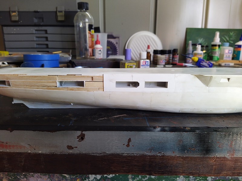

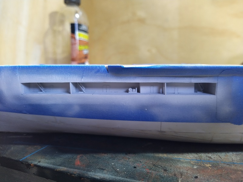

PostPosted: Sun Jul 11, 2021 5:39 am
Joined: Sat Dec 21, 2019 7:54 am
Posts: 100

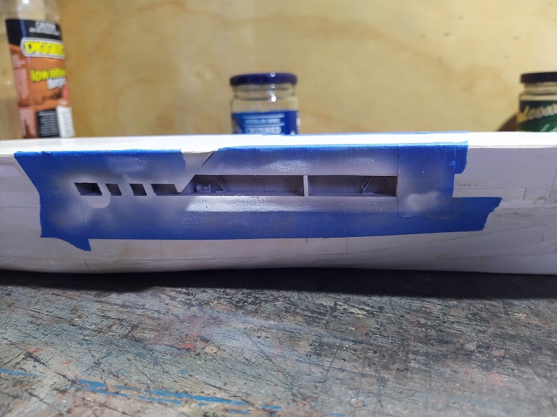

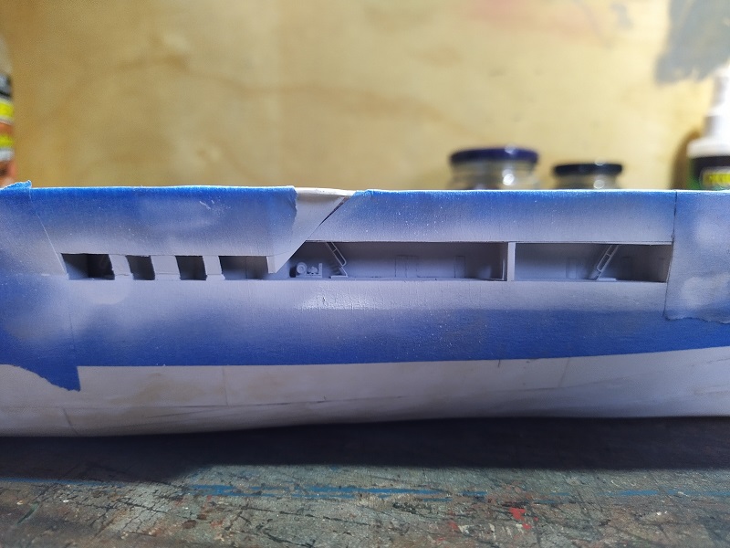

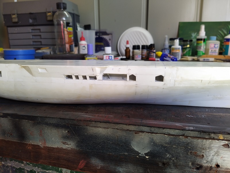

Ladders installed on the starboard side. And openings cut for starboard weather deck under the island. And yep I cut them too big to start off with so had to add some material back. Going to have fun hiding that!

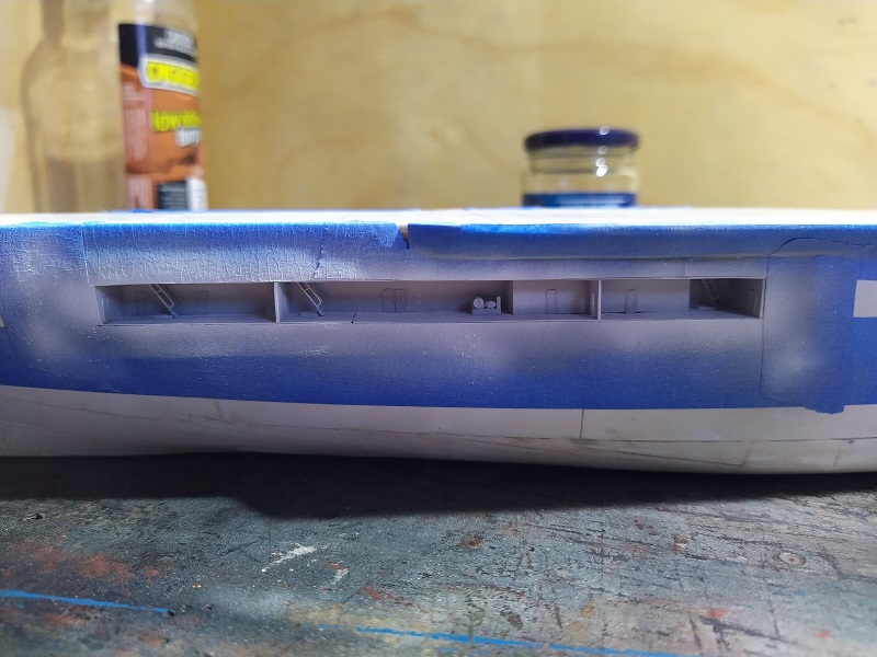

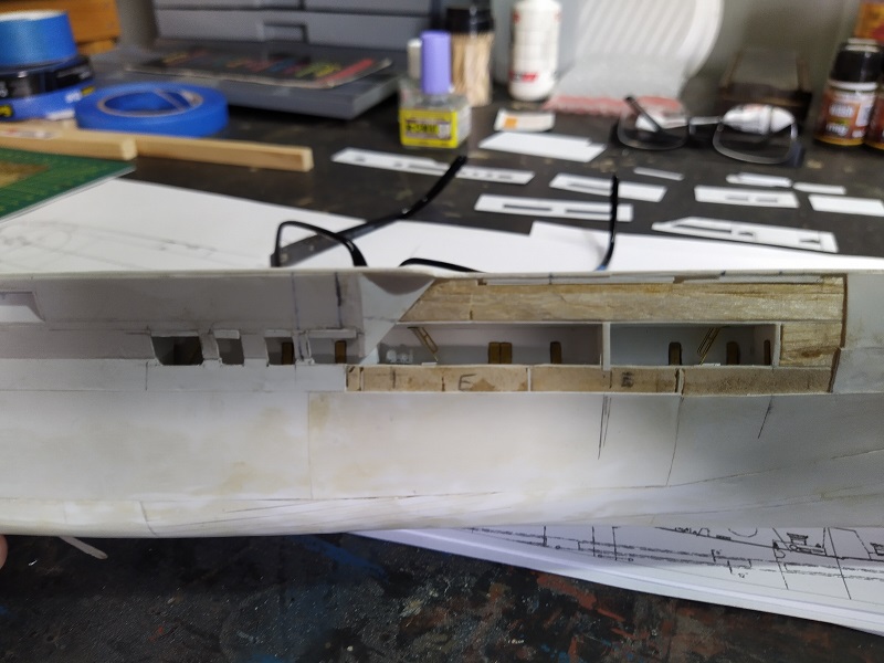

Soooo, progress has been slow on the Melbourne lately. The work crew have found themselves unable to deny the call of better paid work. But after some hard negotiations they got back to work today and managed give the weather decks an undercoat of grey and then a coat of white. A second coat of white should follow tomorrow and then installation of the hull skin around the weather deck openings can begin.

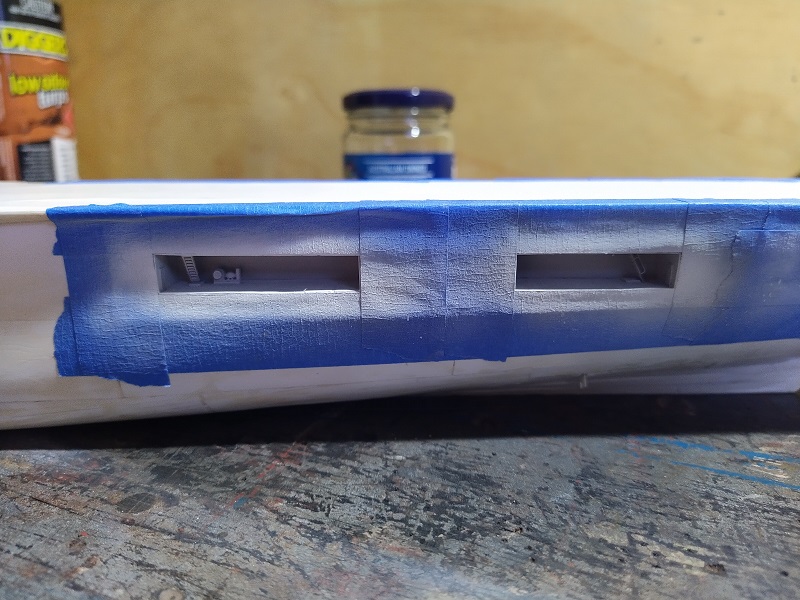

I managed to convince the painters to stay on another day and finish the white on the weather decks. Only cost me a couple of beers :joker:

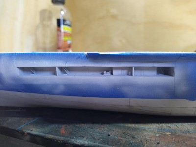

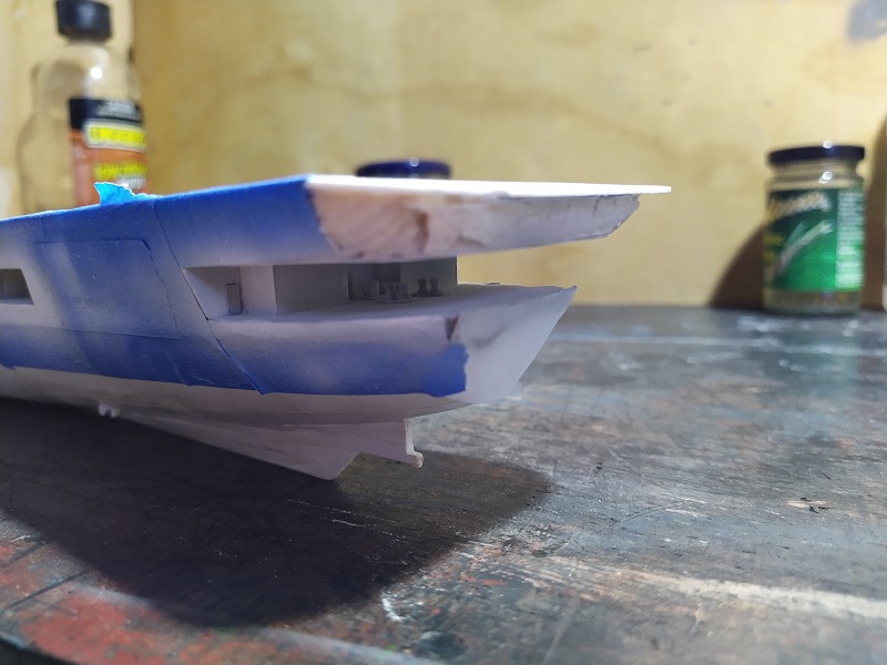

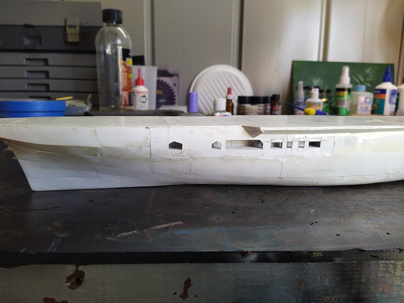

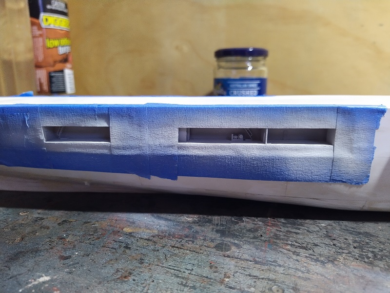

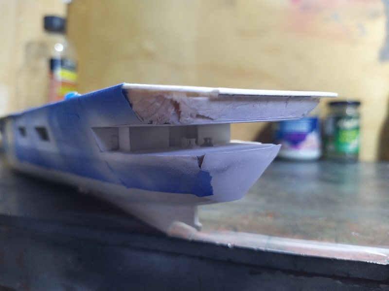

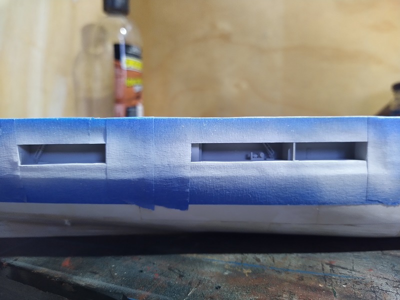

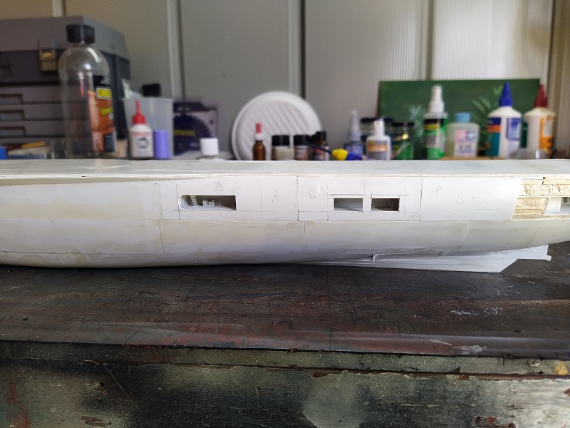

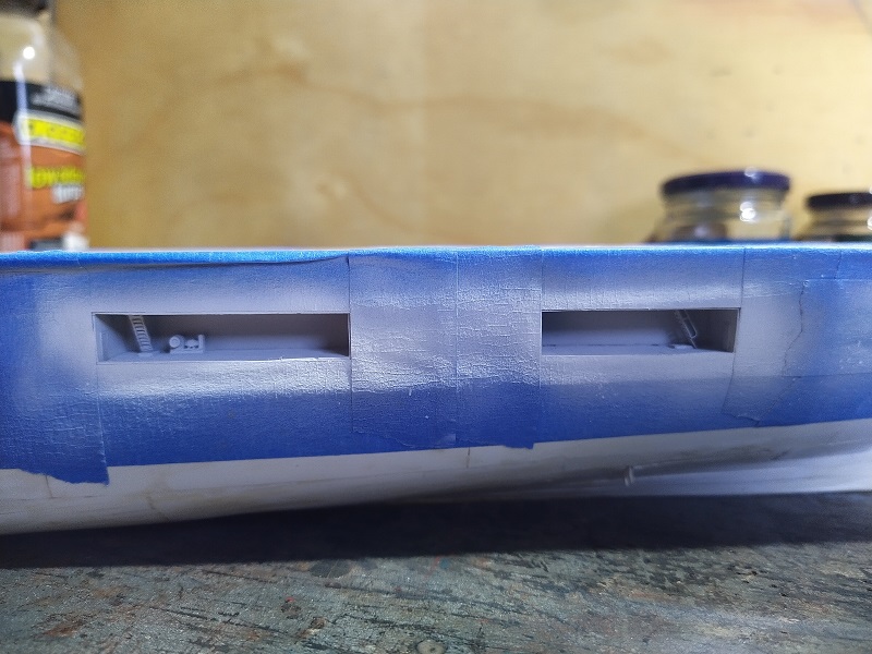

Tiny steel workers were hard at work this weekend installing the hull skin over most of the weather deck openings.

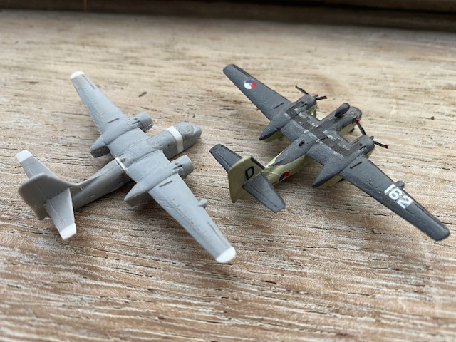

BTW: on my 1/350 ARA 25 the Mayo (a sister ship) I solved the propeller problem by using the Heller props: these were supposed to be 1/400 of course, but appeared so much over scale that they are perfect for 1/350 :smallsmile: Also, they have the right amount of blade pitch (which is considerable!)
You can see also: I had created a master for the S-2A Tracker and cast these in resin. Also modifed these to S-2E and will re-cast these in the future. You might acquire some of these from me then.

I'd love to know more about your S-2 casting experience Maarten as I am looking at doing the same for my air wing. I deliberately bought the Gallery Models 1/350 USS Intrepid so I could copy the A-4 and E-1 from that kit, modifying the E-1 to S-2 of course. I have been looking at 3D model files available online for printing but they all seem to lack the detail you find on an injection molded kit. I've even emailed Trumpeter and suggested they do a run of A-4's but never heard back :roll_eyes: Nice job on the Mayo by the way :thumbs_up_1:

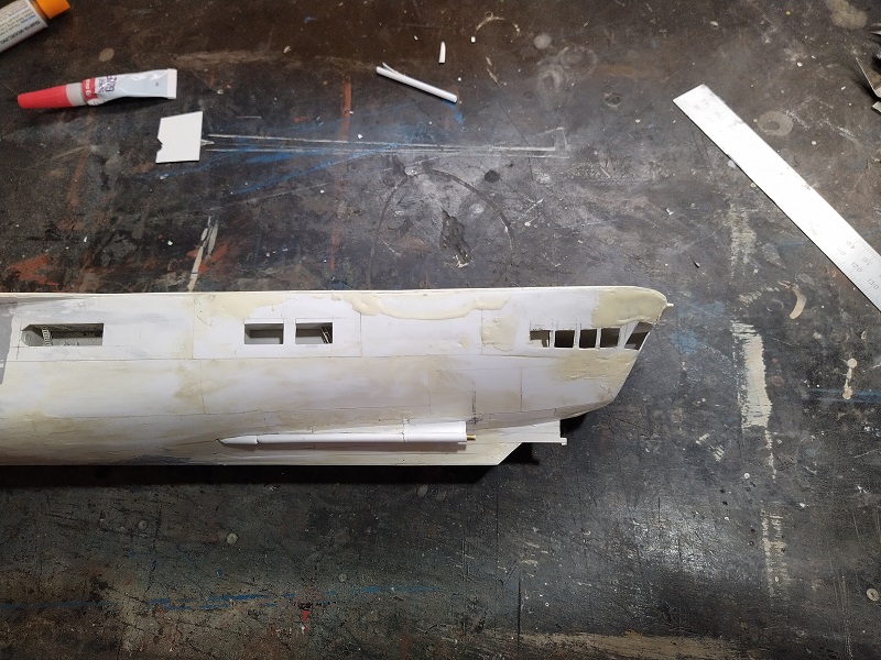

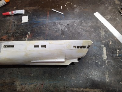

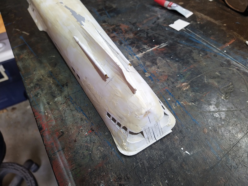

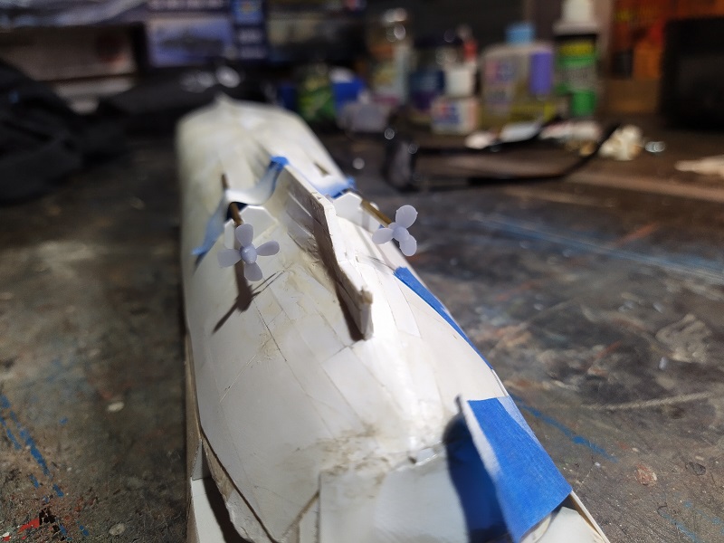

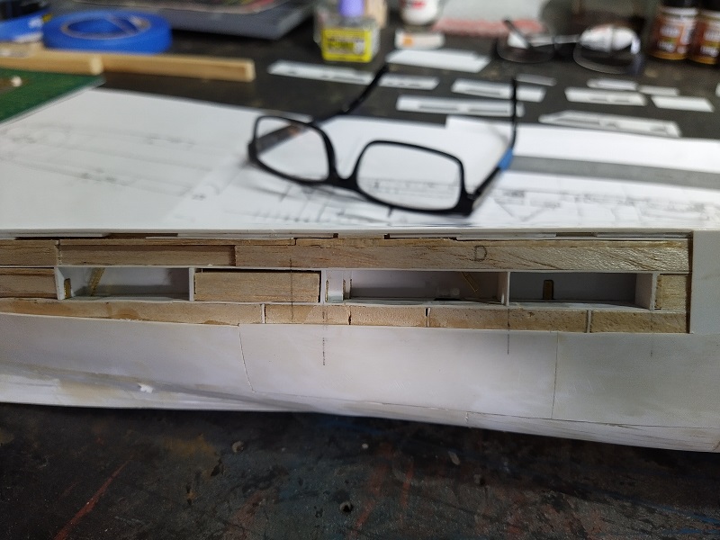

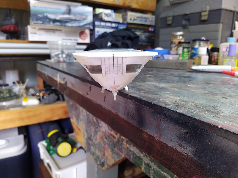

Openings to the aft weather deck started. Filling depressions in the hull skin started. Building up the prop shaft nacelles, if that's what you could call them, started. I see a long road ahead tidying up those weather deck openings :frown_2:

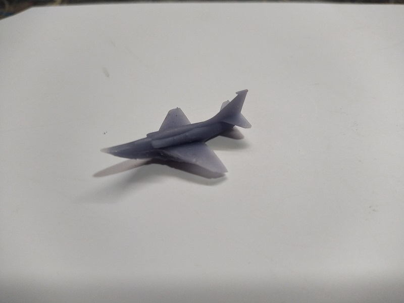

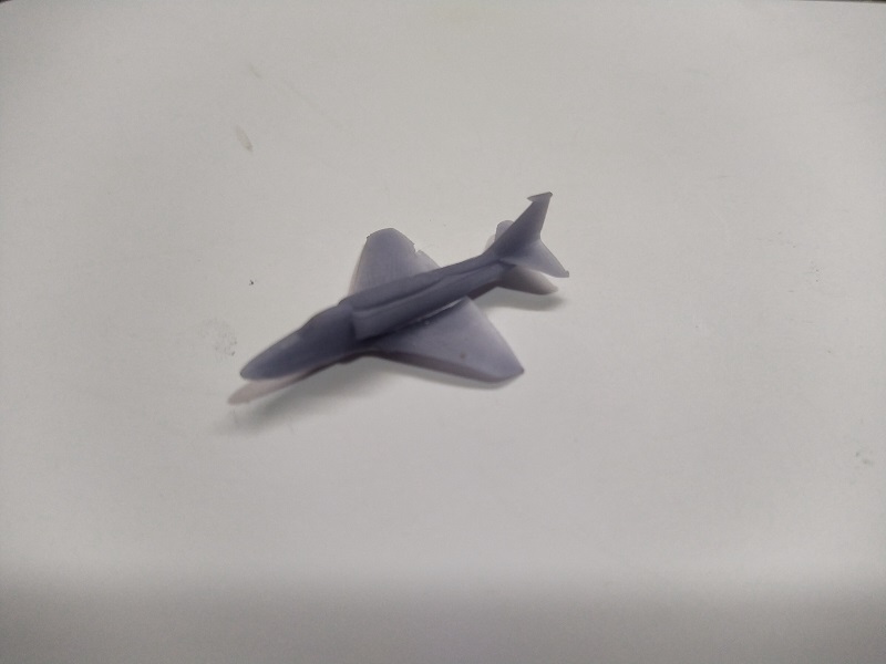

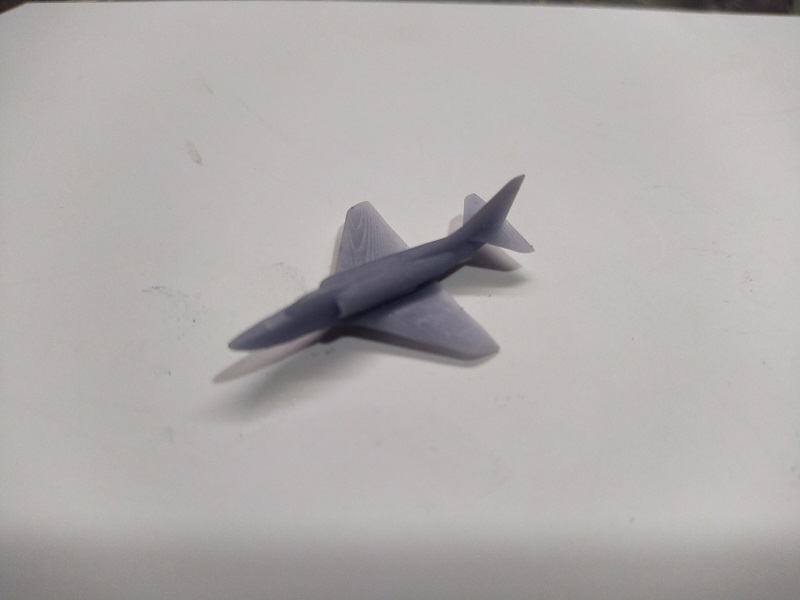

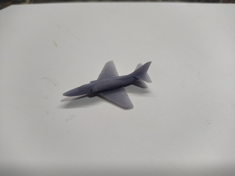

Experimenting with 3D printing the A4's. Obtained the stl files from Cults https://cults3d.com/en/3d-model/game/do ... -4-skyhawk.
Using a Creality Halot 3D printer with Monocure 3D Rapid resin. With the model being so small and the wings etc so thin the Monocure Rapid is a little too soft and the wings deform easily. Am thinking of trying Monocure Tuff next.
File comment: 1st attempt....terrible! Lack of supports under the nose.
File comment: 2nd attempt....getting better...
File comment: 3rd attempt...close...
File comment: 4th attempt...almost there!

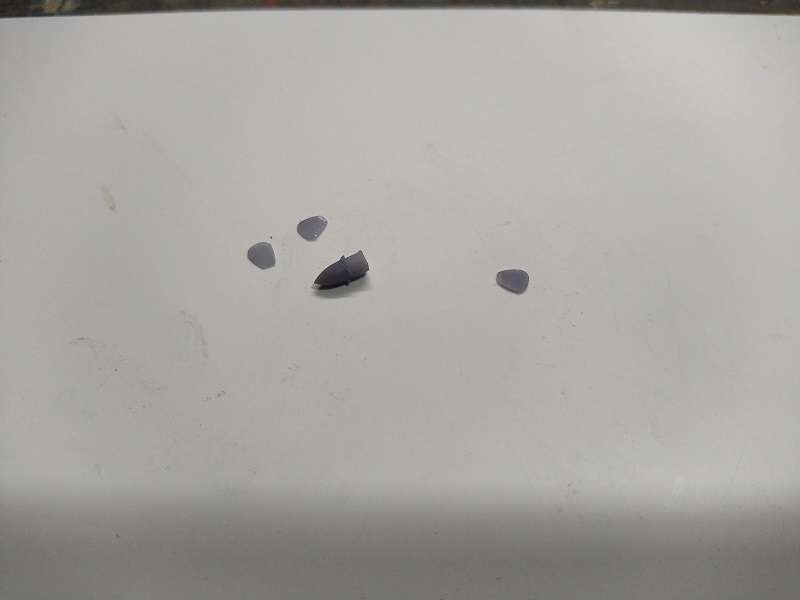

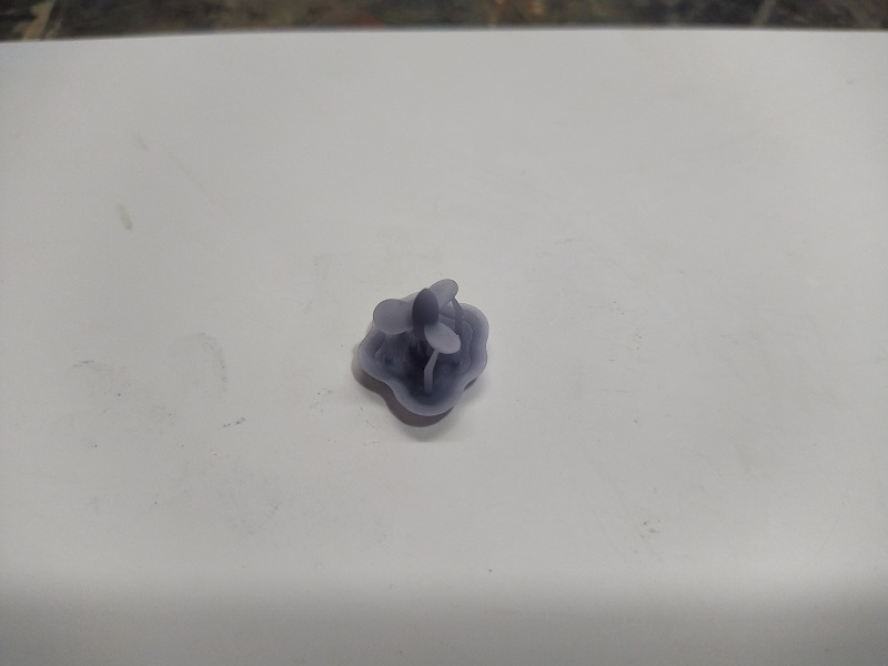

3D printing the ships props. Still using the Monocure Rapid resin and the those tiny thin blades just snap right off when you look at them:(. Hopefully the Monocure Tuff will prove to be a bit more durable but at $70 for a 1 litre bottle of resin this is an expensive experiment. Still toying with the idea of casting in resin. What a shame Trumpeter won't answer the call to run a batch of A4's :cry_3:
File comment: Prints beautifully!!!
File comment: But very fragile:(
Hi Bonobo,
Some notes on terminology:
You call this the 'weather deck', but it should be the 'quarter deck' - see your post with the photo of the Melbourne quarter deck, several pages back in your thread. http://www.shipmodels.info/mws_forum/viewtopic.php?f=13&t=214450&start=74
In previous posts you also used 'weather deck' where you were actually referring to the side galleries - where the ship's boats are located. The term weather deck is a generic word for all the decks of a ship actually exposed to the elements, so not having another deck overhead - which is clearly the case on the side galleries and the quarterdeck in these carriers.
As for the prop shafts: these are called the 'fairings' not 'nacelles': that word is more commonly used in aviation when engines are enclosed in a separate 'pod' or 'body' apart from the fuselage.
Roger Whittaker +9/13/2023
