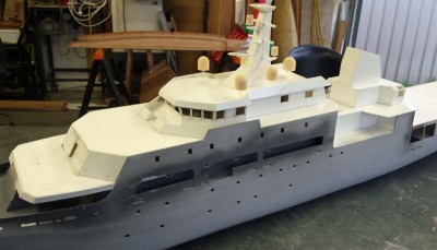

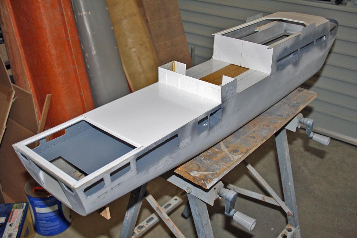

The MV Sycamore is used by the Royal Australian Navy as a training ship for a variety of tasks including helicopter pilot training.
A couple of years ago I started building a 1:72 scale model of this ship. I first built a wooden hull then took a fibreglass mould. Finally making a fibreglass hull.
Construction has progressed slowly over the last couple of years but the model is now starting to take shape. The attached photos show how construction started.

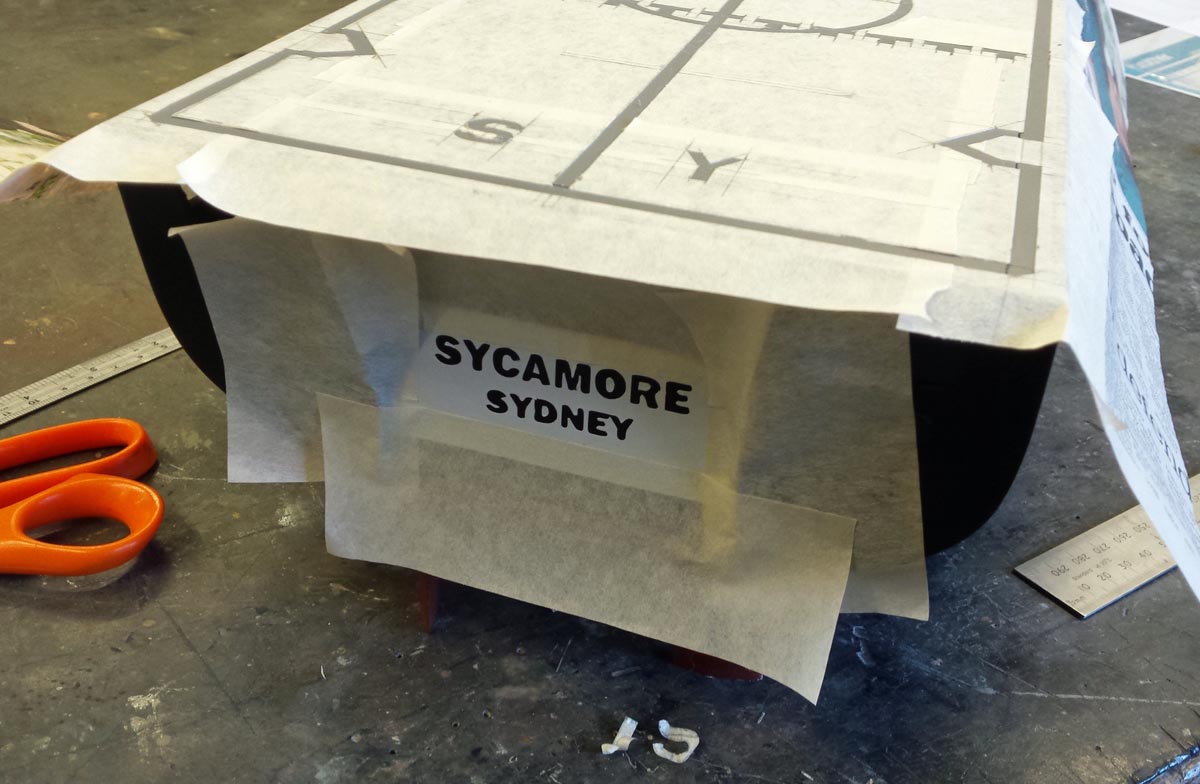

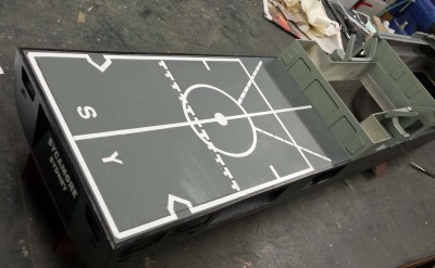

The flight deck was covered in masking tape then the markings were drawn onto the tape. The areas to be painted were hand cut with a sharp exacto blade and the appropriate areas of tape were removed ready for painting. White paint was applied in several thin layers with an air brush
The ships name was done with a mask made from vinyl (cheap book covering vinyl). I used my wife's scan-n-cut machine to produce the mask. The scan-n-cut machine did struggle to produce such small letters. This was an experiment and it did not turn out quite as well as I had hoped but it is still acceptable.
