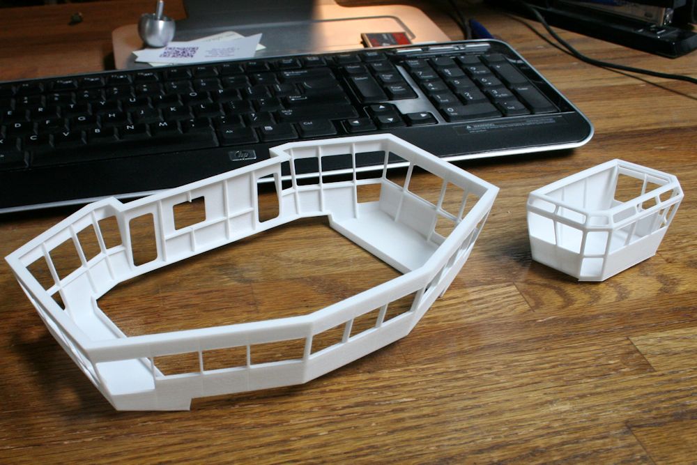

I've been working with 3D printing for model ship parts for a couple years now... anything from a single anchor, to those tricky cowl vents, to major portions of an upgraded model. See some of the items at my 3D printing thread on RC Groups:
http://www.rcgroups.com/forums/showthre ... st23219786 (with some 11 pages already).
3D printing is NOT the equivalent of a Star Trek replicator, where you can just push a button and get a perfect medium-rare burger, or a finished ship hull. You need to do a lot of work first in the design stage... and then when you get the parts, they may well be usable, or not! You will usually NOT get parts equivalent to well-molded bits from Tamiya... more like parts from HAWK, salvaged from under a garbage pile after 20 years' exposure. Really, parts are ROUGH, even from the finest processes available... and forget about these cheap desk top machines that get all the hype, you can't print a usable model part (much less a working gun!) with these things.
That said, parts designed in a way that allow for secondary finishing (filling and sanding) can be wonderful. The link above goes directly to a complex modern pilot house which has flat sides everywhere, no projections... this allowed me to rough sand the striations down, then fill the porous sintered nylon powder structure with polyurethane, then finish sand that... all in preparation for future coats of primer-surfacer before I even think of a finish coat.
This project also give me confidence that I can tackle my new job with nearly 100% 3D printed parts.
File comment: 3D printed pilot house

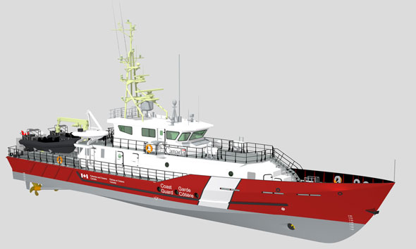

This is the Daman 4207 design, with modifications for the CCG. The Canadian boats have a number of visible differences from 4207's used in other services... there's a bustle on the transom with rear-exiting exhausts, longer forward bulwarks, and a number of other unique details scattered about the boats.
Plans are not available (we've tried!)... but with a lot of web-sleuthing (thank you, Google Translate, for help with the Czech and Dutch sources...), I've been able to develop reasonable lines. And with a number of fairly high-res images from various sources (like Mac Mackay's Shipfax), I've been able to work out a lot of the details in CAD.
If there's one thing I've learned from my day job (automotive engineer), it's that you don't start a big project until you know you can finish it. Believe me, we design complete new cars all the way through details of the assembly process before we get authorization to spend billions on tooling. It's not so critical with a model boat... but I'll still do all my CAD work before ordering the first printed part.
File comment: Concept image (already out of date, missing numerous details found on the real boats)

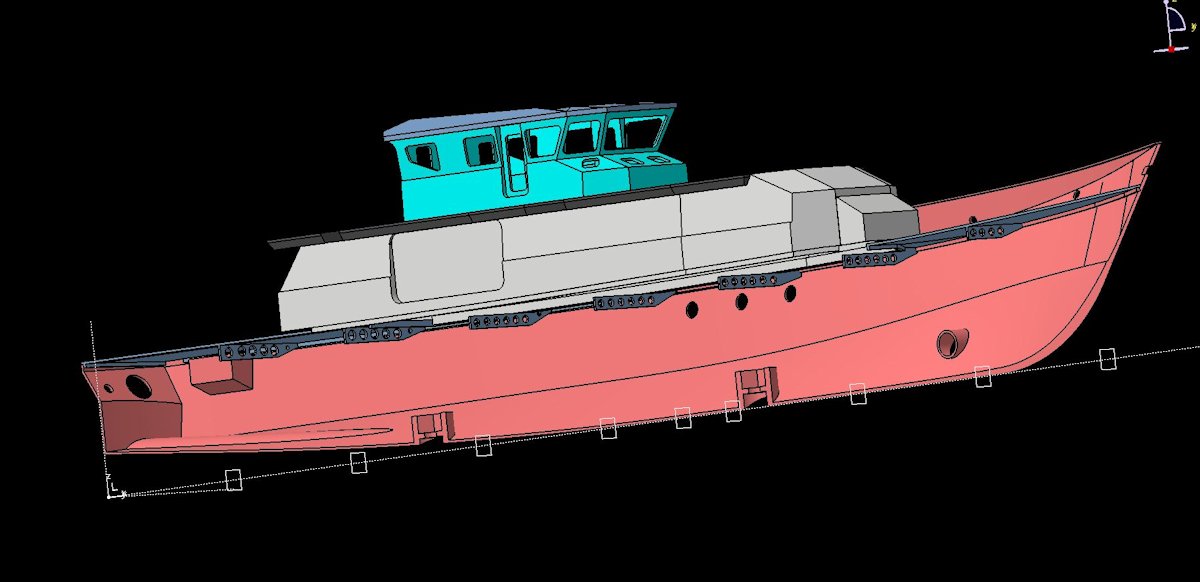

How's the CAD coming along? Pretty well! I'm nearly done with the major structures, and am adding all the little stuff... like hanging ornaments on a Christmas tree. But even that needs to be done, as the design work on some detail often points to the need for mounting features on the main structure.
Note that I have no intention of creating a photo-realistic rendering... that's a job in itself. So my images here will be pretty basic, just showing those components that I plan to print (or will investigate for printing). But all items visible here are designed with feasible geometries for printing, finishing, and assembly.
File comment: Half-hull image showing interior details for the pedestal mounts.
File comment: Detail work to-date.

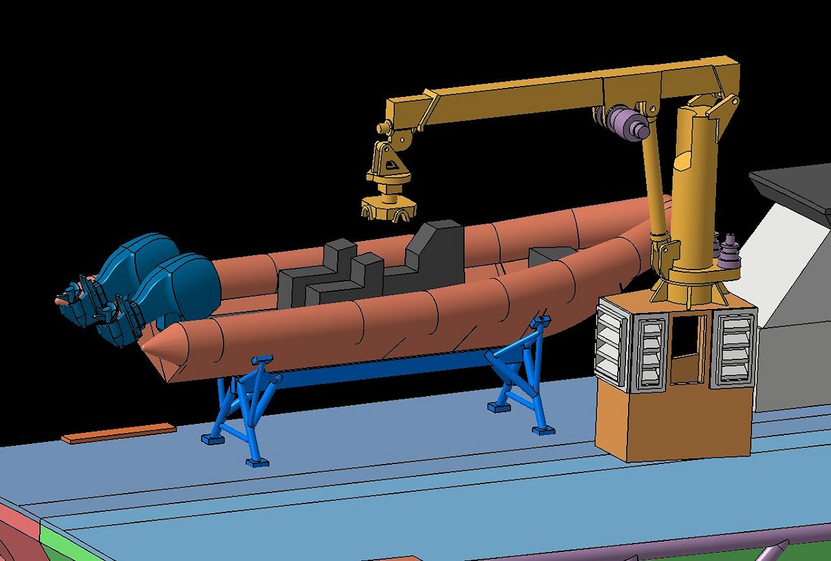

File comment: Hero's can carry two 8m Zodiac H753s, powered by twin 200hp Evinrudes. The crane has a special head to engage a grab structure in the boats (not shown yet)

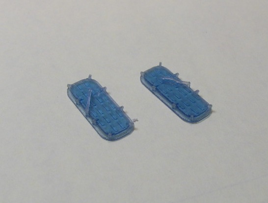

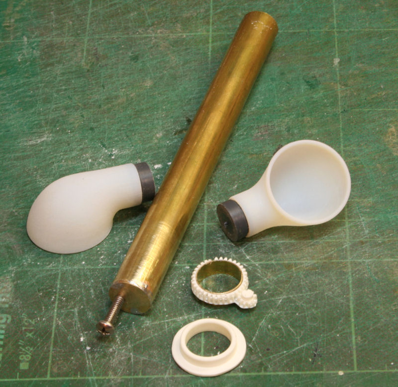

If you haven't seen them before, here are the 3D-printed cowl ventilators I did for a 1:32 Foundation Franklin:
http://www.rcgroups.com/forums/showthre ... st15413788
I also make them available through Shapeways... linked from:
http://matthewsmodelmarine.wordpress.co ... del-ships/
File comment: 3D printed cowl vents
File comment: Hybrid construction

Now, this particular material is not the finest for detail, but was the only clear stuff available at Shapeways. Their "frosted ultra detail" does better for detail, but still requires cleaning (it's covered in a waxy/greasy slime), and still some more sanding.
In this case, the very rough clear blanks were sanded and polished to near optical quality... but again, if you can't sand the surface for the included details, than all hope is lost.

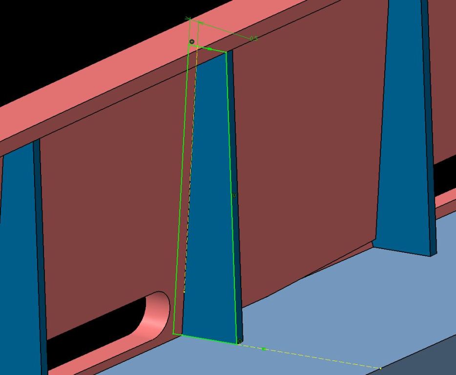

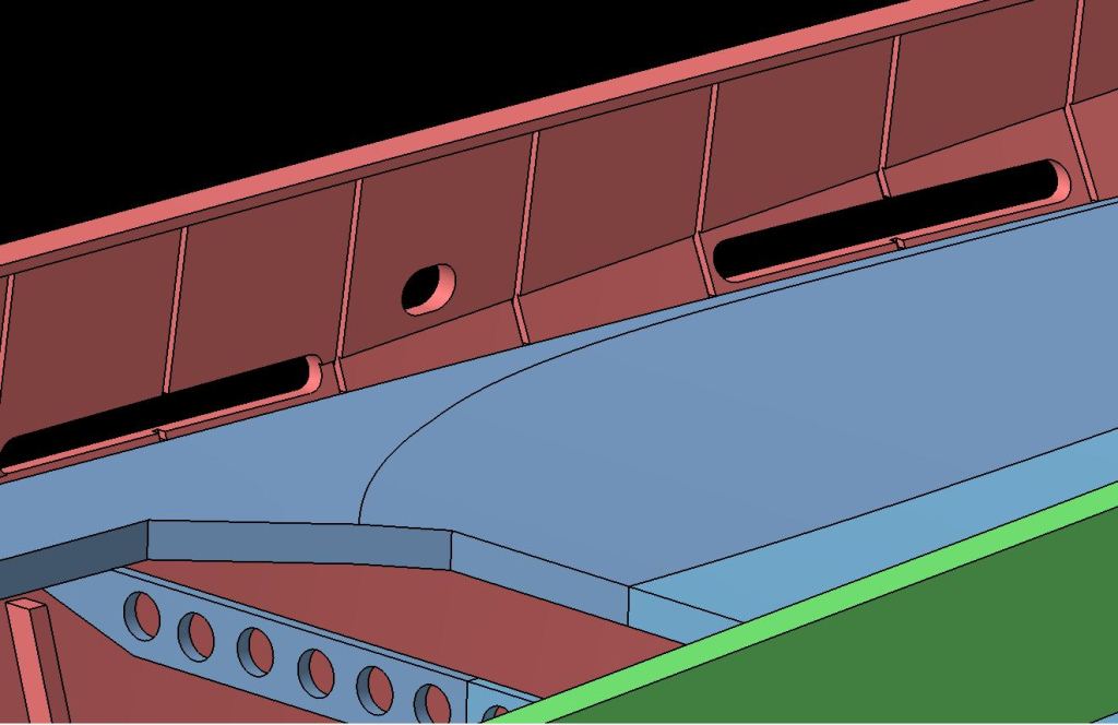

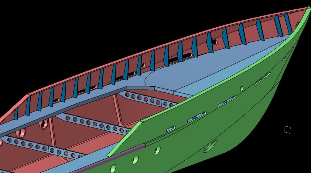

Here's the sort of thing you can do with a good CAD program. I designed the forward bulwark stanchions 0.5mm into the wall of the bulwark/hull. Then the stanchions are Boolean subtracted from the hull, leaving perfect little locating grooves.
File comment: Each stanchion is designed 0.5mm into the 1mm thick bulwark.
File comment: All the stanchions...
File comment: Stanchion subtracted from the hull, leaving precise locator grooves

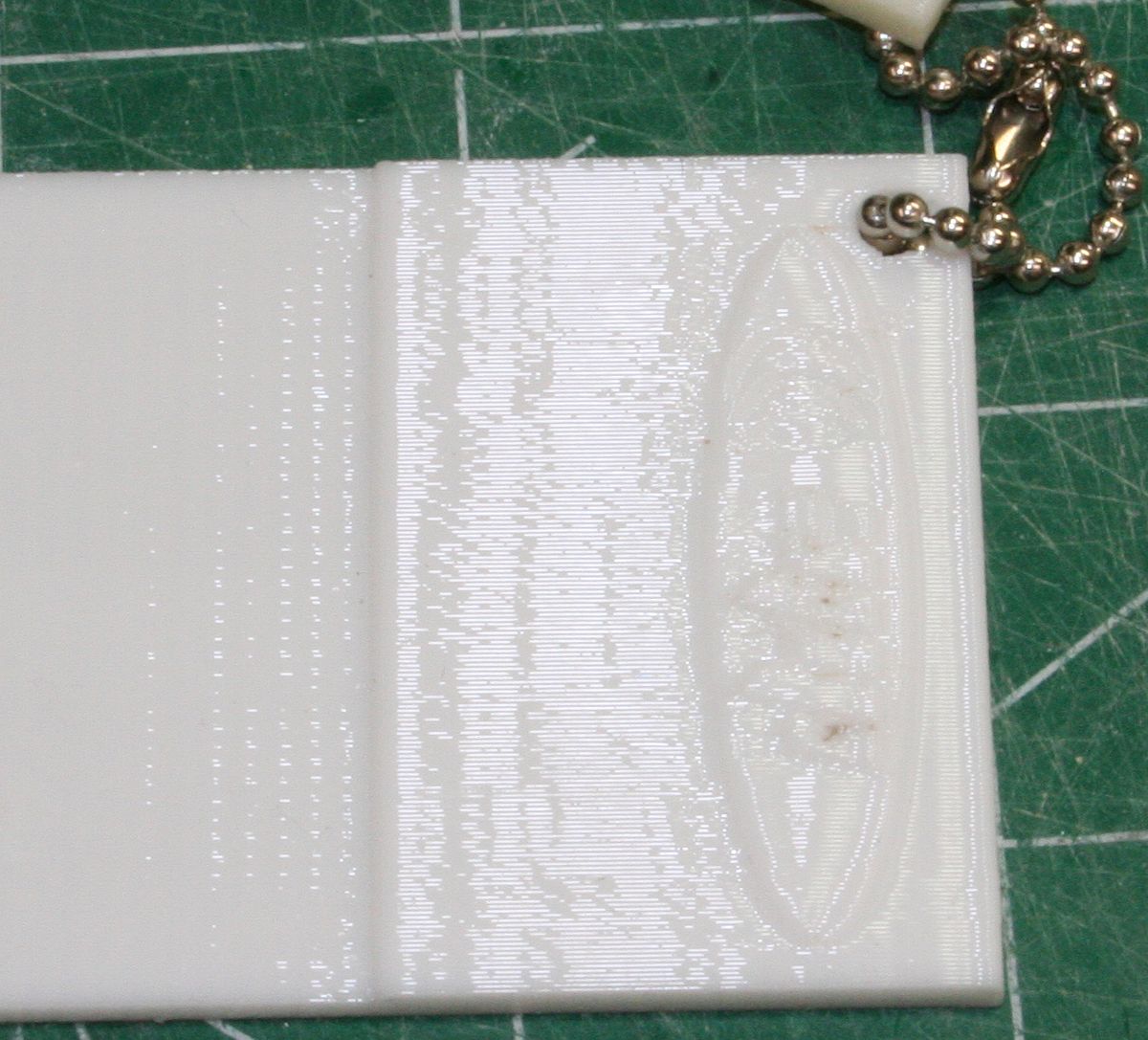

OK, I'm getting ever more hopeful about fine detail parts. I haven't heard back from Nelson, maybe his source isn't publicly available. But I did contact another modeler, TBowman at RC Groups, who has been getting some incredible parts for his large RC scale-sail HMS Scorpion:
http://www.rcgroups.com/forums/showpost ... tcount=128
Those parts come from APP (American Precision Prototypes), and are off of a true SLA machine. Quick reminder, there are several types of 3D Printing commonly available (and others, not so common):
SLA: Stereolithography... a laser is steered around on the surface of a pool of liquid polymer, curing the stuff as it goes. Provides the finest parts.
Inkjet/Polyjet: Just like an inkjet head, but either a photopolymer or a support wax are applied in layers by a printhead. Each completed layer is hardened by exposure to UV light. My experience- depending on the machine and material, can be as bad as FDM (below), or pretty fine (Shapeway's "Frosted Ultra Detail").
SLS: Selective Laser Sintering: A laser is steered around on a box of fine plastic powder (often nylon). Reasonable resolution, gritty porous surface. Often the lowest cost for big parts, needs sanding and filling.
FDM: Fused Deposition Modeling. Squirts out strips of molten plastic, like building parts with a hot glue gun. The worst for resolution, might be ok for 1:6 scale wicker chairs.

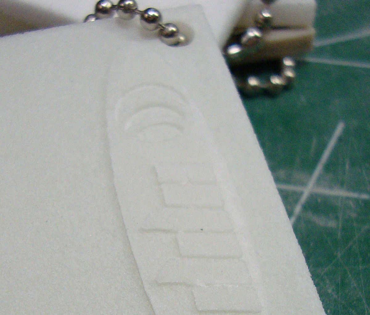

So I got a sample set from APP of a bunch of their materials, some photos below. I wish they had printed round or angled parts... surfaces square to the machine tend to come out the best, but the real test for the "jaggies" is a rounded surface.
Nevertheless, the Acurra Xtreme SLA material that TBowman used looks fantastic... really, no visible strata, virtually like an injection molded part. This has promise.

File comment: FDM example... too gnarly for me.
