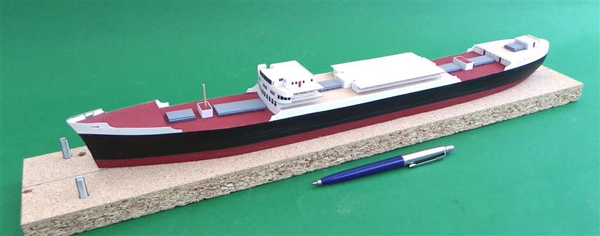

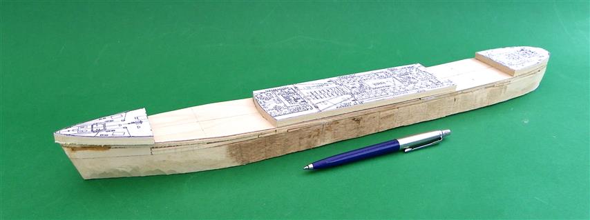

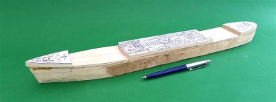

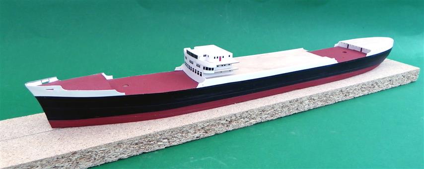

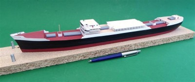

Scratchbuilding (in progress)
Bob
File comment: Ready to start
File comment: Looking a bit rough
File comment: Looking a lot better

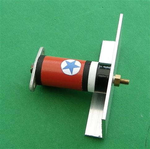

Jim,
I will first mask off the top of the funnel, and spray paint it with red oxide matt. After that is dry, I will spray paint it with vermillion on top. The reason I do this, is that the red primer tones down the vermillion a bit to give the correct shade. I will then mask the bottom part, and spray paint the top with black. Next, I will stick a white band round the black part. The white circle with the blue star on it will be produced in the compter with the drawing section of Word 2000. I will print it out on this, good quality white paper, cut it out, and stick it on. This method is very effective. The attcahed images show the Tuscan Star funnel being painted. The bracket on the second picture is so that I can stick the star on the top, turn it over and stick the star on the other side, knowing that they will be directly opposite.
Bob
PS Sorry for late reply, I didn't get a notificatuon of reply!

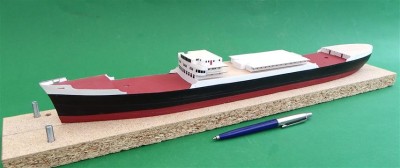

File comment: Imperial Star 9th March 2017
PostPosted: Fri Mar 10, 2017 1:17 pm
Posts: 8358
Excellent work!

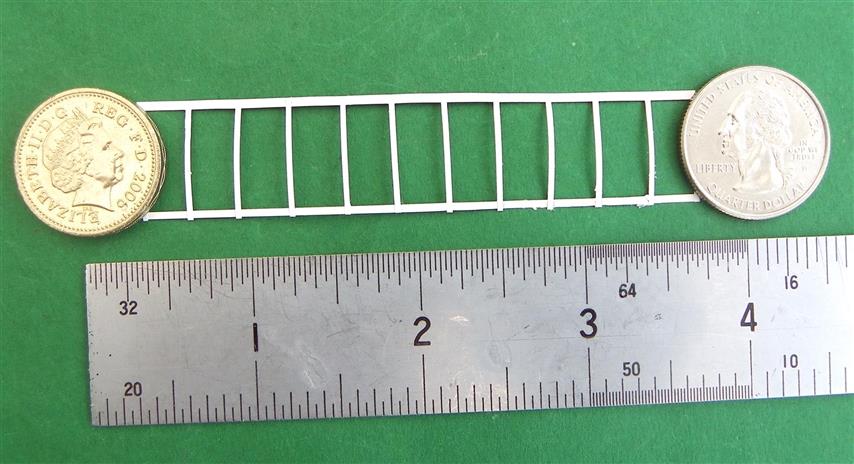

I have now made and fitted the side stanchions and guardrails alongside the port side of the after accommodation. This caused me some considerable trouble. Whenever I find a product that suits me, it is usually discontinued. In this case, it was the etch-resistant pen that I used for preparing 2 'thou brass shim, from which I etched the side stanchions. I know there are plenty of these pens on the market, but the only ones that worked for me have now been discontinued. Consequently, I had to laboriously, (very laboriously) sit down and solder separate slices of brass shim together. The first image shows my second (successful) attempt. I have cut it in two across the centre, thus giving me port and starboards sides exactly the same length. I then fitted the rails behind them, and stuck them on the model. I am delighted with the result. - Bob
File comment: Side stanchions
File comment: Port side rails and stanchions fitted
PostPosted: Sun Mar 19, 2017 1:48 pm
Posts: 5572
Very sharp result.
No need for allowing for deck spring/ sheerline?
or is it not noticeable over such a limited length?
Looking good and getting that 'busy' appearance!
JB
PostPosted: Sun Mar 19, 2017 2:34 pm
Joined: Fri Aug 19, 2011 10:40 am
Posts: 197
Location: Lancashire, England
Jim,
As I cut the stanchion assembly across in the middle to give me port and starbord sides, the bottom of the stanchions are open, and each stanchion is just spot glued to the hull at the bottom end. The strip at the top is so thin that it bends along the sheer quite well. If the bottom of the stanchions was closed as well, it would be a different matter!
Bob
