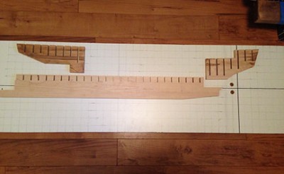

Things are moving forward. Over the last few weeks I was able to secure a manufacture I work with sometimes, to cut the ships frames for me. I am expecting these will be done this week and wait with anticipation. During this time I sourced some maple to use for the keel. I choose maple for the symbolic association with a Canadian ice breaker and because it would hold a good straight line. I notched the keel to accept the frames and that went fairly well. However, I had choose to use 3 pieces to form the keel which may have not been the best idea. In the future I will use a single larger piece to avoid the issues of alignment of the parts. The only advantage I had was in cutting the slots perpendicular and square to the base using a table saw. These were assembled and 1" sq balsa block was added to bow so that it can be shaped later. This now sits on the base waiting the frames.
Thanks all.
Gord
File comment: Maple keel parts.
File comment: Keel assembled with balsa bow

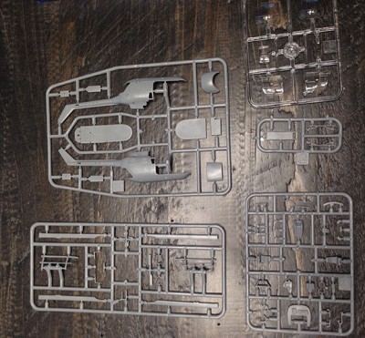

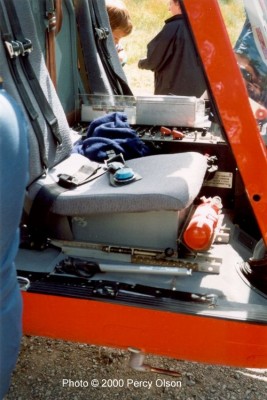

Fully realizing that this is a scratch building Ship site, I hope everyone will humour me on my initial work on the cockpit of the B0-105. The kits parts are rudimentary and the scale is off requiring a bit of modification to get it closer to reality.
More to come.
Gord

File comment: Work on the second seat. Nothing like a prime coat and some macro photos to highlight the flaws in the work. Also started looking at the seat belt construction.

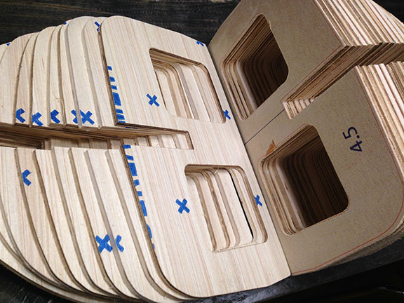

FINALLY. :woo_hoo: . The frames are cut and in my possession. I spent the night cleaning them up. I have bit more work to do as the frames are made from 1/4" plywood however the slots cut in the keel is for 3/16" ply. I will have to take the thickness down a 1/16" so they will slide in like butter. Now everything is on me to get back onto schedule. Below are some intresting shots of the compressed boat frames. Many thanks to Andy for helping me in routing these out.
Thanks for reading.
Gord

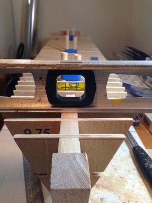

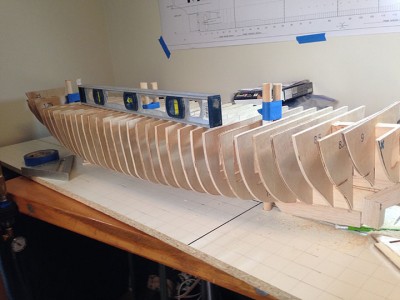

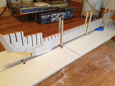

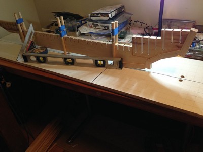

Thanks K494. Things have been going smoothly now. The keel has been set up on a board that is square and level. I used 2 dowels on either side of the keel to keep it true while working on the frames. I did not secure the keel to the board opting for the flexibility to flip the ship when it is time to skin it. Using the pressure from the dowel and tension from the tape has kept it fairly stable. Its at this point I started setting in a few of the frames. Some frames required a bit more sanding and cajoling before they sat properly. I have secured only 2 frames and dry fit the remaining while checking alignment and level. I also realize that the separate bow that was attached to the keel has an angle that is too aggressive. Once I set the deck, I will a have to adjust the frames down to align properly with the ships deck. So far so good.
More to come.
Gord

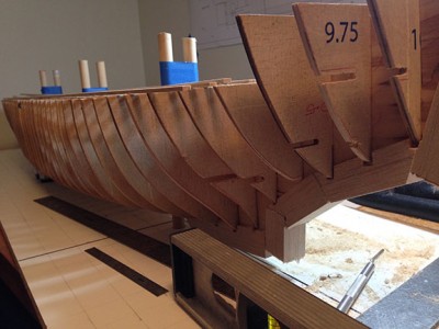

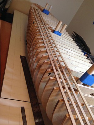

Thanks Scott154 and Aop Aur. Having the frames routed out of plywood felt a bit like cheating since I avoided the struggle of cutting these individually. However I knew there will be more than enough struggles in realizing the rest of this miniature vessel. It was handy knowing someone that could help me out in this regard and the frames fit really well with the keel. I made some more progress last night. The frames have been glued down. After finishing this I can across a few minor issues that need to be addressed before continuing. The first is that some frames are sitting a bit too high and so they need to be sanded down the 1mm+ to even it out. Not that big a deal. The bigger issue is that the forecastle frames have a bit of transverse twist with the port side being about 3mm+ too high. I am thinking to sand the top so it is parallel with the deck frames. Then adjust the hull shape by sanding the balsa skin. I have about 3mm of thickness that I can play with. If I were to cut the front off and reattach it with twist corrected, I believe I will be opening myself up for bigger problems. Any thoughts on how to correct this are welcome.
Thanks
Gord
