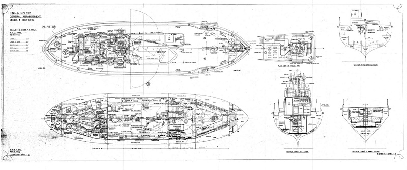

To get this project started a set of plans were purchased from the RNLI consisting of a sheet with the plan and a sheet showing the profile. The are very detailed showing all the internal detail of the superstructure and hull drawn at 1/2 inch = 1 foot. The down side to these drawings is there are only three cross sections which I feel is not enough to build an accurate hull.
Sheet 1 - Plan

A drawing showing more hull sections was required and I was fortunate to receive a set of hull lines from a fellow modeller which are drawn at 1 inch = 1 foot.
Sheet 3 - Hull Lines
With this set of drawings I now spent some time studying them to work out the best way to approach building a fully sailing model.

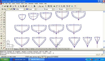

Whilst studying the very detailed drawings I came to the conclusion that I would need to draw a simplified set to work from that would clearly show the main elements of the vessel. Firstly a trip to the reprographics shop was required to have the paper copies scanned into an electronic format to be used in the AutoCAD program I use to draw all my drawings. The scanned image is simply traced over using the CAD program but there is quite a bit of setting up to do before any drawing can take place. The first step is to set up a number of layers, think of these as sheets of tracing paper laid on top of each, one of which the scanned images of the plan is placed on and locked. The other layers are used to draw over the plans such as outlines, centre lines and hidden lines. The next step the hull lines image was placed onto the layer and scaled to the size required, which in this case is a hull length of 902mm. Next the image was rotated to ensure all the vertical lines were square making it easier to trace over. Now I could start the lengthy task of drawing out the hull and frame sections.
With the hull lines completed I decided that I would start to copy the plan and profile views of the lifeboat. The setting up procedure was repeated with the image of the deck and profile views, ensuring they were both correctly scaled and lined up before I started to draw them out. All this may seem like a lengthy process but I find it a useful way of understanding how all the elements of a ship fit together and how I am going to construct the model. The attached images show the drawing in production with the scanned image in the background and the blue lines are what I have drawn over the top.

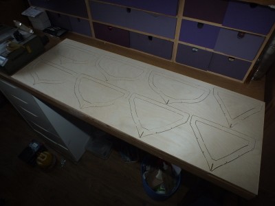

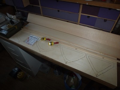

It was a couple of weeks after the order was placed that I received a large parcel containing three sheets of 3mm thick plywood, two of which contained the sections and keel cut to shape.
The first sheet has the keel and the bow and stern ribs. At the bottom is the building keel I will use to mount the keel on so the ribs will be vertical in relation to the building base.

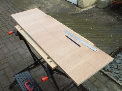

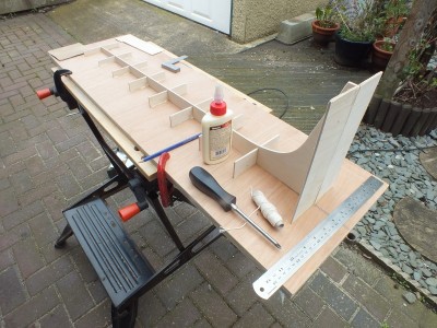

Time to start building the hull but first a base to build it on is required. I had some 18mm thick plywood sheet leftover from a DIY project so measured out a piece 1000 x 300mm and cut it out with a hand saw. Down the middle a pencil centreline was then made as a reference for mounting the building keel.
To ensure the building keel will be square to the base I cut four rectangular pieces of wood to support the ends of the building keel on the mini table top circular saw checking they were true with an engineering square. Now I could glue the building keel in place along the centreline of the base board using some rapid drying wood glue, again checking everything was square.

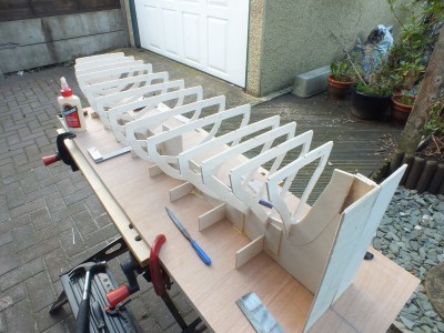

The building keel was now almost ready for the keel to be mounted, but first fourteen blocks had to be cut and glued either side ensuring they were positioned not to interfere with the installation of the ribs later. The keel could now be slotted down onto the building keel and the installation of the ribs could be started.

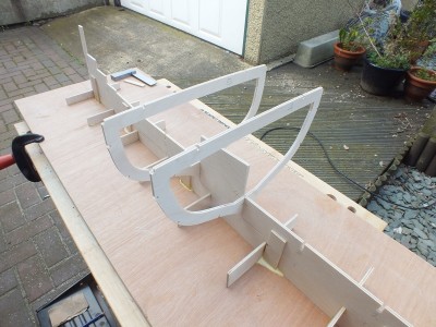

Starting with ribs four and five each one were slotted in place both side of the motor mount and checked that they were perpendicular to the building base with the engineering square. Once happy with the fitment they were removed, glued in place and checked again.
Moving out from the centre each of the remaining ribs were fitted, checked and then glued in position.

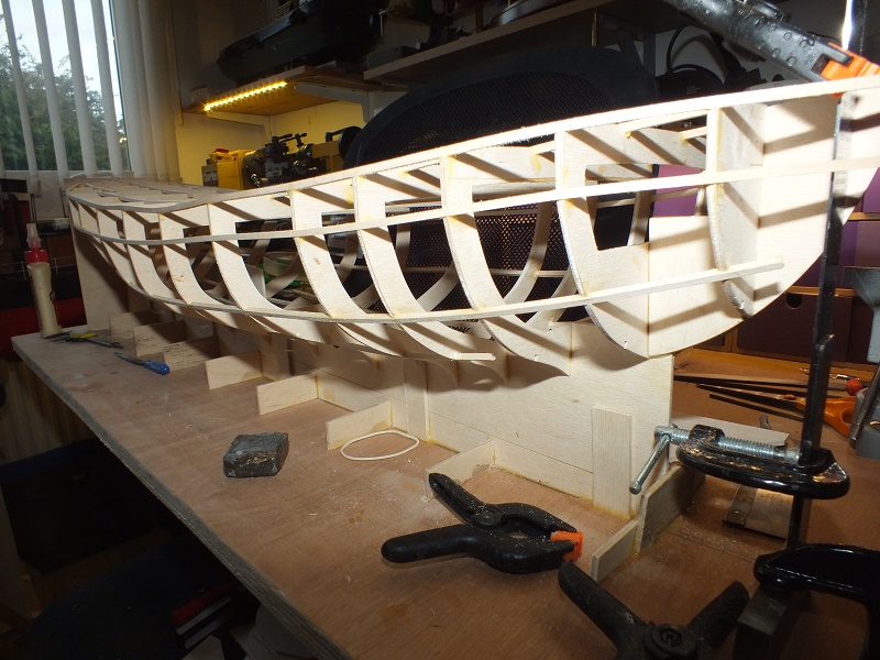

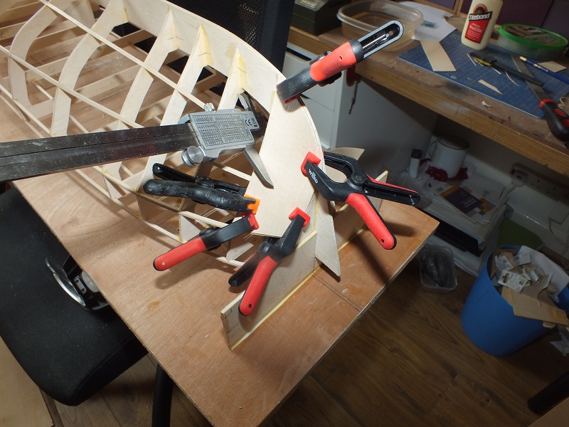

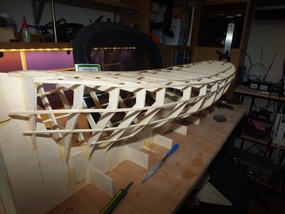

Continuing on with the hull I could now fit the rest of the stringers to the hull, a further three rows on each side, glued into the slots already cut out of the ribs. The skeleton of the hull was now complete ready for skinning.

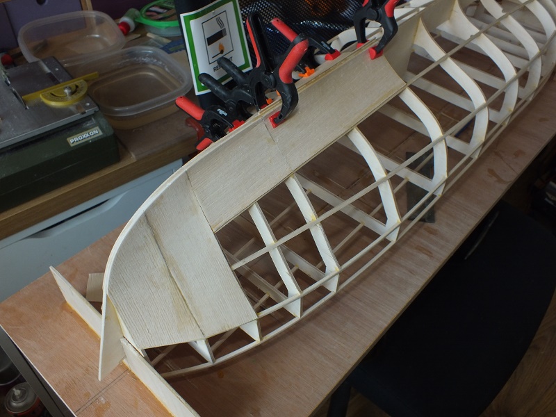

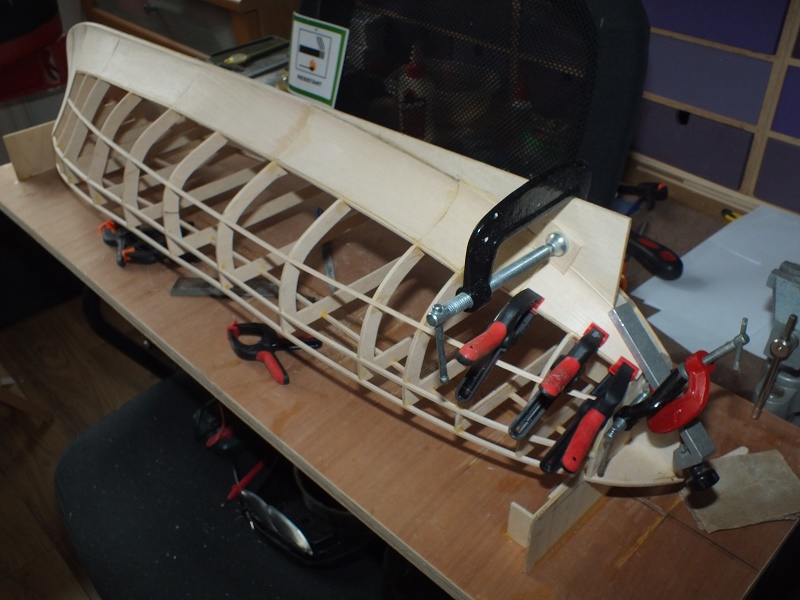

To start skinning the hull first it had to be removed from the building frame and turned over. The building frame was removed from the base board and two new building frames made and glued to the base board. The skeleton could now be mounted ready for the work to start on the outside of the hull using 1mm thick limewood. Initially I was going to cut the sheet limewood into 10mm wide strips and plank over the frames but thought I would cut panels to the shapes of the frames and stringers instead. To obtain the shapes of the panels I used thin paper held in place over the hull and the natural daylight from behind shining through drew out the required shape on to the paper. This was then cut out and offered up to the hull to check it fit. Any trimming was done and the paper shape was placed on to limewood sheet and traced around. Using a sharp knife the panel was cut out, checked against the hull frames, trimmed before I was ready to start gluing them in place. Working from the bow to the stern, along the keel and on each side the individual panels were glued and clamped in place.

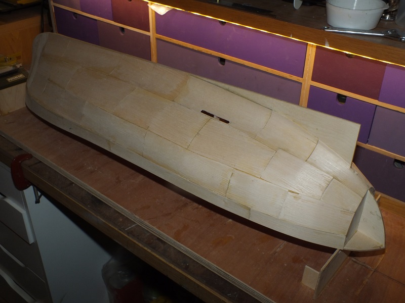

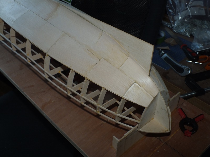

It has been some time since I have posted on this build but here is an update. I have been continuing on with the skinning of the hull with the limewood panels and have now completed them all. Looks like a patchwork quilt at the moment but it is something to work with. I have also cut the slots in the hull for the prop tubes to pass through which are quite long due to the angle of the tubes.
