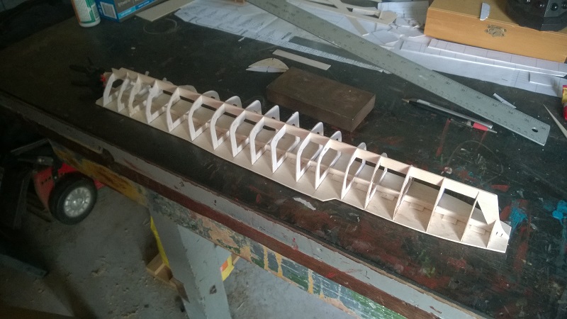

So I started this build about a year ago now and have progressed in fits and starts. But now having taken 3 weeks over Christmas I've managed to work on the model almost everyday and have made as much progress in 1 week as I did in at least six months. Now not wanting to keep you waiting any longer here are some photos of the initial build in balsa.

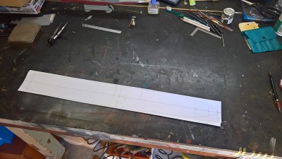

I started by converting the pdf drawings to jpg and importing them into AutoCAD so I could scale the plans rather than relying on a print shop to do this, and so I could build a 3D model. The end goal is that I want to build a 1/72 RC model of the Melbourne one day and also so I could use the hull profile to design my own carrier (Yeah, I'm a sucker for the 'Australia should have a carrier' camp) to build in 1/350 in the hopefully not too distant future.

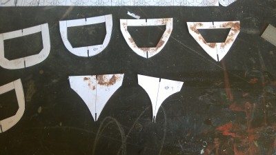

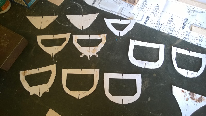

I printed the bulkheads, keel, and flight deck templates on A3, cut them out and used PVA glue to stick them to 1.5mm balsa sheet. It was at this point that I discovered how fibrous balsa was and that this could pose a challenge in the future for creating the finer details.

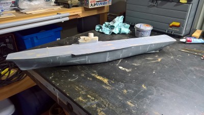

Thanks for the suggestion David. I did eventually come to that conclusion and ended up starting again from scratch for the whole ship using styrene sheet, but we'll get to that later. In the meantime this was the progress with the foam filling and hull skinning. Applying and forming the foam was pretty easy however it porosity wasn't consistent and I found many large air pockets as I sanded away the upper layers and using wood filler to fill in the gaps but this was not as successful as I would've liked. The foam also didn't leave sharp edge detail which was disappointing but expected. For the hull skin I ended up choosing to use the Eze-Kote resin and fibreglass system from Deluxe Materials.
File comment: Filling the hull with foam.
File comment: Bogging the unevenness in the hull profile. You can make these out just forward of the prop shafts.
File comment: Hull and deck all glassed up.

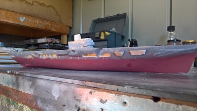

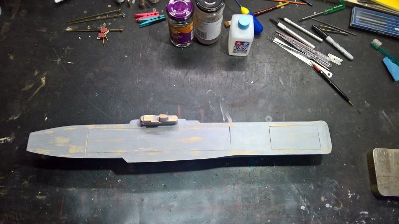

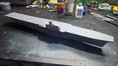

Then I had to decide how I was going to construct the island. I choose to also do this with balsa and this is where I really began to see the limitations in getting fine detail out of balsa. I guess I could have drowned the balsa shape in resin and sanded and bogged my way to the desired shape but I wasn't too keen on that idea so I struggled ahead with the balsa and a little bit of bogging with wood filler. I did get the ship to a reasonable facsimile and started to paint the hull with a base coat so I had something onto which to mark the external openings.

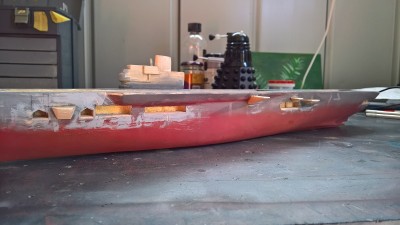

So this is where the fun really began. Cutting openings in the hull fabric was very easy to do, just not accurately. The acrylic resin and fibreglass wasn't very stiff and neither was the foam underneath, add that to the fibrous nature of the balsa and it was a nightmare trying to get that fine detail. After trying to construct the various sponsons from balsa and coming up against the same detail issues I gave up on HMAS Melbourne (Balsa).

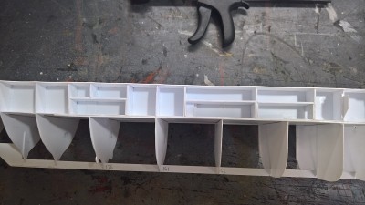

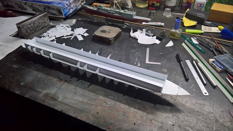

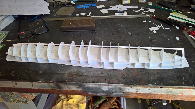

Ad so now the new build starts, HMAS Melbourne using styrene sheet.

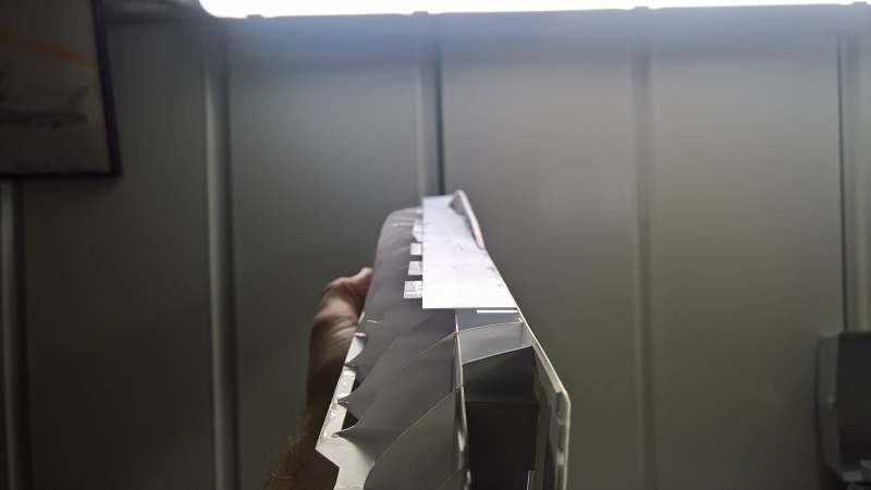

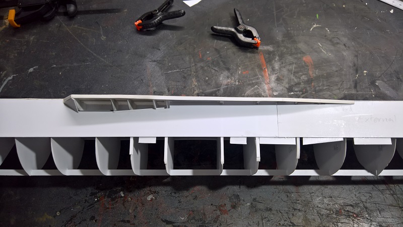

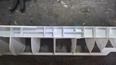

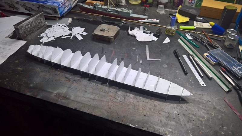

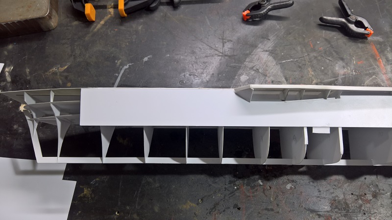

I decided to use the same approach as before: bulkhead frames attached to underside of deck then stiffened with the keel. However I deviated a little by using the underside of deck 3 as my reference. The intention was to build the hanger on top of this with all of the voids needed to detail the openings in the side of the hull. This ended up making it hard to align the flight deck, deck 3, and the bulkheads properly. Needless to say some cutting and sanding was required as well as insertion of packing.

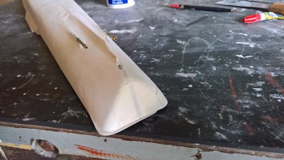

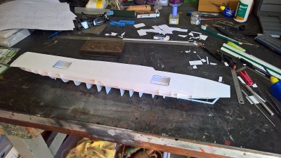

I chose 0.5mm thick sheet for the bulkheads and 1mm sheet for the keel but the 0.5mm is just a little too flexible for the job. I was also intending on using 0.25mm sheet for the hull skin but concluded that it too is way too flexible for the job. So on the next build I will be using 1mm for the bulkheads, 0.5mm for the hull skin, and will be building from the underside of the flight deck.
In the meantime it's time to build the open spaces where all the hull openings are.
File comment: Number 3 deck ready for cutting out.
File comment: Bulkheads installed.
File comment: Hanger bay walls installed.
File comment: Keel installed.
File comment: Elevator openings cut out.

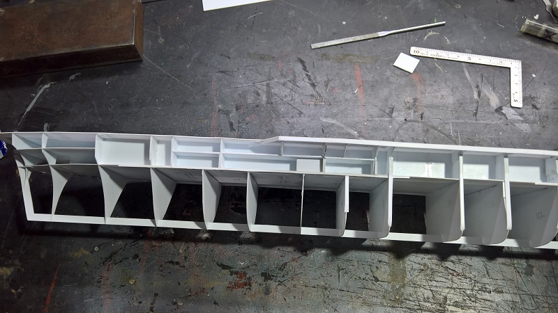

I haven't done much over the last few days being Christmas and all but I did manage to complete the basic shapes on the open deck areas at the forward end. I have been looking at 3D printed bollards, fairleads, winches, and boats to detail these areas so future progress in these areas may be a little slow until I acquire those fittings. Also need to figure out what doors I need to install (those that can be seen) and whether I'll make them or but them if available. In the meantime I will continue working on the open deck areas at the stern end.
Thanks for the support and advice. I do like the idea of additional thickness at the frame edges for a larger gluing surface.

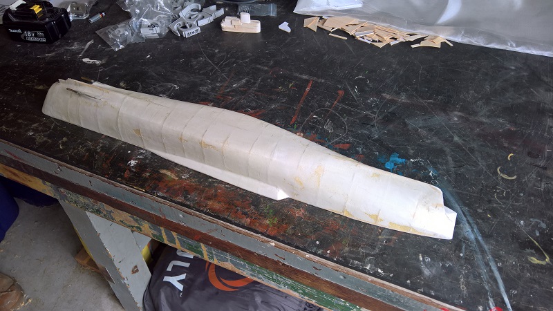

So I've managed to complete the basic shapes to the open areas at the stern end and definitely need to get onto getting the fittings. I would really like to get those installed before painting the open areas, which in turn I'd like to get done before putting the hull skin on. Speaking of which I started investigating how the hull skin was going to match up with the underside of the flight deck. I'm pretty confident I can get those waves out of the flight deck edge but can see it's going to take some patience.

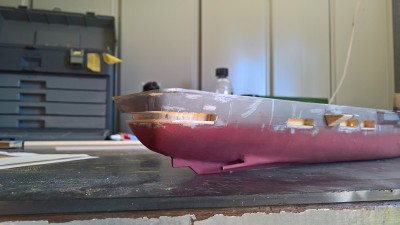

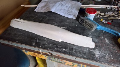

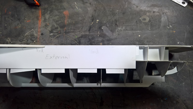

Well hull skin installation went a lot better than expected. Only a couple of areas where some filling and filing will be required. Still contemplating how I'm going to get the sheet to fit around the stern but am hoping that I can use my balsa and fibreglass version as a mould to form the sheet around, maybe softening it with a hairdryer????
