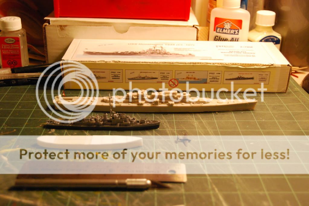

Family shot of the participants in the dio. Top is the Niko 1/700 USS Huntington (CL-107) which will be turned into the USS Newark (CL-108). The WPG hull is on the bottom. In the middle is my AAW modified Butler-Class DE and a TBF Avenger for size comparison.

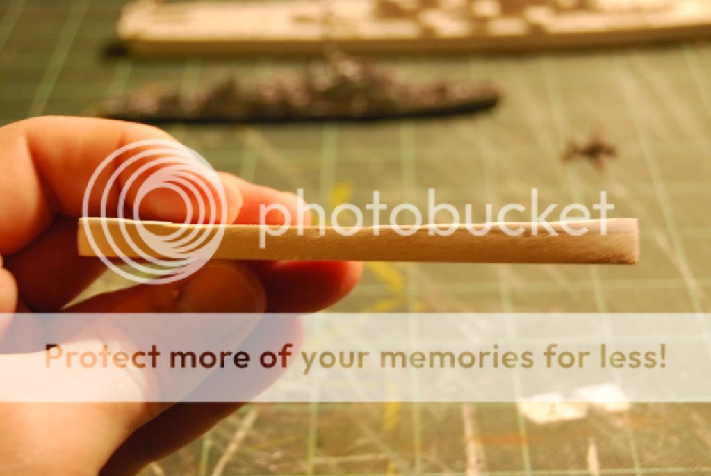

The hull. Carved Basswood with 0.5mm styrene layered to give the deck its sheer. There's also a piece of 0.3mm styrene on the tip of the bow.
I haven't carved the sides of the hull yet. I'm letting the styrene finish drying overnight. The CA glue set very fast and I was able to sand each piece after a minute or so after gluing. Made short work of it all :thumbs_up_1: I sanded the styrene to even out the curve and get rid of the stair step appearance. I'll be adding a layer of Milliput over the deck and hull sides after I finish shaping the hull to unify the shape.
