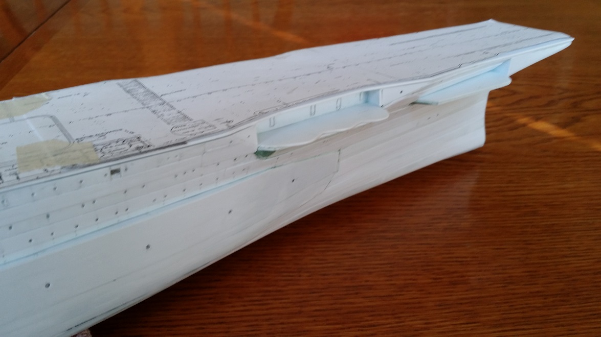

Thanks for all the kind comments!
As Lord Dingwall, from the movie Brave, would say "Feast yer eyes!" - Saratoga sure has pleasing lines.
The fine hull form of the prototype is readily apparent. It's easy to imagine why Saratoga achieved 35 knots during trials.

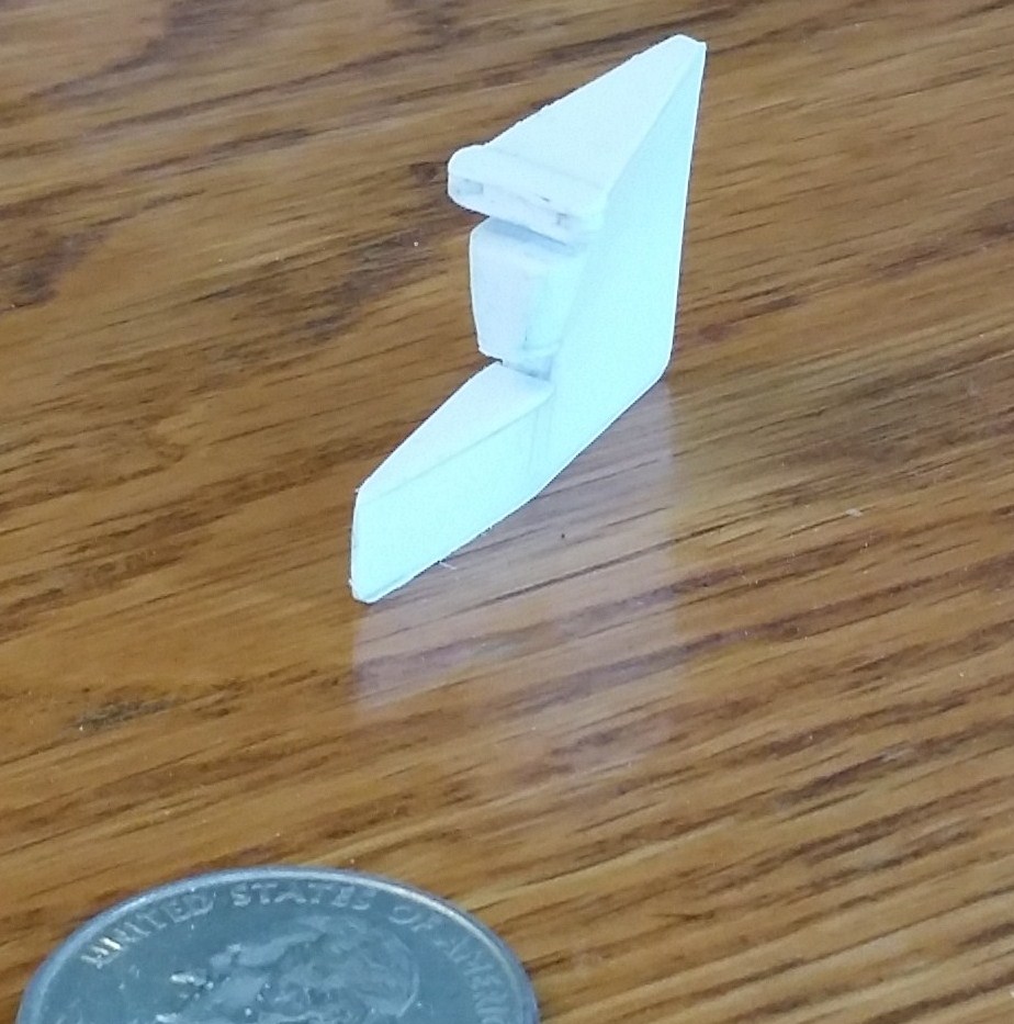

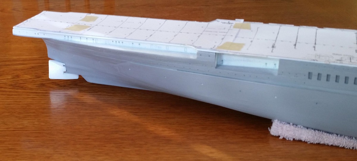

I agree, in many ways, the Lexington class carriers were ahead of their time. And I enjoy studying their features.
One of the most interesting features of the two sisters is the rudder. It has a distinct flare at the top that conforms to the shape of the hull and the bottom is in the shape of a diamond. Also interesting, the rams which operate the rudder are partially exposed. I have tried to capture the complex shape of the original rudder. Compare this effort with the Trumpeter rudder which appears to be accurate in profile but wholly inaccurate in shape.
The aft end of the starboard stability blister is just visible in the first photo. At this end, the outboard blister side tightly conforms with the contour of the hull. At midships, the outboard side is vertical and extends a considerable distance from the side of the hull.
Strake detail is also visible in this photo. It was a swine to get to look good and considerable study of photos of the actual ship was necessary to identify, locate and measure. This was only possible thanks to Tracy, Dave Doyle, and the hull sections on sheets 18 and 19 of the 1936 plans.

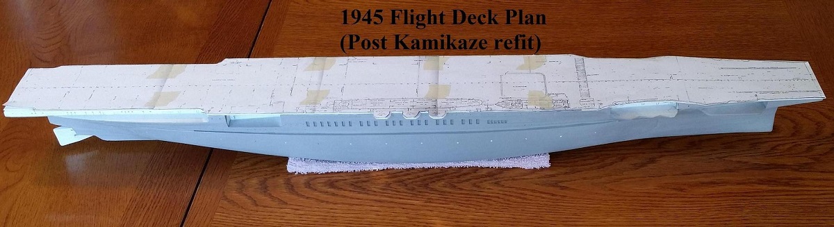

Compare the 1944 flight deck plan laid on top the model with the 1945 post-Kamikaze refit flight deck plan.
File comment: 1944 plan - two elevators.

File comment: 1945 plan - enlarged forward elevator; deleted aft elevator.

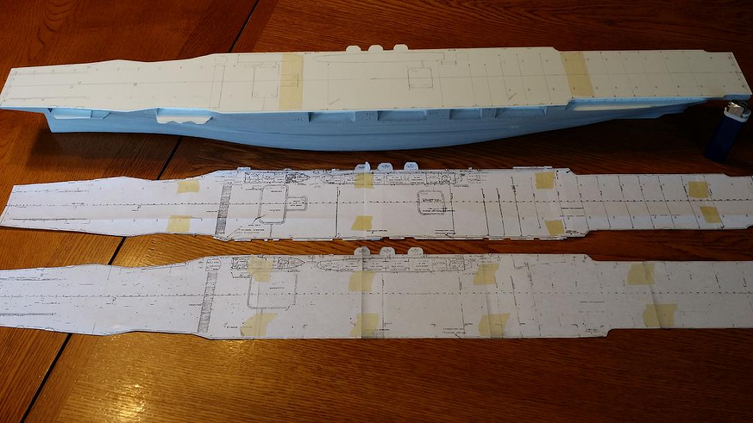

Posts: 4057
Thanks, Matt!
Here you can see that chocks and hawse pipes have been roughed in, docking keels have been installed, and the hull has been primed. In 1942, Saratoga's starboard main anchor hawse pipe had been conspicuously plated over. Next installations include propeller shaft housings and port-side bilge keel (no starboard-side bilge keel after the installation of the large starboard side stability blister).
Taking a break from further detailing the hull, Flight Deck work has begun. The flight deck's major structures and details for 1944 have been penciled on the styrene deck. Plans for the 1944 flight deck and 1945 flight deck lay alongside for comparison purposes.
