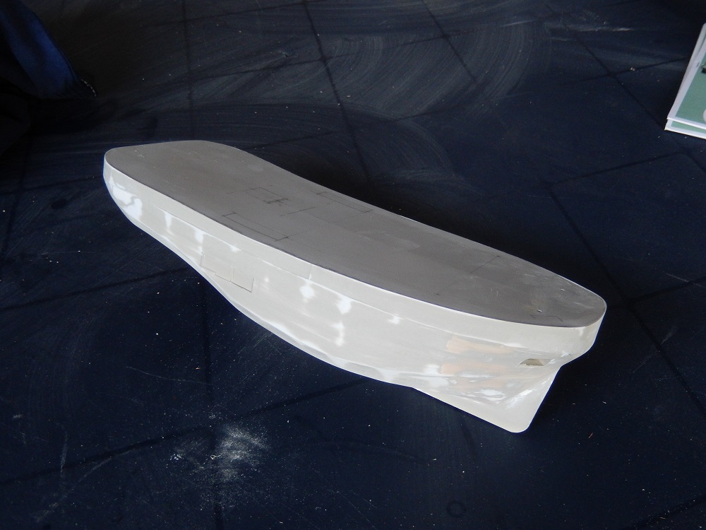

So here are the first pictures. Keel is 2mm styrene, frames are 1.5 mm styrene. The frames were later on hollowed out to reduce weight and to be able to use the styrene inside for something else (economy!). All together it's a rather lightweight construction.
Skin and deck are made of 0.5mm styrene, although in the future I'd change that towards 0.75 or even 1mm, the extra thickness allowing for some more sanding in later stages and also it would give a more smoothed out surface. (the current 0.5mm has some oil canning effect).

The first skinning. The keel was a single 2mm piece, however the plans were showing something much thicker. From any pictures of these ships I doubted my measurements of the plans. Later on I discovered that indeed on the forward part it is narrow, but the aft and middle parts were thicker. So I added extra thickness on both sides later on.

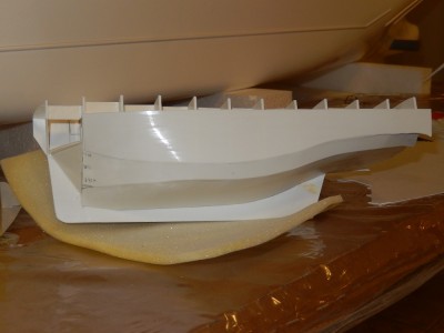

As you can see it's a knuckle-frame ship. Meaning it has plenty of flat planes. After framing, I just put a sheet of paper along it, marked all the angles/corners in each frame, and drew out the area I needed, I then transfered it to the 0.5mm styrene sheet. Started at the bottom and then in a sort of lapstrake structure added the other areas and sanded/filed the corners.
For the anchor spaces I needed some sort of structure to start constructing them. I measured them out and then made a box on each side as a starting point. After the filler I could shape the boxes during the sanding process and add the real shape inside the boxes.
Pictures will show that better of course.
Here are the boxes. I covered most of the bow and stern with styrene (2mm thick) in order to reduce the amount of filler needed. I took 2mm since these parts take some force when the filler is applied.

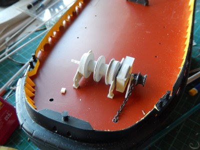

Finally here we go with the last developments in this build. Things were going relatively smooth, with the lessons from Chaconia applied to create the winch for this tug.
Main problem with winches is the positioning and tensioning of attached wires/chains.
First I put the anchor side of the chain inside the hawsepipe and fixed it with the brass fitting you can see in the above picture. Then I drilled the hole to the chain locker in order to adjust the length of chain. Then it was a game of lining up the winch and the holes.

Forgot to mention.
Winch construction is just a collection of punched discs of different thickness. On each side you can see two brakes, powered by hydraulic pistons. The small dots are the bolts with which the brake lining is fixed to the structure. I tried to copy the real bolting pattern for that, thought it was a necessary detail. Basically I punched the small dots with a needle in some litho strips. Then laid the strips over two 2mm thick punched styrene discs. The last detail I added were the pistons.
The warping ends are made in the same way as I did for Chaconia. Practically a piece of styrene tube with on both sides a disc. On one side the disc is drilled open and the details inside were added.

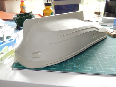

As promised, more progress on the superstructure:
The superstructure is made of styrene sheets with rounded corners made of cut up round profiles.
The backside.
And placed on the ship:
The central hole you see at the bottom is a tunnel below the superstructure to allow the towing wire from the forward winch to pass aft and tow with the stern rather than the bow. The towing fitting as shown in the above post, will actually hide most of that tunnel.
Due to the constant trim of these ships when they are underway (aft is always deeper than forward), the deck is also tilted, while in that condition, the superstructure is straight up. Therefore I made the superstructure complete and only cut the bottom afterwards to align it with the sheer of the deck.
After the construction I treated it with spray putty to avoid too much unwanted contrast under the final white coat. Afterwards I added the railing and handles to the different ports. They'll be black in the end, so no contrast problems there. Next are the eye brows on the windows and then it's the white coat.
The merchant shipyard

In the meanwhile I've added all detailing and added the hatches to the main superstructure block and painted it (spray can).
I did encounter 1 problem, didn't take into account that the white can I bought was Alkyd paint and not Acrylic as the others. Apparently you can spray Alkyd over Acrylic, but not Acrylic over Alkyd. I thought perhaps with sanding in between etc. and the Acrylic primer not being strictly called acrylic laquer, perhaps it would work. It didn't.... Paint nearly immediately started crumbling and forming small mountains.
So in the end I sanded everything down to the spray putty layer where I had to apply the red acrylic primer, then applied the primer. It didn't come out perfectly since even the slightest contact between the dried out Alkyd and the acrylic are reacting badly.
I'm now busy with the black parts, mainly the funnels and aft surfaces of the funnels.
At the same time I'm also proceeding with the construction of the most challenging part, the bridge. Pictures will be up soon.
