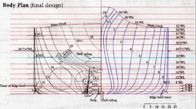

I loaded this graphic into a CAD program, sized it at 1:1 scale, and carefully traced the hull contours with spline lines (dark blue).
Please let me know what the vertical contour lines, numbered 1-20, indicate. A newbie question I know, but, then, I'm a newbie ;-)
The light blue horizontal line is where I'm thinking will be the hull bottom for this model.
Say, what do the letters 'KNU' indicate?
-Brian Chapman
Cedar Rapids, Iowa

Do you mean 11 to 20 on the left half of the diagram? They're for the aft half of the ship. The ones you've done in blue are only for the area between the bow and midships.
PostPosted: Tue Apr 23, 2019 11:49 pm
Posts: 1677
The vertical numbered lines are "stations" spaced at intervals along the length of the hull. For US Navy ships there were typically 20 stations between "perpendiculars" along the hull length. The perpendiculars were the normal load waterline at the bow and stern - the length of the hull on the load waterline. Where the bow met the load waterline was called the "Fore Peak" (FP) and at the stern was the "After Peak" (AP). Station 0 (zero) was at the Fore Peak and station 20 was at the After Peak. Half stations were spaced between full numbered stations, typically forward of the Fore Peak and aft of the After Peak. Stations were just conceptual lines that were used to create the initial design. They were not actual parts of the hull construction. However, they are useful for modeling the hull.
The engineers drew up the initial hull line drawings using station lines and then used formulas or models to generate the mold loft numerical values for the actual frames. These are the numbers in the Table of Offsets. Frames were spaced at 4 foot intervals, with half frames below the normal load water line at 2 foot intervals. There were 216 frames between the FP and AP on the Iowa class ships.
I checked my blueprint drawing manual and found no mention of "KNU." A "knuckle" is a distinct sharp line or edge in hull plating. However, on your drawing there are no sharp transitions in the hull plating surface.
On the New Jersey drawings the 34' - 7 1/4" waterline is marked the "DWL" - Designed Water Line - where the ship would float without the normal load (fuel, ammunition, personnel, etc.). When loaded the ship would float a bit deeper. Your blue line is a bit too far down.

Phil, stations, then (20 of them) are arbitrary and do not relate to frames or physical markers, they're for initial design reference only? So, iirc, the length of the ship between FP and AP (which I have marked on the side view of Iowa) is 860 feet. 20 stations divided into 860 feet is 43 feet between contours?
From this information, I can CAD plot the different horizontal WL levels of the hull's 20 stations by plotting where the WLs meet the hull, correct?
The Blue Line indicates the next WL below the top of the Boot, just wanted to make sure all the boot was included. Is this an adequate WL for the bottom of the hull on a WL model?
Thanks again. -Brian

The stations were just for the initial design. They were not used for the actual construction, so if anything was placed at a station it was coincidence. Looking at the Booklet of General Plans for the USS Missouri BB63 (1950) the AP is at about frame 215. 215 x 4 = 860. 860/20 = 43 feet between stations.
The top of the boot topping is 37' 6" above the bottom of the keel. Lower limit of the boot topping is 26' 6" above the bottom of keel. So the boot topping was 11 feet high. Design Water Line (DWL) was at 34' - 7 1/4" above the Base Line, and the Base Line was 2" above the bottom of the keel. So the DWL was 34' - 9 1/4" above the bottom of the keel.
Most elevations (including water lines) are referenced to the Base Line, and not to the bottom of the keel.
You can use the station lines and water lines to plot the shape of the hull. But keep one thing in mind - the station lines show the INSIDE of the hull plating. This is called the "molded shape." So the actual width of the hull at the station lines would include the thickness of the hull plating. The plating was not the same thickness everywhere. To get the exact dimensions you will need the hull plating drawings. Generally, the plating is thickest midships, and thickness generally increases from the top of the hull toward the bottom - but there are exceptions. Also, station lines do not show any external armor belts, but the Iowas didn't have external belts..
At 1:120 scale the difference in thickness between 1 1/2 inch and 1/4 inch plating is about 0.010" or about the thickness of three sheets of notebook paper. So it isn't worth worrying about.

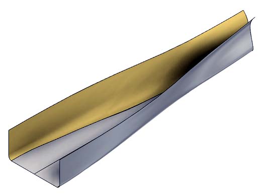

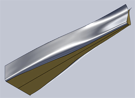

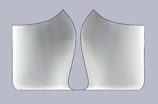

I've learned how to create the Iowa Class body shell using Fusion 360. I'm very pleased with the half-length hull I've created so far. The hull bottom curve about mid-way along the length looks squirrelly so might have to deal with that later. Although, I'm likely to do a waterline model.
I used stations 1/2 thru 11, this section measured 453 feet-plus. Spacing between sections is 43.2 feet.
Here are a few screen shots of the hull.
Brian Chapman / Cedar Rapids, Iowa

Looks to me as though the bottom curvature needs a consistent radius of curve all along the edge. I'll edit those to make them the same, which, I hope, will eliminate the bulge at the middle of bottom outside edge. And, then, maybe that will reduce the pinched area of the bow (terms, I'm still learning).
Brian C.

Been waylaid several days now by something nasty from the planet Virus. Wanted to experiment more with the shell but haven't been up to it.
Where sides meet bottom, in the middle of the length, something doesn't look right, even though I precisely traced the station lines in CAD. Looks like the radii become larger, extending the radii up the side of the hull.
Not sure what to do about that.

Looking at the hull sections in the USS New Jersey BB62 Booklet of General Plans it looks like the radius does get larger gradually forward of the vertical sides, and then the radius gets shorter again near the bow, so maybe your hull isn't wrong here. Most other battleships don't have the vertical sides, but American ships had to pass through the Panama Canal with locks only about 105 feet wide, so our battleships and carriers had the sharp radius at the bilges and vertical sides. But forward and aft of the widest beam the hull shapes were "normal" with varying radii at the bilges.
It does look a bit "pinched" aft of the bow, but the hull actually does this a bit because it is concave and wider at the upper flair and the bulbous bottom near the bow. It looks "pinched" to me because the transition from concave forward to convex aft seems to be too sudden. This could be due to a simple misplaced point on one of your station/frame curves. Been there, done that!
Just looking at the hull lines it would appear that the sharp transition is somewhere between Frame 13 (deep concave) and Frame 46 (wider radius and flat side).
However, this appearance may change as the hull is rotated and lighted at different angles. Your hull may be correct and just looks "pinched" at certain view and lighting angles.
One trick I have used to verify the curvature of a hull surface is to generate "contour" lines where horizontal planes intersect the hull at different elevations - the same as waterlines in hull line drawings. Any sharp kinks in a contour line indicate where a point in a frame/section line is out of place. This is especially useful when generating a hull surface from Table of Offsets numbers, because those hand drawn tables often contain slight errors. When the draftsman was copying lots of numbers from the engineer's notes there was potential for transcription errors!

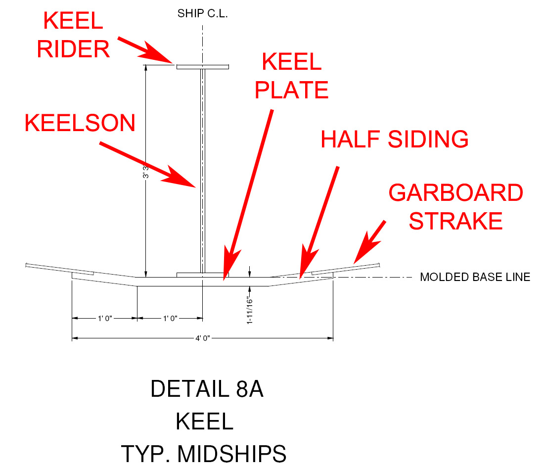

I do not understand to what the half-siding lines, bow and aft, refer. Googled the term using ship design in the search term but returns were not enough for me to understand what they are.

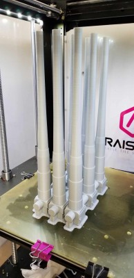

Nice work, Brian, enjoying the discussion and your efforts!
If there are any Model Monkey products you would like made available in 1/120 scale to save you some time and effort, just let me know. Products in big scales can be done. For example, a client in Washington state is presently building a USS Iowa BB-61 model in 1/48 scale. Yes, really, 1/48 scale. The turrets, directors and some fittings for his ship are all Model Monkey designs.
Here are the 16"/50 barrels for his model:

On WWII era warships the very bottom of the hull often consisted of a flat keel plate (part of a large "I" beam) with additional plates welded to it on either side. These additional plates were called "half siding." Outboard of these were the "garboard strakes."
On flat bottomed ships the half siding was just half the width of the keel plate. On ships with upward slope of the plating outboard of the keel (dead rise) additional half siding plates were often welded to the bottom keel plate, at an angle equal to the angle of the dead rise.

Phil, ". . . additional plates welded to it on either side . . ." And welded underneath? Which accounts for the 2" plates under the molded baseline?
Near the top of this thread is a graphic showing the station lines from fore and aft views. The shape of the half-siding plates on this drawing are throwing me for a loop, the way they run vertical. And, the Iowas are flat-bottomed, correct?
