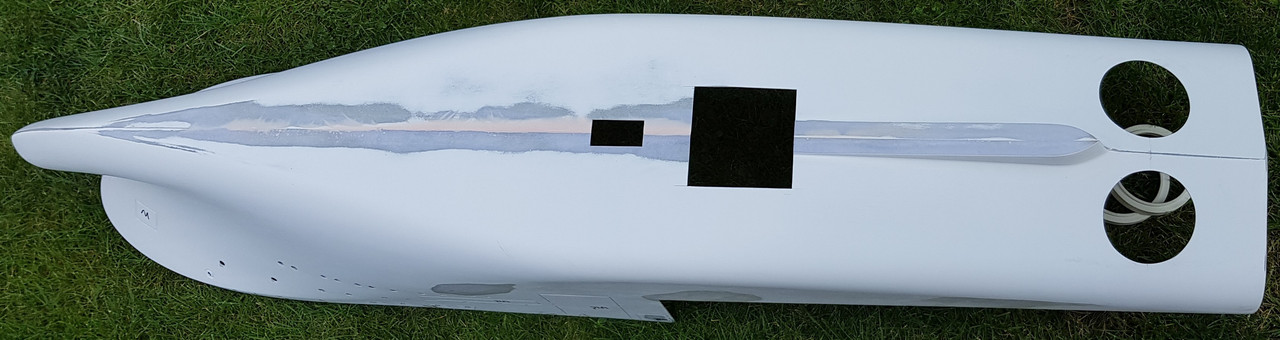

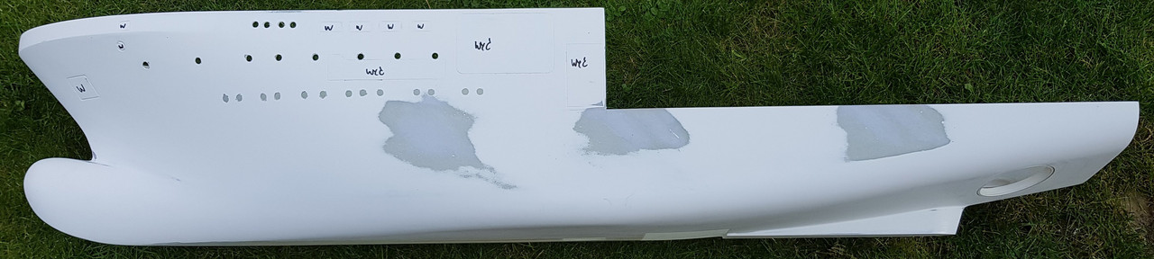

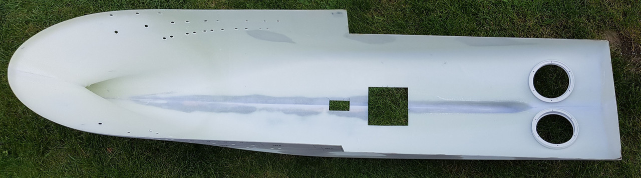

I don't know if this is a good department, but I would like to show you the construction of a 1/75 scale Edda Flora inspection ship bought in Germany from Bauer Modell.
The model is intended to be RC. I bought a laminate hull with a deck and plans (4 sheets A0). The deck material will be HIPS 2mm reinforced from below with foamed 6mm PVC. The superstructures will be milled parts of HIPS of different thickness.

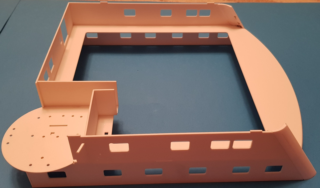

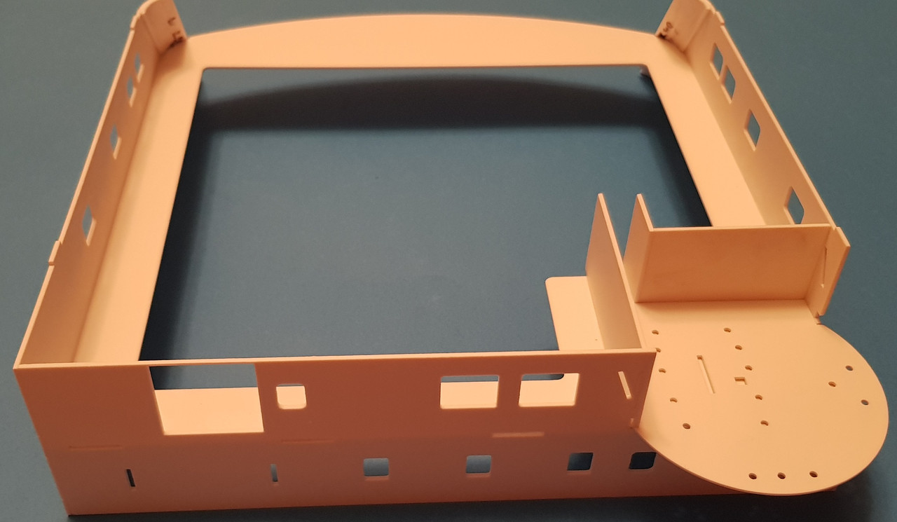

Superstructure lower level

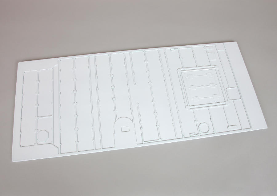

Some laser cut parts
Fiberglass hull

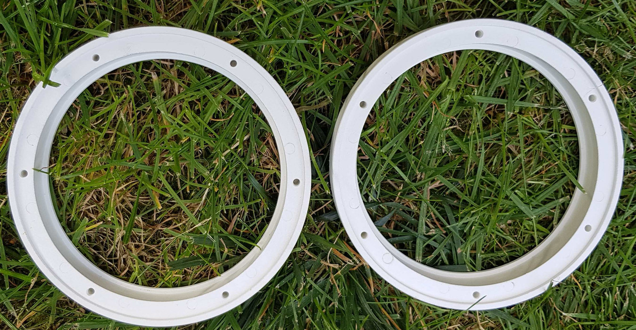

VSP drive mounting rings

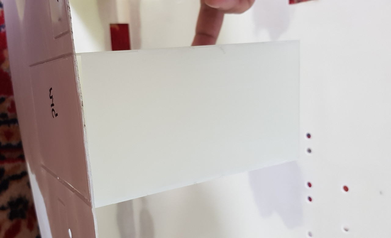

Superstructure wall with windows openings
Hole for vertical bow thuster
Moonpool and sonar wells
ROV hangar
Laset cut superstructure construction

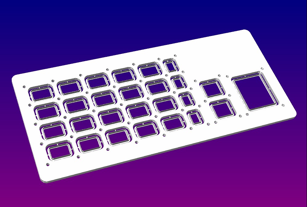

Windows frames (cnc cut)

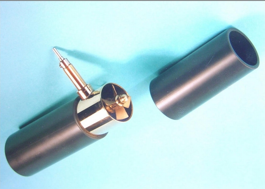

Typical bow thruster (needed two sets)

Fiberglass hull

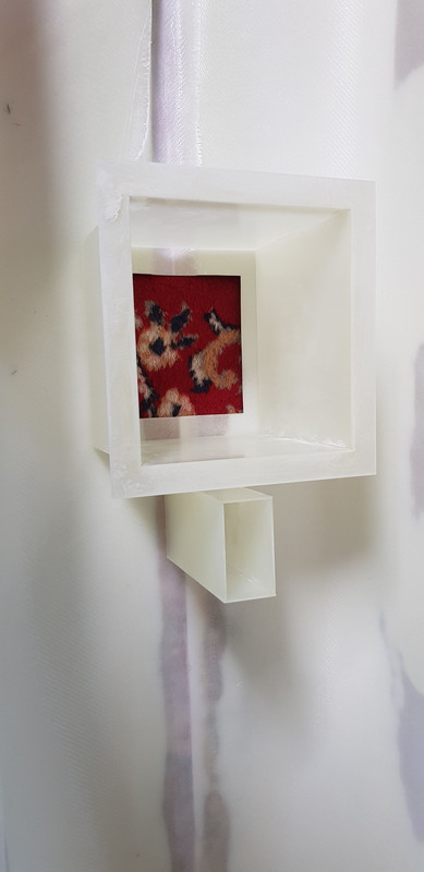

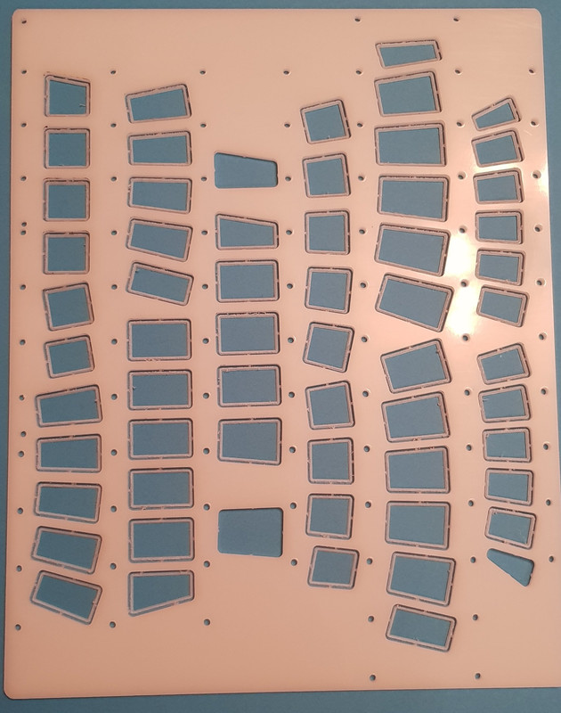

New windows frame (not included in kit) - my design (cnc cut)

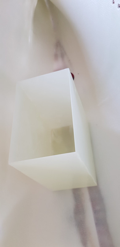

Vertical bow thruster from Haller (3D print) - needed to mount with 2 servos and electric motor on top

Great choice. Love that retractable thruster, very curious to see that in operation. :woo_hoo:
Strange to see a vessel like that propelled by Voight-Shneider thrusters rather than Azithrusters/Azipods/Z-drives.

I like your CNC windows ...
very neat and sharp!
Jim B :thumbs_up_1: :wave_1:
PostPosted: Tue Mar 24, 2020 2:44 am
Joined: Fri Mar 13, 2009 2:04 pm
Posts: 45
Location: Poland, Gdynia
Hello Jum
Because this is CNC cutting :)
