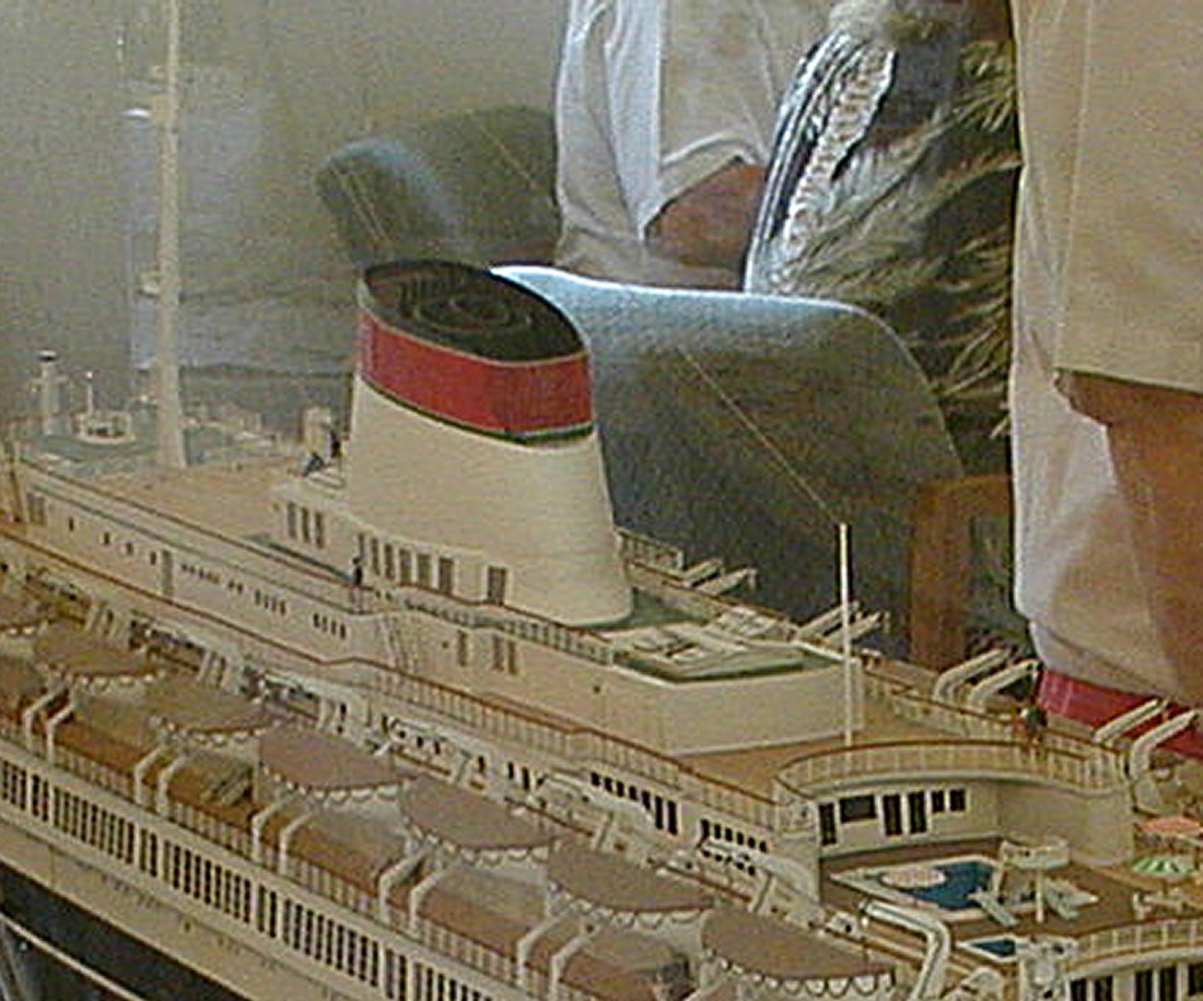

Hi guys, build is progressing but I've hit a problem with the funnel.
My plans show it as a "normal" solid funnel but the photos show a cut out on the front and another at the back. Does anyone have a clear photo of what the funnel actually looked like close-up?
Many thanks>
Patrick

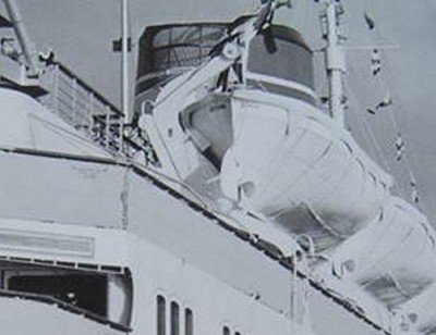

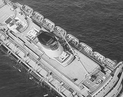

PostPosted: Thu Sep 12, 2013 4:47 pm
Posts: 5568
Try and grab a still from this when viewed at full screen--it may elicit some info
http://www.youtube.com/watch?v=7oKmt-jj5HM
I have had a look at flickr-- nothing there alas that is useful for the funnel
do however search the Life Magazine site--they did a photo coverage of the sinking
nice hgh res images--as the ship listed some of the images should show the funnel area
Good luck
Jim Baumann
I think I can see what you mean-- but better images will be useful!

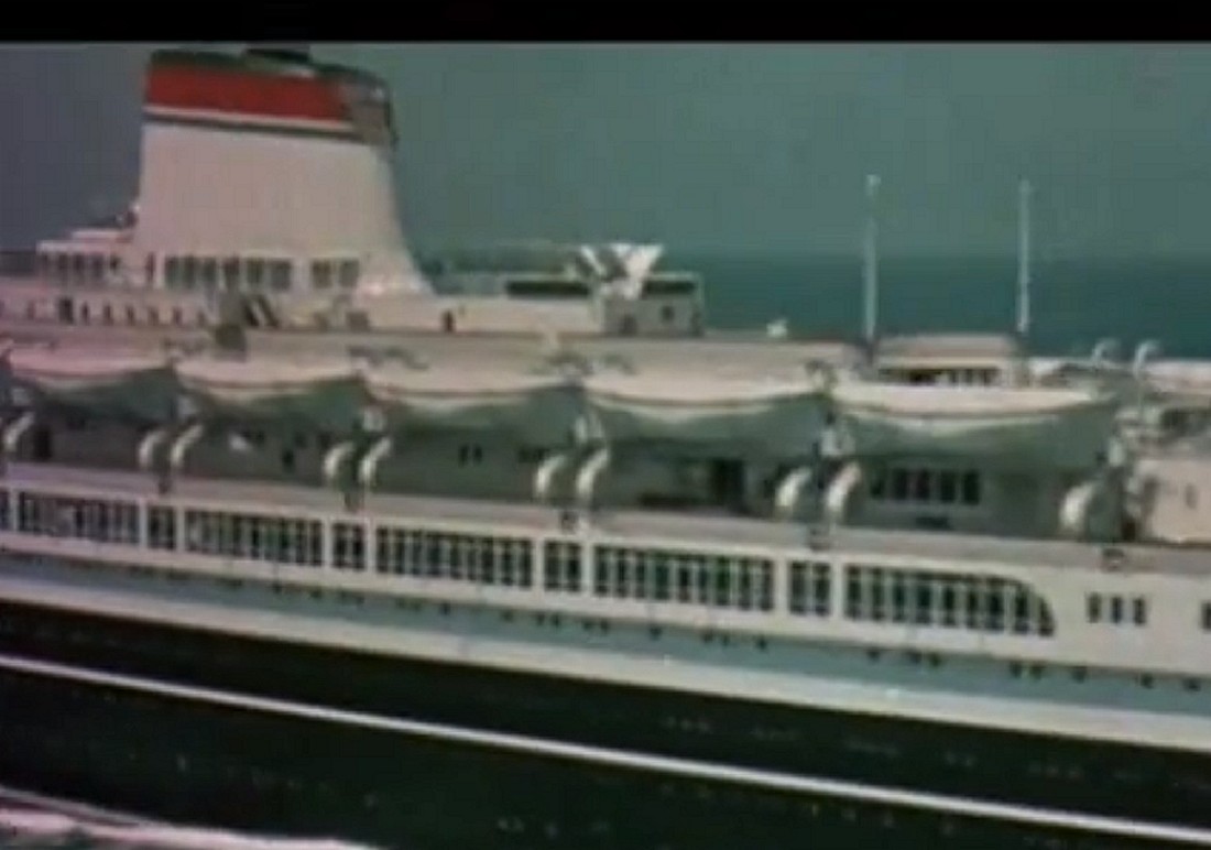

http://www.playerwindow.com/gxLv1az0Tpk
and this is the puppu ....
I entered andrea doria (smokestack ) in italian....
result !!! :thumbs_up_1: :thumbs_up_1:

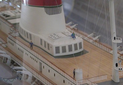

Hope these help. Front and back of funnel had same type of vent openings

Wow .! Those are some great shots. Many thanks guys, just what I needed. ......... now to think how to reproduce the effect ...."Hmmmm lots of tea required" he says ...as he pulls out a new 10A blade and fits it to his scalpel!

Many thanks for the advice. You always seem to be helping out with my ships' funnels: First the Normandie then the Michelangelo and now the Doria!
I've already tried looking through my PE box and I'm thinking of using 3 lengths of ships railings placed vertically and superglued together. The pictures show that the grille on the Doria was in 3 sections with thicker vertical members between. The top and bottom rails of the 3 lengths of PE railing will become the thicker vertical members - well that's the idea at least. I think it will work.
I'll have to carve out the top section of the funnel in order to build the inside and then form a cowl around the top. A fair bit of work to do but whenever you look at one of these models you always seem to be looking straight down the funnel ...... if the funnel doesn't look good it spoils the model.
