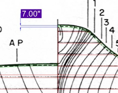

Step 1
I'm using the Body Plan (Station Lines) found in Paul Stillwell's book, 'Battleship New Jersey', pg. 295.
I scanned the drawing into Photoshop, which allowed me to size independently horizontally and vertically to account for paper stretching during printing. Also, I corrected for angle of rotation so that the baseline is zero degrees. With adjustments made, the Fore, Aft and Midship deck heights were on the mark, as was the Hull width.
The deck heights, as well as other key dimensions, are found on the General Dimensions chart included in the Booklet of Plans for the several Iowa Class ships retrievable online.

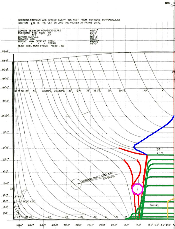

Step2
Once the Deck heights and Hull width were established in Step 1, I added the horizontal Waterlines (red) every four feet from bottom to top by using the software's Offset Tool for accuracy - the printed drawing's Waterline 48-inch separations vary, noticeable in the drawing below.
The Body Plan's dotted line indicates the height of the main deck, and the dotted line is what I used to create the deck heights above. The bottom Green line (below), using the software's Spline tool, is the Main Deck tracing, the top Green line is the height of the Side Plates that extend above the Main Deck. I settled on a 7-inch height for the Side Plate extension above the Main Deck - this doesn't include the 2-1/2 inch round that sits atop (or partly buried into) the 7-inch extension.

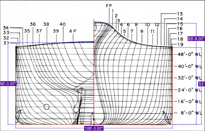

Step 3
Again, using the software's Spline Tool, I traced the drawings Station Lines (Green), sparingly using Control Points by snapping to the center of Station Lines where they crossed the accurate Red Waterlines. On a few of the sharper curves, I did click on intermediary spots between the Red Waterlines to create the correct curves.
At the far edges of the Beam Width, the drawing's (mostly) vertical lines amidship blurred together, so I did have to estimate distance ratios in that area. I'll see how that works when I join Station Lines with a skin in 3D using the Loft Tool. I think it'll work well.
Question 1: Station Lines 20 through 30 are not shown on the drawing below. Might this be because the Hull in these locations is full width and 90 degrees vertical?

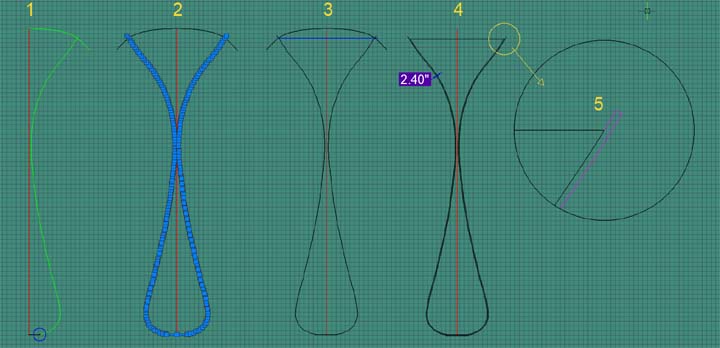

Step 4
I'm working with each Station Line separately, drawing them in 2D then importing into the 3D program and spacing them correctly along the length of the ship's bottom Center Line.
So, for each half-station line in the above drawing, I: Copy (1) and extend the baseline (short Black line) between the Station Line base and the Center Line, and radius the connection an arbitrary 12 inches. Mirror (2) the half and Join the two halves into one Polyline. (Note: The Top curved line represents the Main Deck, not the Side Plates that extend above the Main Deck.) Create (3) horizontal line (Blue) at Main Deck height from side to side.
I understand Station Lines do not represent the external surface of the ship but, rather, the lines of the ship inside the external plating. But, I'm using the Station Lines to represent the ship's outer surface and sized them that way above in Step 1.
Copy and inset the Station Lines (4) 2.4", or 0.020" in my model scale. This could change, but I'm planning to skin the model with 0.020" thick ABS sheet to represent External Plating. Also I used the horizontal line to trim the inset Station Line at the Main Deck level.
Up-close illustration (5) of the inset Station Line, the Main Deck, and, in Magenta, the 2.4" External Plate.
Question 2: With this size model (10.8" beam), should I shape the Main Deck to show its Camber? Or, would that be asking for trouble beyond what it's worth?

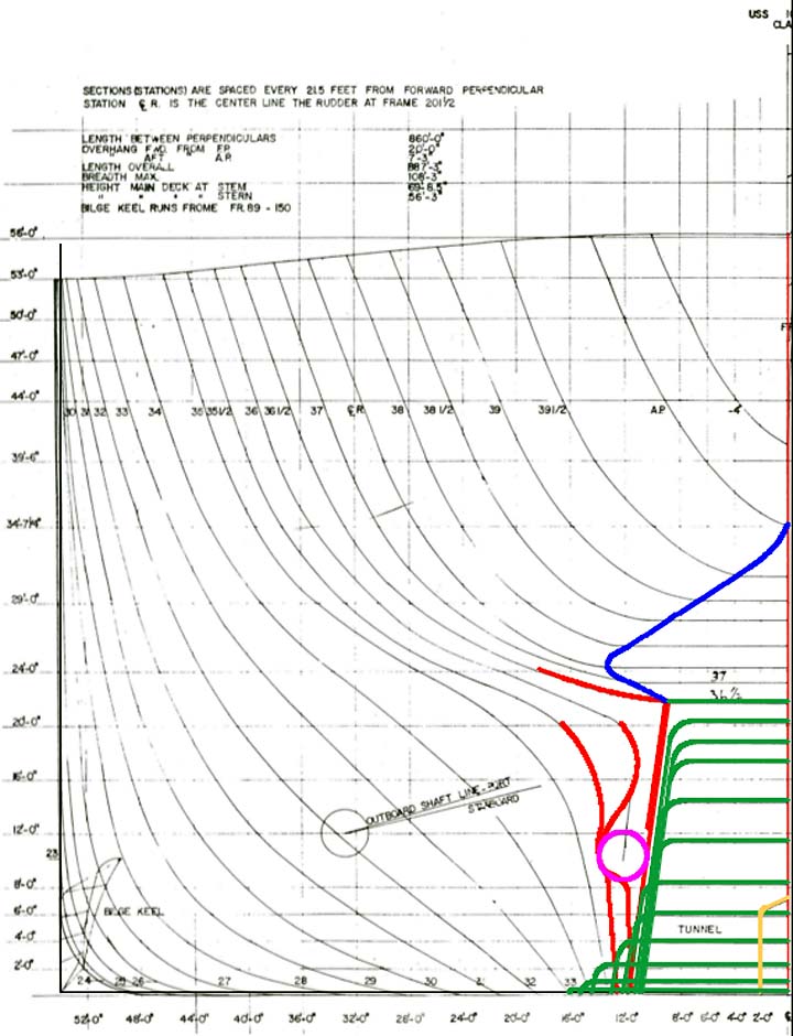

Step 5
The Skegs and Tunnels are giving me trouble. Hope I can get a bit of help here.
Question 3: The Blue line marks where Hull curves end and the Hull becomes horizontally flat?
Question 4: The Red lines show the shape of the Skegs - even the left most Red contour?
Question 5: I don't understand what the Gold outline illustrates since it's within open Tunnel space.
The Green lines represent the Tunnel as it grows taller toward the Stern.
Question 6: The Green lines do not match up well with the Hull Station Lines. Are they not meant to match up with the ship's Stations?
Question 7: The Side elevation of the ship reveals (once the Station Lines are marked every 21-1/2 feet AP-FP) that the aft Hull begins to rise about the 27-1/2 Station mark, not about the 33 Station mark immediately above. WTH? ;-)
I've looked around online for Iowa Class Skeg/Tunnel photos. Found nothing too helpful.

Good job, great plan, and kudo's to you. I too am gearing up for a build, but of the BB62 and in 1:96.
I'll add though, that the 'gold lines' that you're asking about, are for the "Docking keel". That seems to be left out of most 'reproduction's' as well as discussions.

The short keg at the forward end of the aft tunnel is to support the weight of turret three as the hull girder begins to thin here, despite the huge appearance of the after deck. Particularly helpful, structurally, when dry docked. Consulting one of the available centerline profiles shows this relationship.
Some people on the forum have rather extensively researched the Iowa's hull shape, "Big Jim Blade" comes to mind. For those of us doing traditional hull construction methods, our transpositions are perhaps not precise enough to realize the possible increase in significant figures. Using almost any of the available drawings one will be much more accurate than the plastic kits on the market.

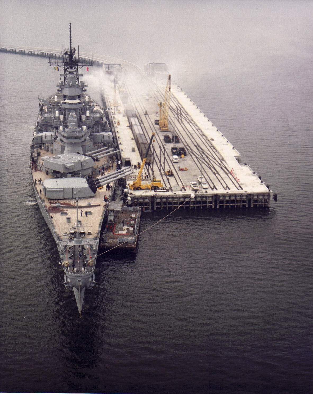

Ryan S., curator, Battleship New Jersey, posted a video (YouTube, all his videos are good!) about the battleships transiting canals. I'll post the link below. At the 6:30 mark, I believe it is film of BB62 sliding through Panama locks during Vietnam War.
There is a sailor holding a ruler between the hull and side of a lock. Interesting. But, it also shows the round at the top of the side plates. Looks like 2-1/2 inches in diameter to me. What do you guys think?
https://youtu.be/qzRhYaTg354
