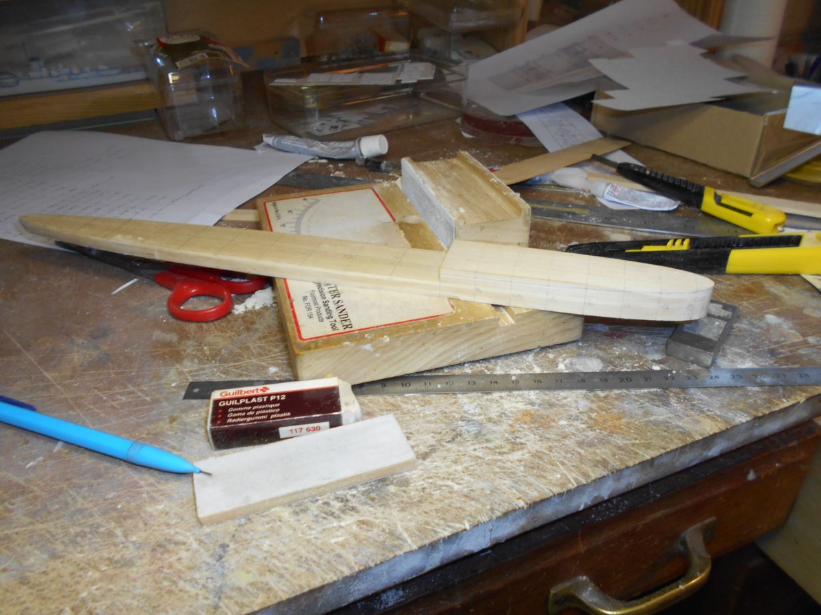

I've tried to build the hull using styrene frames, but the central one was to thin (0,75 mm) and the hull was warped !
I returned to my usual method : solid wood

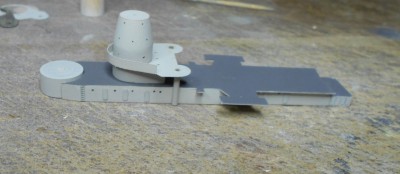

I finished the hull and turrets. I was not very busy

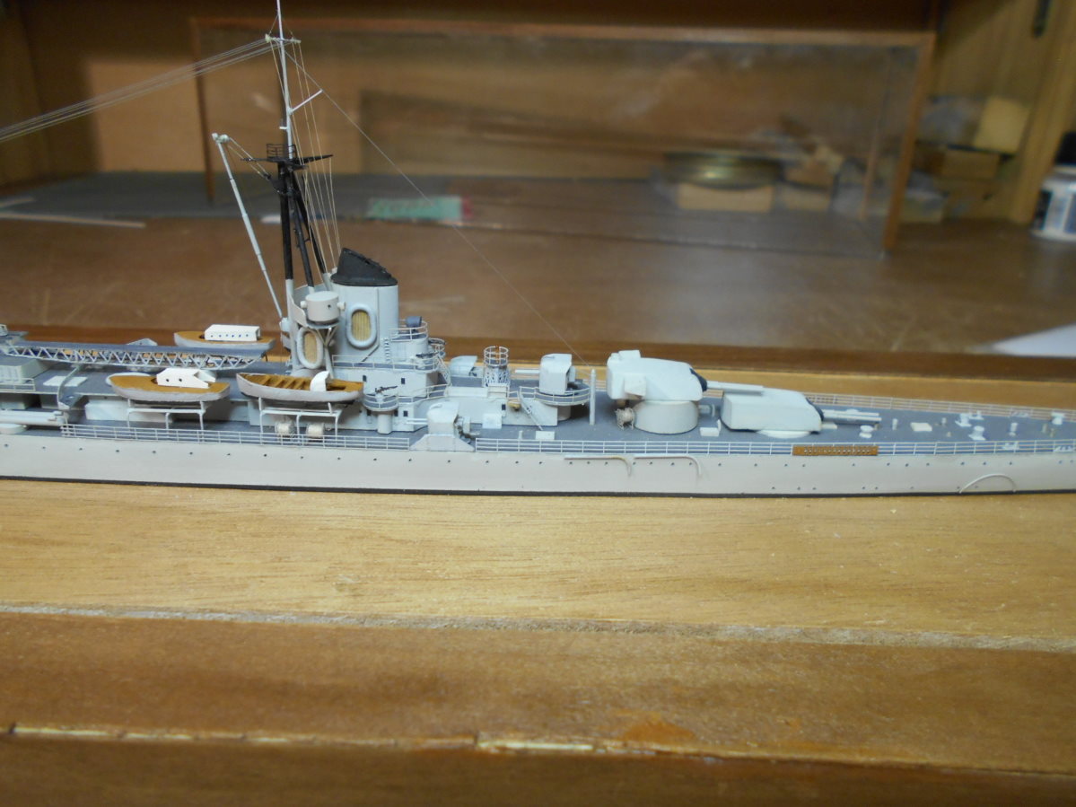

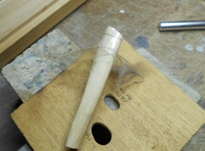

The tower is finished : wood turned on a lathe and photoetch

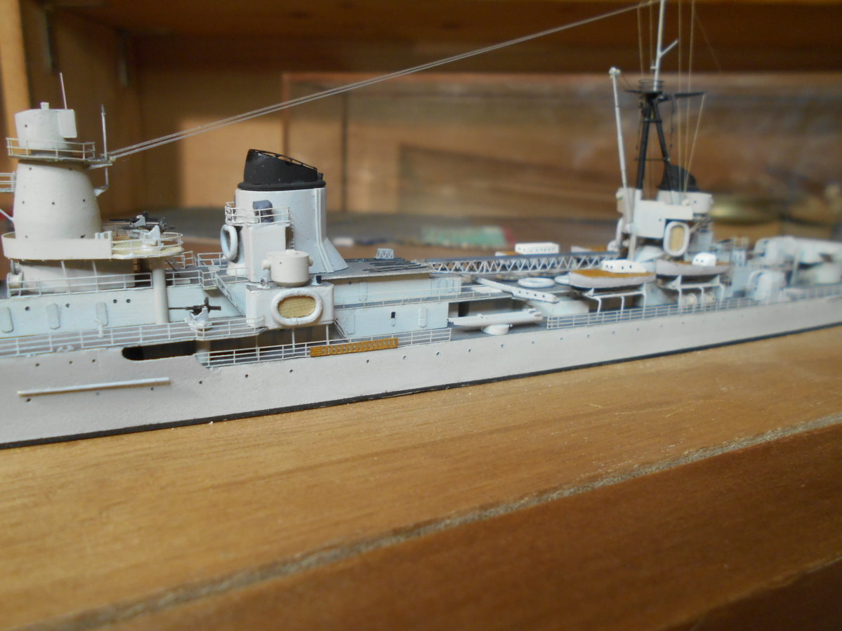

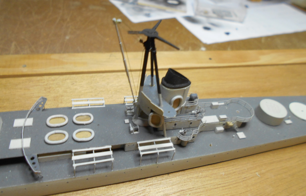

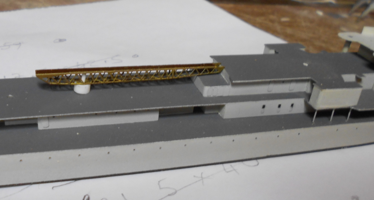

I made the catapult with photoetch.
The gratings are photoetch too, painted with Humbrol radome tan.

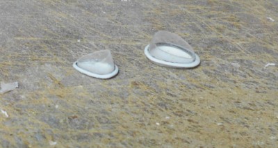

The funnel caps where vacuum formed

PostPosted: Sun Jan 19, 2020 11:52 am
Posts: 2432
Definately good looking. I'm also a fan of such "crude" ships, without all the clutter of AA and radars etc. Love the techniques you're using, did you make that PE yourself?
Vacuum form worked splendidly as well. You don't see it used so much, apart perhaps for lifeboats, but it worked for these funnel caps for sure! :heh:

Thank you Neptune !
yes I made my own photoetch .
I'll make the boats with vacuum forming, with this method you can make thin curved funnel caps. And you just need a hair dryer !

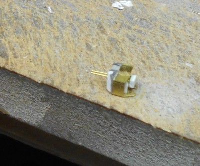

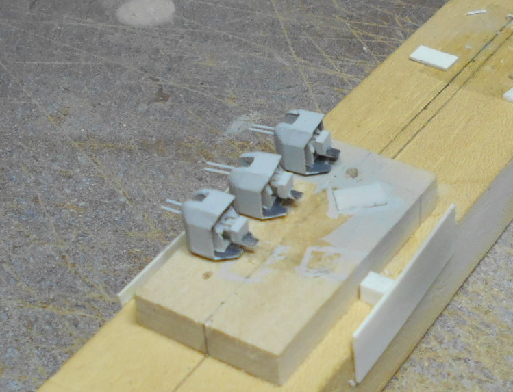

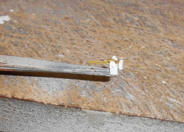

I've finished the 100mm guns (20 parts each) using custom photo etch, styrene and albion alloys tubes.
Finally, to raise my morale, I put on the ship all the parts aleady made.

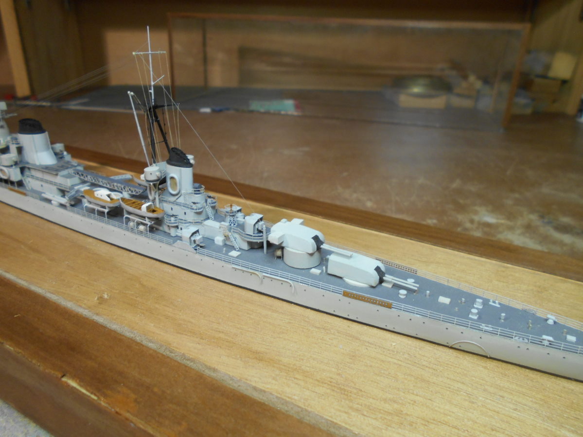

Finished at last
