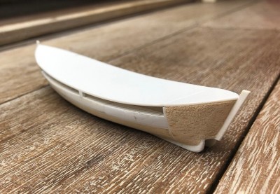

Just a little project to the side: building a master for a resin cast rescue boat of the 'Eierland' class.
Thirteen of these boats were built between 1922 and 1968 to serve the smaller coastal locations of the Dutch Rescue Service KNZHRM. Several of these were on the Frisian Isles including Ameland. On that station in particular they used horse traction until August 1979, when an accident caused the carriage to slip into an unknown pit, drawing the eight horses into their drowning. In 1994 the last of these boats was decommisioned, but all thirteen survive 'til the present day, even one staging the launch on summer days with horse traction for the tourists. (but of course with many precautions not such an accident to happen again!)
The boat itself was designed in Denmark by Orlogsværfted in Copenhagen, as a slightly smaller version of the Skagen motor rescue boat. The thirteen Dutch boats were built by Taat bros. in Katwijk. As the screw (propeller) is mounted in a tunnel, the centre keel from midship aft is replaced by two parallel timbers. This also causes a little challenge to be reproduced in scale, the problem is to retain structural rigidity during the build.
Here first two images of the first phase: after making the central keel member plate, I made the floor decking plus the side boxes. To this I will fit the temporary curved top deck, which will serve to get the hull topsides in exactly the right position. When these are firm the central part will be removed, only the fore and aft decking will remain.
Next I will start building the tunnel to the floor. When this is firm and rigidly attached to the aft part, the hull sides will be added in strips, showing the clinker build structure.
Note: this little boat ca 6 inches long will appear as kit, including the carriage trailer and a Caterpillar D4 tractor (which was the most common power source, besides the horses).

Almost that: balsa wood. Works like a charm, I have built masters for twenty years that way. I just started with the first pieces, I will post some photos tomorrow.

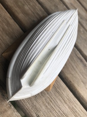

Yes indeed! These Eierland class boats had just such a 'screw-tunnel', constructed by two wooden timbers, partly instead of the central keel. These also served as the engine bearers. The predecessor of the Valentijn class boat you showed was the 'Ubbo' on the Egmond station, now in the Reddingsmuseum in Den Helder. https://commons.wikimedia.org/wiki/File:De_UBBO_in_het_Nationaal_Reddingmuseum_Dorus_Rijkers_(01).JPG
Below you see how I'm building the clinker hull, using strips cut from an Evergreen 'clapboard' sheet. The strips are 2mm wide, which is slightly too much so I file the surplus away before applying the next strip. The advantage is that the strips are bevelled already, as it is quite difficult to bevel straight plastic strips yourself. Note: I temporarily put a square rod 6.3 x 6.3 into the screw tunnel to keep it in shape while the glue is setting.

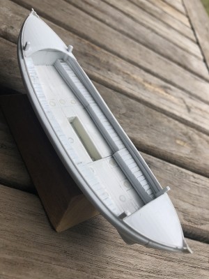

I further detailed the screw tunnel:
An then on to the inside: the bulkheads, the topside of the fore and aft peak, the mooring bitts.
