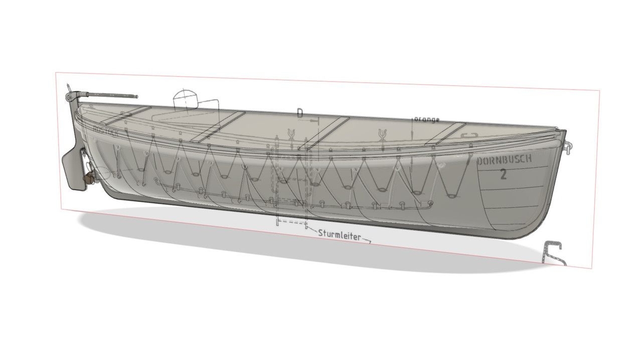

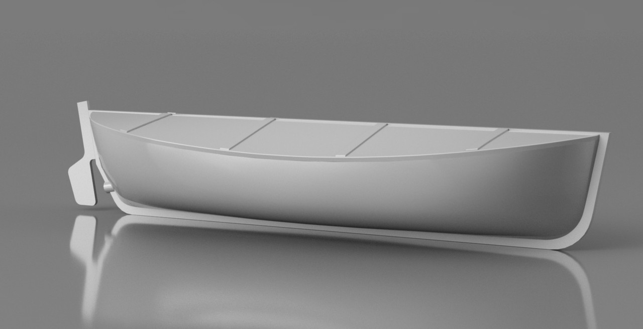

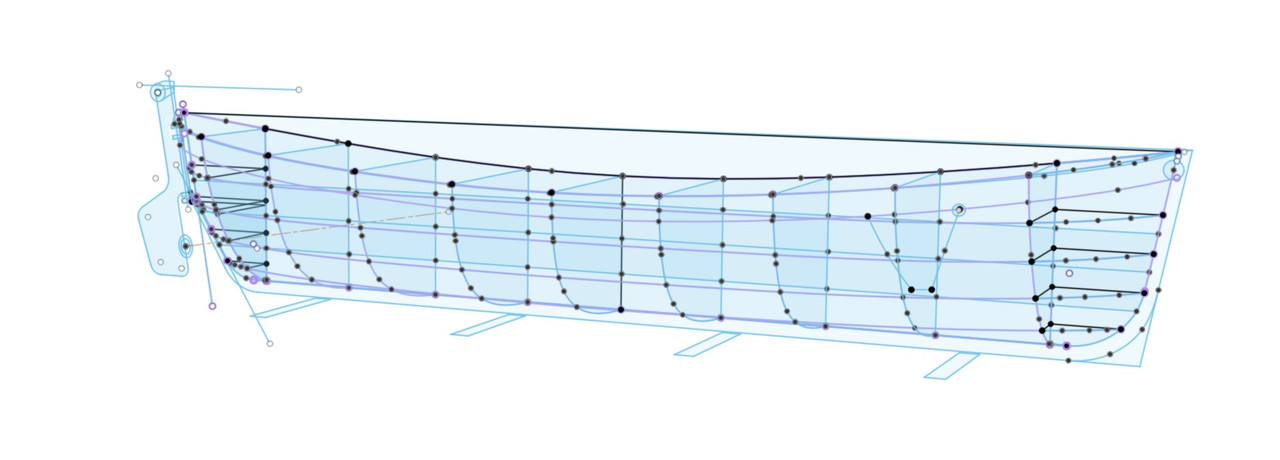

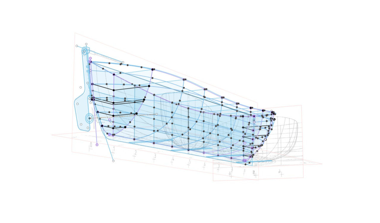

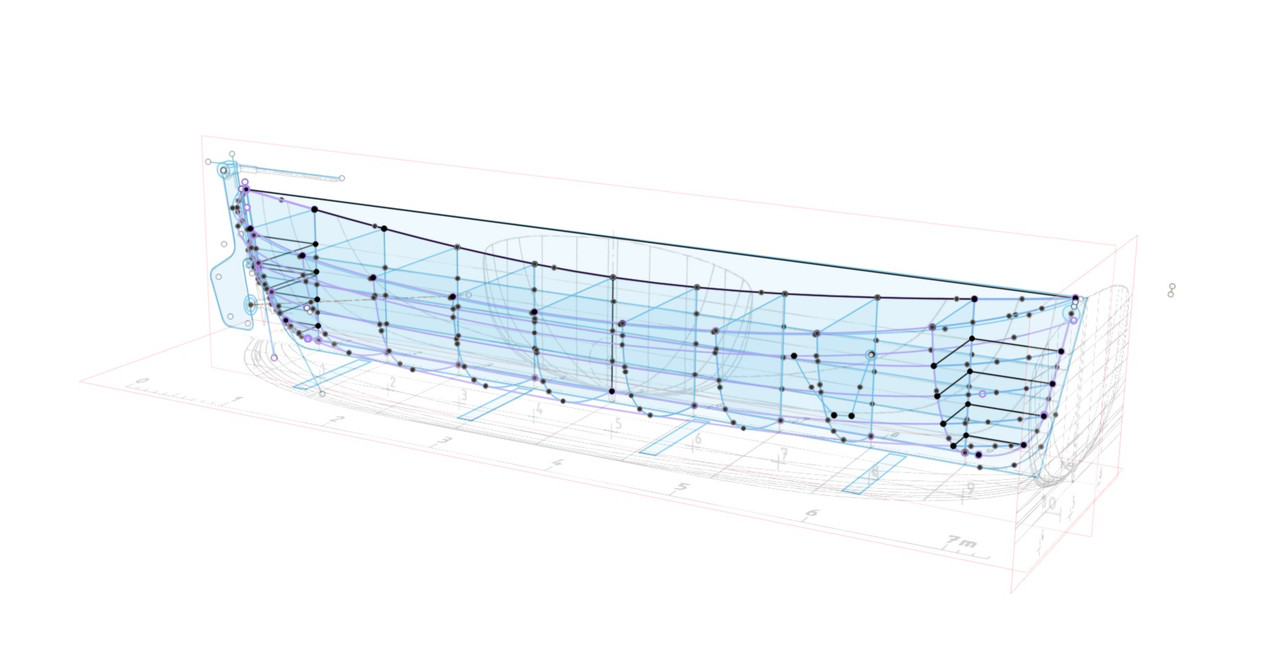

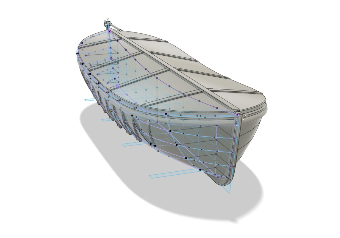

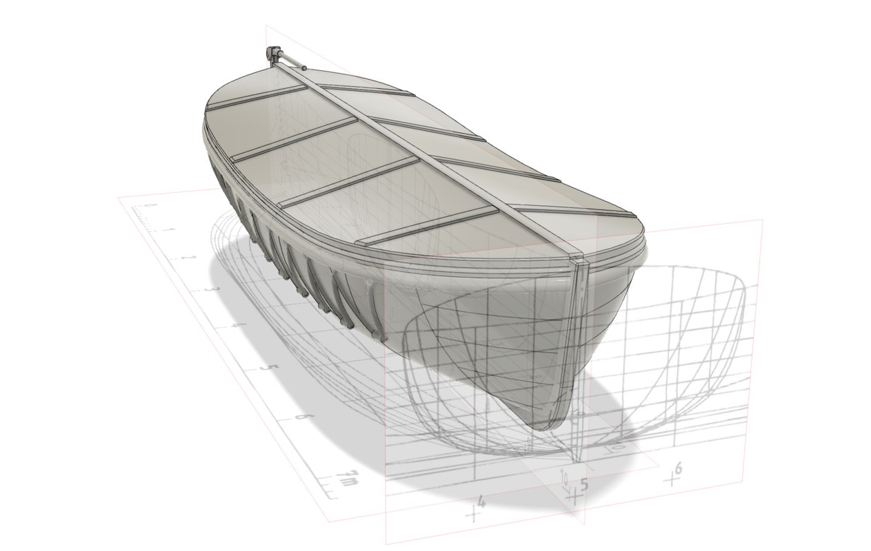

I started the design of this boat this morning for a friend, it will be finished probably tomorrow. Once printed it will be 60 mm long, but can be declined in different sizes.
Here is the model on the plan which is almost generic for the time.
The boat is covered here, not with a boat cover, but with removable sheet metal plates. The material is more durable and waterproof.
This is not the final model because there are still some details to be rectified and added, pulleys etc..

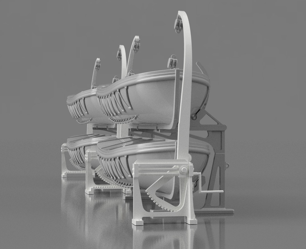

These boats are intended for the friend Jean-Louis mounted liner Pasteur (1938) to 1:125, these lifeboat are not commercially available at this scale. There are 30 such boats on this ship before its refit (Liner Bremen), of which 4 near the bridge are smaller Titanic style boats.
The davits for the bridge boats are of the well known Walin type, which were used on many ships in the early 20th century, notably the Olympic class.
A particularity of the Pasteur is the stacking of the boats in pairs.
So I had to find out how the upper boat was supported. I was missing pieces of the puzzle. Most of the pictures of the Pasteur liner that can be found on the internet are wide shots. No photos taken on board are available. So I called my friend Roland Grard who is the right man for the job when it comes to finding a drawing or a particular photo.
I found some HD pictures of the Pasteur, so I was able to zoom in on the part I was interested in, but only from the sea side. As the supports are on the opposite side, I had no idea of their shape and layout.

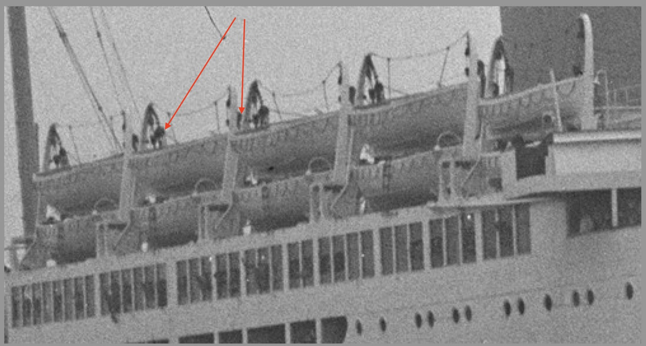

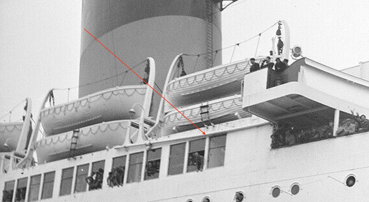

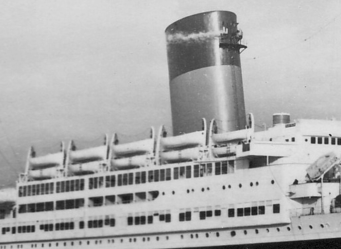

Some detail shots of the boats, this nice HD photo found on Flickr was quite useful too:
"The French steamship Pasteur, chartered by the Dutch government, with more than 4,000 repatriated soldiers from Jakarta and the surrounding area, is towed through the North Sea Canal by tugs from Reederij Gebr. Goedkoop, 24 February 1950."
Photo Ben van Meerendonk / AHF, IISH collection, Amsterdam
The HD version, downloadable below right:
https://www.flickr.com/photos/iisg/1001 ... xbq-wjU9bF
The red arrow indicates the spinnaker pole for the sounding machine, a system identical to the Olympic class.
The 2 Titanic style clinker lifeboats are clearly visible on the bow, probably 30 feet.

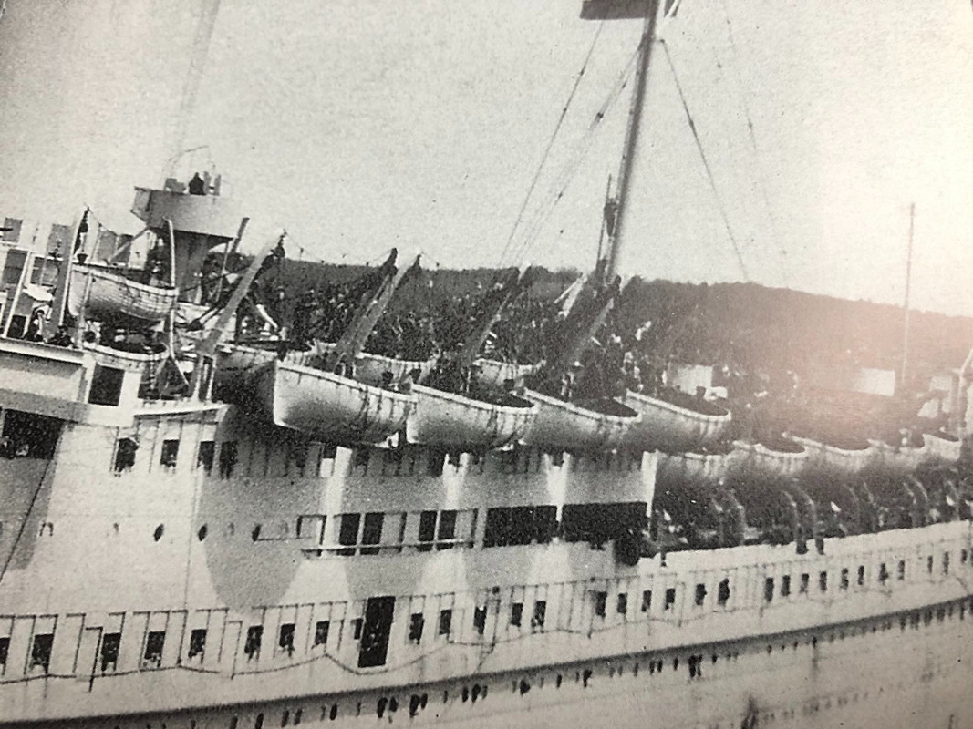

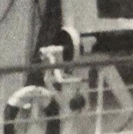

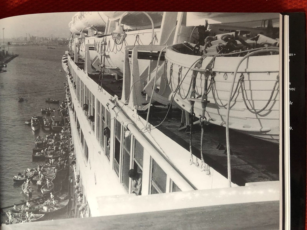

All these photos did not show me what I was looking for, Roland allowed me to visualize what I had to draw.
These snippets of photos are taken from this beautiful book "Le Pasteur 1938-1980" by Jean-Yves Brouard (French author) published in November 2005. I will surely buy it because this ship is very beautiful and historically interesting.
https://livre.fnac.com/a1763510/Jean-Yv ... -1938-1980
The last photo solves the problem. Thanks Roland, now I just have to draw it all.

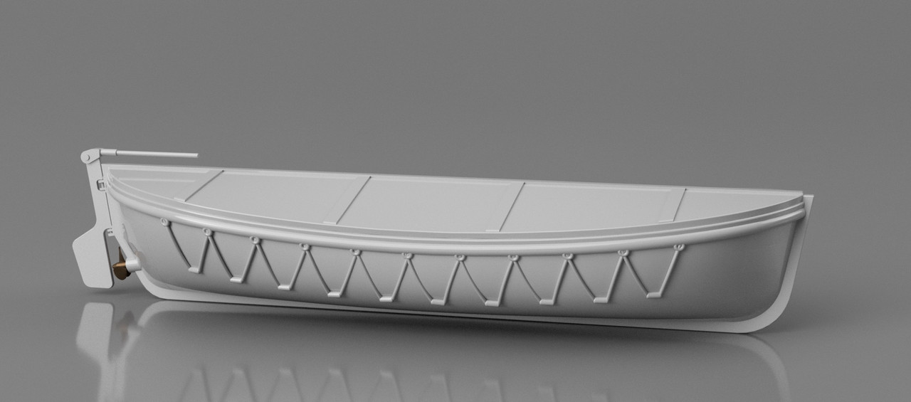

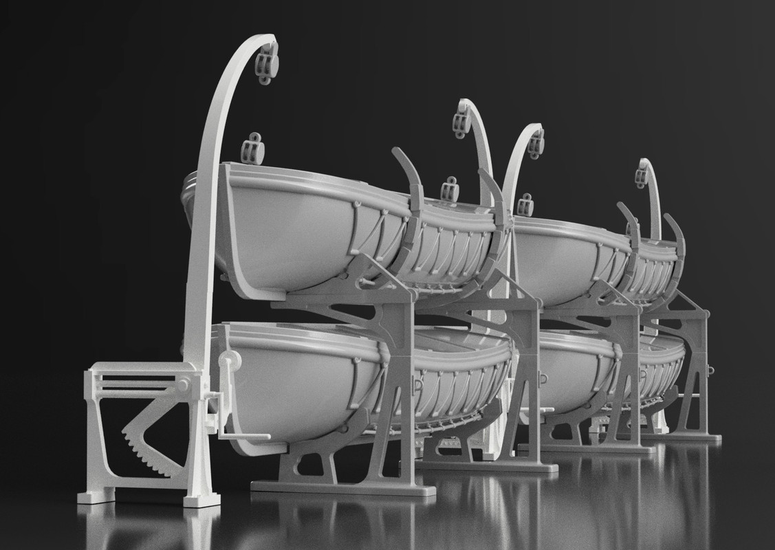

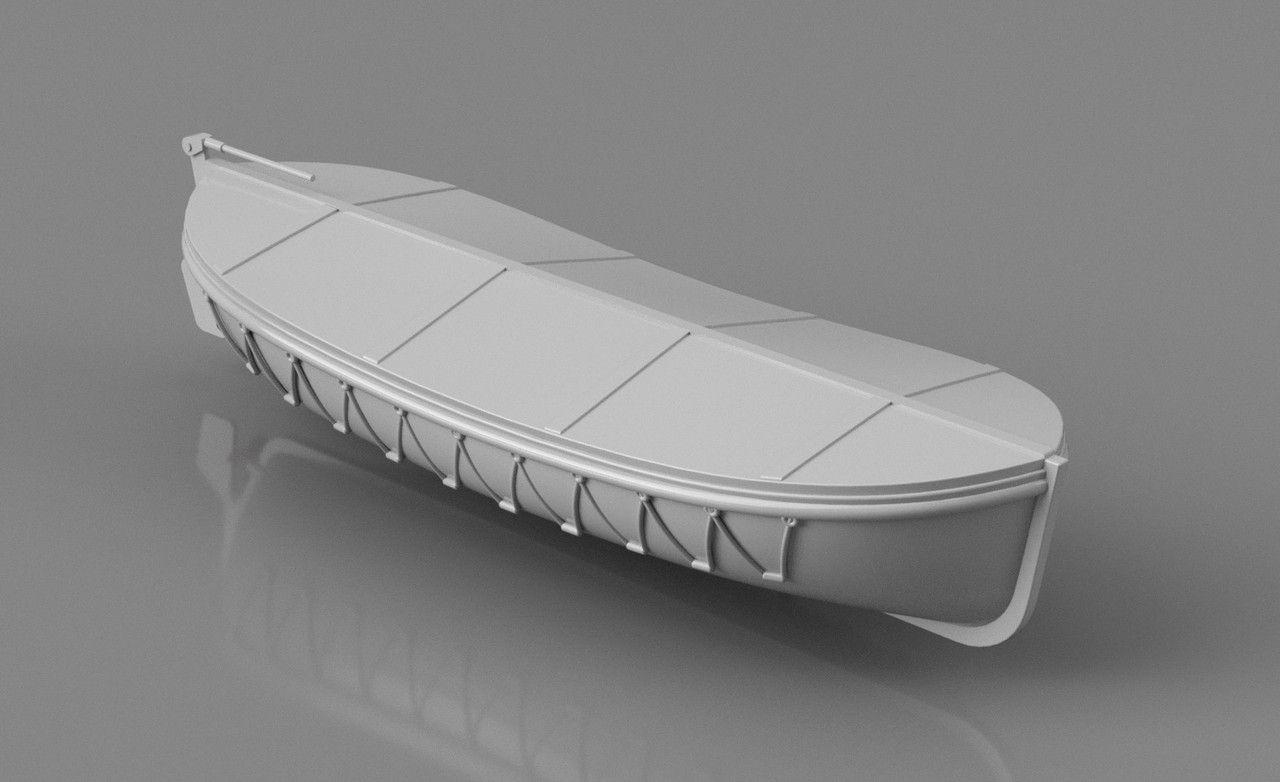

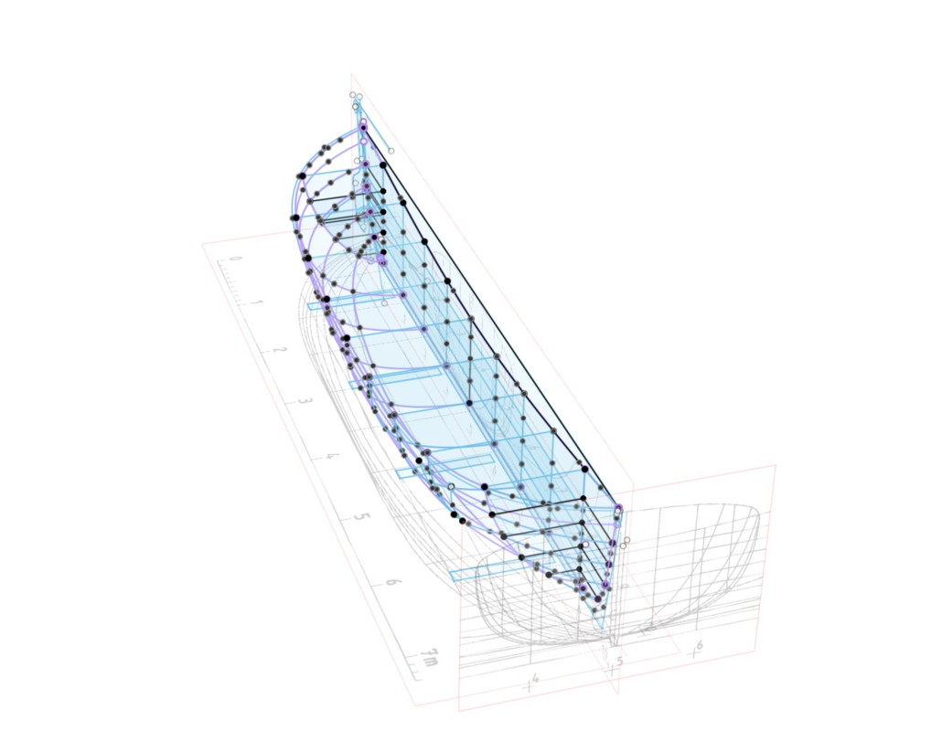

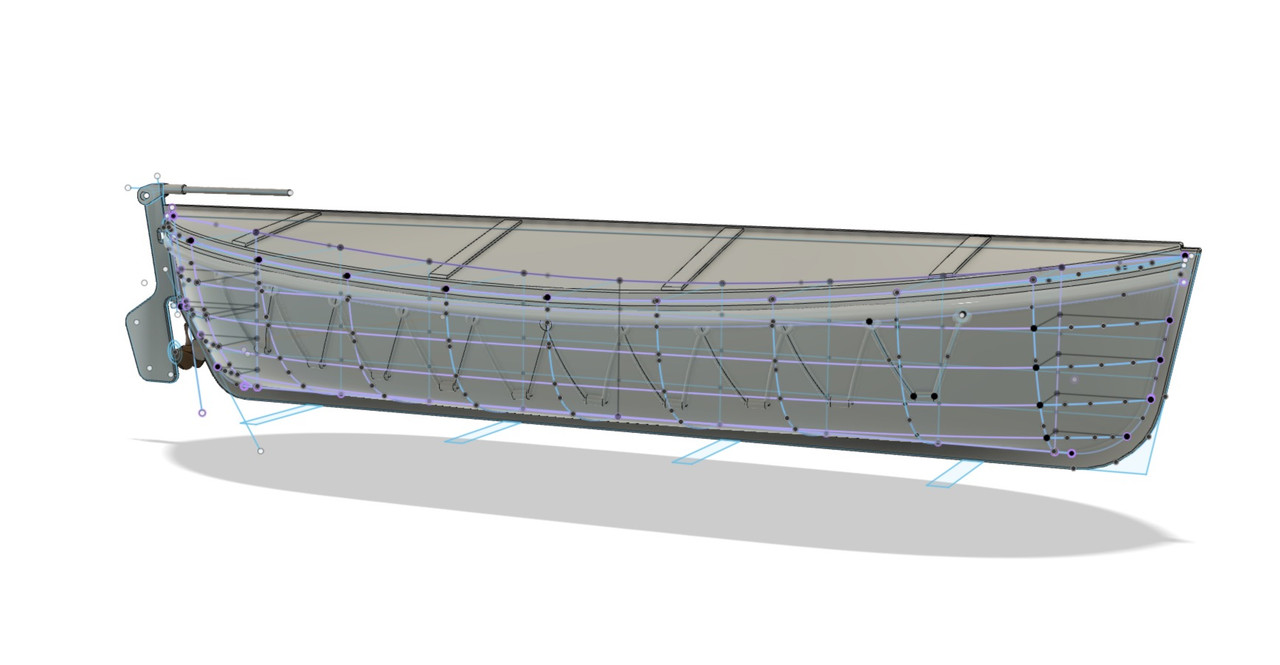

That's it, a few details to rectify.
I still have the small lifeboat models to adapt that I already have in stock, it will be quick.
I simplified some details in relation with the 1/125 scale and a sailing model.
The two kinds of horns are "off-shore derricks", a classic system on this type of lifeboat to prevent it from snagging when it is slumped along the hull (Wall), especially in the event of constant rolling or heeling of the ship which would force it along the hull during the descent, one can compare that to sledge blades.
They are released once the boat is in the water to avoid drag, especially if the oars are used to move away from the ship (engine failure).

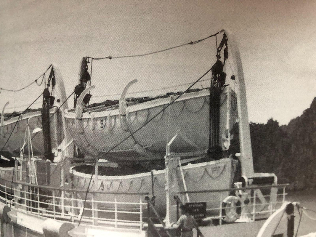

Looking at the photo above, a small detail amused me and made me think of my job as a former sailor where often common sense governs in order not to get hurt or stay alive, risk prevention is the key word.
If you magnify a little, you can see that the control cranks of the Welin davits are mounted upside down, and there is probably one main reason for this: to avoid catching the crank in your legs or pelvis when you are walking around, and secondly, although theoretically this is impossible with a worm, to avoid the davit deviating unexpectedly at sea, as the crank will get stuck in the davit support if it turns alone.
Caution should be exercised with davits, a device that has killed more sailors than it has saved.
Good bosun and good first mate!  :)
Pascal

That's it, details to check, massive (!) 3D printing to do, with a prototype first...
Pascal

Clever and interesting davit setup. Many wakeful nights of brainstorming activity by the design engineers. Do you have any idea how the upper cradles swing out of the way to release the lower boats. On the APA's the racks for the upper boats pivoted sideways.
PostPosted: Sat Dec 18, 2021 12:23 pm
Posts: 1888
Location: Bretagne, France
I think that the upper cradles stay in place or can be tilted 90° upwards. The photo is not precise enough to confirm the presence of a pivot.
Of course you can only launch one lifeboat at a time starting with the upper one, there are two sets of hoists. The davit has to be brought back to position for the lower one of course.
This is not very efficient in case of emergency.
Pascal

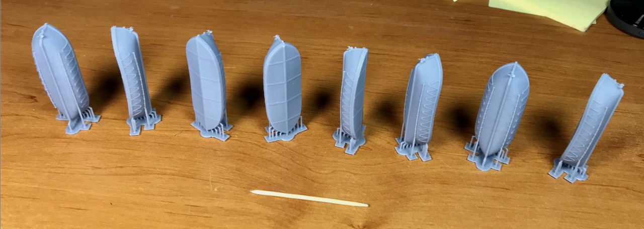

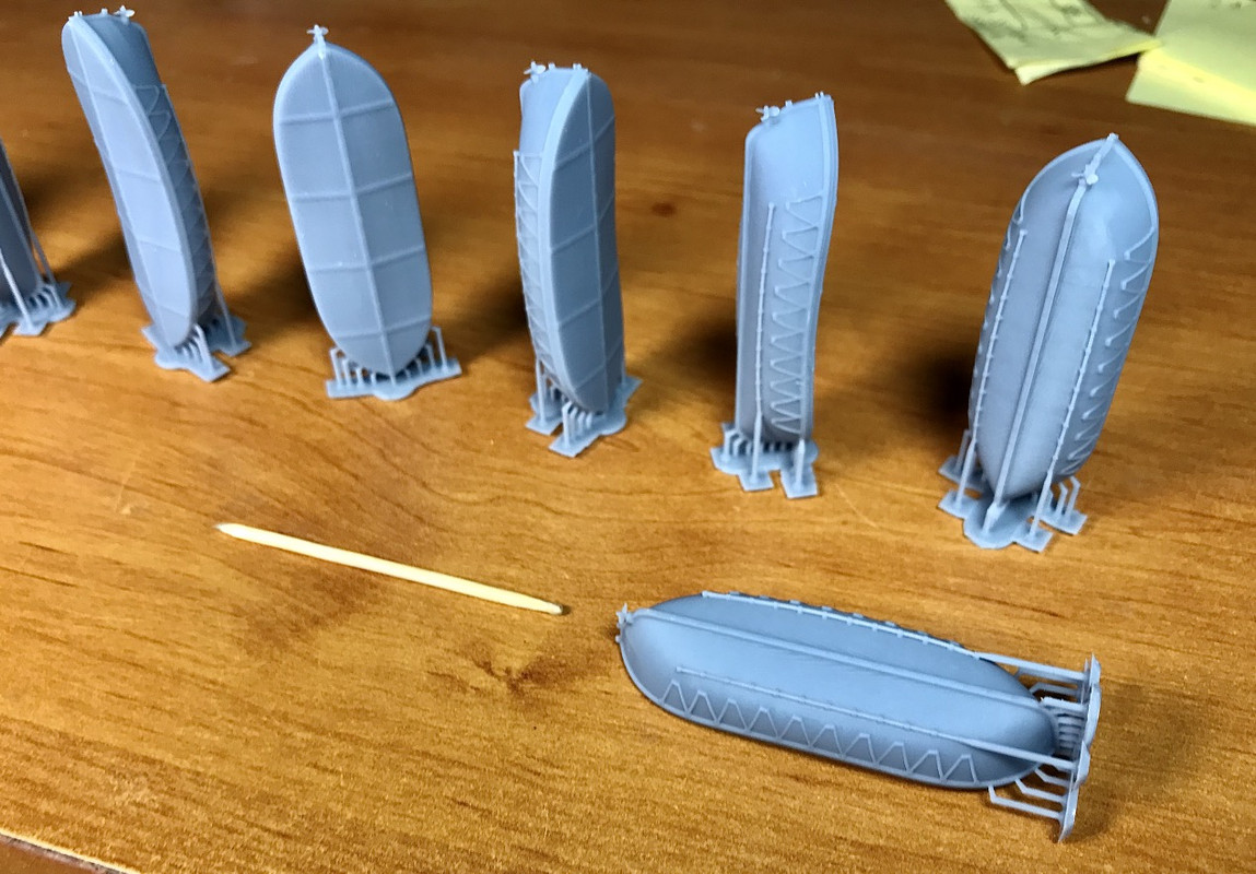

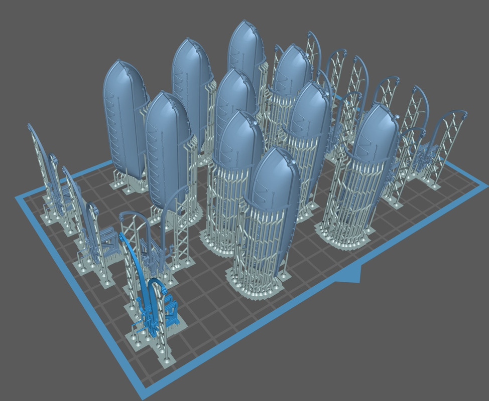

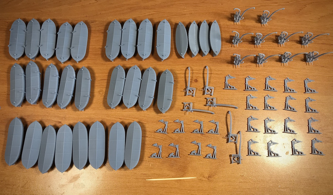

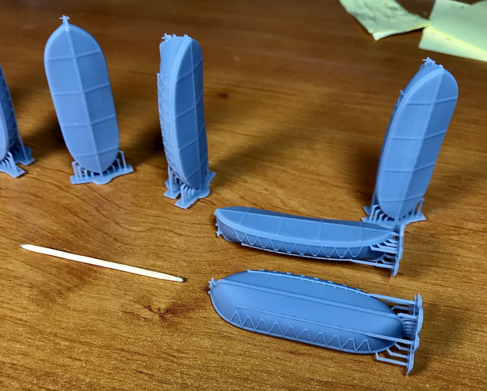

The print is of very good quality.
The vertical position that I now use systematically to print is a big help, of course you have to hollow out or squared off the inside of the hull to avoid too much tension on the thin supports. But it works.
A part of the 30 lifeboats to be printed. They are already printed in their entirety. It will take more than 2 hours to remove the supports from the boats and davits.
The 3D printing boards.
Pascal

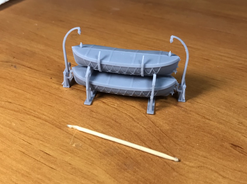

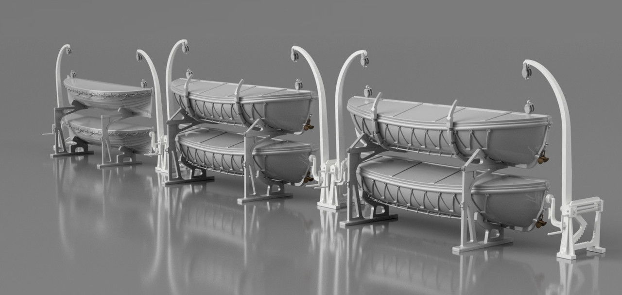

This set is finished. Quite happy with the result.
My friend will have little work to paint and assemble it all.
The drome of the liner Pasteur (1938) at lifeboat level:
Pascal
