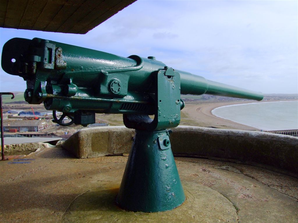

The 12-pounder QF 12 cwt naval gun is a 3-inch (76 mm) multi-purpose gun built by the British from the 1890s.
Designed to equip the Royal Navy's "27-knot" destroyers, it also equipped several armed trawlers and served as coastal artillery.
It was then purchased and produced under the name of 76.2 mm/40 Type 41 gun by Japan, which made it the standard secondary armament of its ships between 1890 and 1920. Italy bought and produced them under license by Ansaldo; they were used for anti-aircraft defence during the Second World War.
http://www.navweaps.com/Weapons/WNBR_3-40_mk1.php

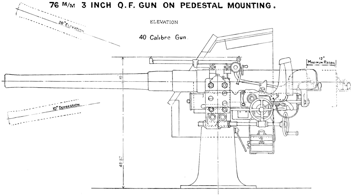

QF 12 pounder 12 cwt naval gun (serial #11107), CPP 1943. The QF 12 pounder 12 cwt was a 3-inch (76 mm) multipurpose naval gun introduced in 1894 and used until the mid-20th century. It was produced by Armstrong Whitworth, Elswick in England for use on warships, and exported to Allied countries.
In British service, "12 pounder" was a round reference to the weight of the projectile and "12 cwt" referred to the weight of the gun and breech: 12 quintals = 12 X 112 pounds = 1,344 pounds, to differentiate it from other 12 pound guns.

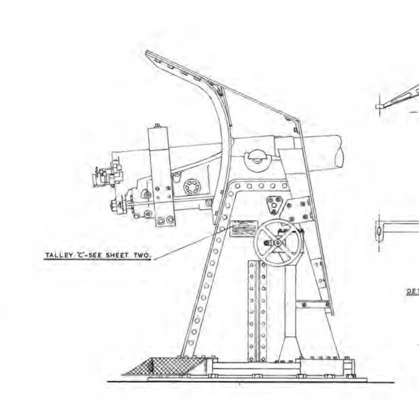

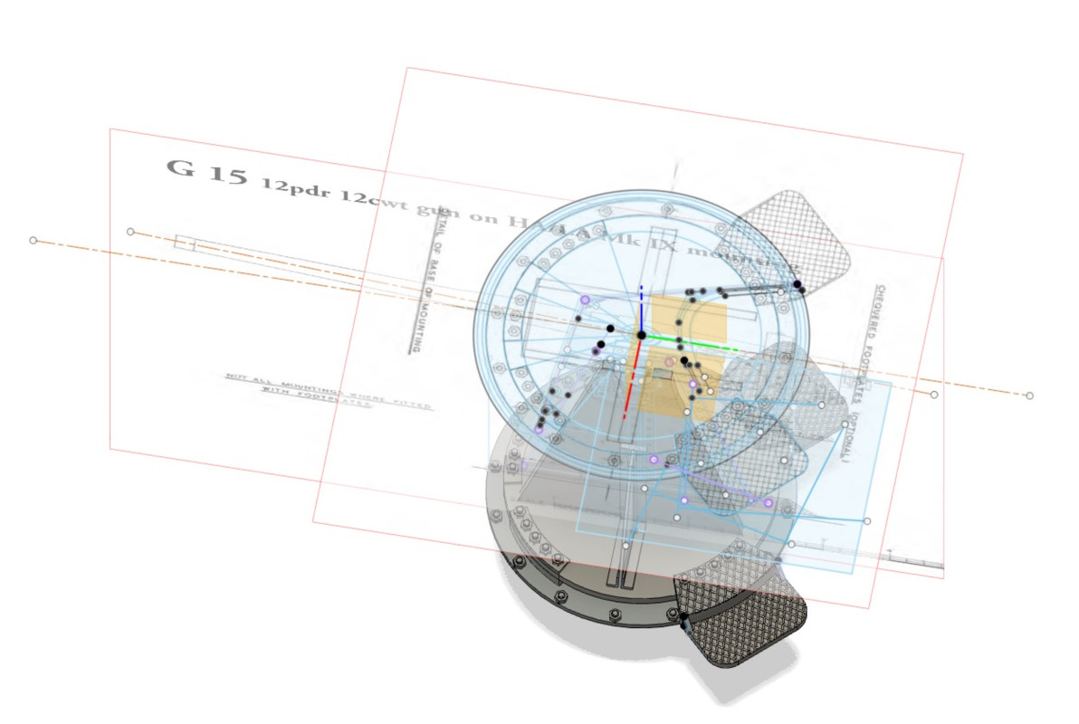

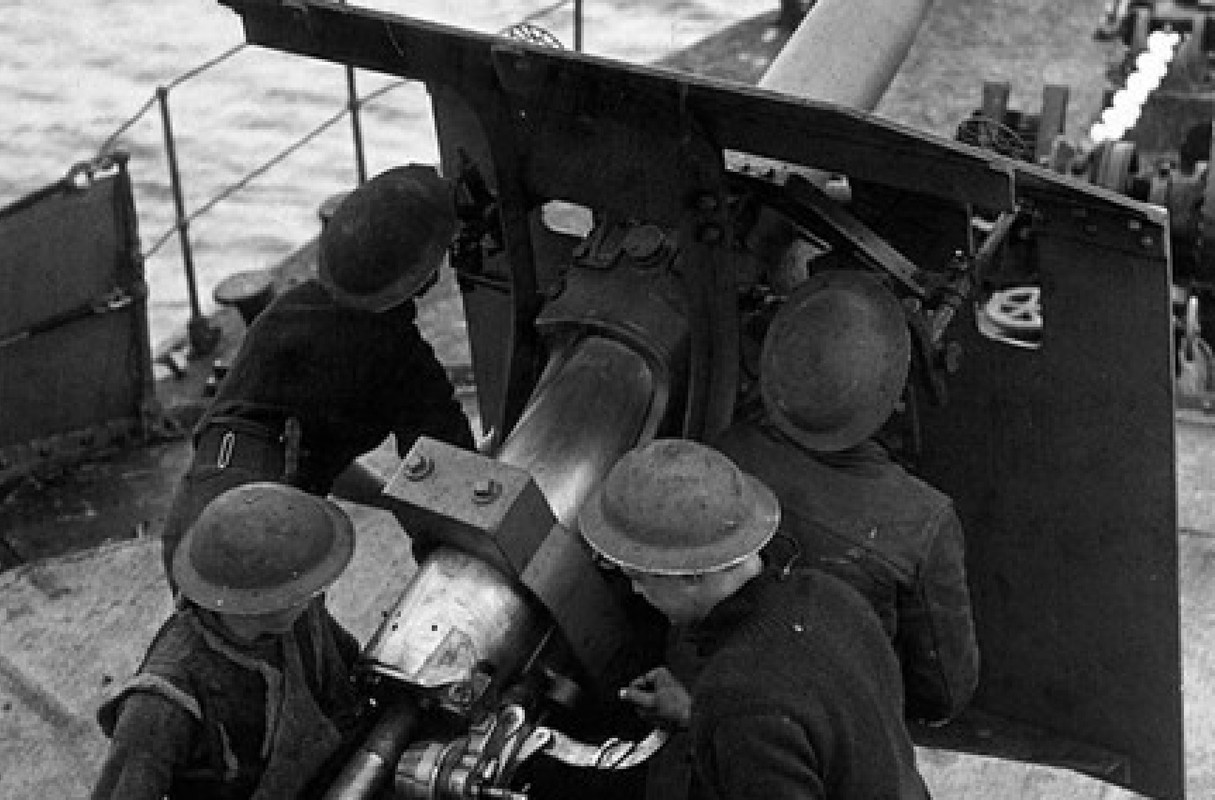

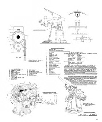

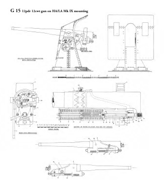

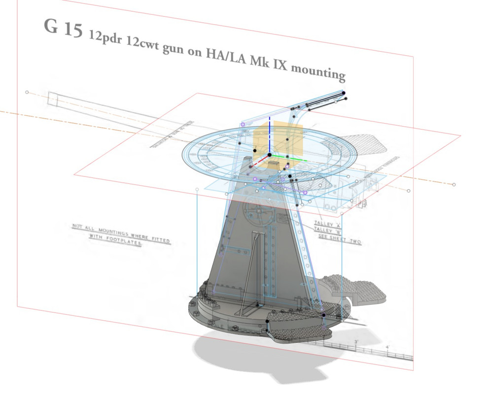

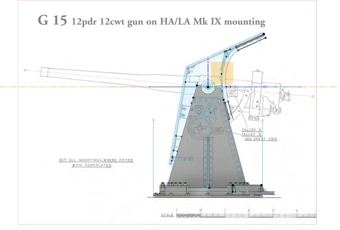

I have done some research and found my match.

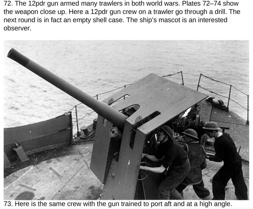

This book from the John Lambert collection ( the same as for the armed trawlers) contains all the necessary information and drawings.
I also made a harvest of other photos always useful for the 3D drawing:
Pascal

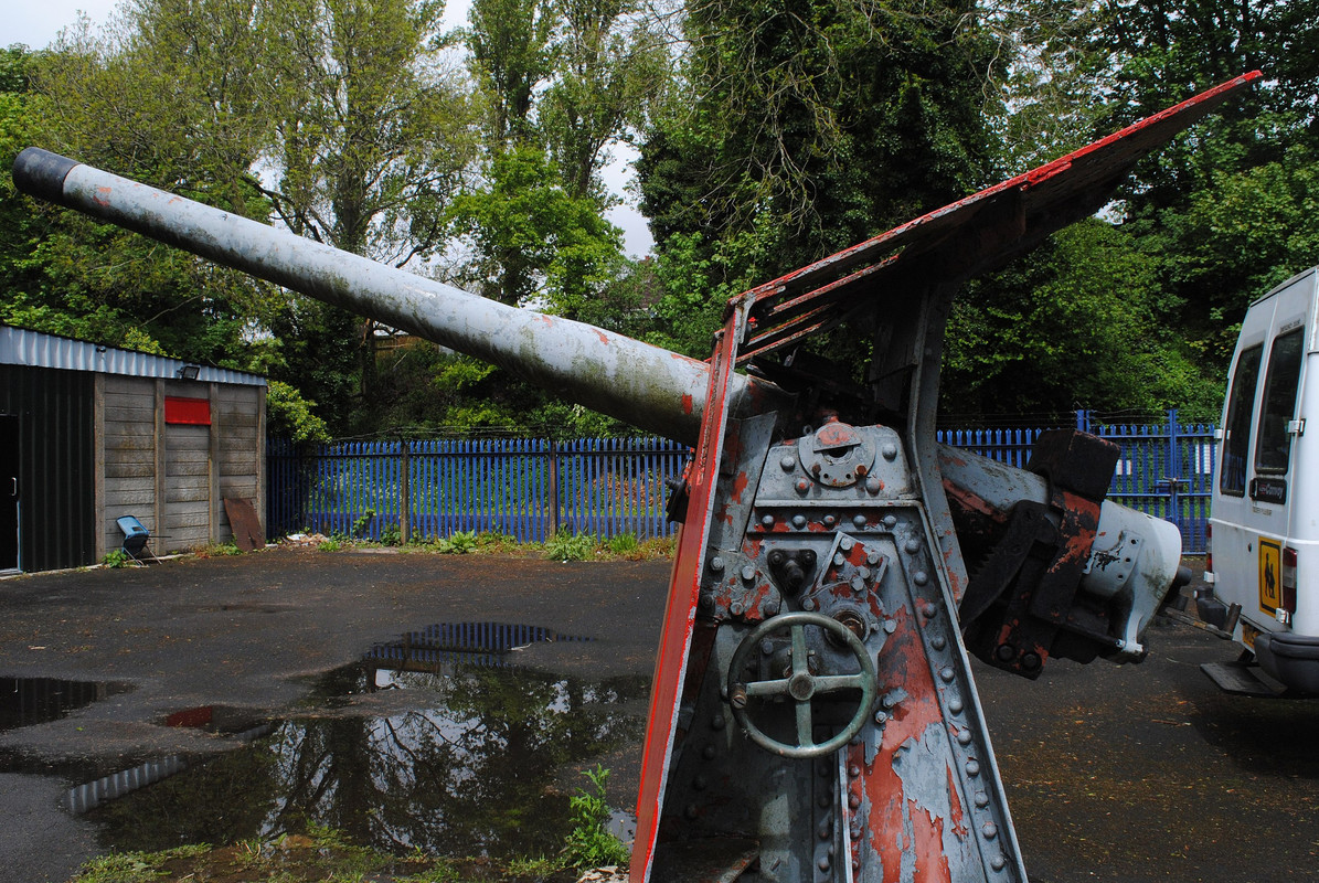

PostPosted: Thu Feb 17, 2022 5:15 pm
Posts: 1885
Location: Bretagne, France

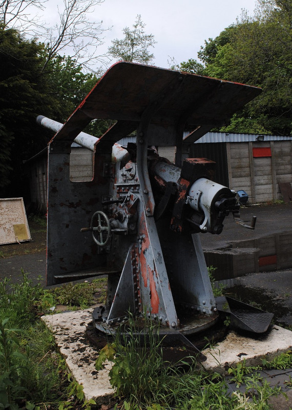

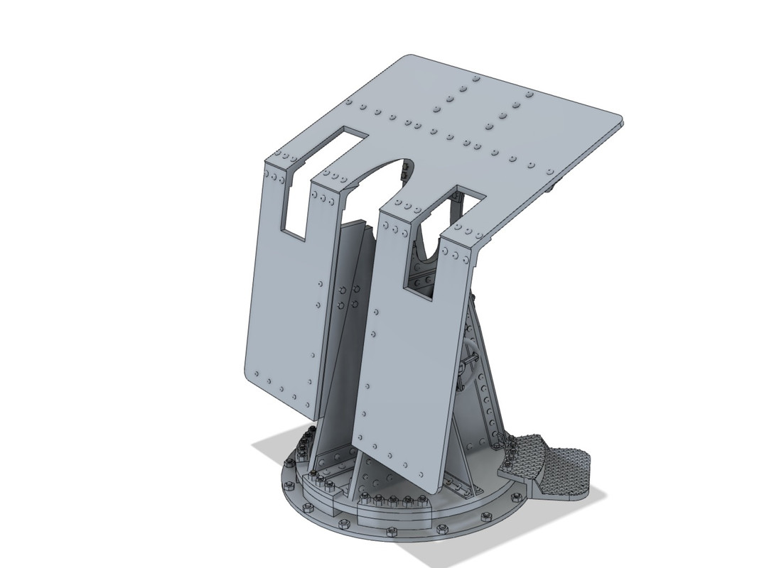

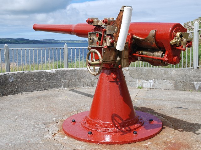

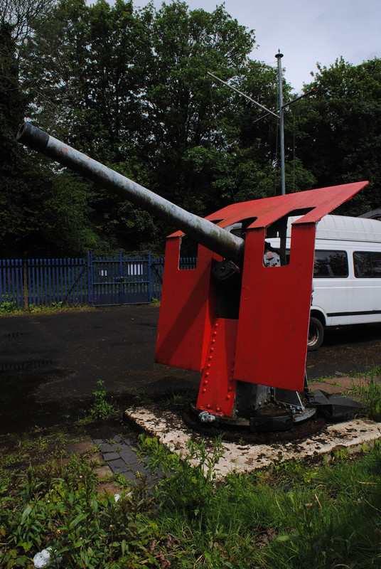

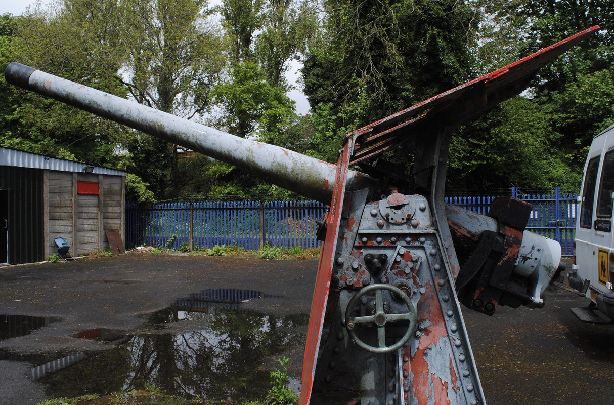

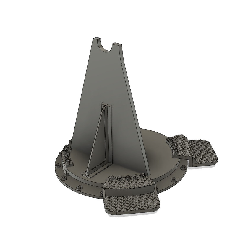

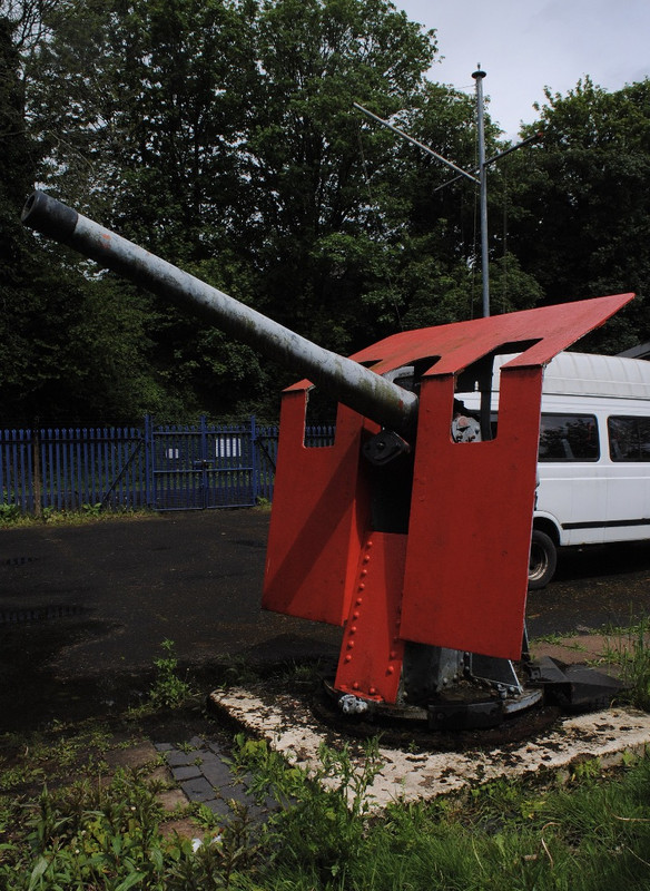

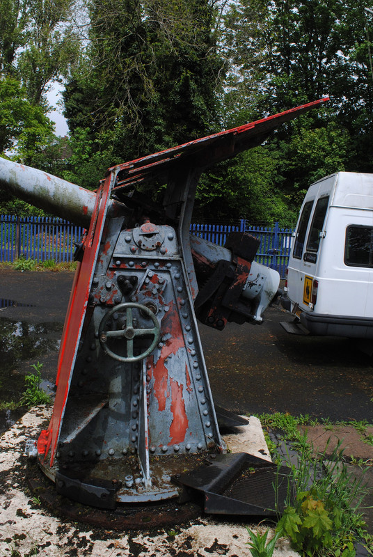

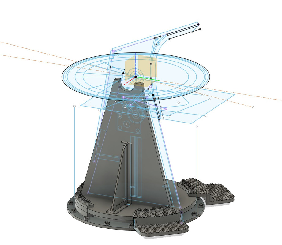

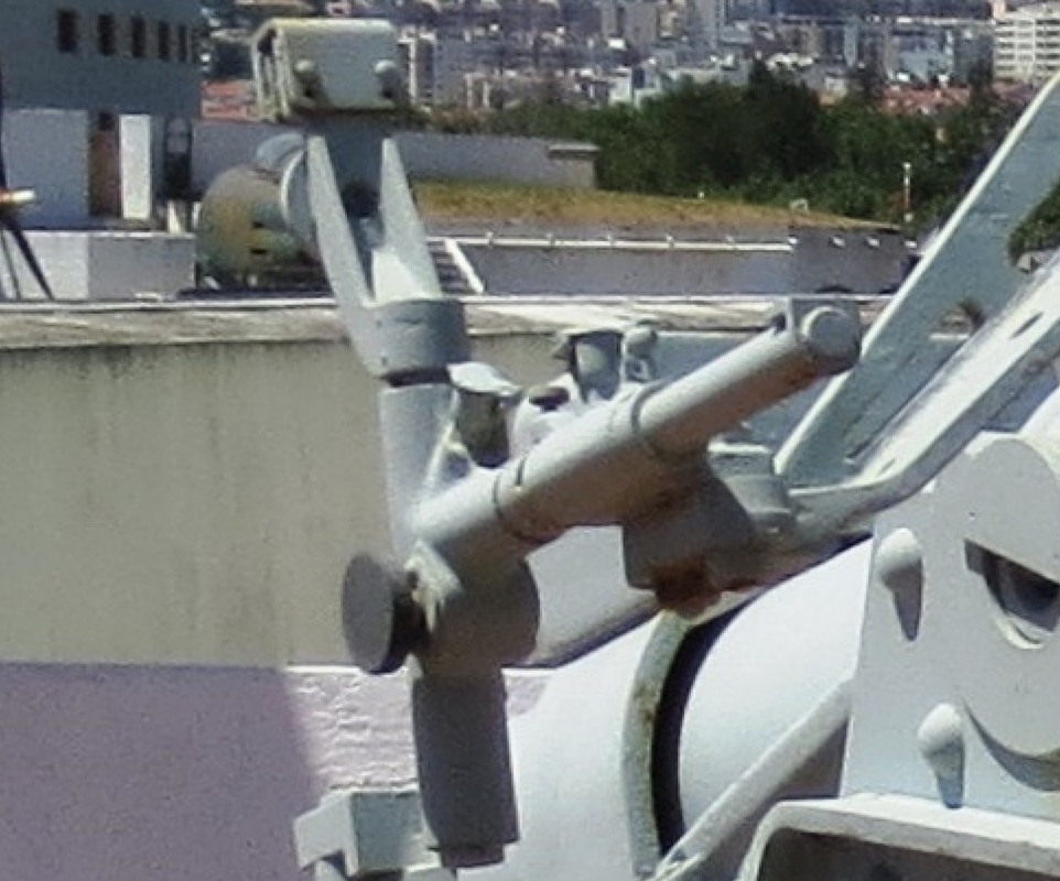

Advances of the day on the 76mm 3 inch or 12 pounder gun with the "World War II" pedestal.
These 4 HD photos of ©️Andy Mabbett taken in Birmingham, UK, in a garden ( Communal? )... help me a lot.
Pascal

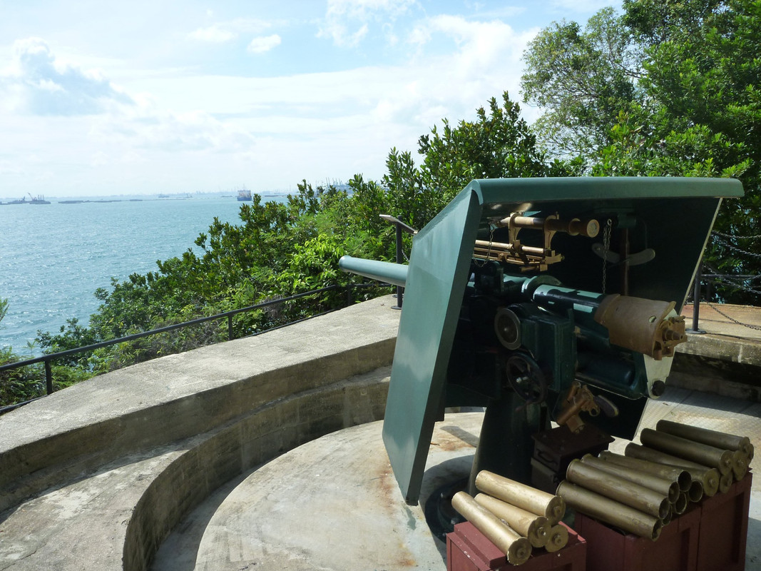

There is one of those in Hong Kong at the base of the Kowloon Peninsula, not far from Star Ferry, at the government buildings where the Typhoon warnings were hoisted from a mast.

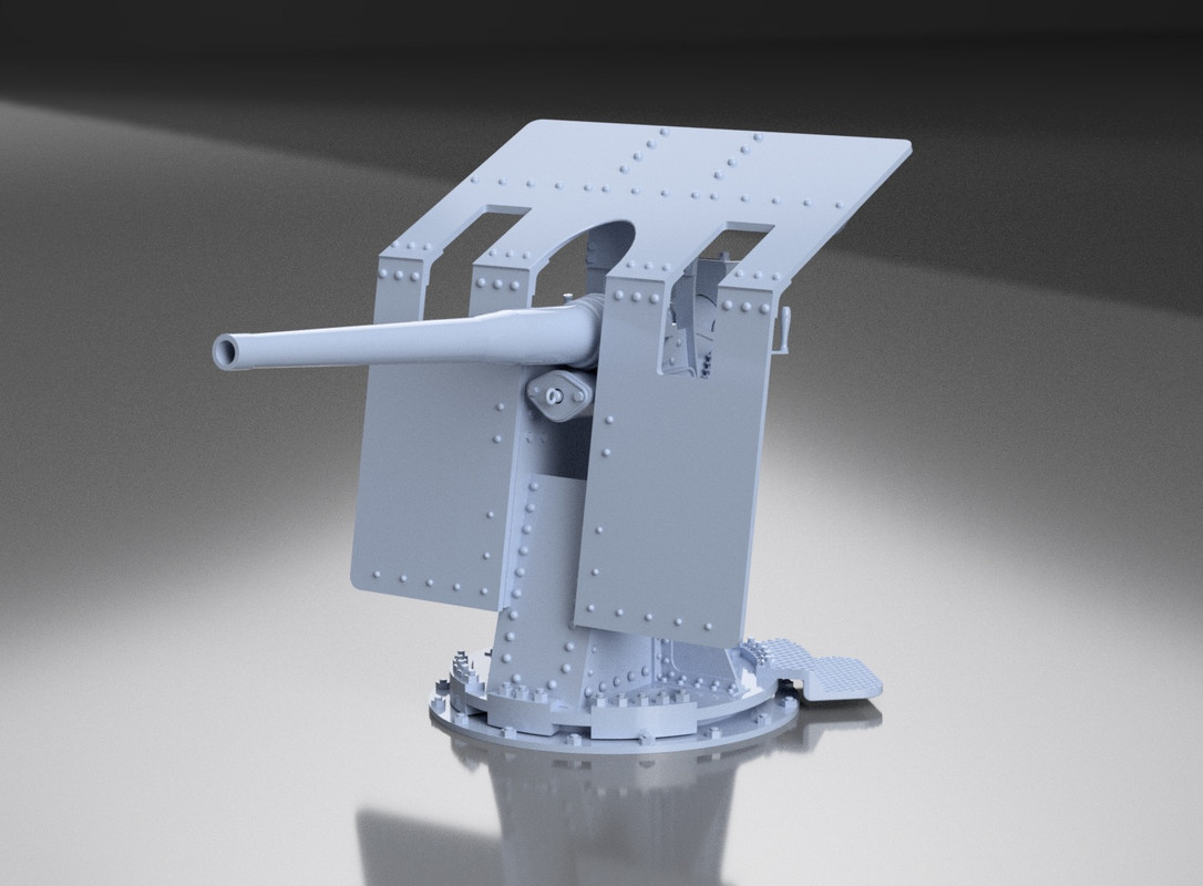

Definite advances on this more complex than it looks cannon pedestal.
Pascal

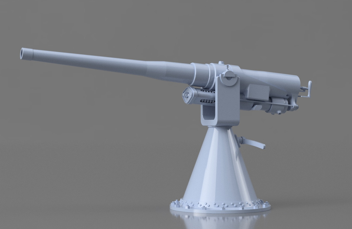

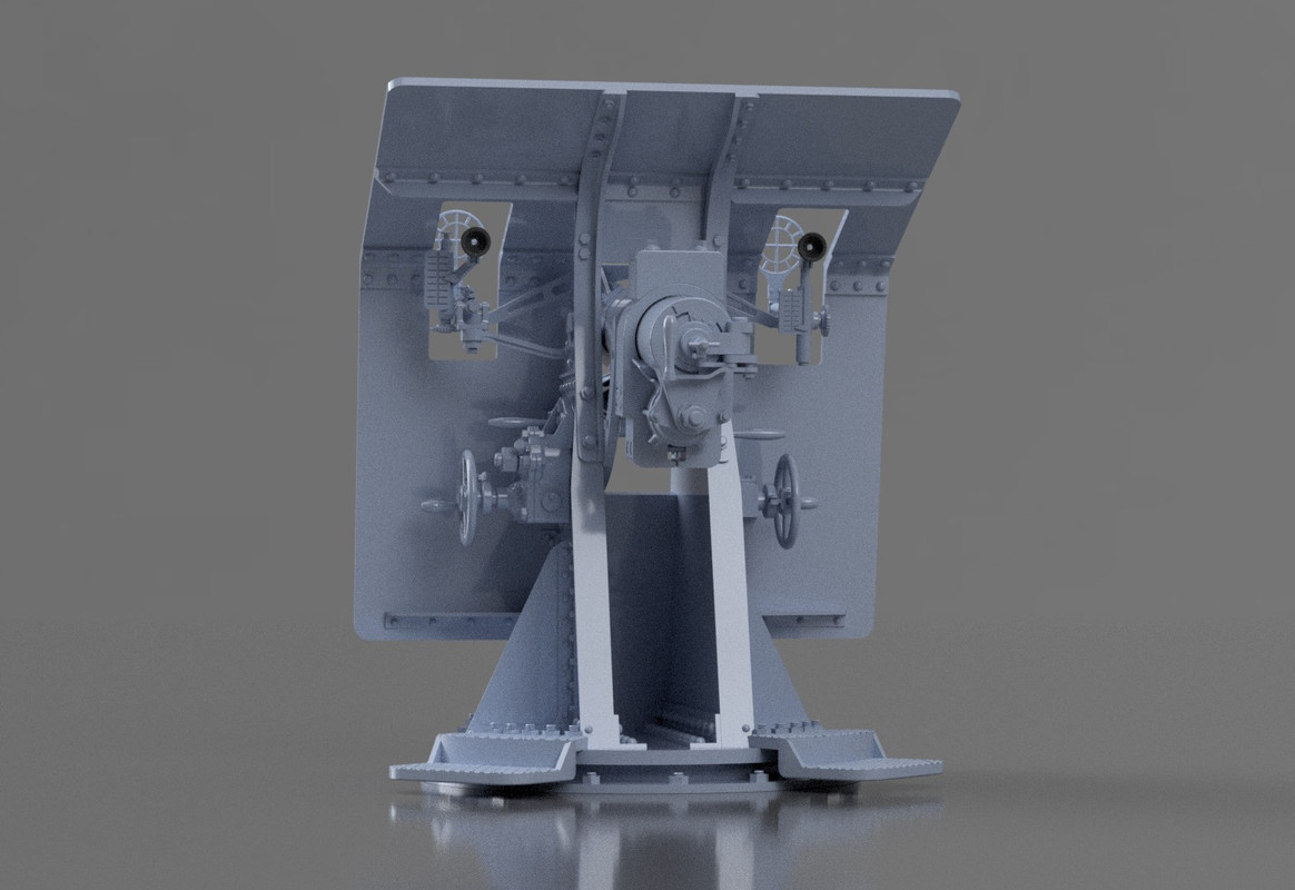

PostPosted: Sun Feb 20, 2022 1:12 pm
Posts: 1885

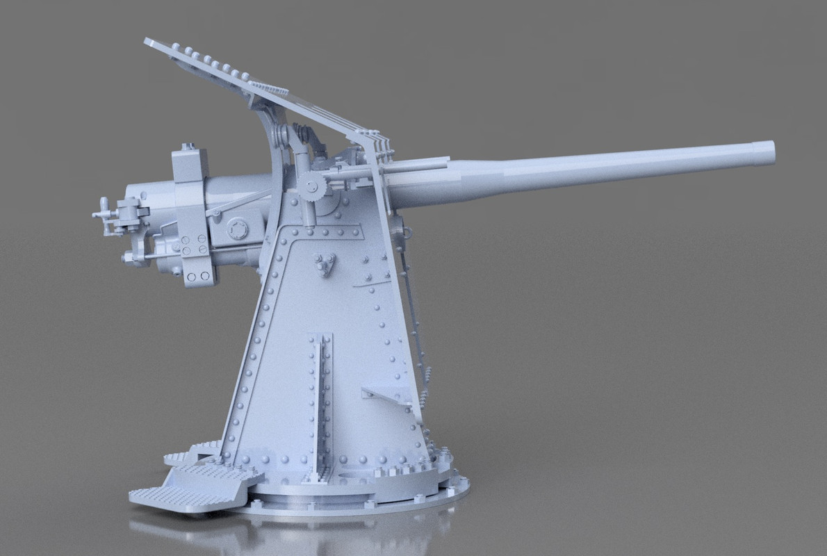

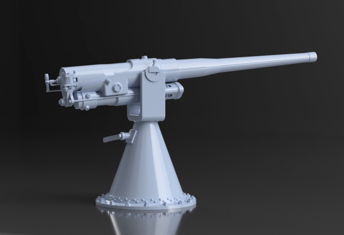

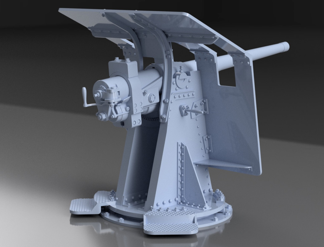

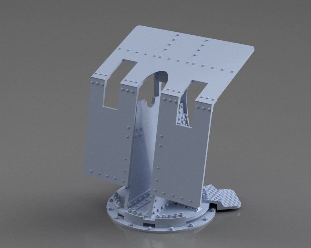

This gun is not far from being finished. There are still some small flaws to remove, the sighting system and finish the breech.
There are a number of breech variants, with more or less safety.
Then I would switch to the WW1 version. More simple.
Pascal

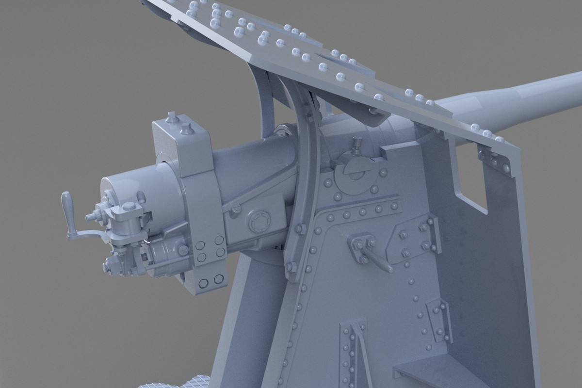

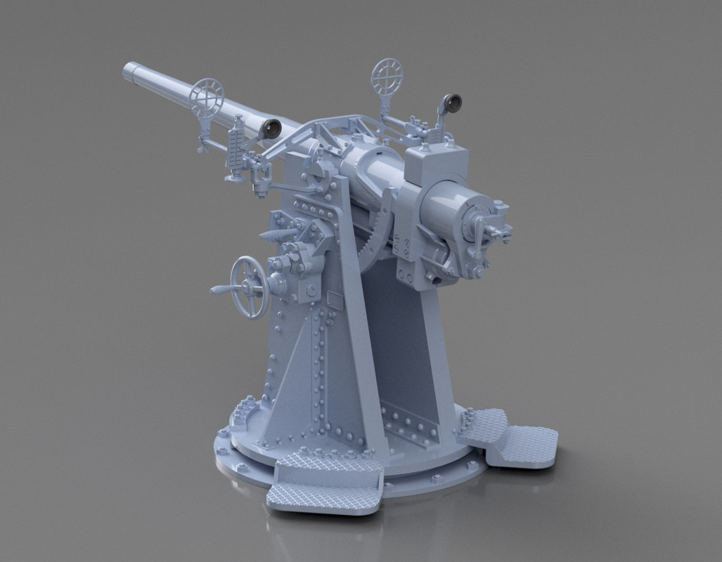

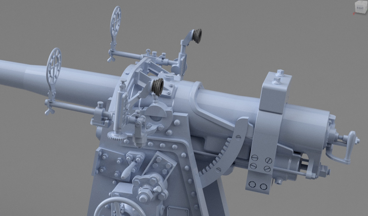

Start drawing the sighting system, finished the breech. Added small details.
Pascal

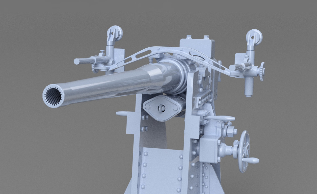

PostPosted: Tue Feb 22, 2022 4:38 pm
Posts: 1885

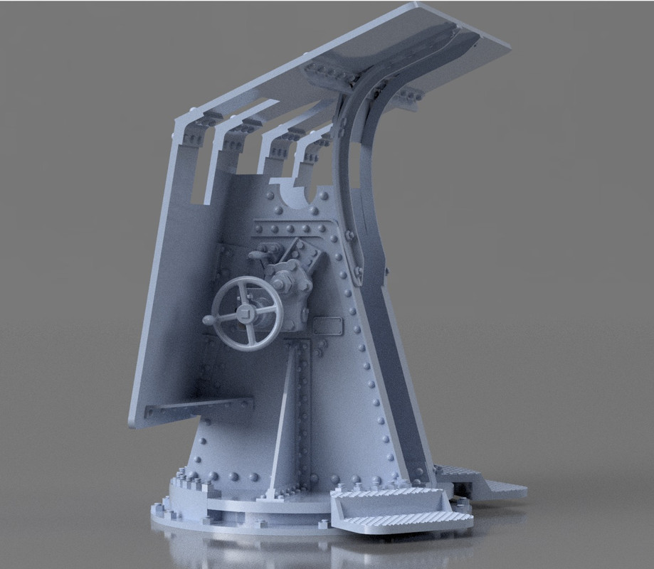

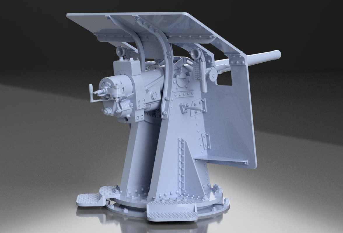

Drawing of the second sighting system which is different from the one on the right and the handwheel actuator which allows to turn the whole gun.
Pascal

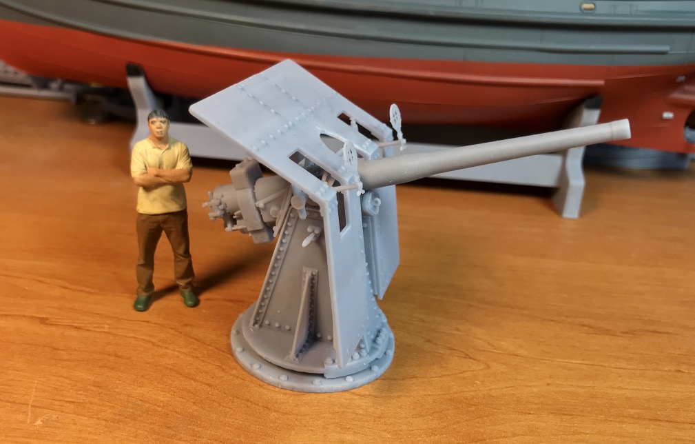

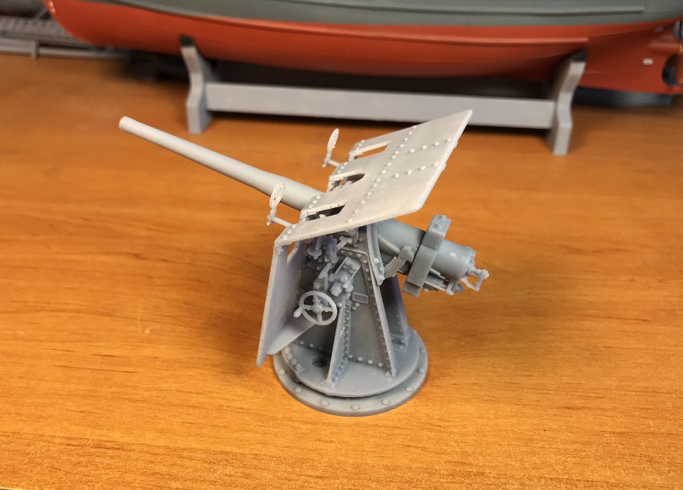

PostPosted: Fri Feb 25, 2022 9:30 am
Posts: 1885

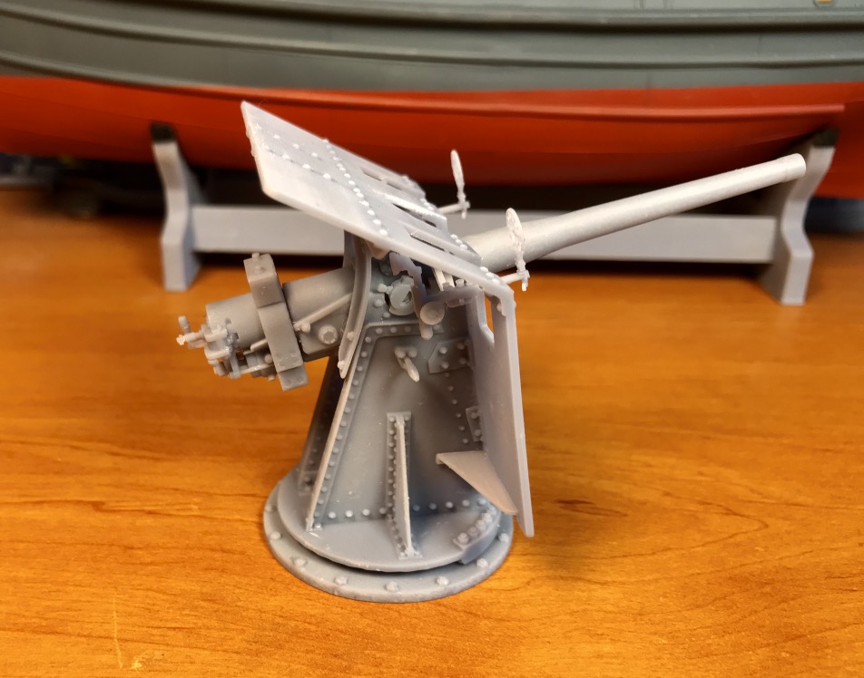

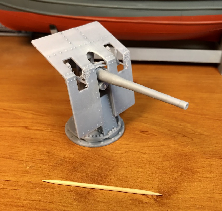

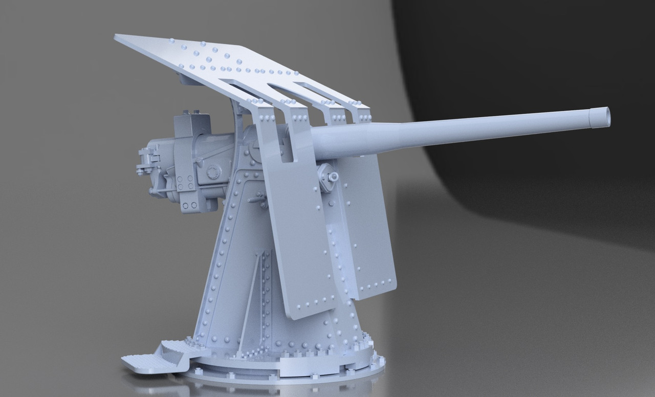

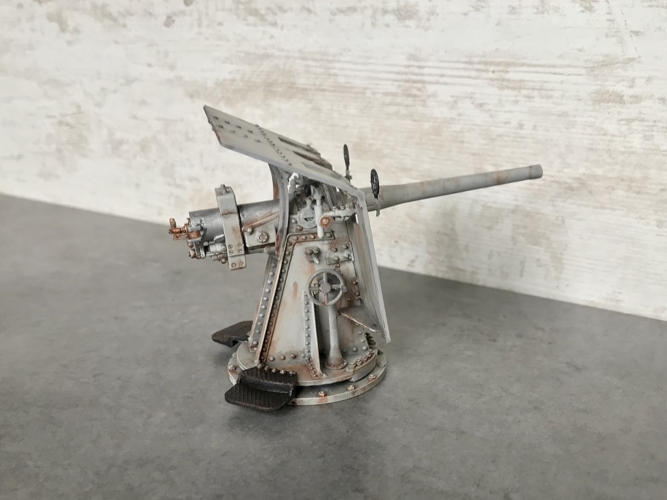

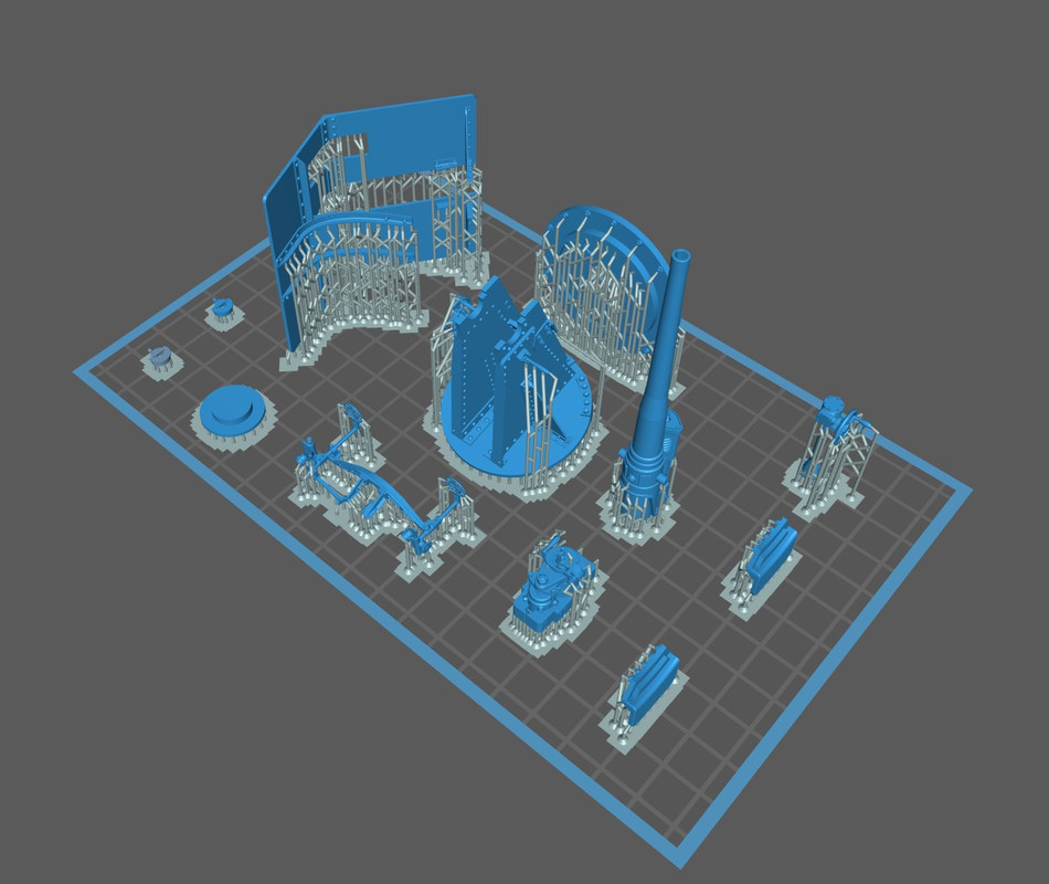

This gun has printed well. It is in 12 pieces.
Pascal

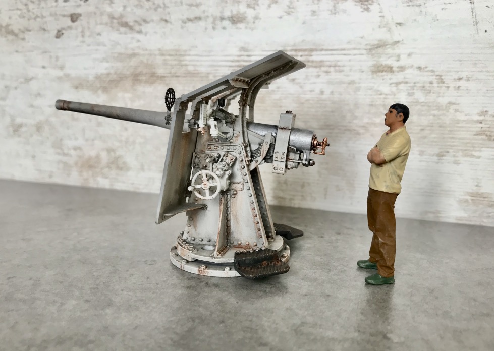

PostPosted: Sun Feb 27, 2022 6:01 pm
Posts: 1885
:thumbs_up_1:

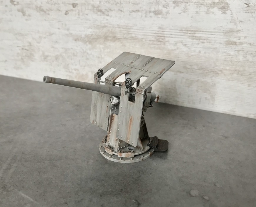

Paint and patina pronounced
Tamiya's Lacquer Paint is great to apply and the result is remarkably uniform, more robust. Nothing to do with acrylic. It covers very well. I never used this type of paint before.
Pascal

I have started drawing the WWI version.
No plan for this version, some pictures will help me, including this one:

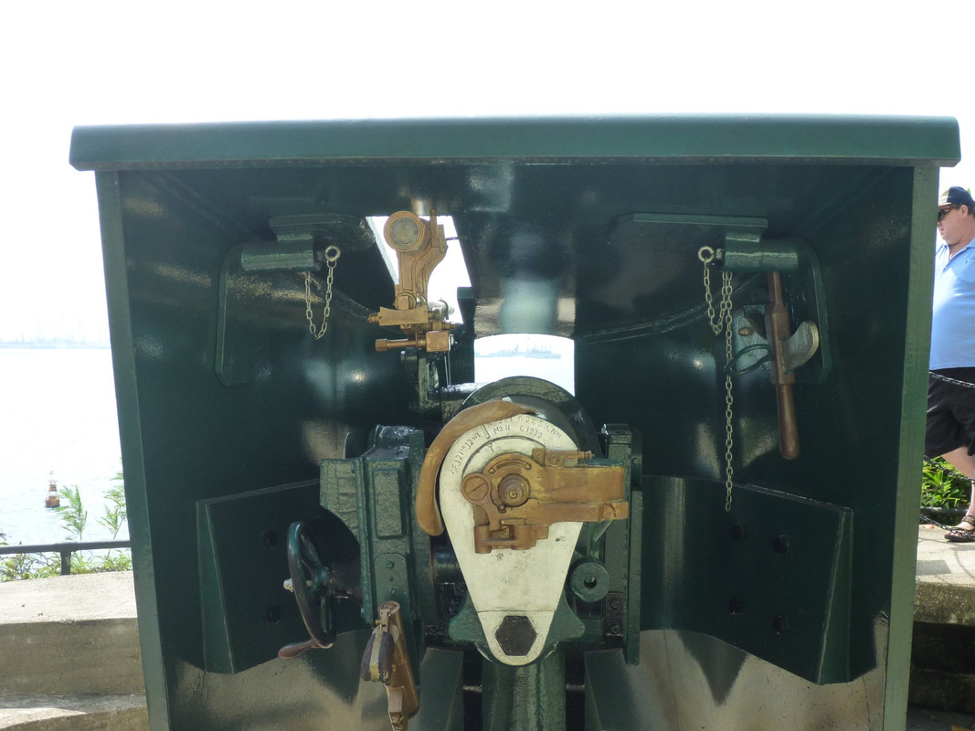

PostPosted: Sun Aug 21, 2022 1:32 pm
Posts: 5062
Somewhere I have photos of the excellently maintained 3" guns at the base of the Kowloon Peninsula in Hong Kong. Brass nicely polished! The Tamiya pains look quite good on your weathered mount. Though due to supply chain issues (nearest hobby shop 400 miles away) I have mixed my own Golden Acrylics, the Tamyia paints go on quite well, In my display case I have a 1:550 simple scratch built DE that I did 30 years ago and brush painted with their paints and one cannot tell it's not airbrushed.
A most excellent result!
