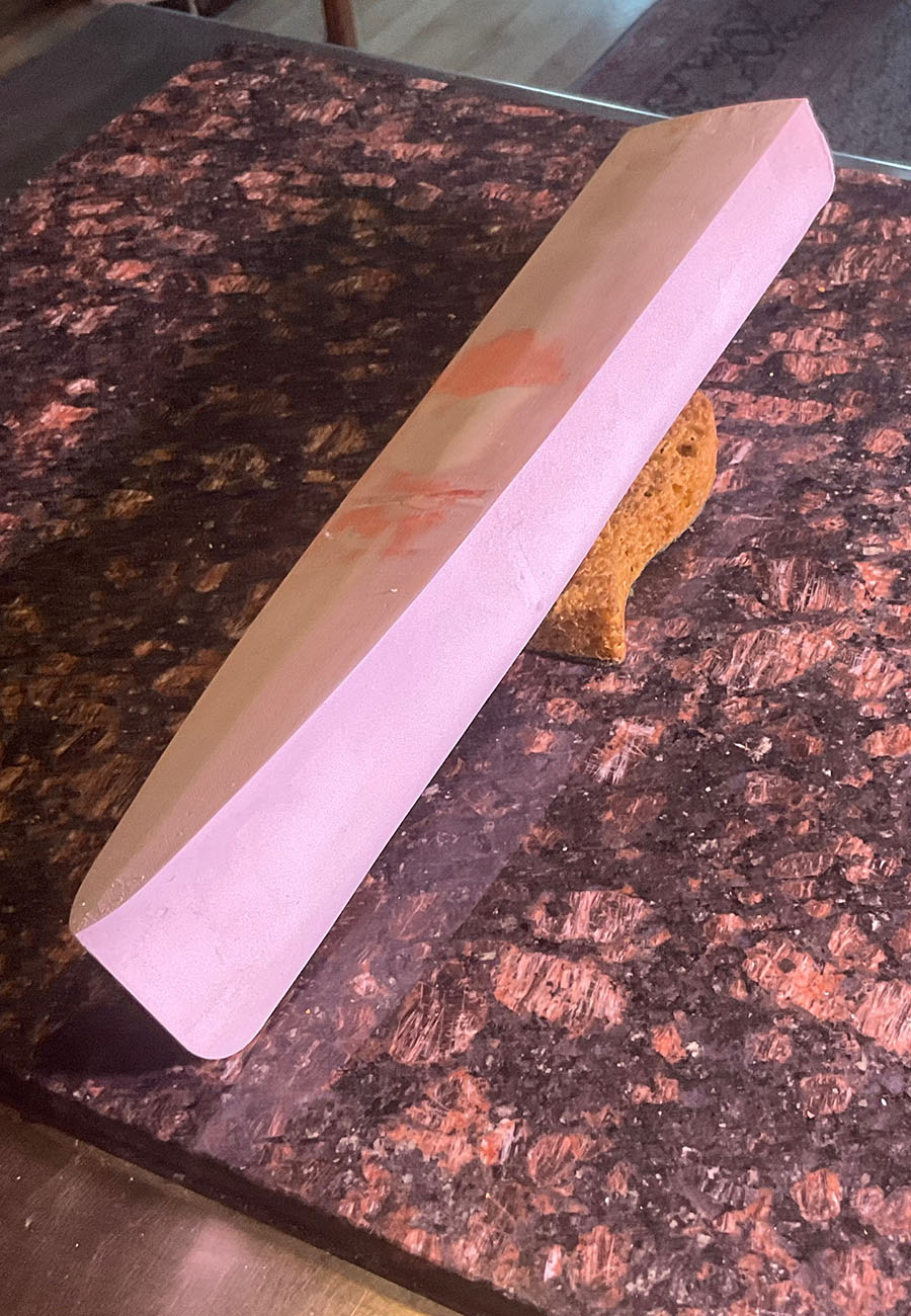

The bow, being the shorter of the two sections is now clear of the resin and looks OK. Maybe another 5 hours to go. Hopefully the vat won't run out of resin, though it was as full as could be to start. The Mono X 6K has a feature (bug) that stops the printer if the cover is removed. I think it has a resume feature so if needs must I can try to add to the reservoir.
Ordered two more jugs of resin just in case one doesn't do.
On the section on the left there is a horizontal tear, repairable....
Tom

 Post subject: Re: DMS 14
PostPosted: Wed Apr 13, 2022 1:57 pm
Posts: 1890
Location: Bretagne, France
Tom
It already happened when I printed my first hulls.
These type of prints are very different from the small parts.
Probably the retract speed is too high (too much stress), 180 mm/mn is safer, and or the UV exposure time is too short. 1.9 to 2 s is good. Or the hull is too thin at this point.
Glad to see that you have embarked on this adventure! :thumbs_up_1:
Pascal
PostPosted: Wed Apr 13, 2022 10:07 pm
Posts: 1677
Tom,
The tear could result from a "Lift Speed" that is too fast or insufficient exposure time. Since you increased the layer thickness you may need a bit more exposure time to be sure the resin is cured. This could depend upon the opaqueness of the resin for how long the exposure should be.
From what I have read in other discussions and on the Chitubox web site, the "Retract Speed" is actually the speed the print platform is lowered into the vat to the next print position - very bad terminology. "Lift Speed" is the rate the print platform and printed part is pulled away from the FEP film.
Also, I suppose ambient temperature could effect the curing time during exposure, so if the printer was too cold that may have contributed to the tear.
