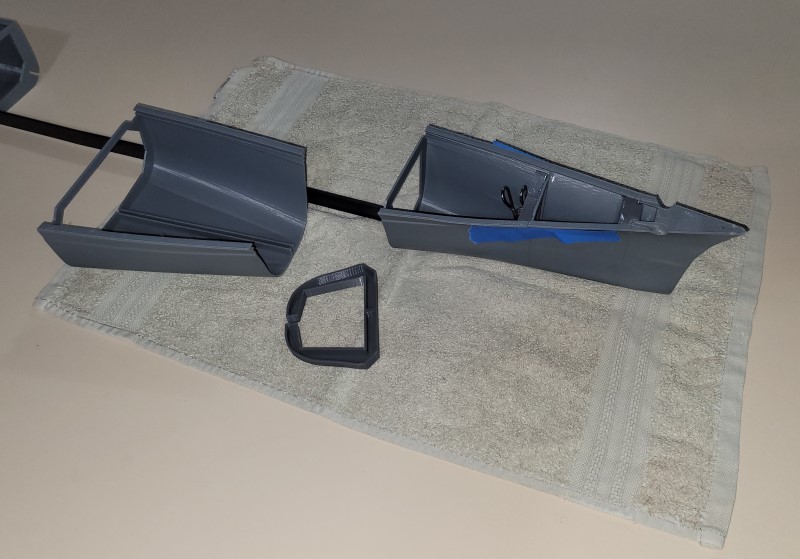

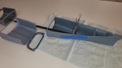

So, the steel keel support is a flat steel bar 3 X 20 mm, 1055 mm long. The angled cut-out at the rear is to accommodate the centre prop shaft and housing for an RC version.
File comment: Keel reinforcement bar.
BTW, in case you were wondering, I have been at this for around 2 months now. Currently the model looks like this:
File comment: Current Status 1
File comment: Curren Status 2
It is currently held together by gravity, friction and 2 pieces of masking tape so I really need to start putting it together, hence this build log.

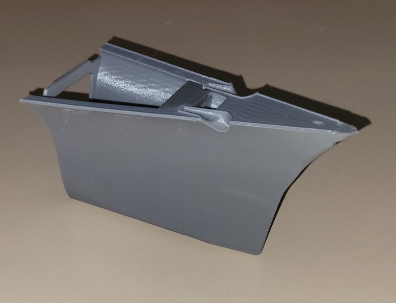

Finally a bit of movement..
File comment: Hull 2 Section
File comment: Hull 3 Section
Nothing much to do here really. Generous smear of Epoxy and start putting pieces together then checking the alignment of everything.

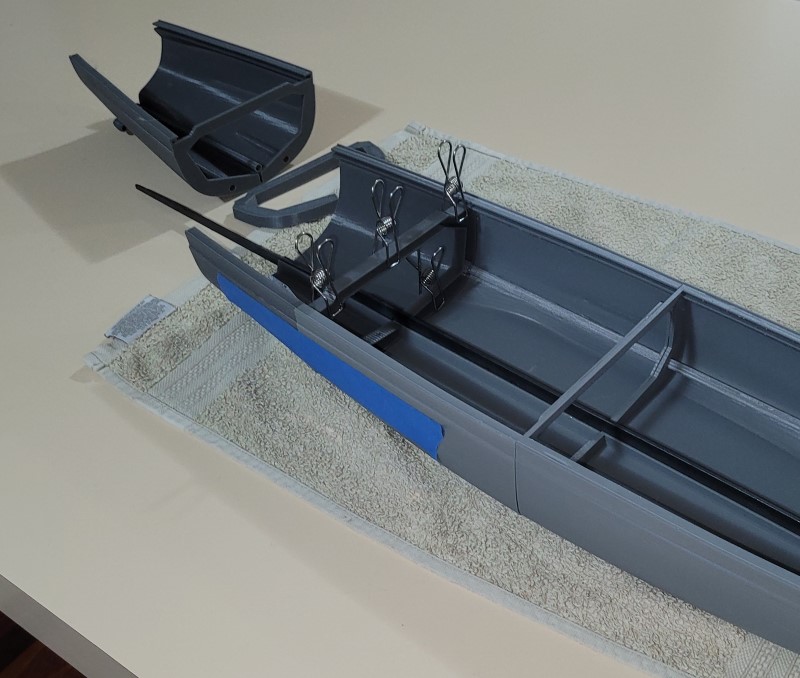

This photo may be a bit clearer:
File comment: Interface Detail
We are lucky here as the earlier sections of the hull were printed in a lighter Gray, than the later sections. (Not a biggy as this will be painted in any case)
You can see that the light hull section was printed with an "interface" (Bulkhead) built in. This has the added advantage of an increased footprint area and better bed adhesion.
The darker section is created by taking a slice of the end of the section 10mm in, then projecting from the end cross section and lofting between the 2 profiles. The fit is pretty much exact and follows the curvature of the hull nicely.
The hull is semi rigid so the interface can be inserted in either direction. If the hull were to be any thicker, or cut from aluminium (and thus not flexible), the interface would need to have tolerances added and be inserted from "inside out"
This gives a 10mm section of hull which gives plenty of purchase for the epoxy to grab between the hull sides and the interface and also plenty between the bulkhead and the interface.
I don't think it would work without the reinforcing keel bar.
Time will tell, and our lake is shallow!

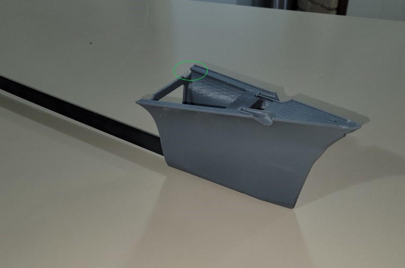

Slightly more progress.
Unfortunately a gap has developed between sections 5 and 6, its not terrible but will need to be filled. I'll do this either by 3D pen, plastic putty or filler.
File comment: Hull Section 6
PostPosted: Wed Jul 12, 2023 7:20 pm
Posts: 5062
Perhaps a very thin inside coat of fiberglass cloth (like model airplane guys use) and resin on the inside would obviate any issues of strength and water tightness.
Good luck! Tom

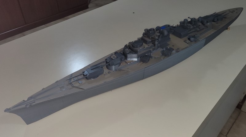

Finally, the hull is complete:
File comment: Hull Completed!
For securing the hull sections in place I tried:
    Super Glue
    2 Part Epoxy
    3D Pen
And the winner is (by multiple furlongs AKA Country Mile).....3D Pen!
In terms of part join strength its remarkable. The hull parts deform and collapse before the join fails (I had a few spare hull parts to destructively test), and I haven't seen a join fail as yet. It sets quickly and is fairly easy to control.
The Only issue I have is that I find my current pen feeds filament too quickly (you want to make sure the parts to be joined get fairly gooey so the pen needs to move slowly to spread the heat around) and only has three speed settings, so I have ordered a new one with 8 speed settings. Hopefully that may get around the problem.
Definitely thinking of making future designs 3D pen friendly for jointing.

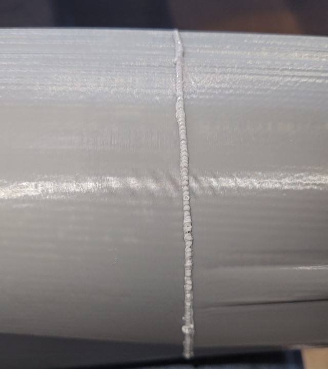

I forgot to mention I also tried friction welding with a rotary tool and UV resin. They all have pros and cons, but I'm fairly happy with the 3D pen results so-far.
Here is a gap that needs some work (Sorry to hurt your eyes like this):
File comment: Ugly gap
With my preferred amount of preparation (none) a weld bead is inserted:
File comment: Weld Bead
I could choose to leave my "stack of dimes", like any good welder should, to demonstrate to the world how amazing my welding skills are :whistle: but craft side cutters are a better option in this case:
File comment: Bead trimmed
And lastly a light sand and its ready for final prep and painting.
File comment: Cleaned ready for final prep

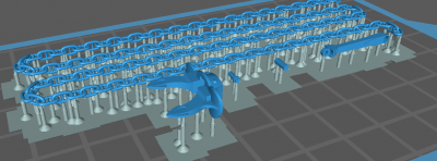

The anchor and chain is still my favourite. It zips right off the supports and is fully articulated. Mind blown...
File comment: Anchor print
