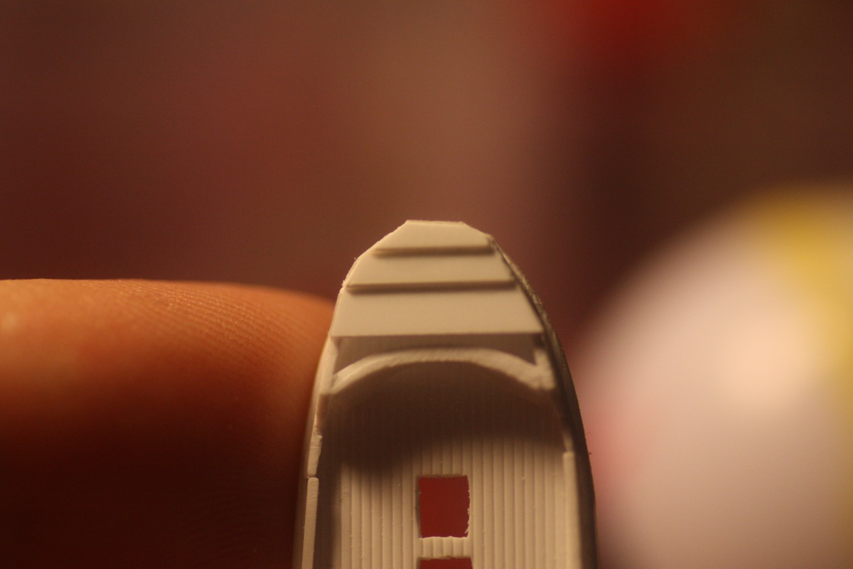

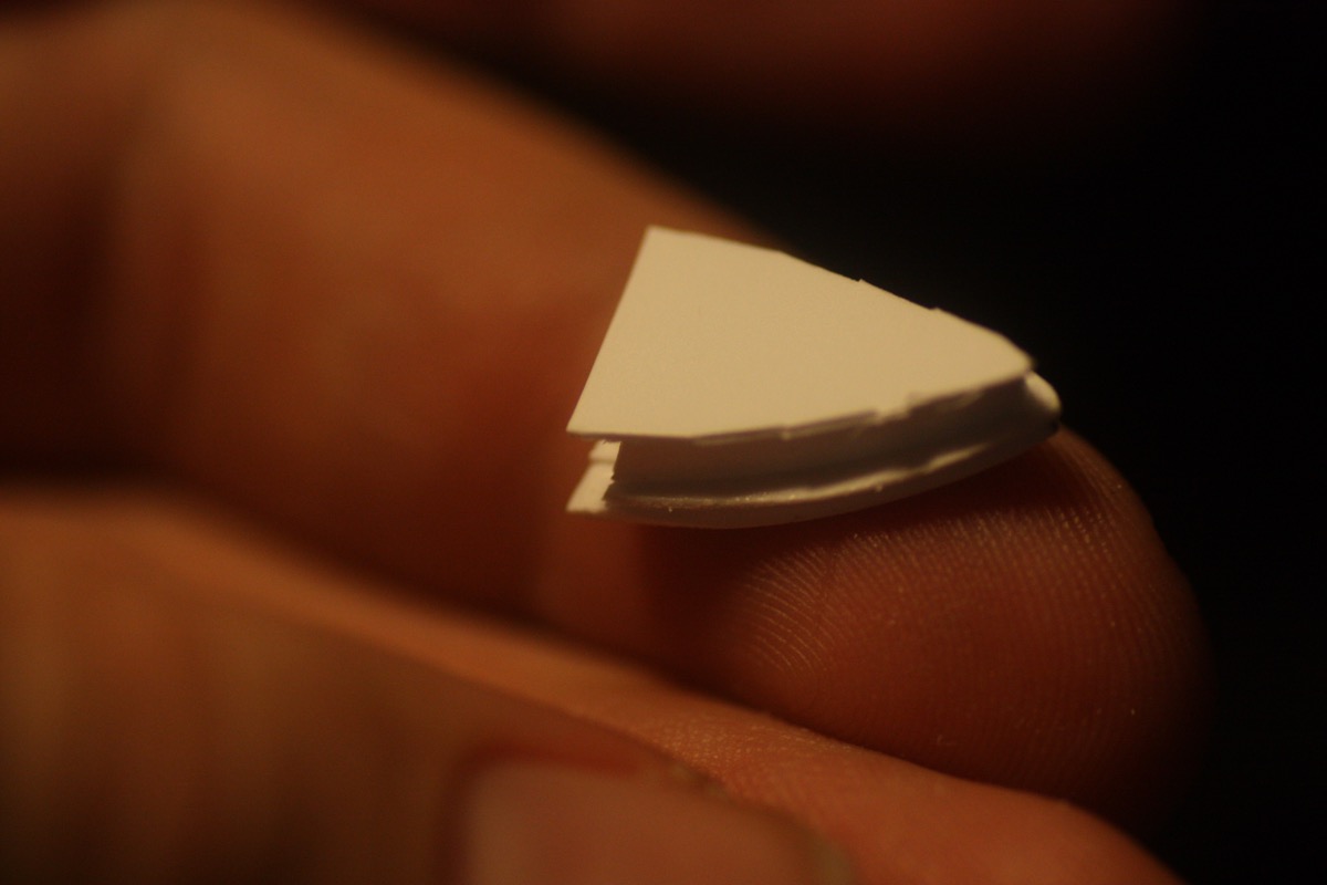

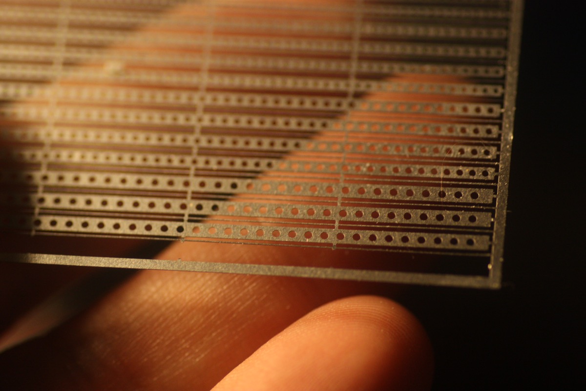

This was my first carrack and my first scratch built ship. I was just getting my feet wet with original subjects, and knew very little about carracks at this point. I called her the 'Beja.' As a representation of a genuine 16th Century Portuguese carrack she has a lot of errors, but I had huge fun building her and learning about the subject.
I had competed successfully in model contests before, and decided to enter the Beja in IPMS competition in 2011. To my great disappointment, she did not place. In fact, I had made several critical errors with this build that cost me in competition.

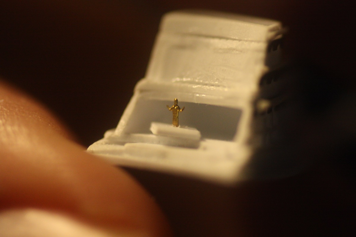

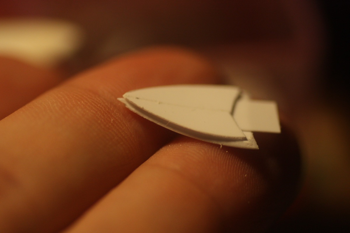

My next carrack was another conjectural build, which I named the 'Fora.' This build incorporated much improved accuracy and historical information. I also made sure my modeling was up to snuff with this one. As a result, she took best in her category at the 2011 IPMS nationals, a resounding vindication for me at the time.

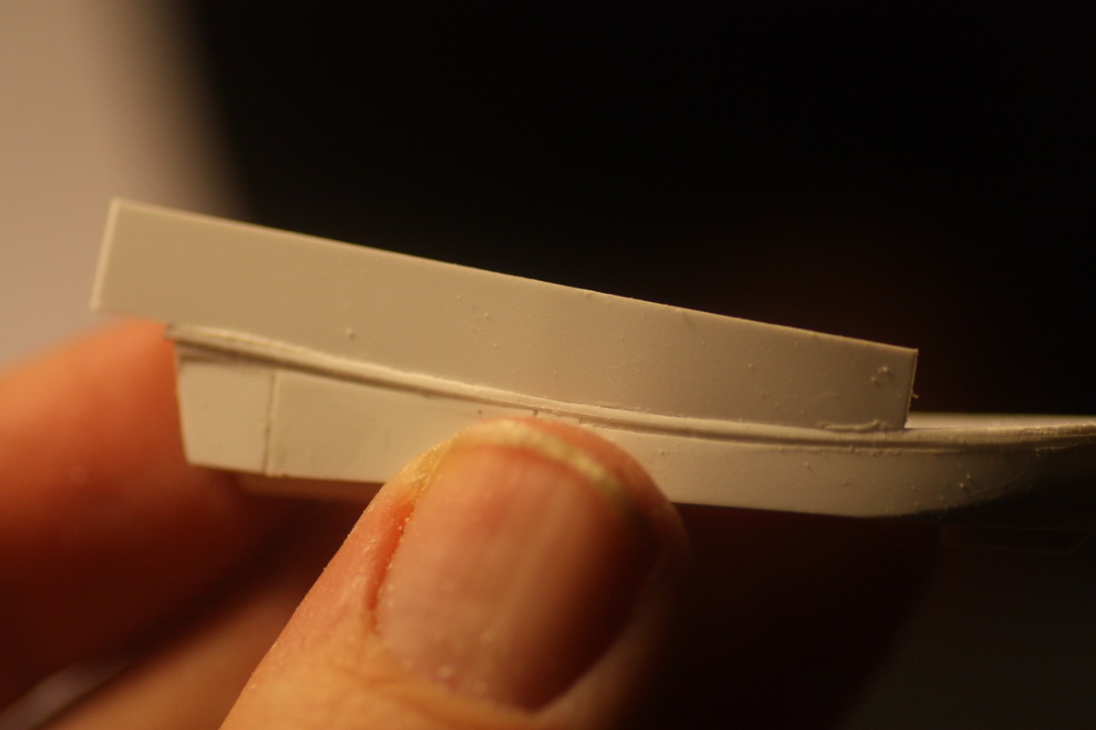

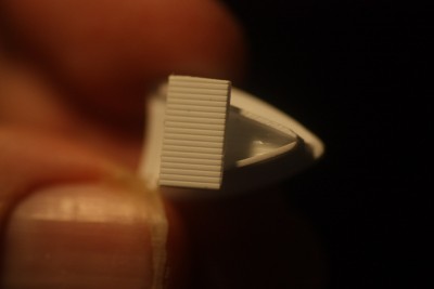

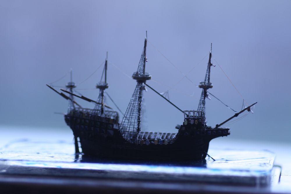

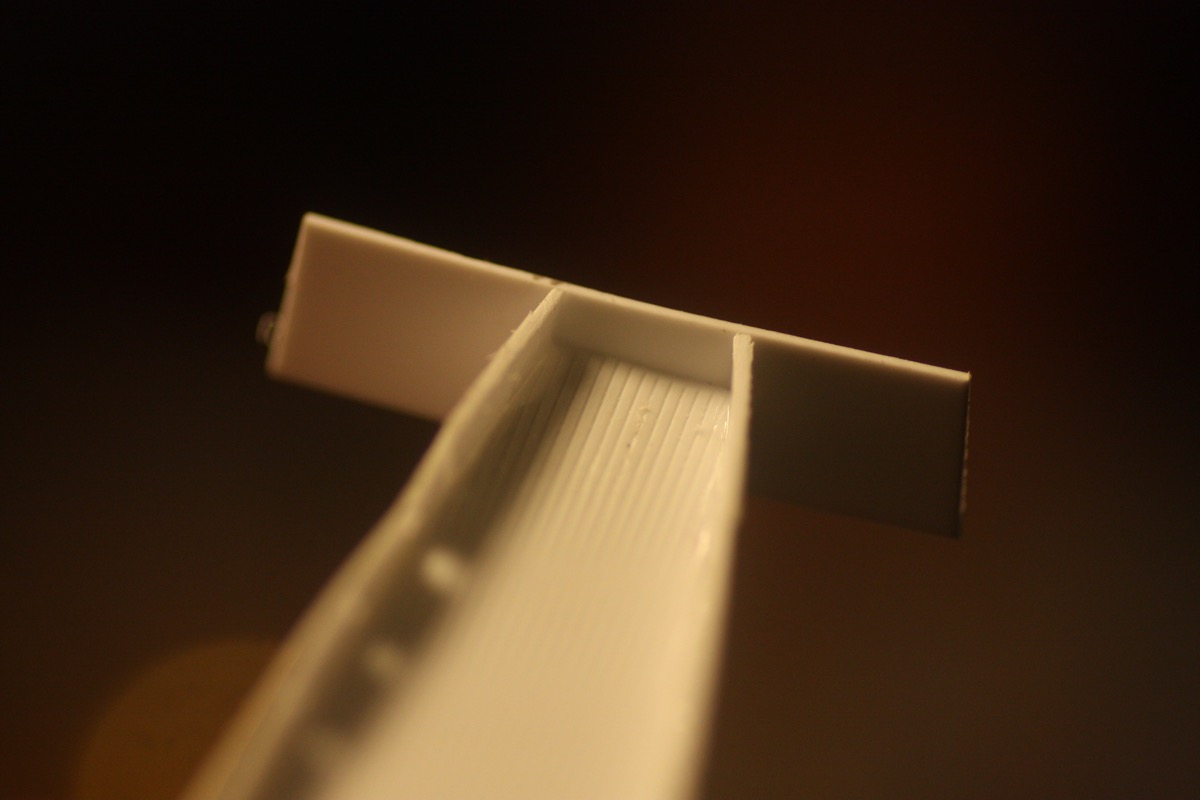

These are two shots of the same build, based on the famous 'Willem Kraek' contemporary illustration of a Northern European Carrack. Although this build is not done, it was probably my best effort at a carrack, the most accurate, since the Willem Kraek Carrack is considered by most historians to be an actual ship. I plan on finishing her concurrently with the Mary Rose this year.

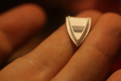

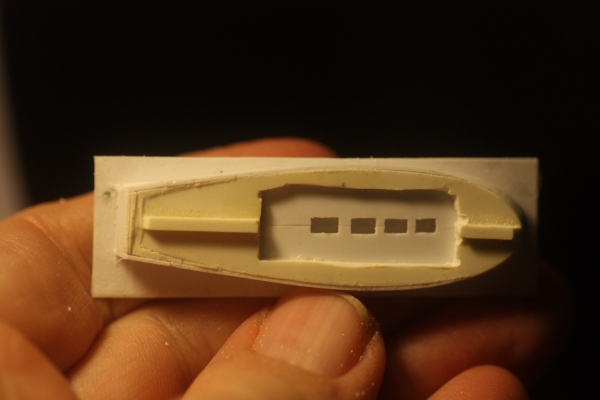

Other historical ship efforts included a still unfinished Solferino French Ironclad, which I also hope to finish this year.
For good measure, i'll include the remaining incomplete carrack builds in my collection, all generalized and conjectural:

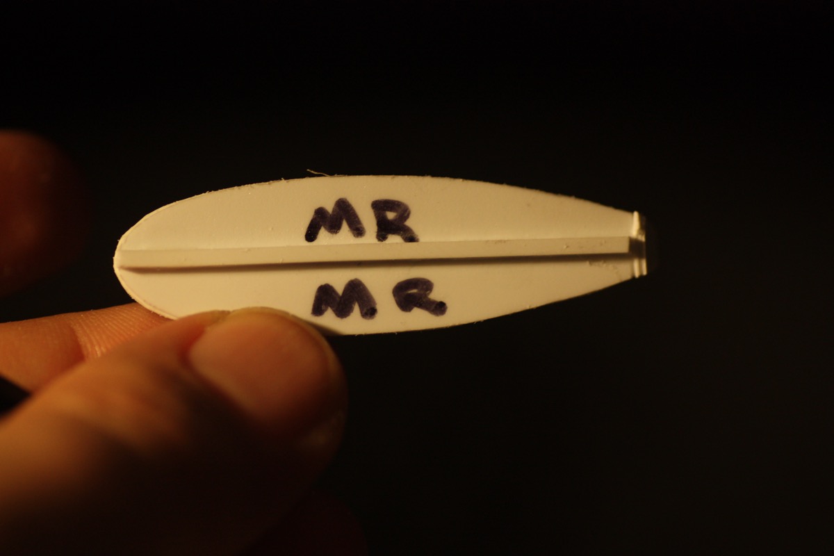

Ok! Here we go with the build! I began this model in 2010,
but set aside the base plate almost immediately in the rush to progress on the other builds I've shown you. I began the build in earnest only two months ago, in December.

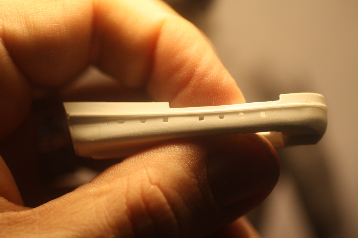

Adding the bulwarks before the decking caused some unnecessary complications, as you can see in the previous post, but eventually I was able to build a deck piece that matched the curves of the hull.

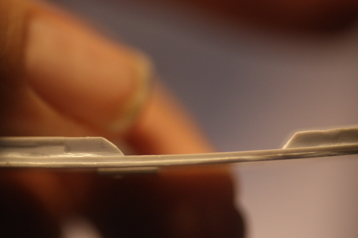

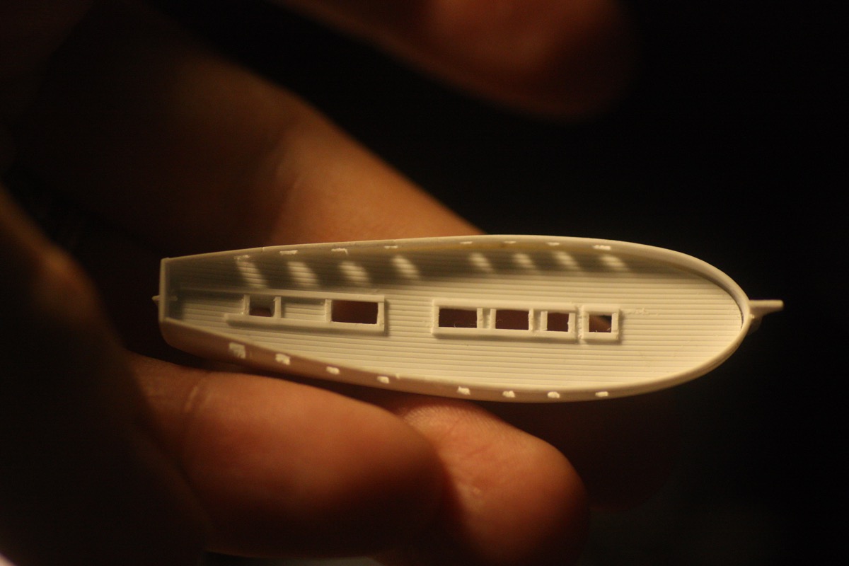

So here, you can see the deck I've worked on up to this point is actually the gun deck. The true weather deck will be, well...one deck above.
:big_grin:

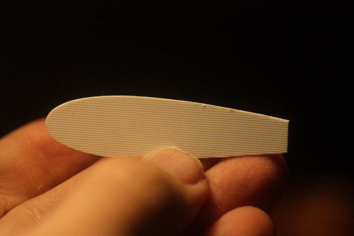

I worked very hard to create a deck piece that matched the lovely sheer of the lower gun deck. In the event it did tend to flatten out a bit, but was flexible and easily conformed to the upper surface of the lower hull bulwarks in dry fitting tests.

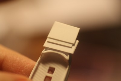

Like the forecastle, the after castle will have two decks. This is the lower one.

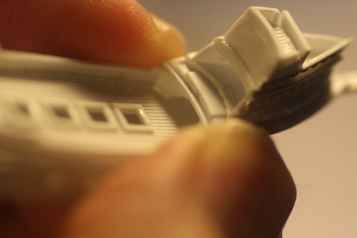

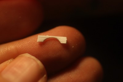

Now for a very characteristic detail: the Cubbridge Arch. This structure is present in the Anthony depiction of the Mary Rose, and in many many depictions of contemporary Carracks. The cubbridge arch stands astride the weather deck directly beneath the aft edge of the forecastle. I believe its purpose was to support the weight of the forecastle, and transfer that weight to the hull sides and frames/futtocks, while also giving access for the crew to the foremost part of the bow area. This structure was needed, as the weight of the forecastle was likely considerable. Very likely the windlass was located inside the partially enclosed area created by the cubbridge arch.
For the transverse planking of the cubbridge arch, I used square rod 0.01 styrene from Plastruct, as Evergreen does not make a rod this small.
Cubbridge arch installed.

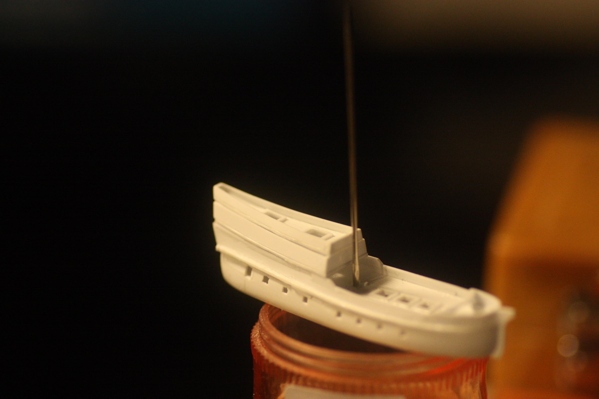

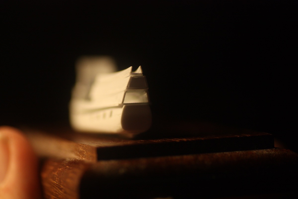

Adding some height to the bow. I realized, in pondering the angle of the forecastle that the Anthony Roll depicts a significant sheer to the angle of this structure. In considering the realism of this, I realized such a sheer would be very useful, as it would add height to the forward edge of the forecastle, facilitating its placement over the waist of an enemy carrack. This is the goal of carrack tactics, to place the forecastle over the waist of one's enemy. The forecastle then functions as a bridgehead for the invasion of the enemy ship, essentially land-based siege tactics adapted for sea warfare. Since this made the sheer of the forecastle a reasonable feature, I decided to adjust the model accordingly.

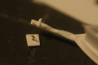

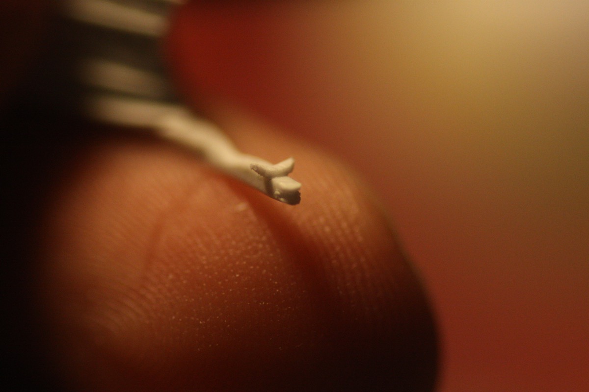

Beginning work on the figurehead. Many of the specific component terms of a sailing warship actually date to the time of the Carracks. 'Gunwale' today means the uppermost edge of a wooden hull, but the uppermost wale in a Late Medieval carrack was actually the most logical placement for cannons prior to the invention of the gunport. The forecastle (today pronounced 'foc'sle') was, in the era of the carracks an actual castle-like structure. And the figurehead was actually a monstrous head mounted on the end of a projecting timber. This head, though not strictly utilitarian, would have been the first part of the attacking carrack to converge on the waist of a defending carrack. The soldiers there attempting to fire at the attacking carrack would have seen this gargoyle-like head thrusting towards them as their enemy drew close. It must have been a fairly alarming sight.

Shaping the gargoyle-like figurehead.

This was new territory for me. An interesting task, trying to carve a tiny gargoyle head. In reality this part would have been about three feet across, not including the horns/ears.

At this point, I thought I'd enlist the help of a 1/700th Scale PE figure from my stock to help me gauge the scale and size of the various decks and components. I countersunk this figure into a piece of plastic, so the white base you see there does not, in fact, add to his height. In scale terms he's about 5ft 6". I call him 'Brass Bob.'
:thumbs_up_1:
Brass Bob examining the headroom of the forecastle lower deck. He's a tight fit, but this is characteristic for ships of this era.

Coamings for deck hatches...

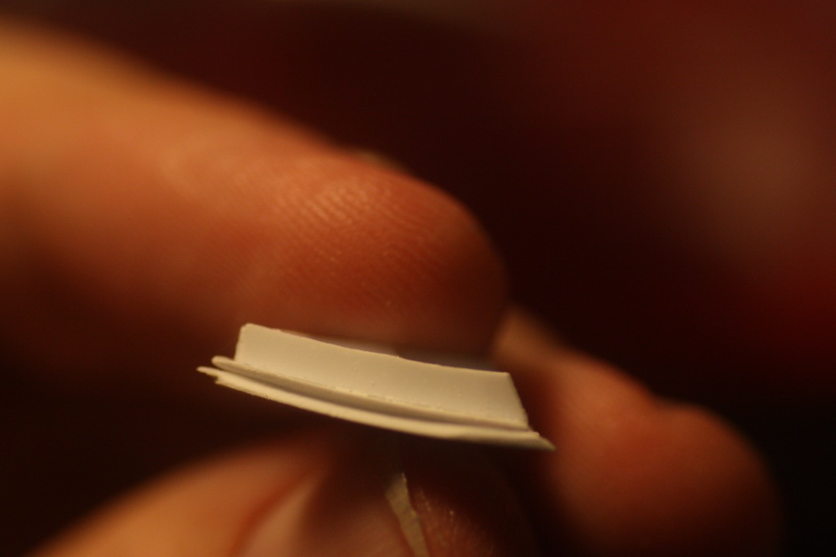

Building up the Transom.

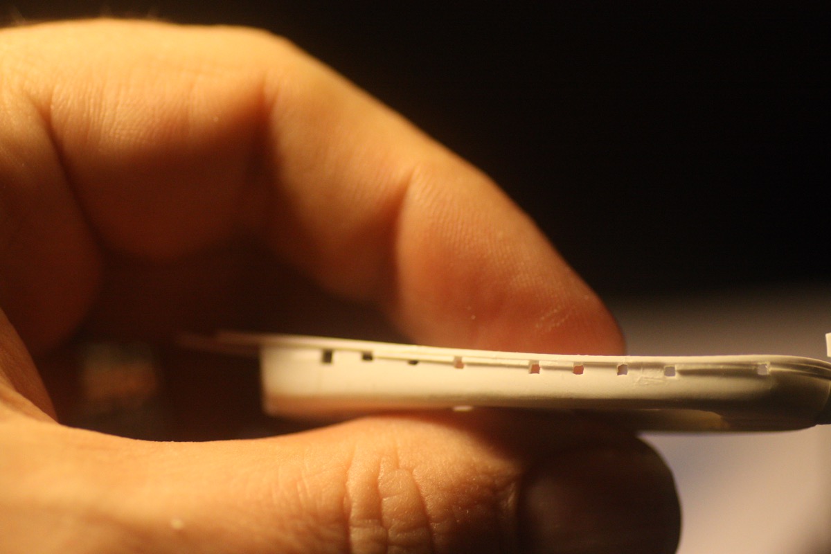

Stern chase-gun ports.

My intent with this build is to make the most of the interior spaces of the hull. I plan on showing the ship with her hatches open, so that one may be able to see down into the various decks of the ship. Even if the view is not extensive, the sense of 'interiority' will, I think, add to the appeal of the model. Here you can see my efforts to make sure the hatch coamings of the after-castle line up reasonably well.

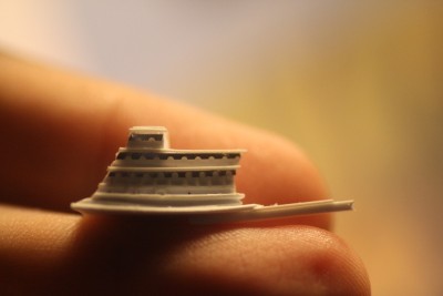

Checking the transom shape as it is developing. Since we're dealing with three separate pieces here, I need to continually verify the way they are going to line up. Tudor Carracks had a very distinctive sort of transom stern, flat all the way to the waterline, with a gradual tumble-home, and a slight overhang. The back ends of the various pieces have not yet been faced, but they need to come together well.

Hatch coamings faced for both the lower hull and the main deck piece. Really adds to the look of the parts.

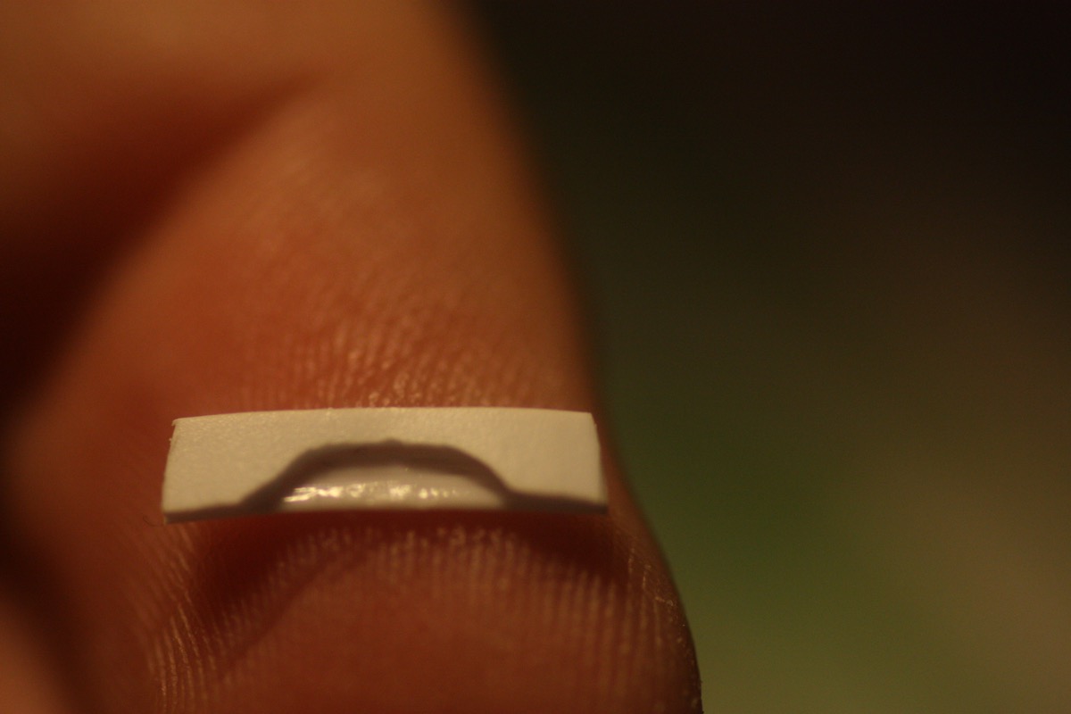

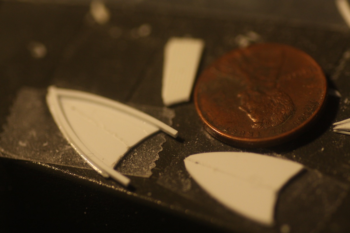

Adjusting the sheer of the forecastle upwards has created a problem. The final half-deck has a forward-facing bulkhead that was once vertical, but now inclines backwards slightly. Ideally this bulkhead should be vertical, making the angle where it meets the deck less than 90º. So, this will need to be adjusted.
Now we've got the right angle. Incidentally, this matches well the style of forecastles seen in the Anthony Roll, as well as other contemporary illustrations.

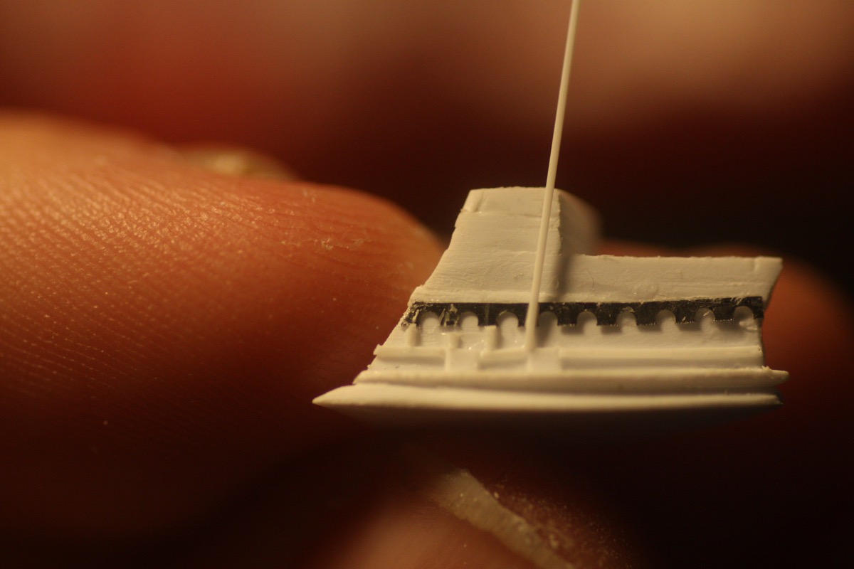

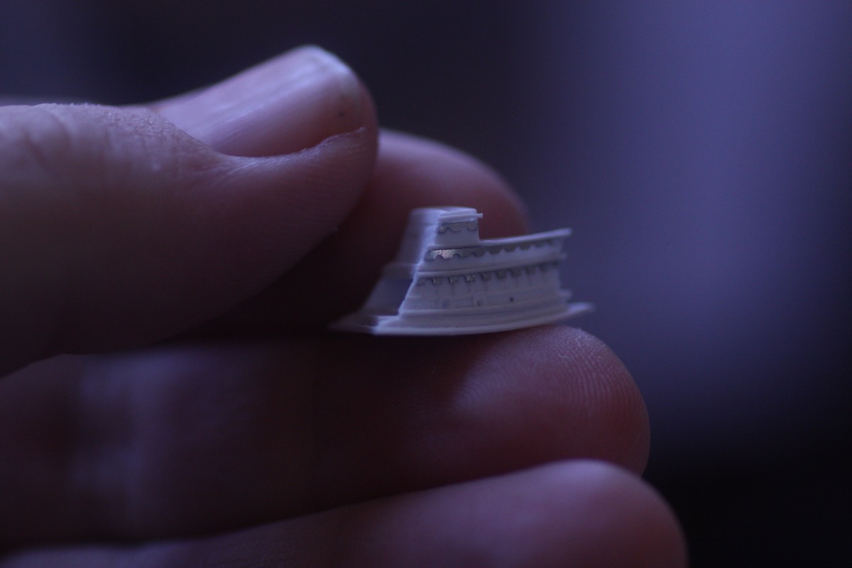

Note how the back edge of the various decks and parts of the forecastle do not conform to the curve of the cubbridge arch. In the Anthony Roll the back face of the forecastle has a distinctive concave shape. Some trimming is required.
I think this is much improved. The lower edge of the forecastle now conforms to the curve of the cubbridge arch.

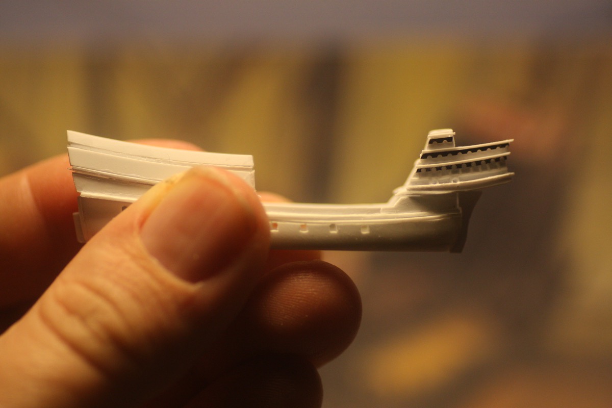

Dry-Fit of the various components so far.

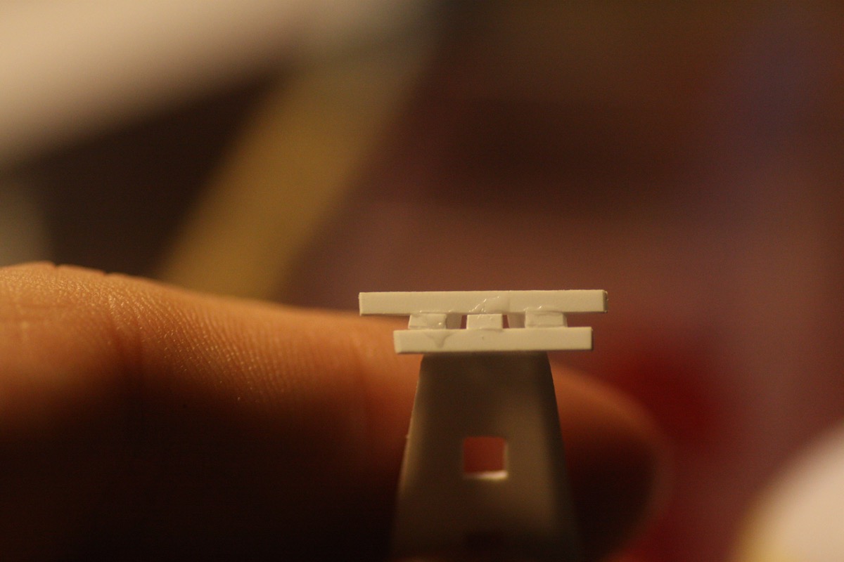

Alignment of the hatch coamings at the waist. The shape of these hatches has to be carefully considered. If they are too wide laterally, there will not be enough space for the cannons and their recoil.

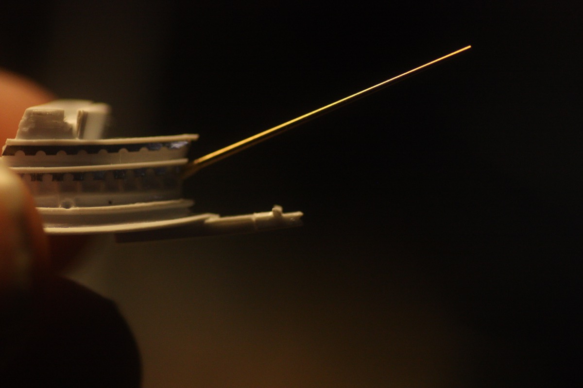

Bowsprit time!

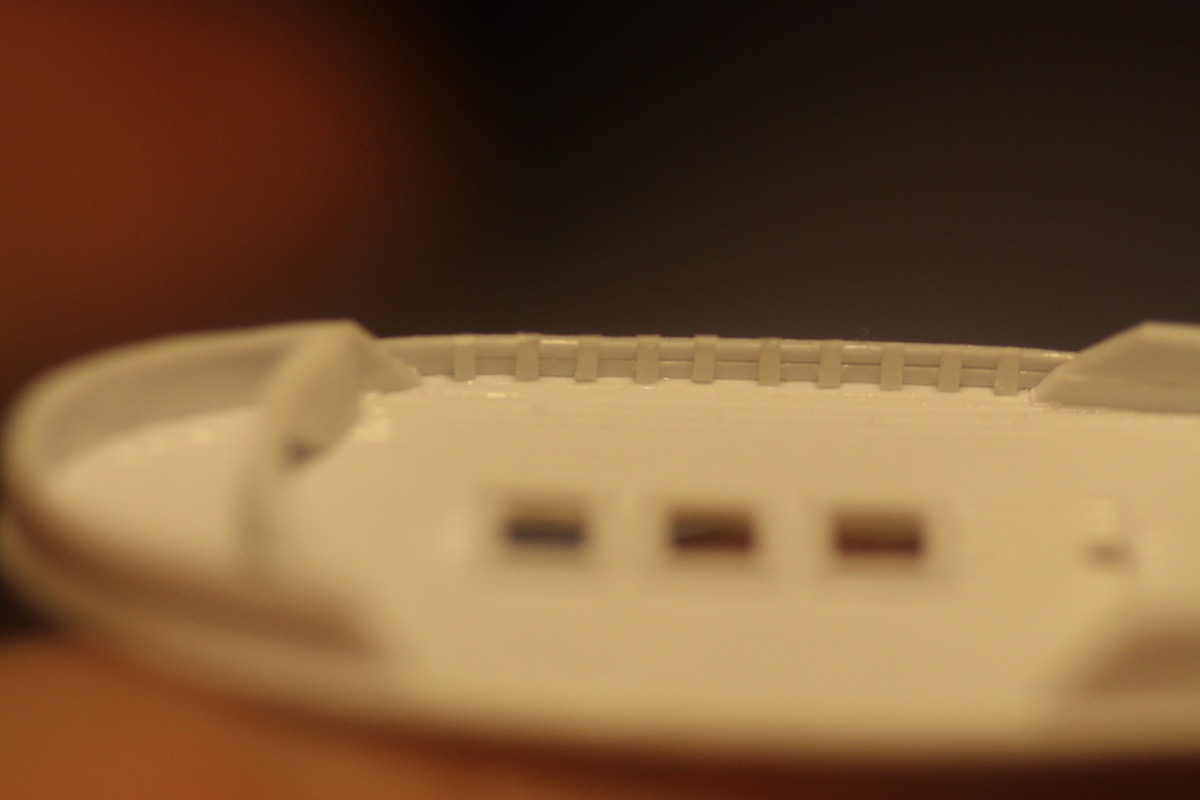

At this point, I realized that my zeal to create as many hatches as possible in order to show the interior of the ship had caused me a major problem. Can you see it?
I had thought 'the foreward part of the after-castle would be a great place to site the mainmast!' Without checking to see whether that was the case. In fact, it appears that nearly all carracks of all nations had their mainmast close to but forward of the front edge of the after castle. And I had made a hatch coaming right smack where the mainmast needed to be... :heh:

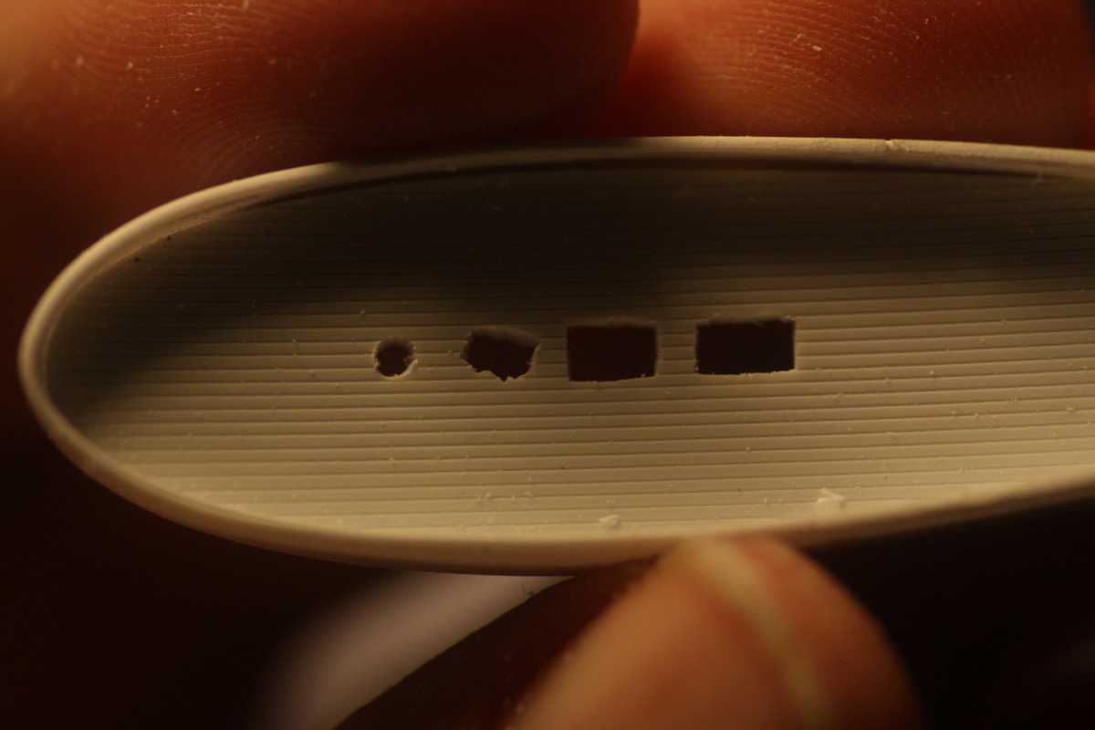

Now we have a proper site for a mainmast on the main deck. In fact, with the extra backing on the new piece, it's stronger than before. Cosmetically it's not perfect, but the seams will likely not be noticeable on the completed model with all of the detail that will be in place in this area.
As for the gundeck, it's not necessary to do any drastic surgery, simply filling in the coaming is sufficient, since this part of the deck will not be seen.

Checking the size of the build with the case I have picked out for her. The bowsprit makes for a tight fit, but I think she'll manage.

The gunwales at the waist are actually too high.
